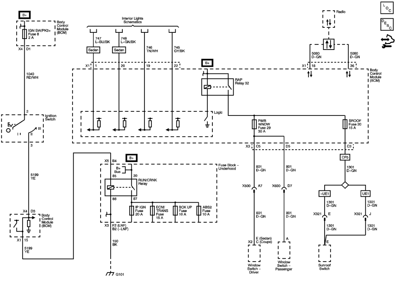

Can confirm that the four fuses after the run/crk relay becomes 12v when the key is switched on. The fuse labeled INJ is also getting 12v. This is good news I suppose?
Yes, good news. I am having difficulties on where to start on this issue too. Makes me want to go back to the OBDii codes.Can confirm that the four fuses after the run/crk relay becomes 12v when the key is switched on. The fuse labeled INJ is also getting 12v. This is good news I suppose?

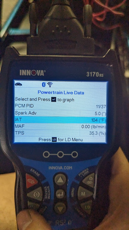

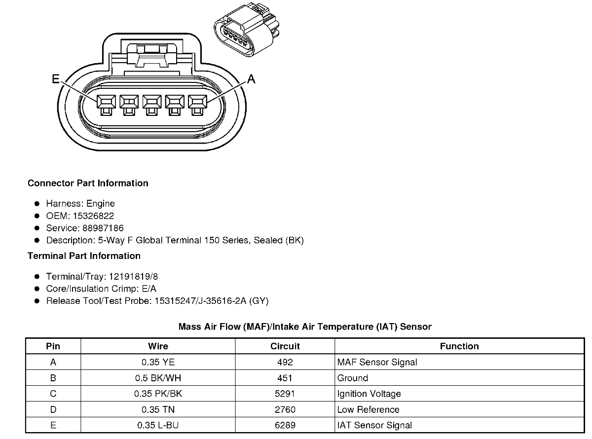

All what share the same ground? The IAT sensor is grounded through the ECM.Do all those share the same ground on the engine block above the starter and below the intake manifold?

Guess we will have to keep looking. The MAF reversal doesn't apply to your engine, and the electrical plug isn't it either.I grounded the TCU and ECU and nothing changed and the EXH fuse is getting 12v

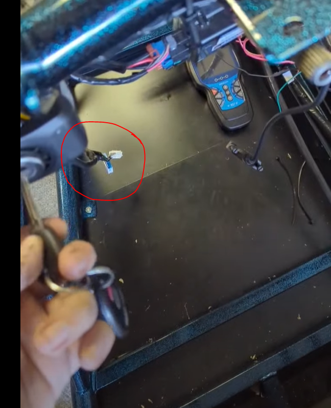

You did find an electrical plug that wasn't plugged in! Clear the OBDii codes, and try starting it again? I'm not sure what that plug does, but it had to do something. Pull the OBDii codes again, and see if anything has changed.
Check for more missing plugs... that is what got my LSJ to start the first time... a missing plug on a sensor.
What do these plugs go to? The ingnition switch? I would make sure all plugs are installed as a lot of systems are related. (i.e cruise control tied to 3rd brake light circuit)
