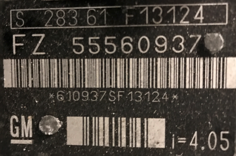

It sounds like the consensus is wait and see. I’m nearing finishing my new engine build so I won’t run out and buy a different one just yet.
I will still say the 3.63 is too tall for my current 220hp engine. Sounds like I should get a different trans for that one and maybe move my current one to the big engine.
So SliderR1, Lonny and I are all driving ~205hp LSJ SC goblins witk 4.05 diffs, running tires that are the stock highth?
My 1st gear is good until about 40mph, second, 70mph.
I'm not sure I am getting a full 205hp yet, as my car isn't instantly at red line in first...
Unless I do a clutch dump at 4500rpm... then the tires just spin and I hit redline. (Lol... I have never been on a prepped drag track.)

My biggest problem is first gear is instantly at red line. I feel I need a taller final drive as it is. If I were to up the power I would most definitely need to change
This is what I believe I will run into with mine in Autocross (F40 Regal trans)....launch in 1st and immediately into 2nd...pondering on how much power is really “value added” in this situation....would think 250-300 is about max “useable power” in Autocross based on the weight of the Goblin...

Since there are many transmission swaps occurring lately, I pulled up this thread for those who have not seen it before. Post #26 above provides some of the manufacturers information about the F23, F35 and F40 transmissions - published torque ratings and some assumptions putting these transmissions into a Goblin that is approximately 1/2 the weight of a Cobalt.
Thought I would also provide some additional information about the gearing for each transmission. The gear ratios and splits between gears can make a big difference in the acceleration and cruising RPMs that each one can provide.
In the below is provided the gear ratios, shift mph when selecting the next gear at redline, and the rpm the shift drops down to. Please note all the data provided is based on the stock sized 25.0 inch tall tires and shifting at 6200 rpm stock redline.

F35 - with 3.82 ring & pinion
1st (3.38) Shift to 2nd - 36 mph - rpm 3230
2nd (1.76) Shift to 3rd - 69 mph - rpm 4160
3rd (1.18) Shift to 4th - 102 mph - rpm 4675
4th (0.89) Shift to 5th - 136 mph - rpm 4875
5th (0.70) Cruise at 70 mph - 2500 rpm
F35 - with 4.05 ring & pinion
1st (3.38) Shift to 2nd - 34 mph - rpm 3230
2nd (1.76) Shift to 3rd - 65 mph - rpm 4160
3rd (1.18) Shift to 4th - 96 mph - rpm 4675
4th (0.89) Shift to 5th - 128 mph - rpm 4875
5th (0.70) Cruise at 70 mph - 2650 rpm
