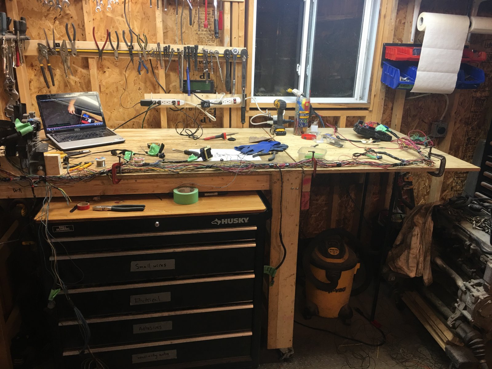

Once the kit arrived, I really had to move on the wiring. It took a long time, which felt even longer because there's not visible progress (and I'm still not sure I did it right because I haven't made it to first start up yet!).
A lesson learned, be a bit careful when you remove and coil the wiring harnesses up, it can get shockingly tangled easily to the point where I actually wondered how many wires I was going to have to cut and re-solder to untangle it. With a bunch of patience it worked out reasonably well. There are lots of helpful pictures and diagrams on this site. Adam has a good one posted that I printed out and referred to many times: https://photos.google.com/share/AF1...?key=N0YzY0tTQ1E4UTJvc1pRamNGMF9OcU5pNmVFaUlB
Wiring probably took me another like 25 - 30 hours, maybe more because I tangled everything to start. The lengths of the various legs of the harness aren't quite right, but hopefully it will work.

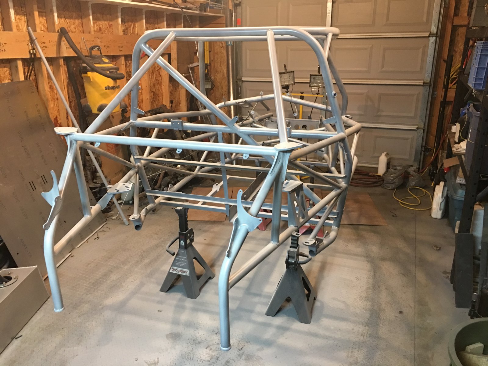

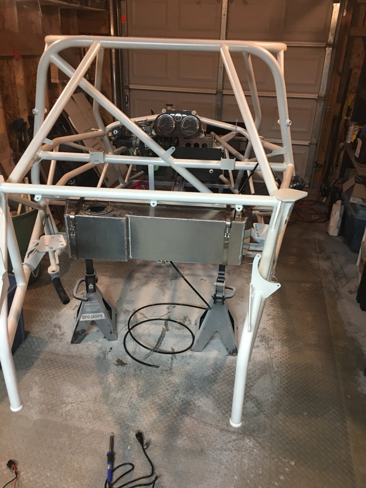

My wonderful girlfriend was keen/insisted on doing the painting of the frame, and other visible parts. I can't blame her, I'm way more of a function guy than a form guy. After discussion we settled on an iridescent pearl white with charcoal accessories.
In underestimating the work/cheaping out, I figured how many rattle cans could it be. I have a decent compressor and a paint gun, but rattle cans just seemed easier and quicker. Wrong! 5 cans of primer, 30 cans of color (the Duplicolor near match stuff at like $15/can) and like 5 more of clear. Total cost of like C$600! Definitely should have just used the paint gun, but we kept telling ourselves, just a couple more cans and it will be good. The paint job is decent and I'm hoping in the sun the color shows better.
J

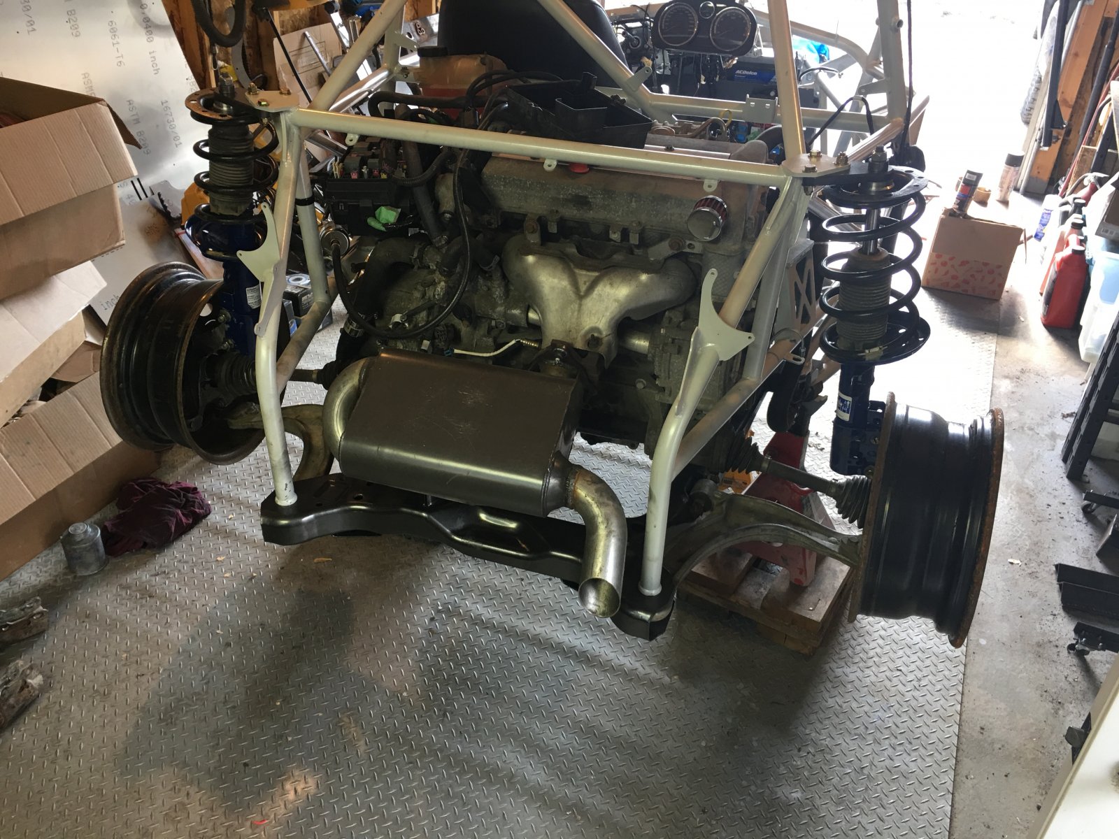

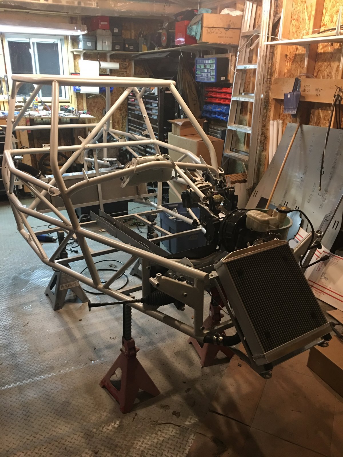

Currently getting a few of the basics installed. Holy crap that Tire Wet is slick stuff! Getting those hoses through was way easier than I expected with lots of lube, frame on the ground and the GF spraying while I pulled it through tug of war style.
I've got the powertrain bolted in (no picture of that yet). I didn't paint the gas tank because aluminum seems like a fine colour to me. I'm on video 20. If I can get this started this weekend I'm going to be one really really happy boy.
I also don't have the floor sheet metal because I'm waiting for my painter (cough gf ... cough) to have time to paint it. She is definitely a way better and more patient painter than me!
Current step if figuring out the coolant hose routing, which seems much more complicated in an SC with the IC/HE hoses. I chopped up a bunch of the stock hoses during disassembly because they were so seized on and I may regret my impatience.
It would be nice if there was a little add-on document to the build videos with just a few comments here and there about things that are different in an SS/SC than the stocker they are rebuilding. Maybe I just haven't found it yet, because while I've read most posts in some parts of this forum, I haven't read all the awesome stuff that's here.
If someone is feeling generous, where is the H/E for the IC supposed to mount? I saw pic with it mounted on top of the engine. I saw another with it mounted to the left of the battery box, which seemed a little vulnerable to road debris to me, but I'm not the smart one that put this awesome kit together, so I'll just do whatever is recommended!
The HE is pretty much left up to you. Each builder seems different about where and how to put it. You're right, there isn't a lot of specific information about the differences in the SC build. You kind of figure them out as you go or ask how others did it. I did my coolant line different than some of the other, it's part of the fun of doing your own build and building it how you like to. I was wanting to make sure that I did everything by the book and then quickly realized the book is more hints and suggestions as you go along. I'm fine with that.

For others, getting wires tangled is a big pain. I got 1000 small tie wraps and used them to keep the groups together while thinning. I actually got a 16 ft table. A sheet of plywood where I put some screws in it at junction points and tied the harness to the table. It was easy.
Thanks for the comfort on the H/E. I totally understand (and mostly enjoy) the general guidance and letting me figure out the rest. The flip side is that Adam and Lonny are way smarter than me, so if they'd designed with something specific in mind, it is probably a lot better/easier than what I'd dream up!
A 16' table would be brilliant. I moved to a new house (and more importantly new garage) as I was planning this build. New garage meant new custom built workbench. I built a 3' x 8' workbench (well 5' with an extra 3' fold up leaf) specifically with the wiring in mind and it wasn't really long/big enough. The wiring was time consuming, so having a really big work surface would save hours and some aggravation.

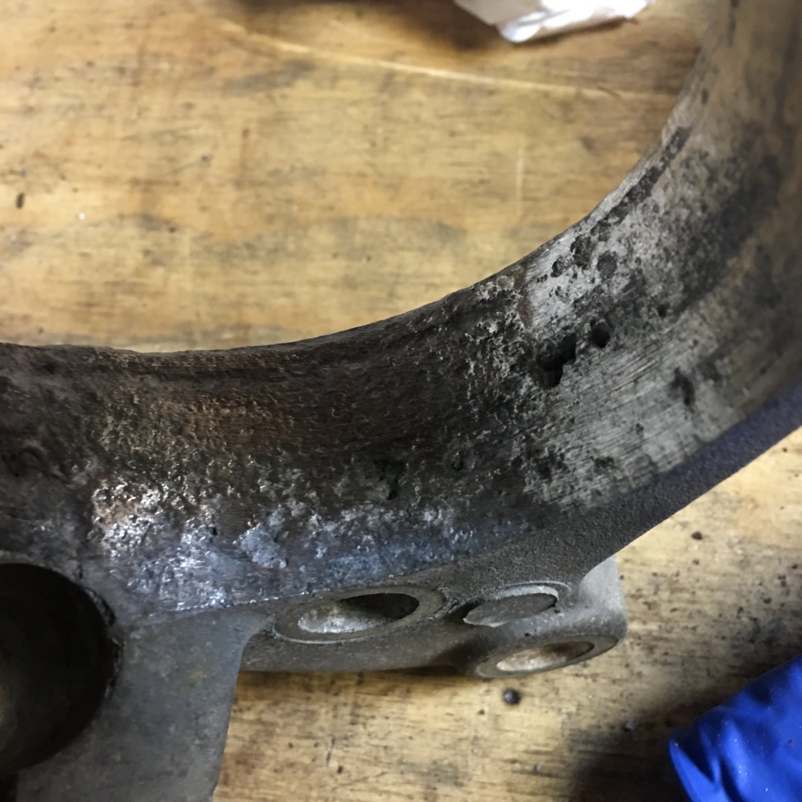

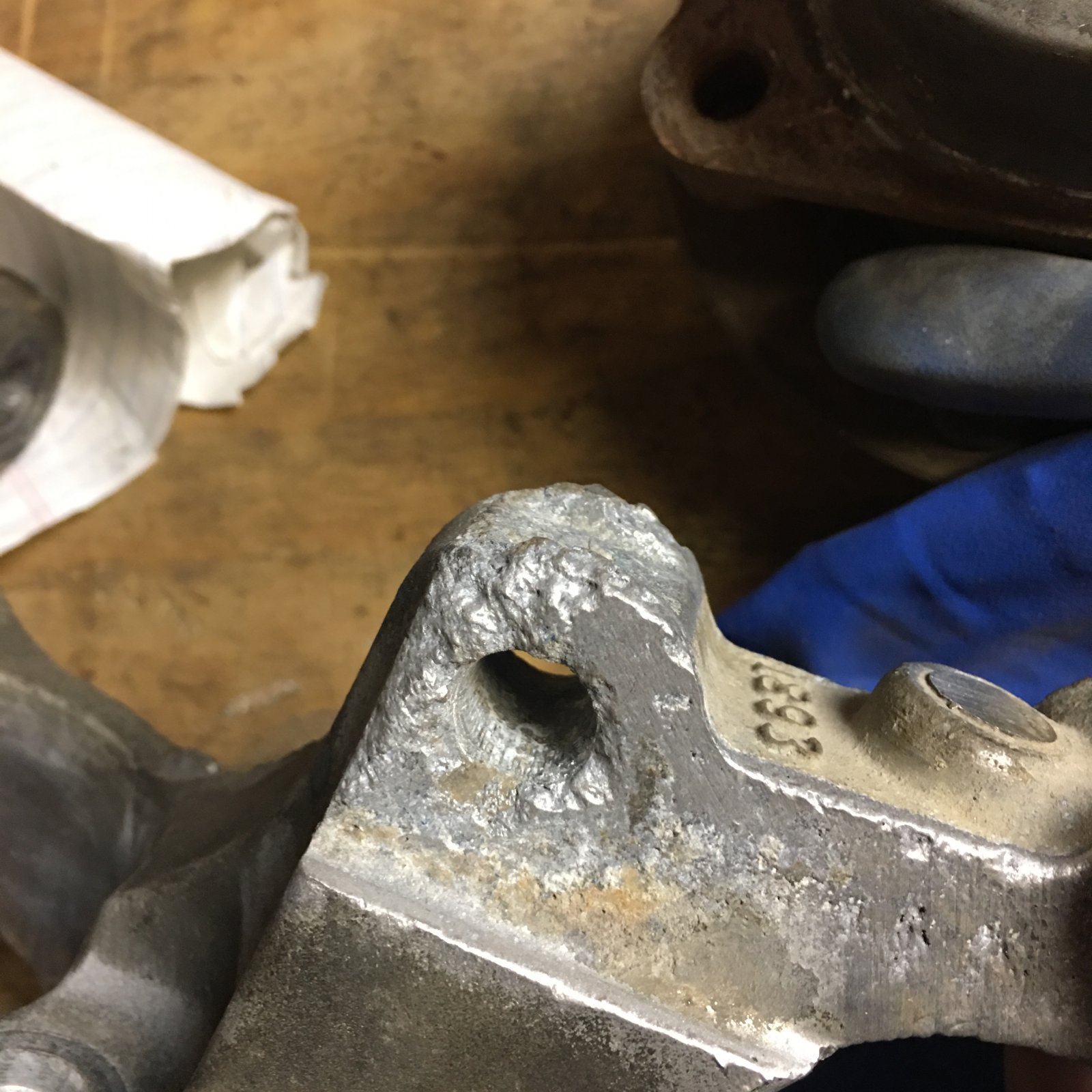

Anyone encountered some kind of mouse that eats aluminum steering knuckles? Maybe it is only native to Canada.
I'm putting these on for now, so mainly this is just to emphasize the value of low mileage donors rather than my 200k + miles donor.

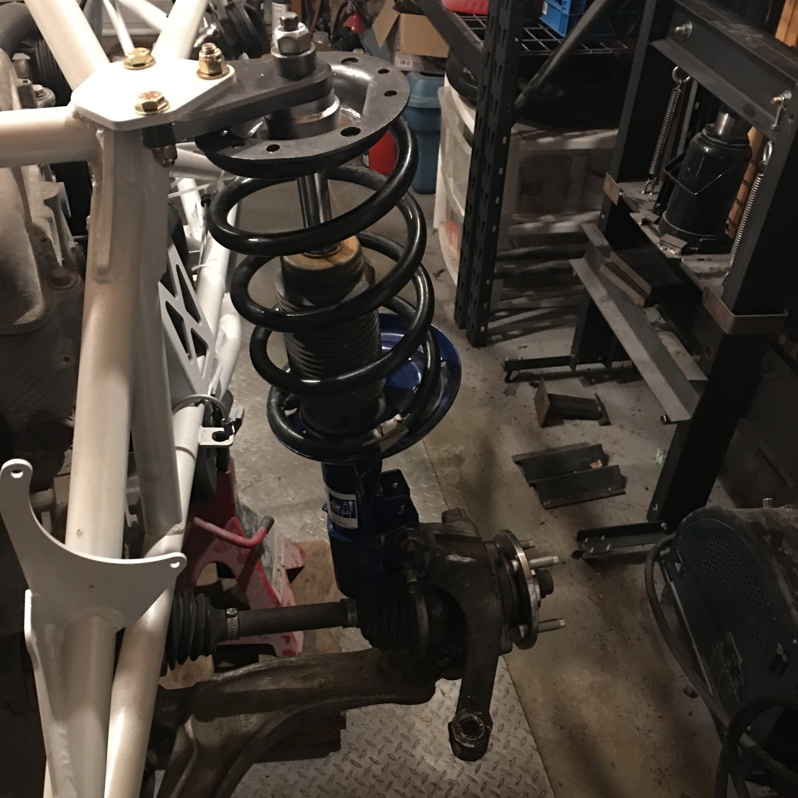

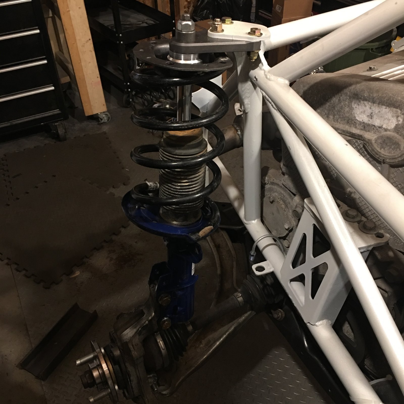

Got the suspension put together on the first corner (passenger rear). Does this generally look right to everyone? I cut half a round off the bottom of the spring in accordance with the write up instructions. I'll get some wheels on eventually and see how it looks in terms of ride height.
I heard people talking about "seating" the aluminum spacer, but I'm not sure how that would work, it seems to just sit on top of the strut top-hat.

dperkins
Those look quite strange, maybe some type of corrosion? I think you could just sand and polish the imperfections and re use it if you really don't want to replace it. Shouldn't be too bad since it's supporting less than half the weight of stock.
Karter2026
Road salt, Calcium Chloride, Magnesium Chloride. And the fact that the aluminum is sandwiched between the steel of the strut. Mine looked the same. Not really visible when it is on the strut.
