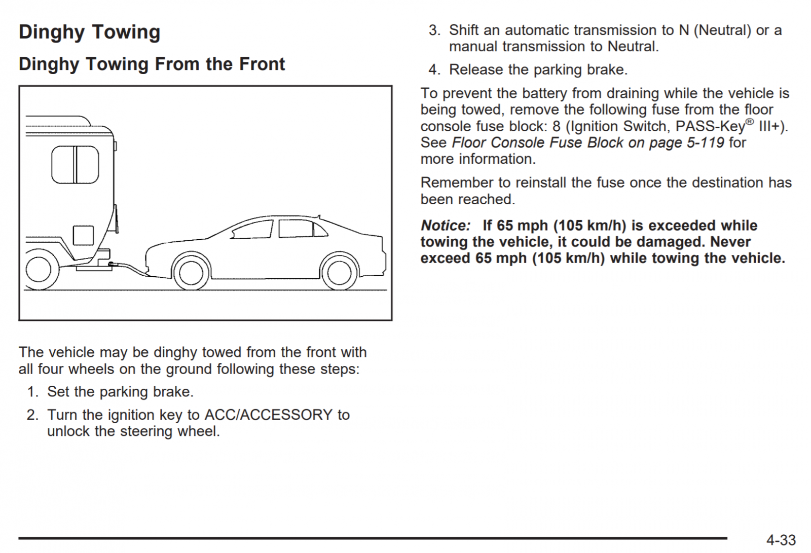

See also below from a 2009 Cobalt Owner's Manual:

According to the GM manual snippet posted by Rauq, you're supposed to remove the ignition/PK3 fuse from the BCM, turn the ignition to the accessory position, and put the trans in neutral. Just checking why this is necessary; is it to have power to the power-steering motor during the tow?

Do you have the tow bar package from DF? I used mine for the first time on Sunday when I blew up the engine at autocross and it worked flawlessly! We don't have to worry about the steering lock mechanism so no need to turn the key on and pull fuses. I picked up a magnetic towing light kit from Harbor Freight cause it was just way easier than trying to wire into the Goblin lights.

Thanks @Fozda and @Gtstorey for the info, I didn't even consider the steering lock as the reason.

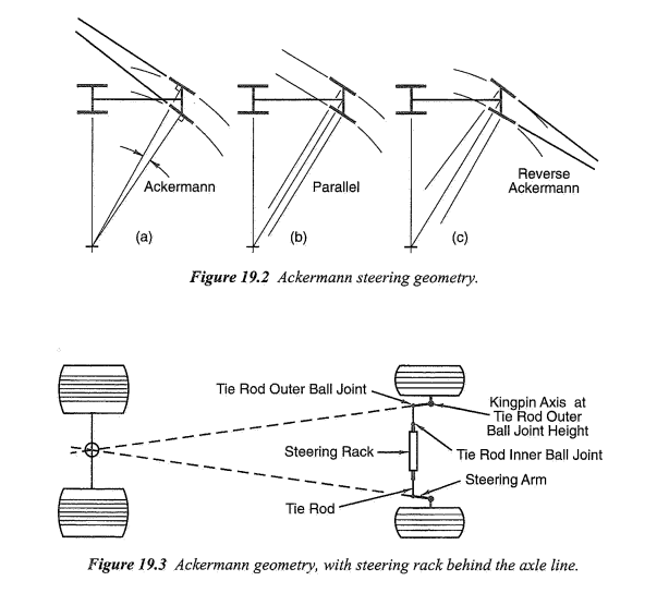

I flat towed my goblin to the State Hwy Patrol this last weekend for inspection. It was fine on the highway and straights, but dragging it through turns just felt wrong, I could feel the goblin's tires dragging and it was shaking the ass end of my truck. This was my first time flat towing anything, are turns just like this or is there something wrong with my setup?

The wheels/tires do not touch the control arms. All the clearance is good while driving the goblin on it's own.
I redesigned the front suspension and went with a parallel steer setup (street cars typically use Ackermann, as does the stock goblin setup)
