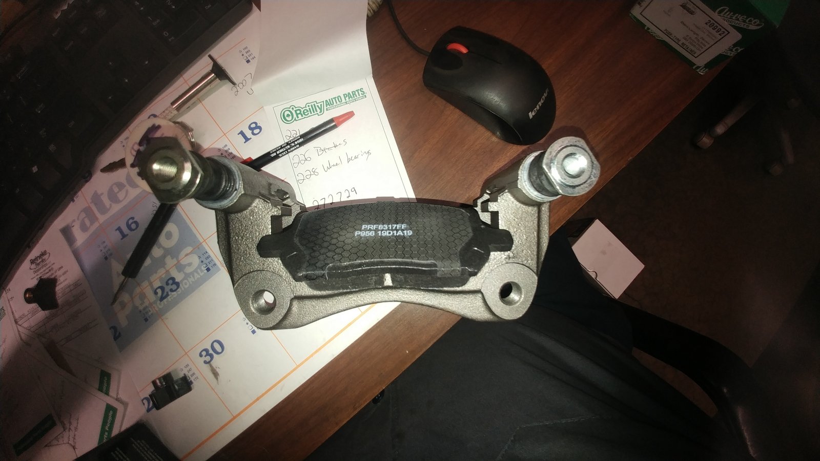

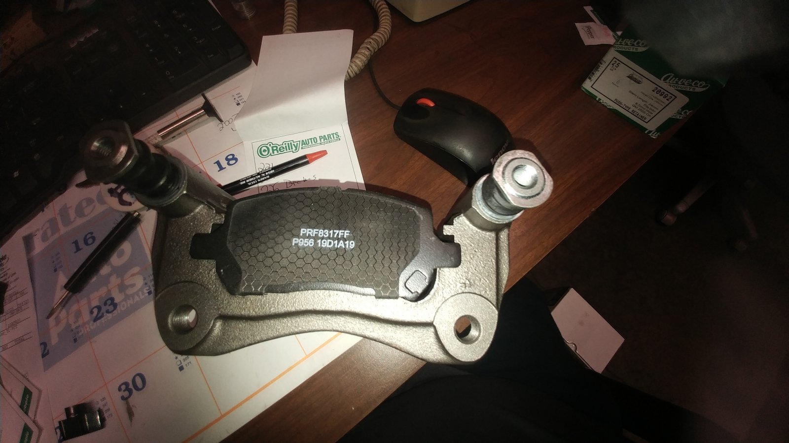

Ordered PXD956H pads for an 09 cobalt ls they don't fit. All 956 pads should be the same size. Caliper is 18-B4880a for left front.

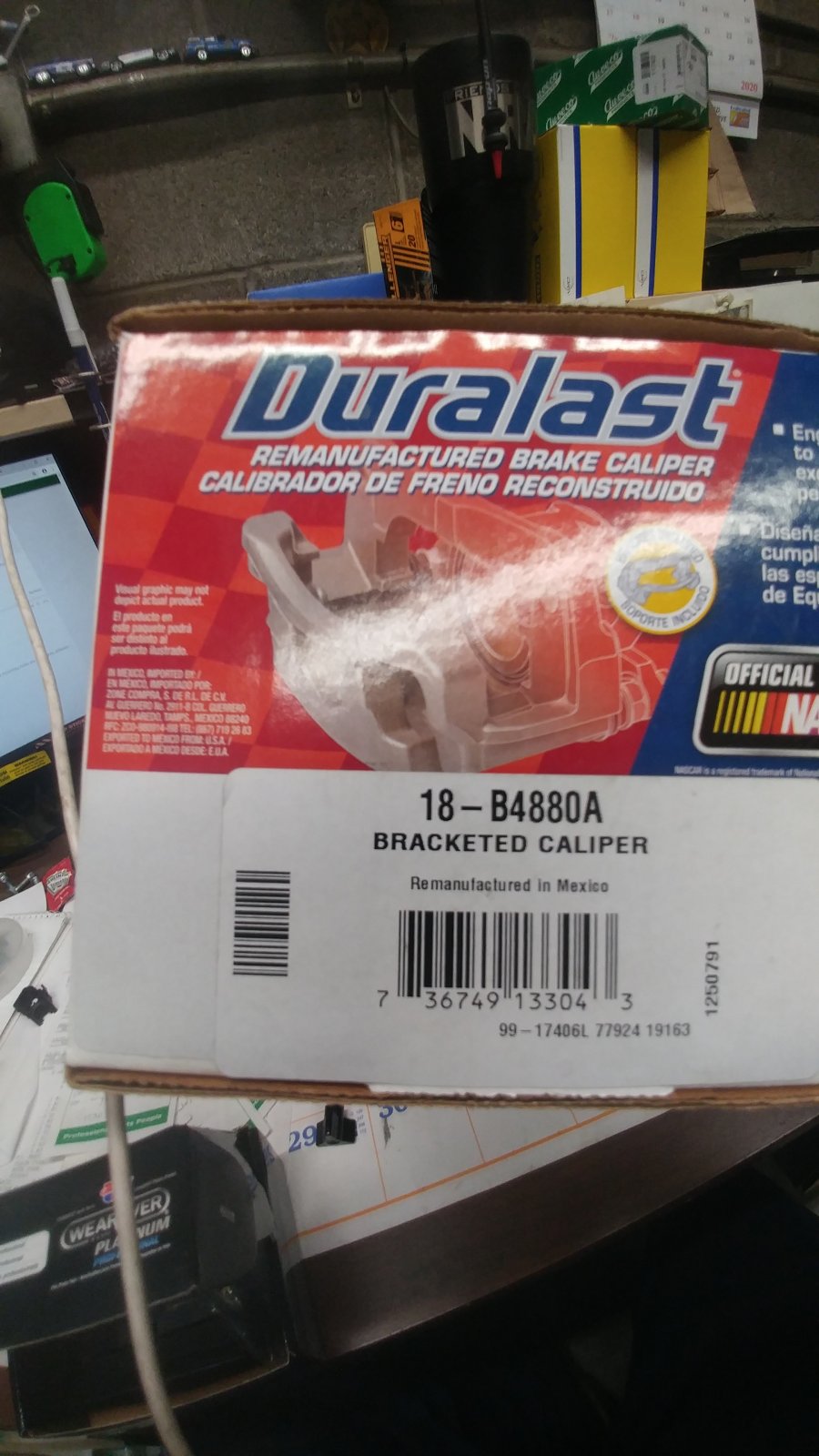

These are the calipers that I received for my SS/SC build, with no parking brake:
Duralast:
18-B4880A - Front Left
18-B4881A - Front Right
18-B4880 - Rear Left
18-B4881 - Rear Right

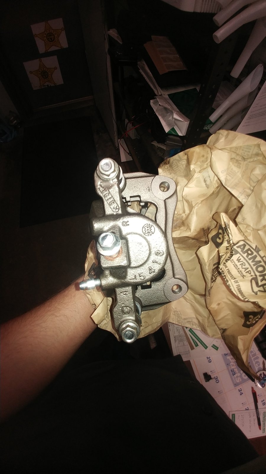

My 18-B4881A box contained the drivers front caliper but it was open, the 18-B4880A box was taped shut but has a mystery caliper in it. What number caliper is supposed to go where? Did I have a left caliper in a right side box, or is askiles wrong on his sides for part numbers?

Yes, I know that. I need to know what the actual number is for each side. Askiles post says 18-B4881A is front right, but my box 18-B4881A was a left front caliper. Was it boxed wrong or was askiles post wrong? I need a right front caliper now
After being in the auto field for 30+ years I have found parts store rebuilt calipers boxed wrong more than they are correct. I have seen the wrong one completely, sides swapped, wrong brackets, and one that was in a sealed bag that was rusty and grease covered and definitely not rebuilt.
The best and quickest way to figure out if those numbers provided by Askiles are wrong is look up a base cobalt at the parts store web site.
According to Advance auto parts 4881 is Right front
So do need a 4880 then for a cobalt left front for the goblins right front? Were the cobalt front calipers trailing instead of leading like they are on the goblin?
Karter2026
You need one of each of these
18-B4880A - Front Left Driver side
18-B4881A - Front Right Pass side
What they say is where they go on the car.
You apparently had 2 calipers that where boxed wrong as usual
From what I can understand you have a left front caliper in your hands correct? If so you will need the 18-B4881A - Front Right Driver side caliper
