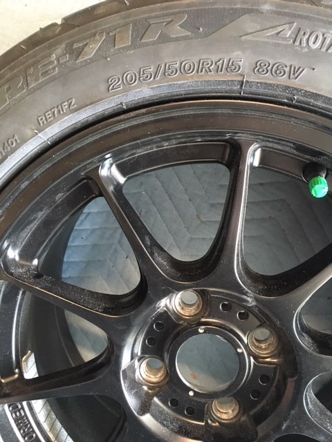

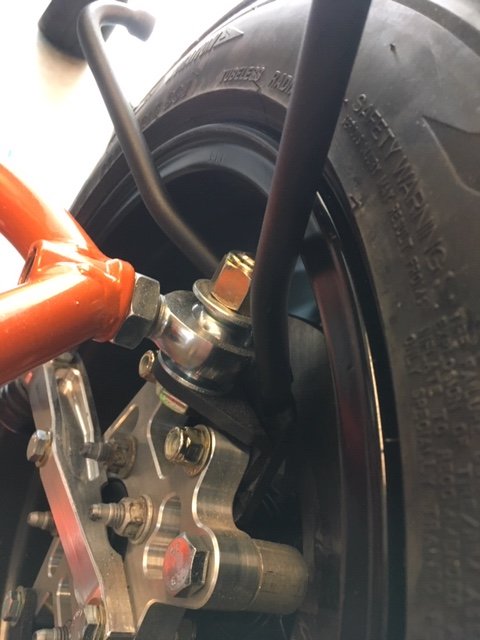

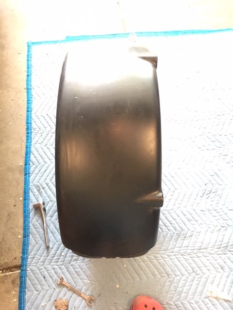

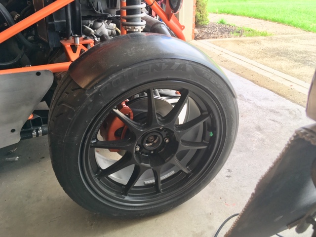

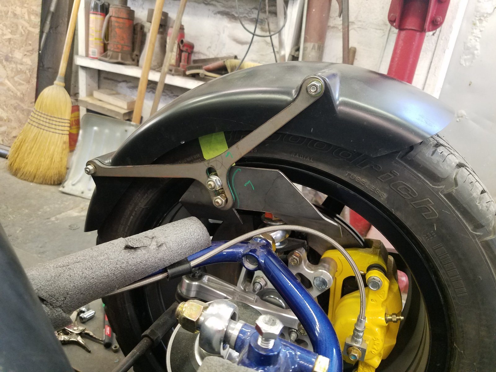

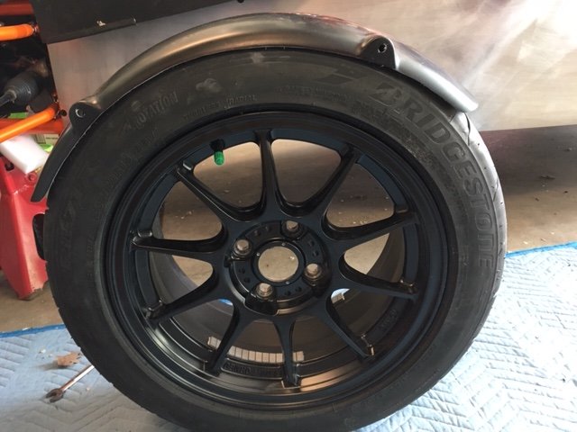

I just got all my body panels fitted in place yesterday and moved onto trimming out my fenders this morning. I put on the front fender mounting bracket and I wanted to cry. The bracket is hitting my wheels even with 3/16" spacer between the rotor and rim. It is also about an inch to high. My wheels are Konig Dekagram 15 x 7.5 ET-35 with 205/50R15 tires. The fenders look so good trimmed down sitting on the tires - I don't want to walk away from them. HELP!
I think we are going to have to redesign or fender mounts. It looks like we may have to have more than one style.
Karter2026
I heated my brackets and reshaped them to clear. Time consuming

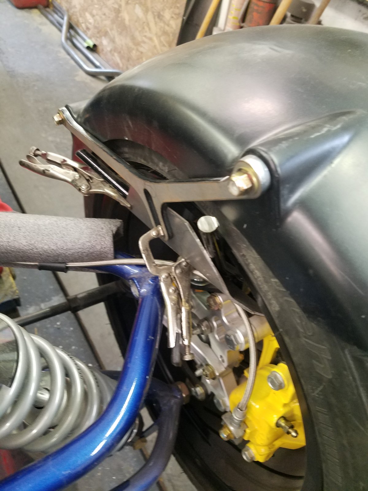

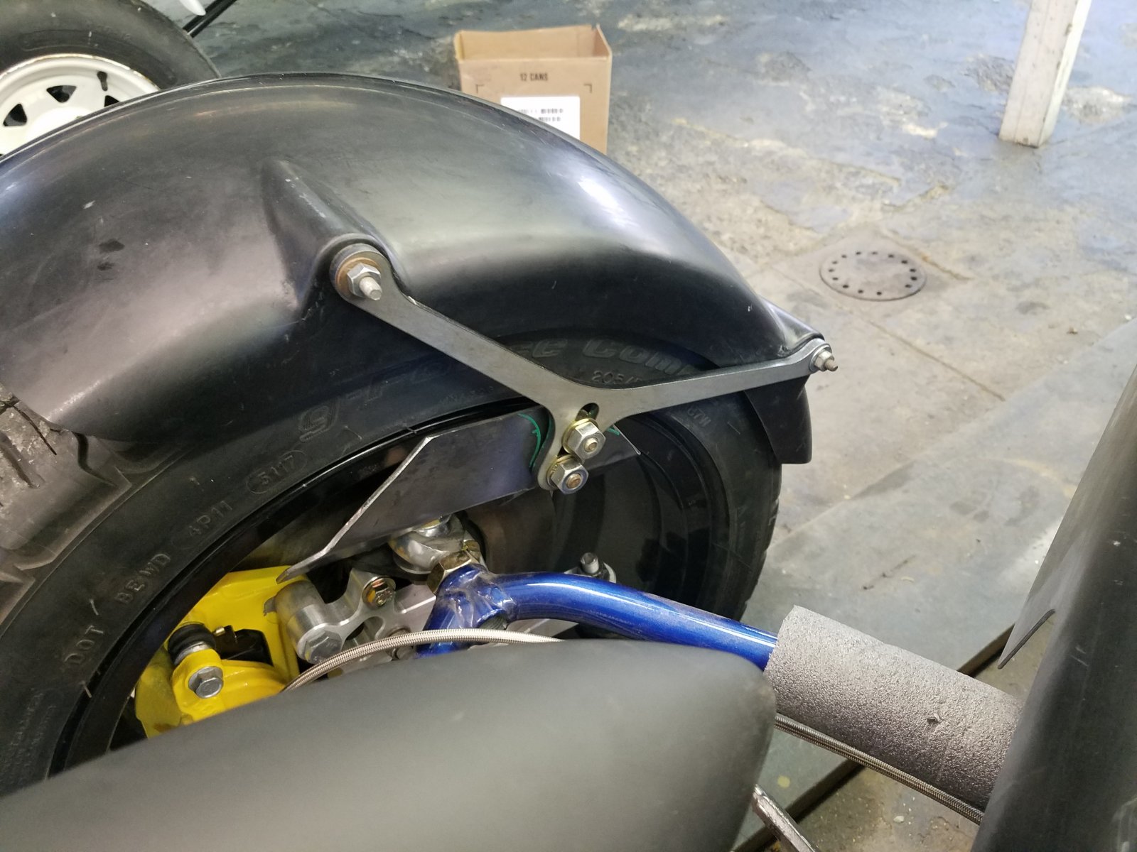

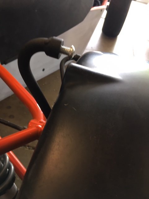

I did the same thing. I still did not like them then I cut them up and did something different. I used a rear fender mount for the coilovers. The picture is not the finished products these were mock up. For some reason I never took a pic of the finished product. I have a good bit of adjustment for tire height also.
