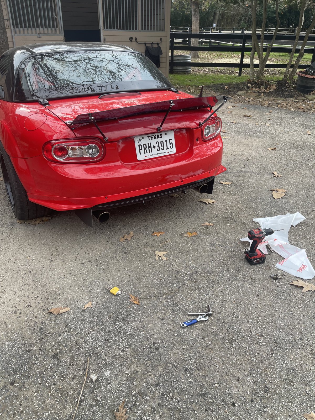

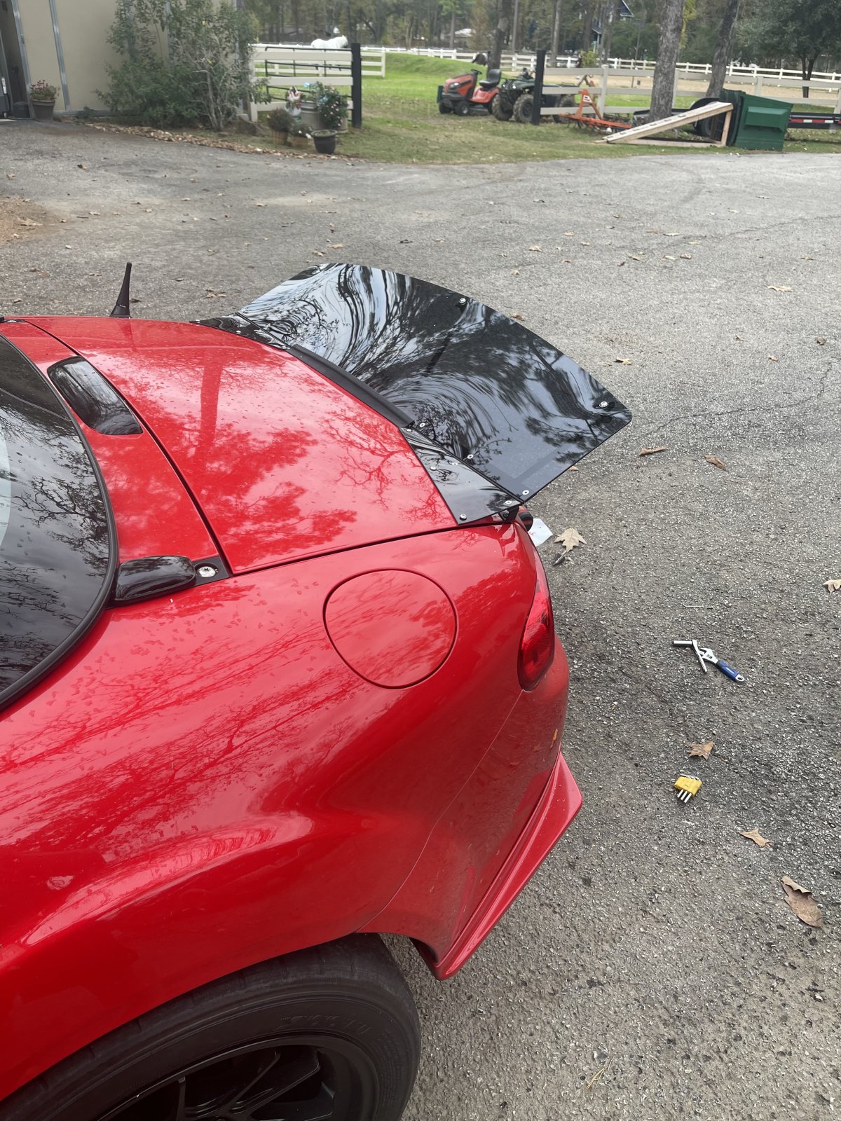

So no speed holes, but a new spoiler today!

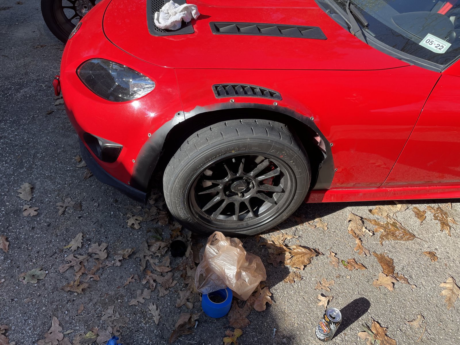

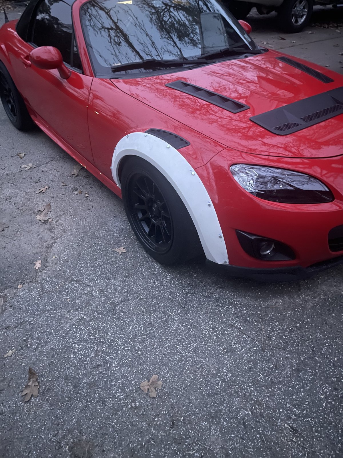

3 of the 4 flares are mostly on, almost time to cut the body up

Front will be quick, the rear will be like a brutal torture, lots of small cuts, beating it like it owes me money and then burning it with my welder

I spray painted them real quick just because I couldn’t stand the white. SO MUCH BETTER

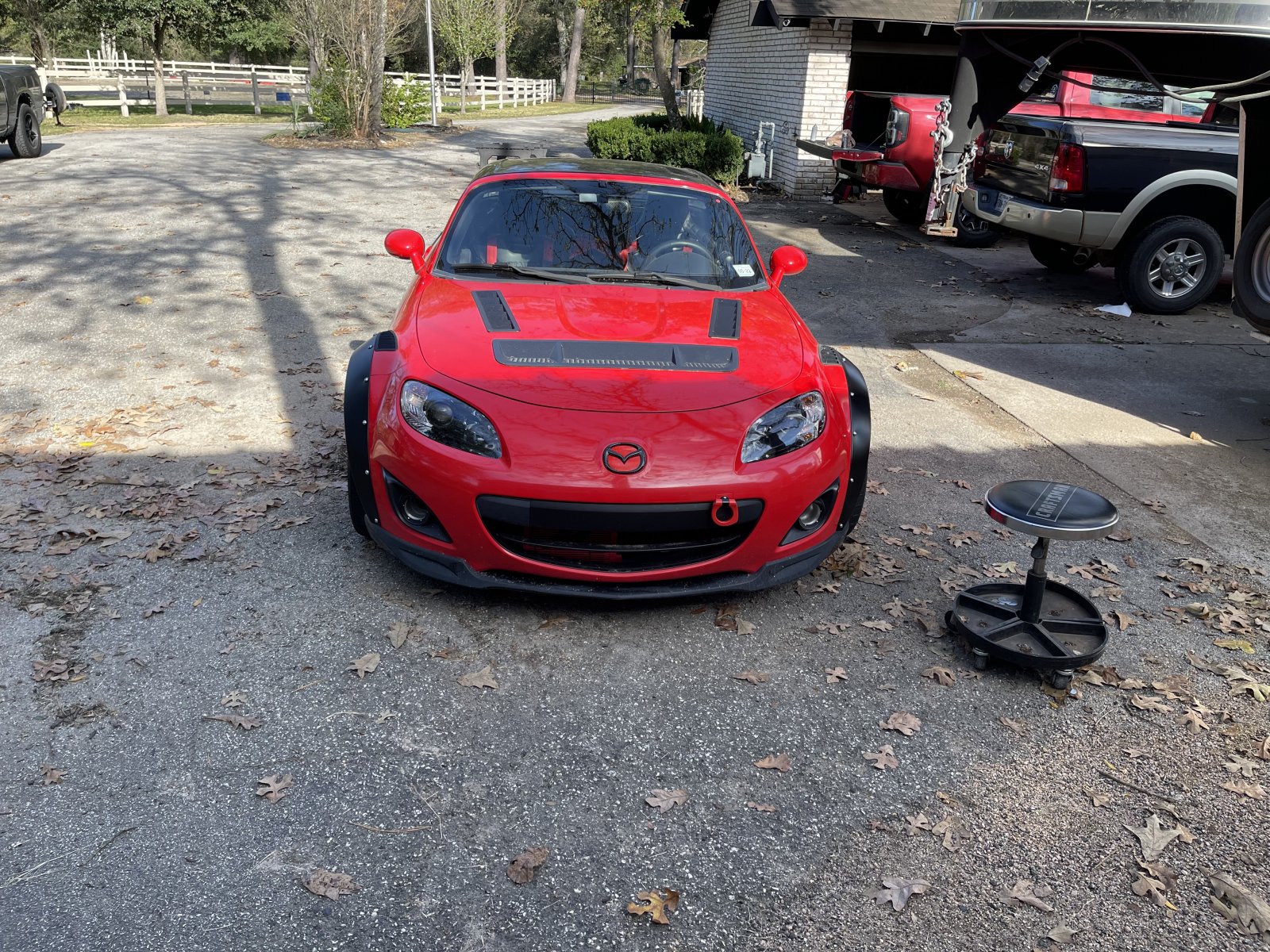

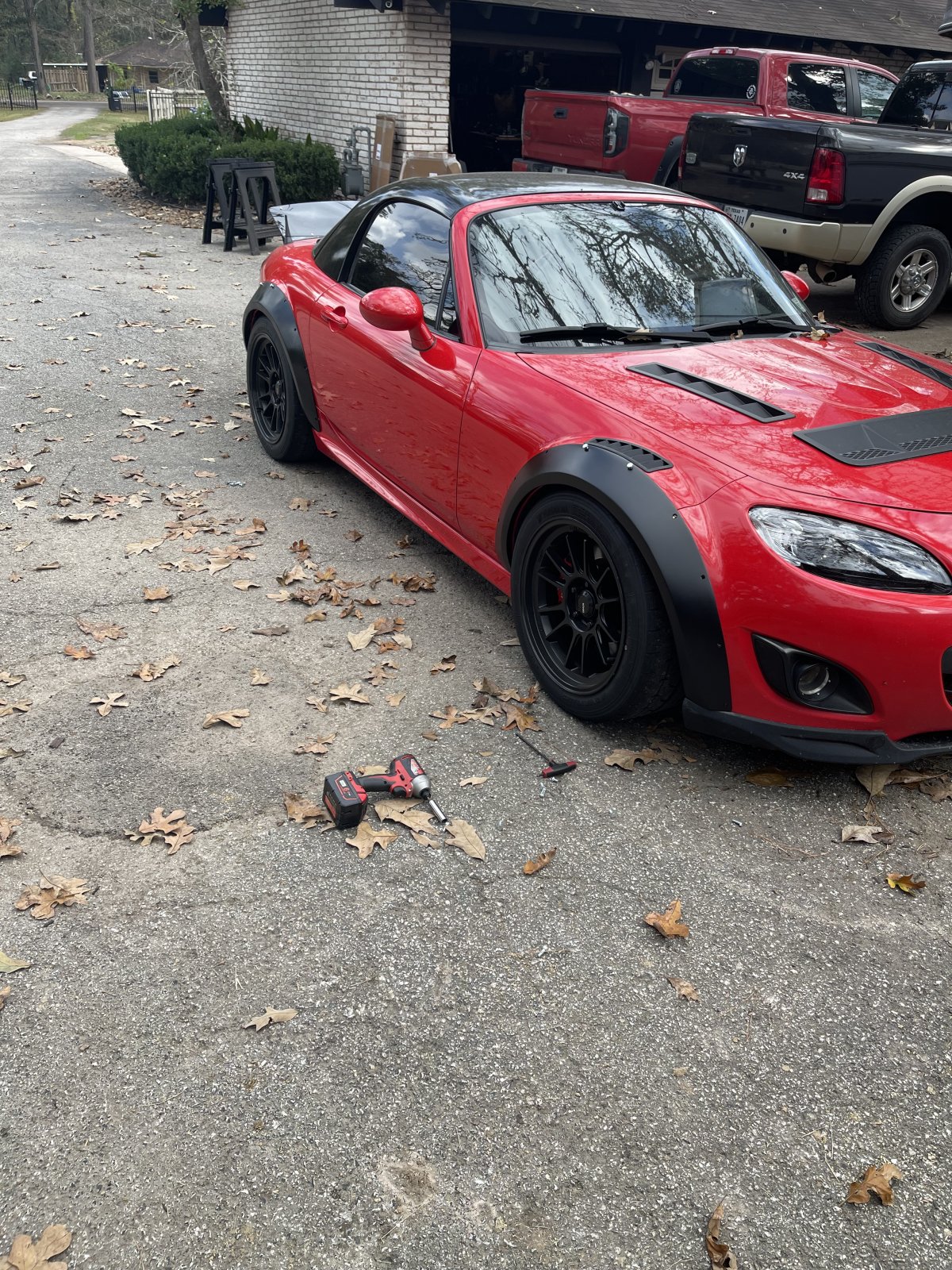

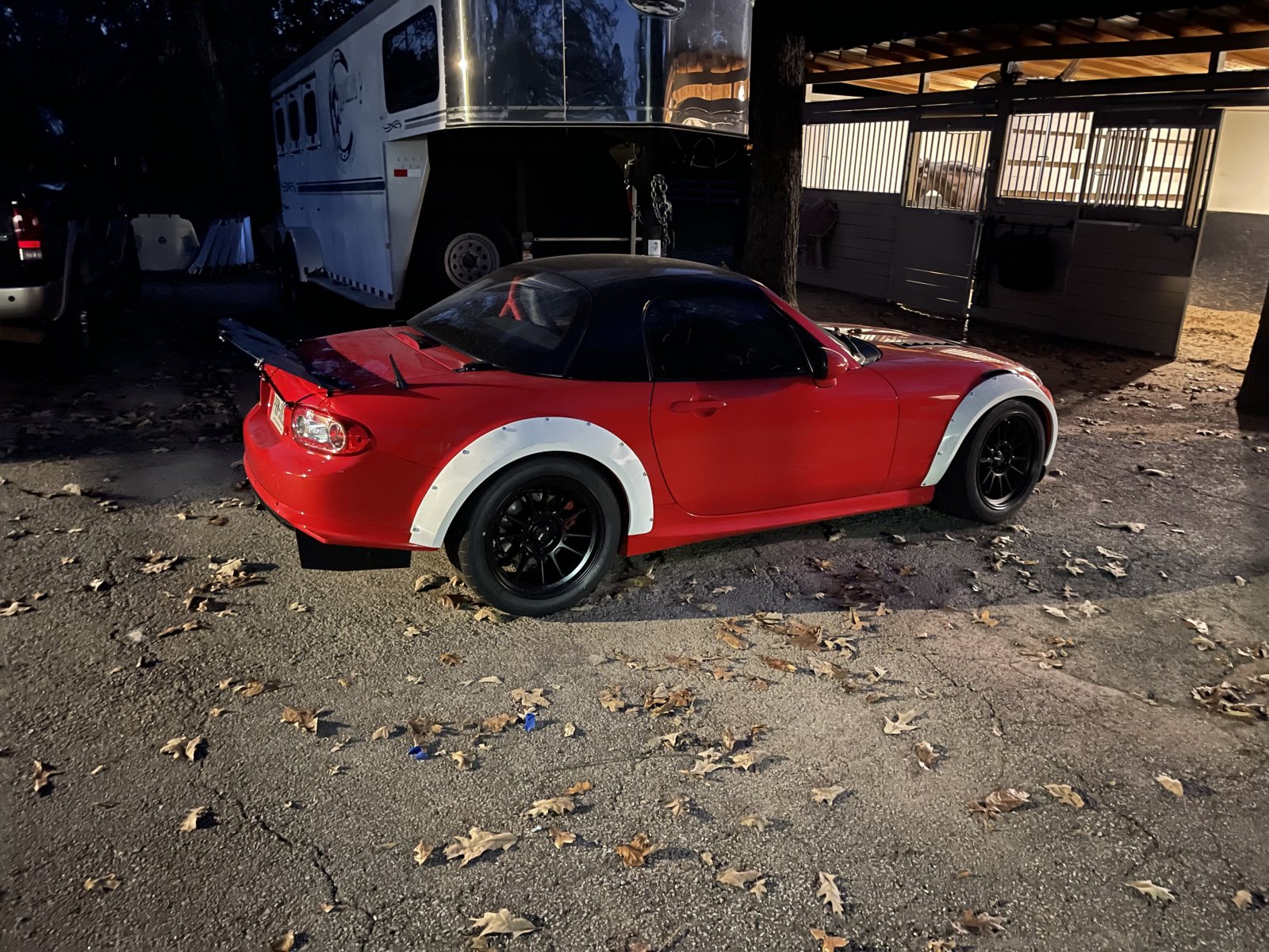

Today I cut the front fenders and painted the other front fender flare, I was sick of looking at the white. I will eventually take them back off, smooth them out and wrap them, but this will do for now

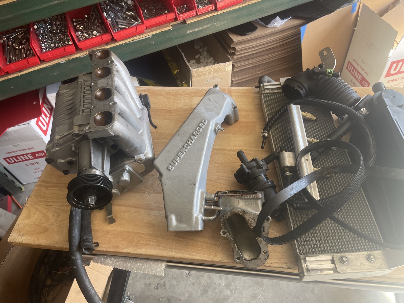

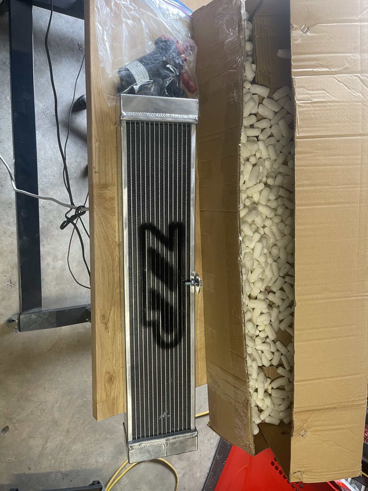

BUT! I did buy some ecotec parts for my Miata!
ZZP heat exchanger and red top pump. This heat exchanger is massively larger than the one that comes with the super charger I am getting. I am also toying with the idea of taking an ecotec TVS1320 and cutting it up to fit on my Miata.
My car is going in to have the old roll bar and convertible top removed from my car and the new bigger roll bar will go in, I will also pull the ITB’s and slap the supercharger on at the same time. I am hoping all of this is done before the February Auto X, but I doubt it.

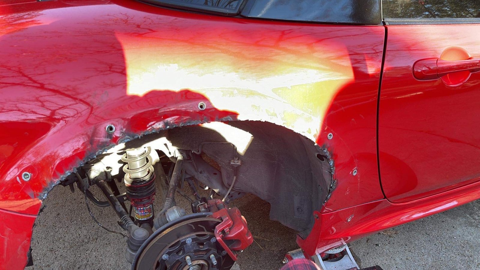

I finally spent the time finishing cutting up my car. I had to cut away the pinch welds up front and welding them back up, and then cutting away the rear fenders and I stitched welded them for now. I was afraid of burning all the paint away.
I can finally drive my car with out scraping

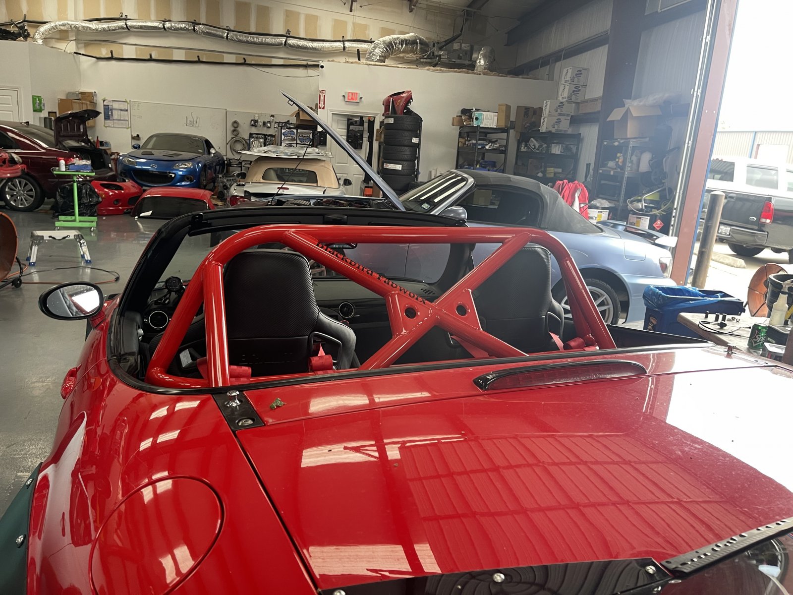

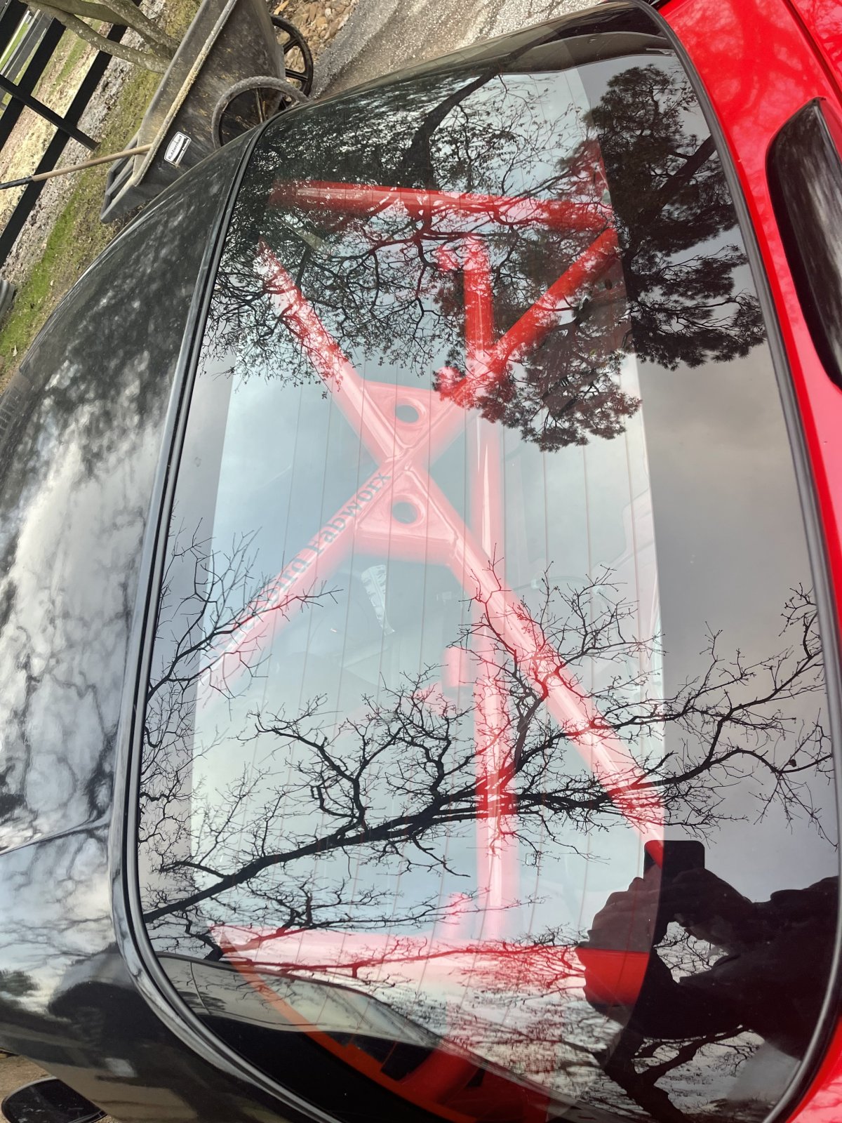

The new roll bar went in and the convertible top is GONE!! Driving it home it felt peppier, I knew it would lose some weight, but I was surprised I noticed it
also, a picture of why I don’t tint my rear window.
Tomorrow I need to adjust my coilovers and get my alignment redone, after that, I will be back to full operation for the February AutoX assuming weather behaves
