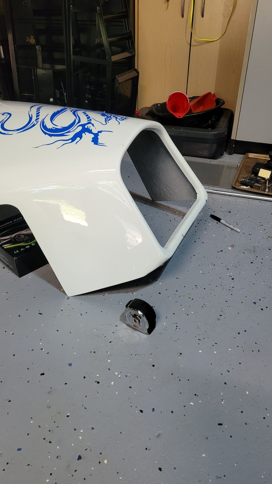

Front radiator screen
Davidljones88
Davidljones88

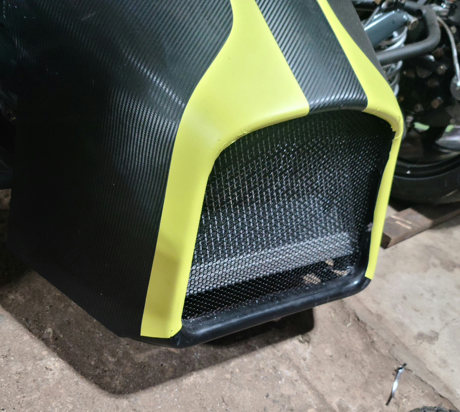

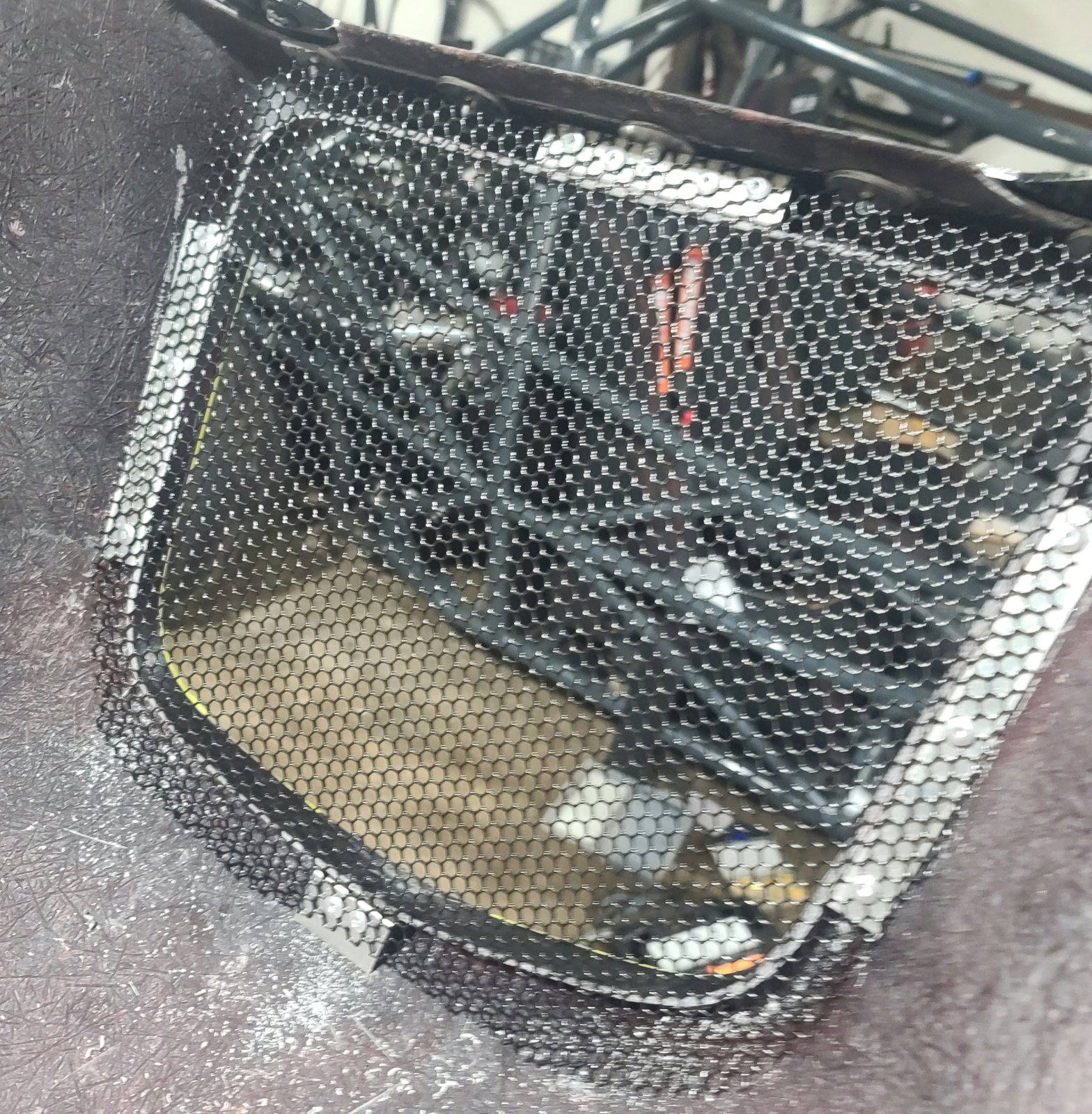

Ideas on how to attach the screen?

Mahkoi
I used black rivets for attaching brackets to the hood so they didn't stand out. Not sure what your options are for making them blend in if you care. I guess you could hit the rivets with white paint before installing them if you wanted.

Does anyone happen to have specs on the opening of the the hood? I’m working on getting something made but need the specs of the opening.
I've never seen anyone post anything like a detailed dimensioned drawing that could be used to fab something up. Someone could probably get you rough dimensions to order materials, but most have just trimmed to fit.
Metal Mech
Yeah I had a feeling but I figured it couldn’t hurt to ask.
Most likely looks like I will just have to wait till I can get the specs myself. I do plan to post them up if no one else does in case others want the information. Unfortunately for how this is being done rough measurements won’t work.
escapepilot

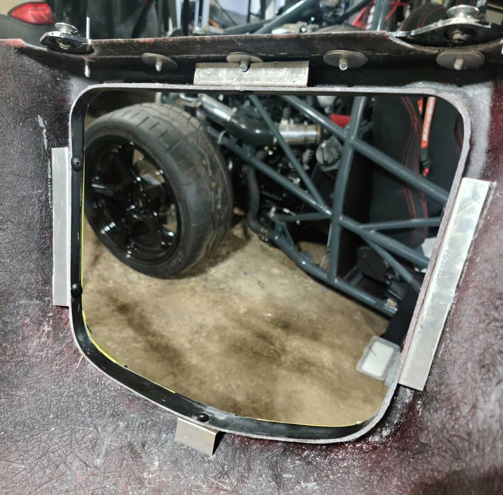

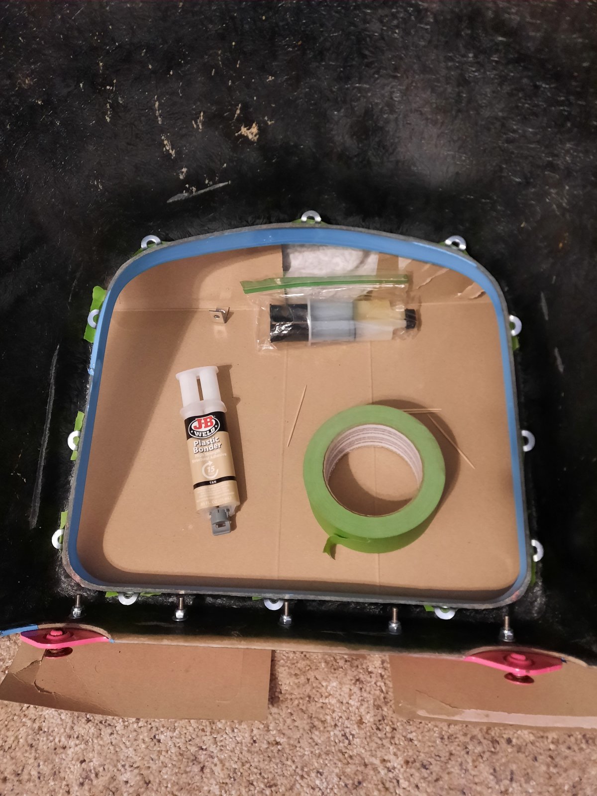

I used CAD (cardboard aided design) to make a pattern. It's fairly small so I'm sure it can be mailed rather inexpensively. Be aware that the inside of the opening isn't square to the front. If you use flat material, it will need some flexibility to sit against the lip.
The opening is not 100% symmetrical, plus there’s several ways to attach the screen, so no basically no 2 are alike.
