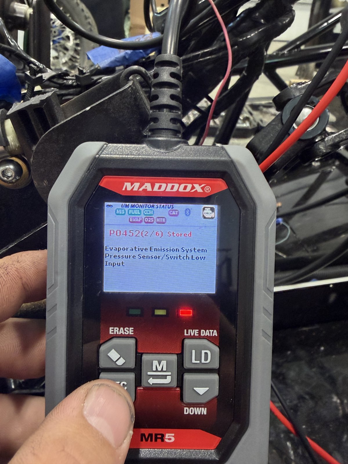

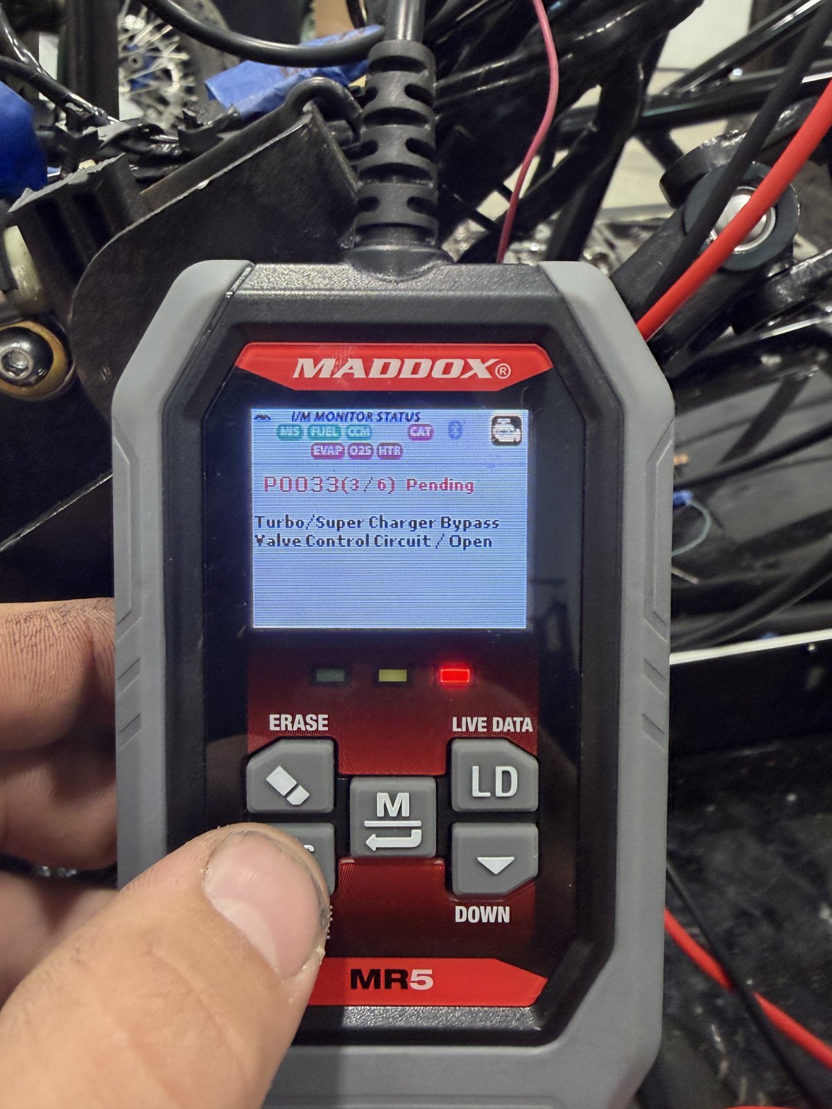

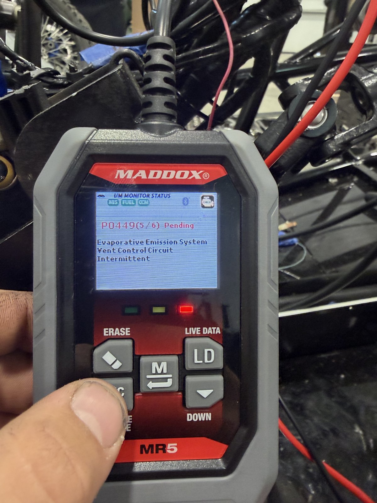

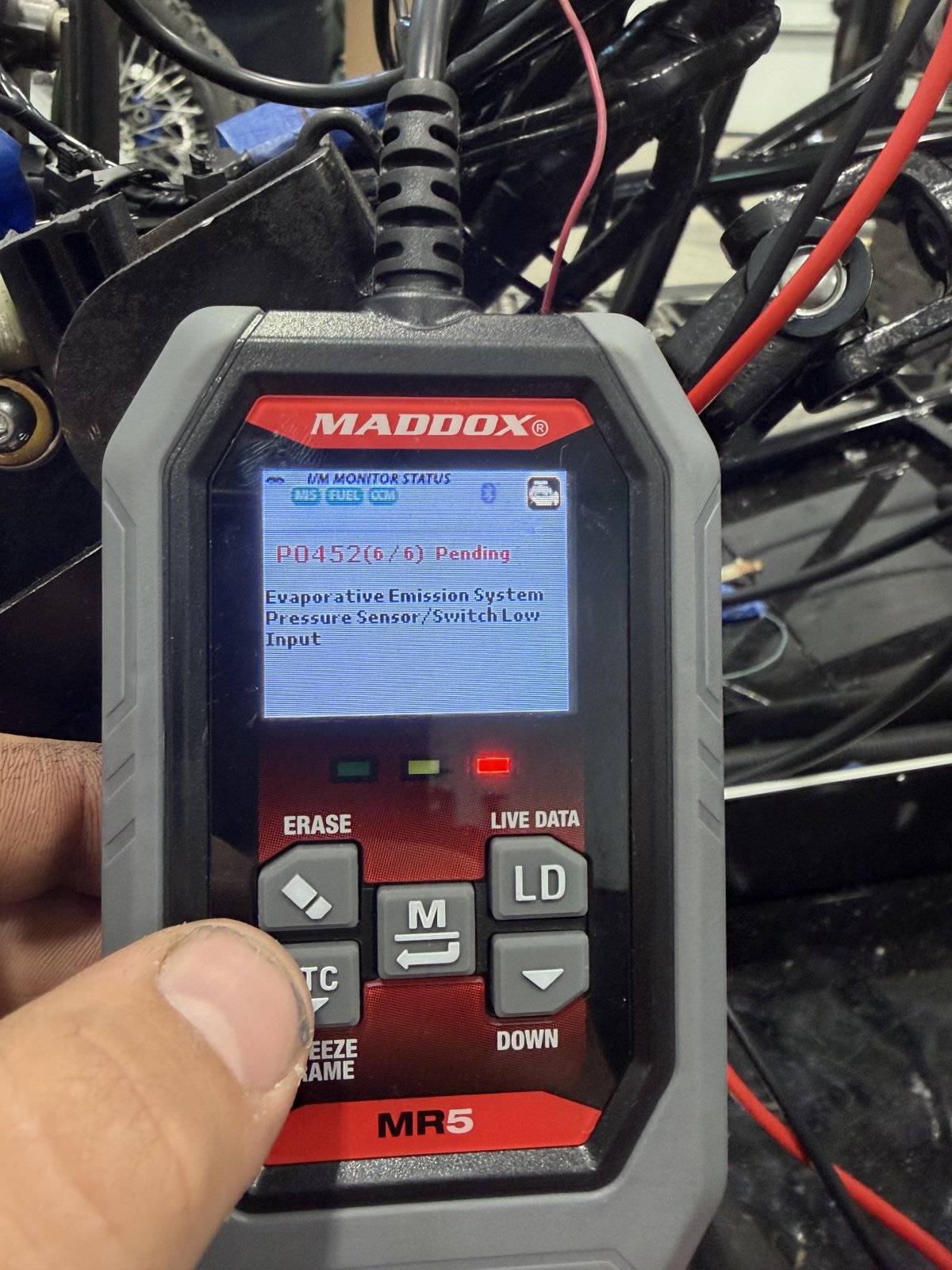

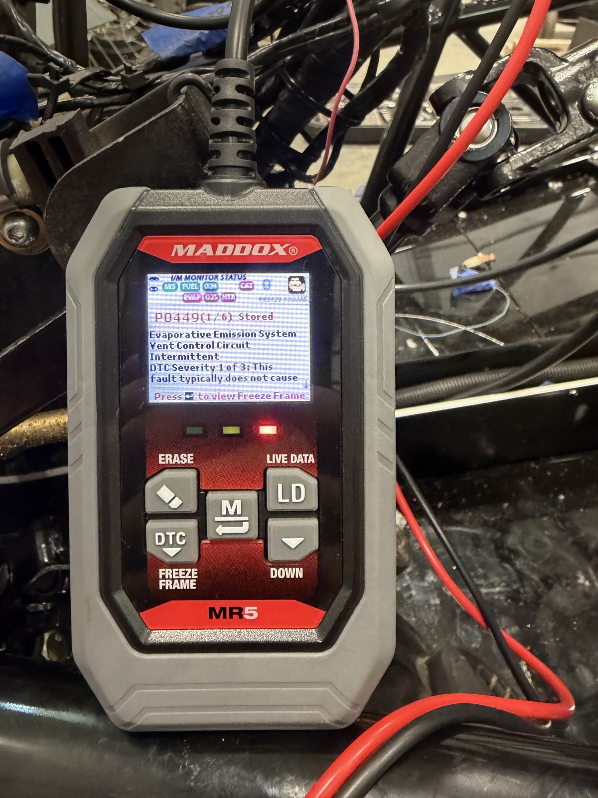

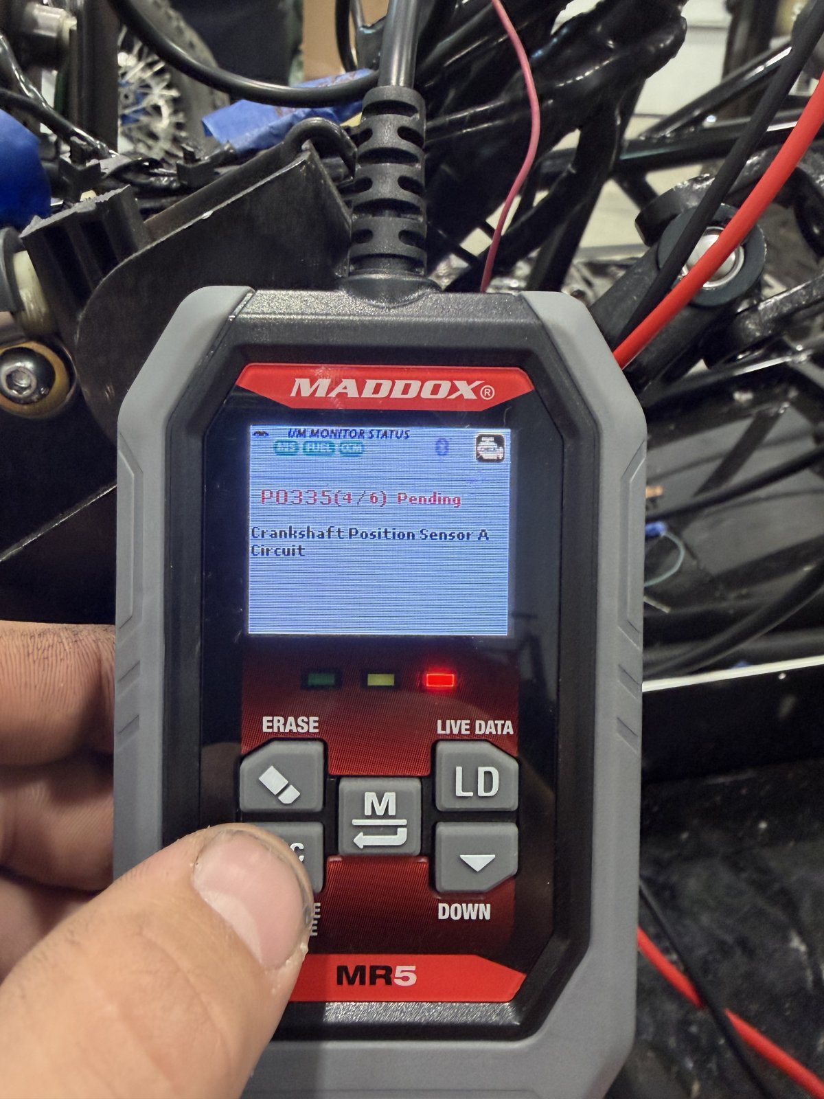

These are the faults codes I’m getting. Erase them and they come right back

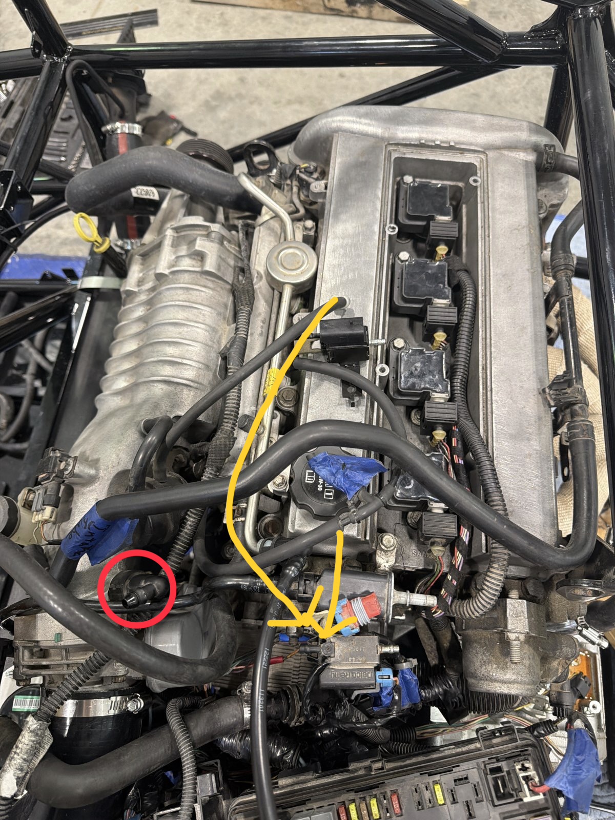

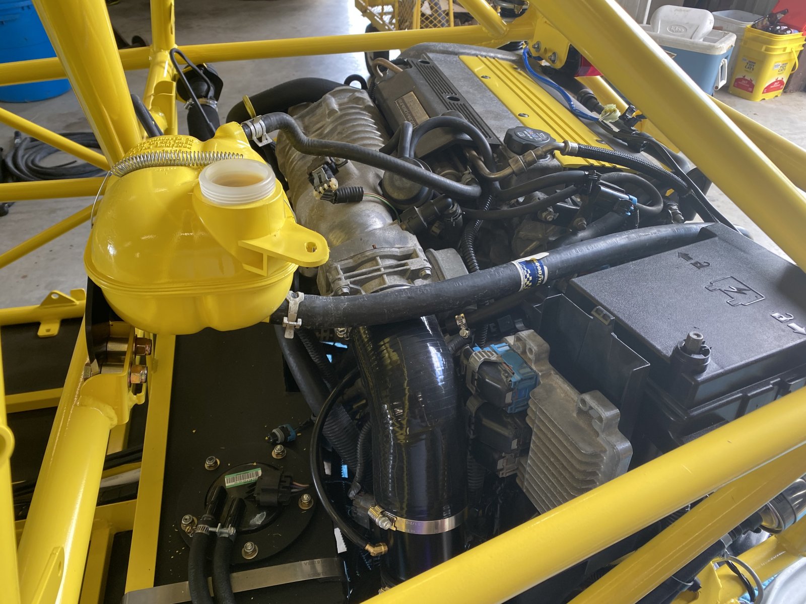

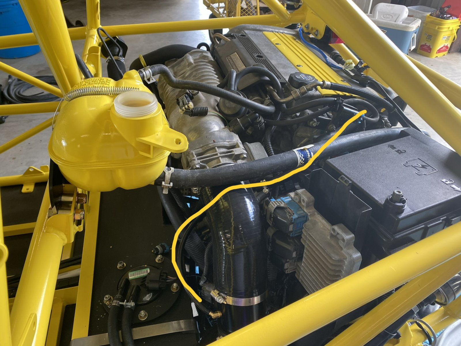

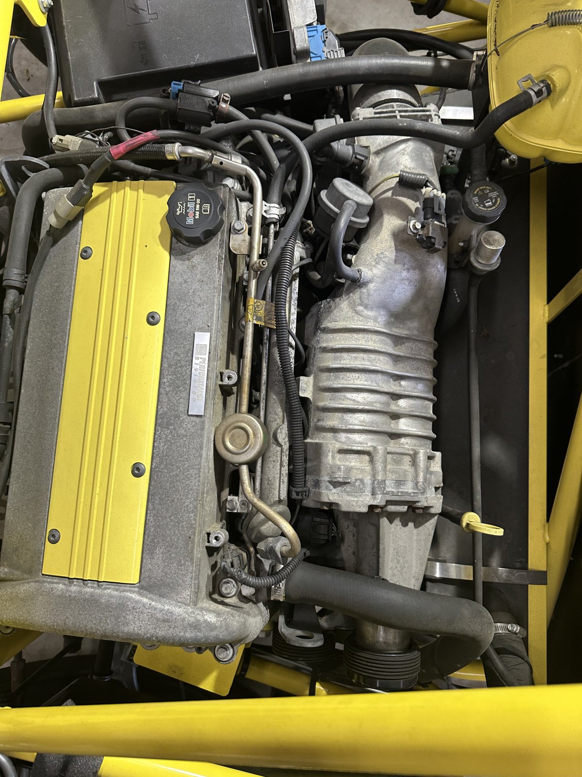

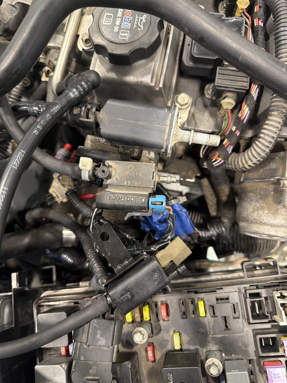

Getting lots of code for evaporative emission. I have lots of hoses and 1 red plug disconnected per video for supercharged engine. Can anyone help for the hoses missing there location's.
56966
56967
This problem seems more pressing than all those evap issues:
- P0335 Crankshaft position sensor A circuit
meaning the Powertrain Control Module (PCM) is not receiving a proper signal from the sensor. This is a critical issue because the crankshaft position sensor (CKP) is essential for timing fuel injection and ignition; without its signal, the engine typically will not start or will stall immediately.
I had an issue with my LSJ crankshaft position sensor wiring a while back. Might be worth a check. The following posts talk about reprogramming the CKP sensor.
YOU ARE THE MAN! Found the wires were barely hanging on. Soldered the wires for now and it started right up. I will have to get a new adapter. Still is running pretty rough idling up and down. Seems like it’s not running and all cylinders still.

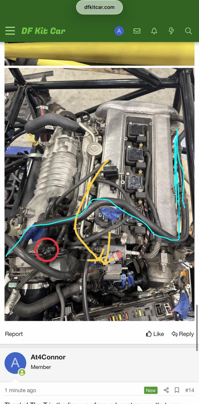

Red circle is a huge vac leak. That should be your brake booster connection. The other 2 go to the boost solenoid, but not sure why that one has a “T”.
56971
I put a small air breather on that exit from the head. It is part of the PCV system, I think it originally went to the intake plenum... somewhere near the throttle body? Just check you don't have any open holes on your intake. You don't want unfiltered air getting in, especially after the throttle body and MAF sensor.
