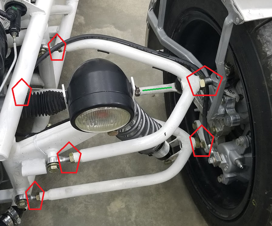

This weekend we tested Brad's 600 lb/in springs & shocks on my car, and changed the toe in. Still hops the front wheels under hard braking.
I was telling Lonny that I ran out of adjustment the first time I adjusted the toe in. The steering rack was too long, so I had to adjust my front suspension out farther. He suspects I put the wrong tie rod ends on the front. A quick inspection, and I have the long steering tie rod ends on the front, and the short ones on the rear... which is backwards.
So I hope that bringing the front suspension in closer to the frame will increase the front stability, and eliminate the hopping.
Fozda
Are we talking inner, outer, or both tie rod ends here? I believe we put the OEM in front and the supplied in the rear which, now that I think about it, doesn't make sense!
The tie rod end is about 1" shorter on the DF supplied ones (black) vs the Cobalt ones (white)
14854
14853
So I (mistakenly) added a 1/2" extra threads at all 6 of the swing arm's heim joints.
I should have moved the white tie rod ends to the rear of the car.
14851
Hmm, interesting that an extra 1/2 inch of exposed threading on the heim joints would allow the flexing of the a-arms to cause the hopping you're experiencing. Wonder if the overall length is at the 'harmonic' length for the arm tube to wall thickness ratio? Kinda like a tuning fork when the right combination is achieved and sufficient energy is applied, like hard braking. :rolleyes:
So far, it is a hypothesis, but a likely one, as most Goblins don't have this issue, so it is something that I have done differently.
