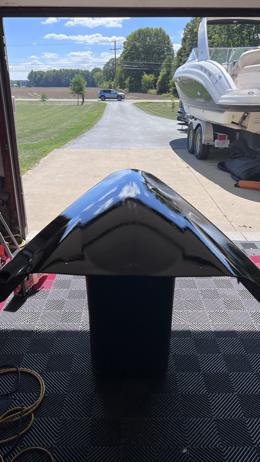

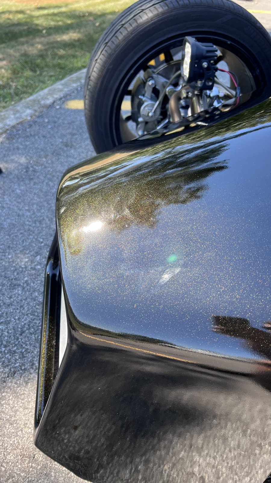

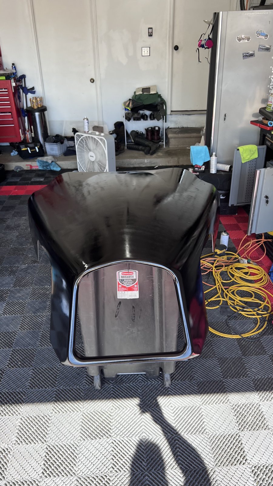

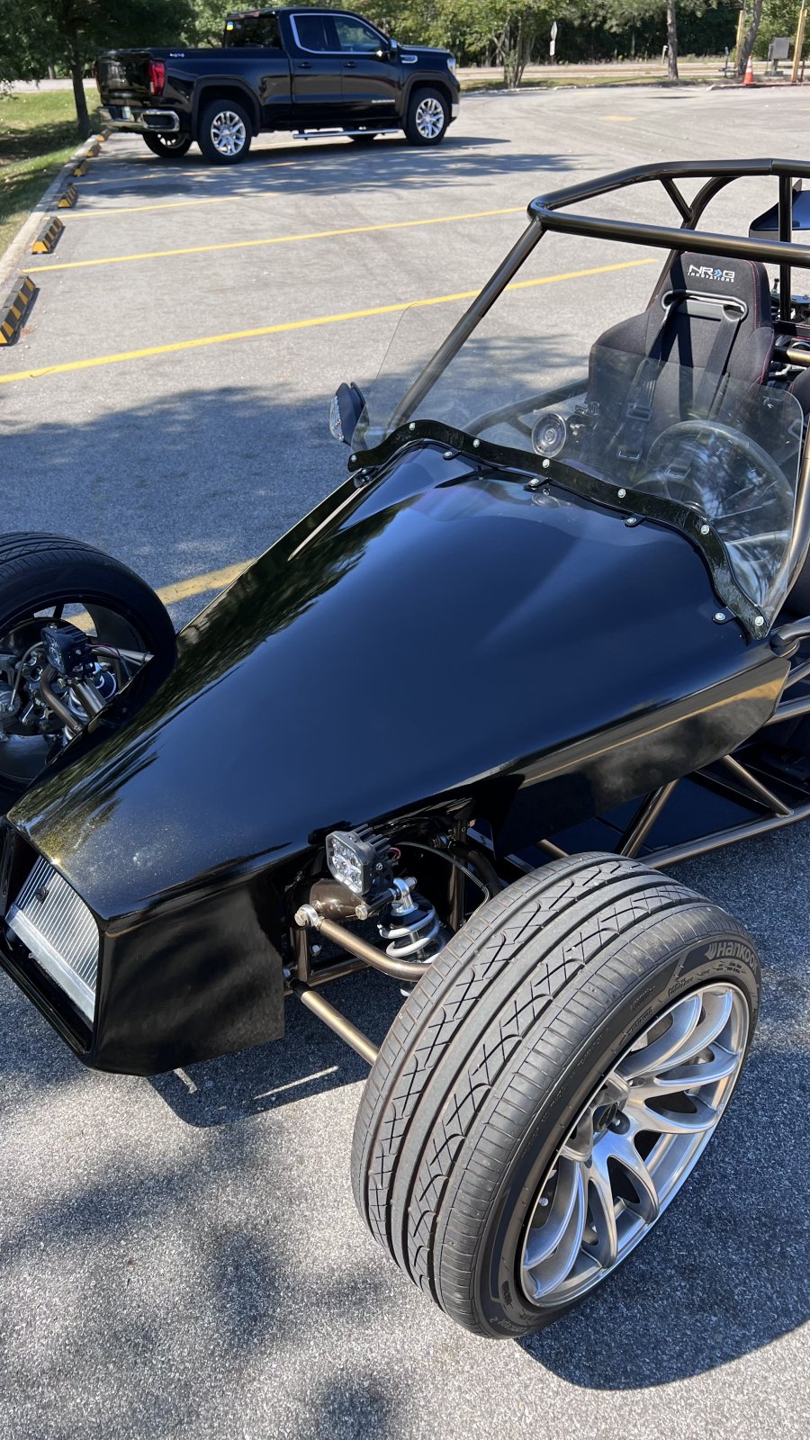

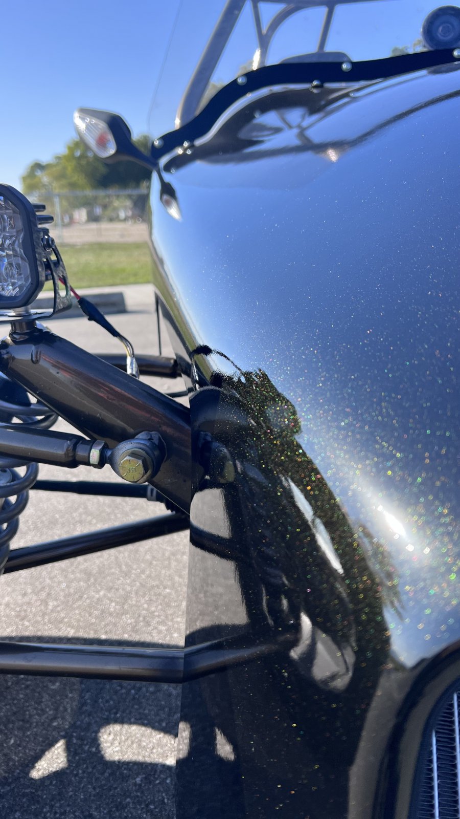

Mmmmm hood looking good….

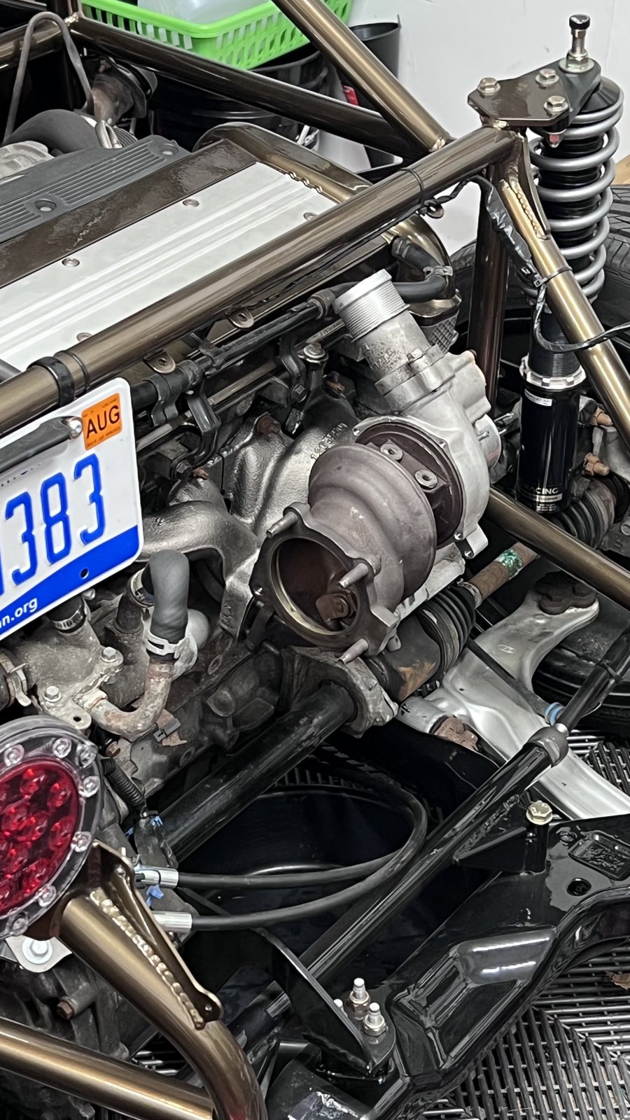

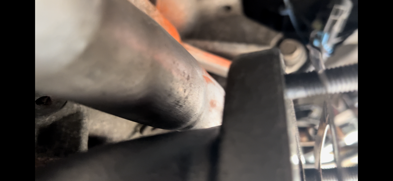

I was mocking things up for that picture, the coolant crossover must have been replaced at some point. I thought the k04 setup wouldn’t bolt on a LSJ.
Ghostknife
K04 blowing into the supercharger - haven't seen one of those yet on the forum. Should be good for at least 36 lbs of boost - wonder what kind of HP that would produce?
If that were to happen, The K04 would be too small I think. You would want a turbo on the larger side to compensate at higher RPMs when the the SC starts to fall off. The pulley on the snout would need a clutch of some sort so when the turbo lights off you wont over spin the supercharger by pushing through it. Then there is the tuning aspect..... Just easier to go all turbo lol
