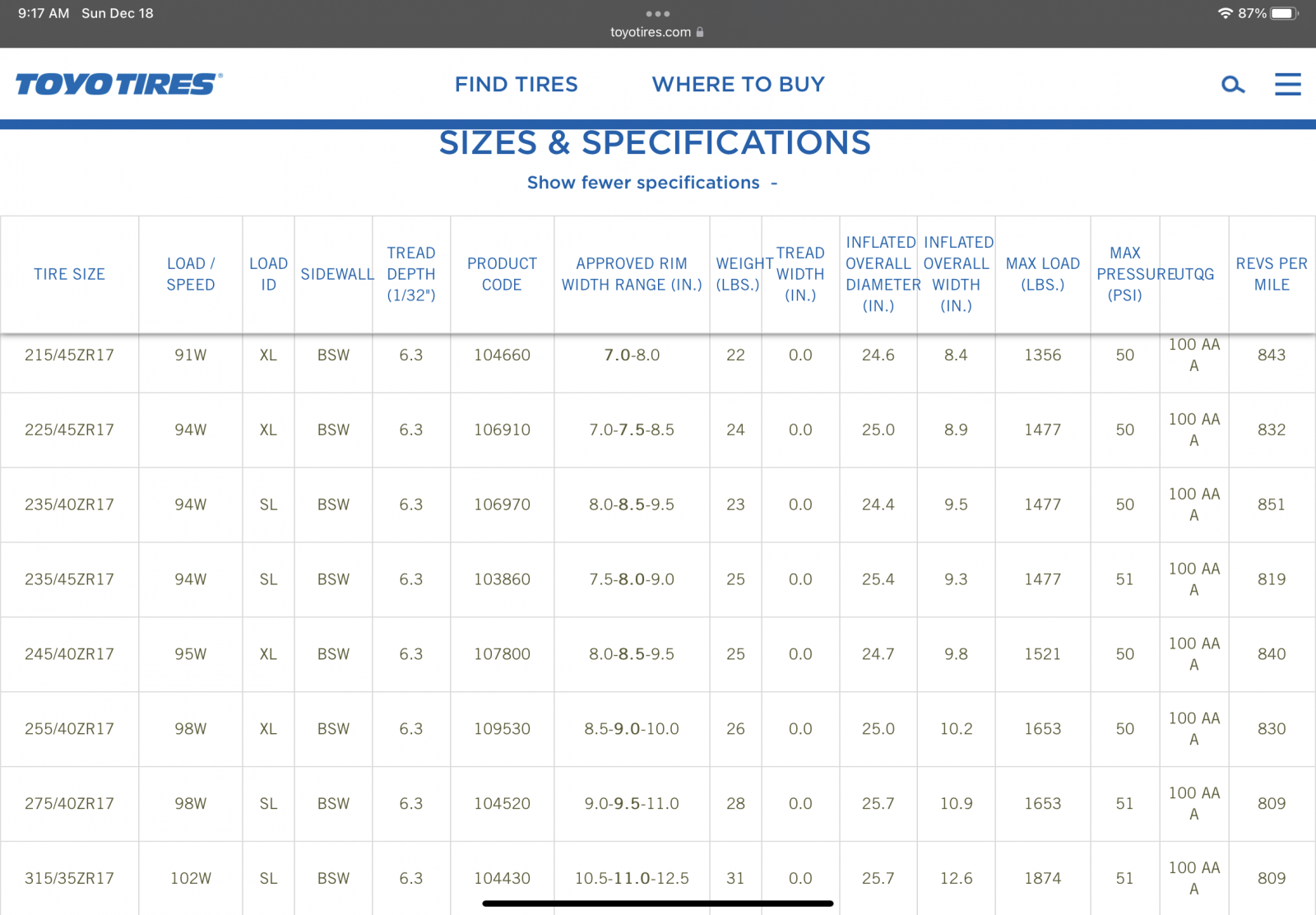

9“ is a good width. You can stretch on a 225 if need be, but it’s a perfect fit for 245 or 255 and still accessible for a 275. I run 245’s on the front and 275 rears on 17x9 wheels. absolutely love them.
Toyo is good at putting the recommended wheel width with their tires, to give you an idea what sizes will work best.

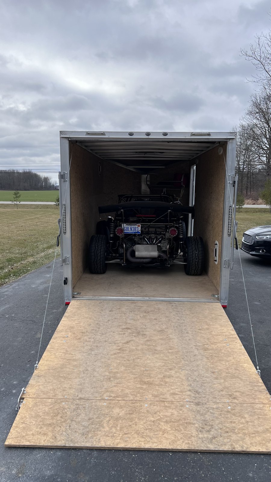

Yep. I’ll be looking for a small one this year too. The door will be the biggest issue.
I love my open aluminum trailer for local towing but across the country in the salt, I wanted enclosed. Nice to try it out before i buy one, I need an extra height trailer for the SxS as well.

yep. I have an open trailer I used for my Rzr back in the day. It works well for autocross, track and such, but I’d like an enclosed trailer for bad weather and such, but not have to put it in the travel trailer/toy hauler. Plus with a simple enclosed, I can add an ac and run a generator To keep cool at autocross.

That sounds like a plan! Trailers seem so expensive right now unfortunately (along with everything else)

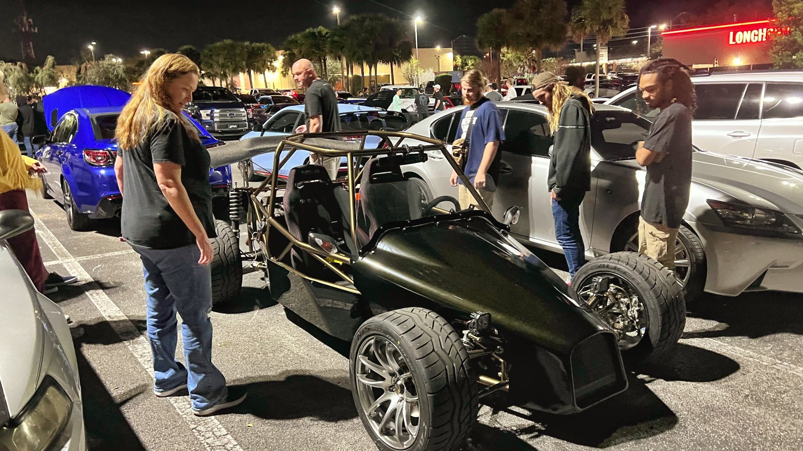

Snappin necks - you took a few people for a test drive?!? Wonder if anyone knew what a Goblin was before you told them? Or if all but the most exotic cars at the show would be left in the dust? :p:cool:
REMEMBER, Be very vague about how much it cost! If you mention you are driving "a cheap ass $30,000. car" to "their car show" folks will avoid you like the plague! You're from Michigan, kinda from "Detroit"(St. Clair/ Detroit, Same/same, right?), so, claim you built it in your "off hours"(cough: from a kit) and you can't discuss what you do at "work", and you could build them one much like it for, uhh, mebbe about $69K. These folks spent more on their last ski weekend to Gstaadt(it's in the Alps by the Matterhorn) than you spent for that car! Some folks just believe if it isn't very expensive (and they overpaid) then it's junk. Everyone KNOWS you can't build a fun, fast car out of a Chevy econobox, you'd have to start with a brand new Corvette. Let them dream.;)
GK, you can tell me, really, roughly what do you have in your Goblin? 22K? I haven't read your Build. 26K?(am I getting warmer or colder?) SNOBS can be fools! Take their money!{cue: Evil Laugh!}
