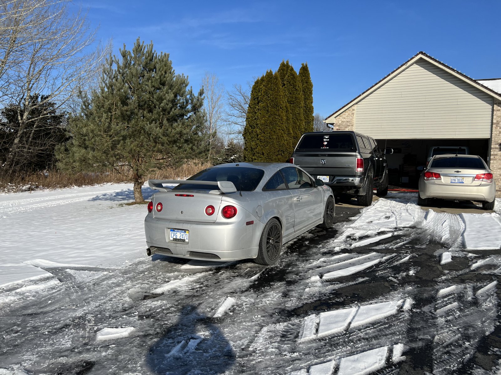

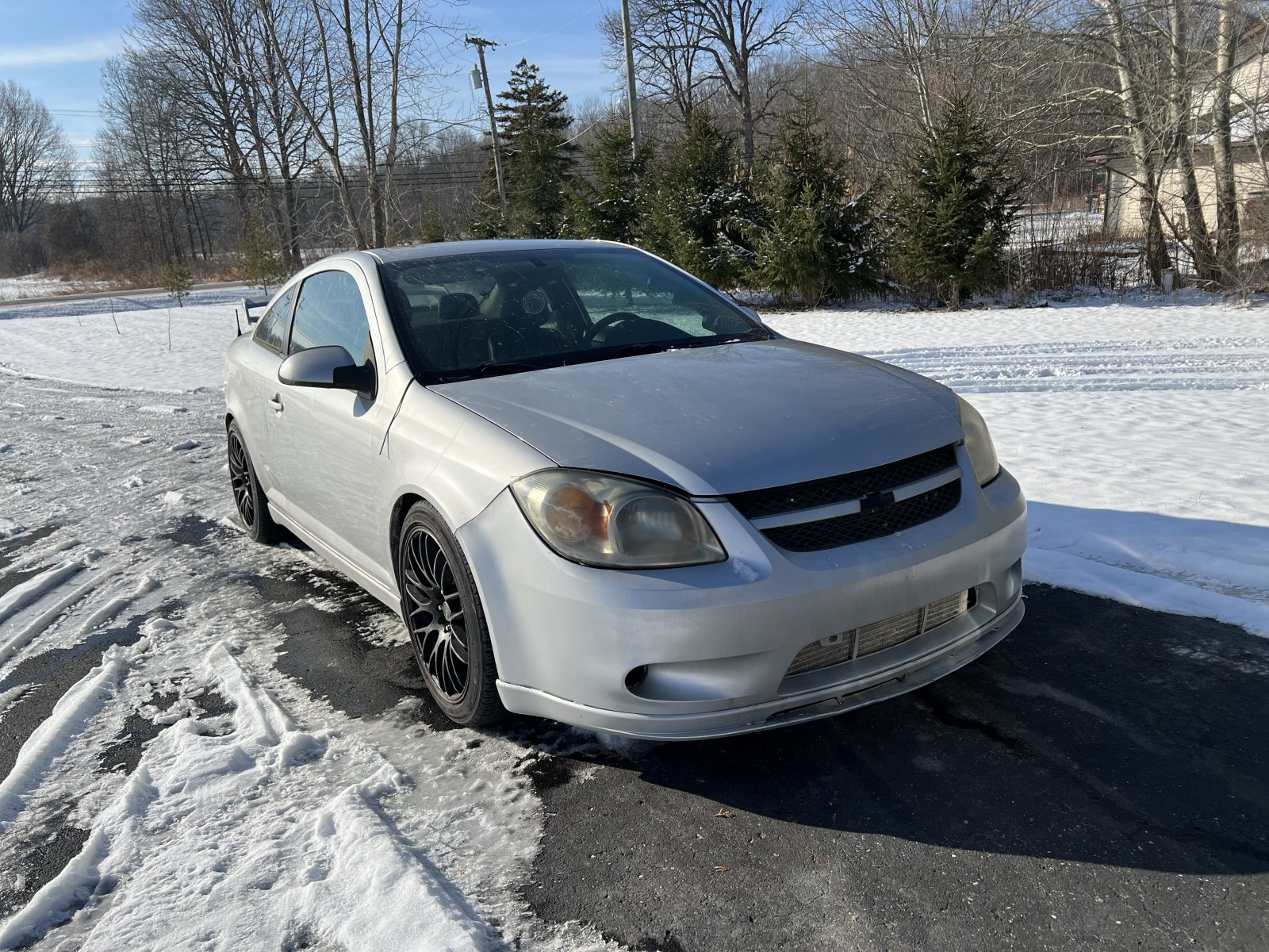

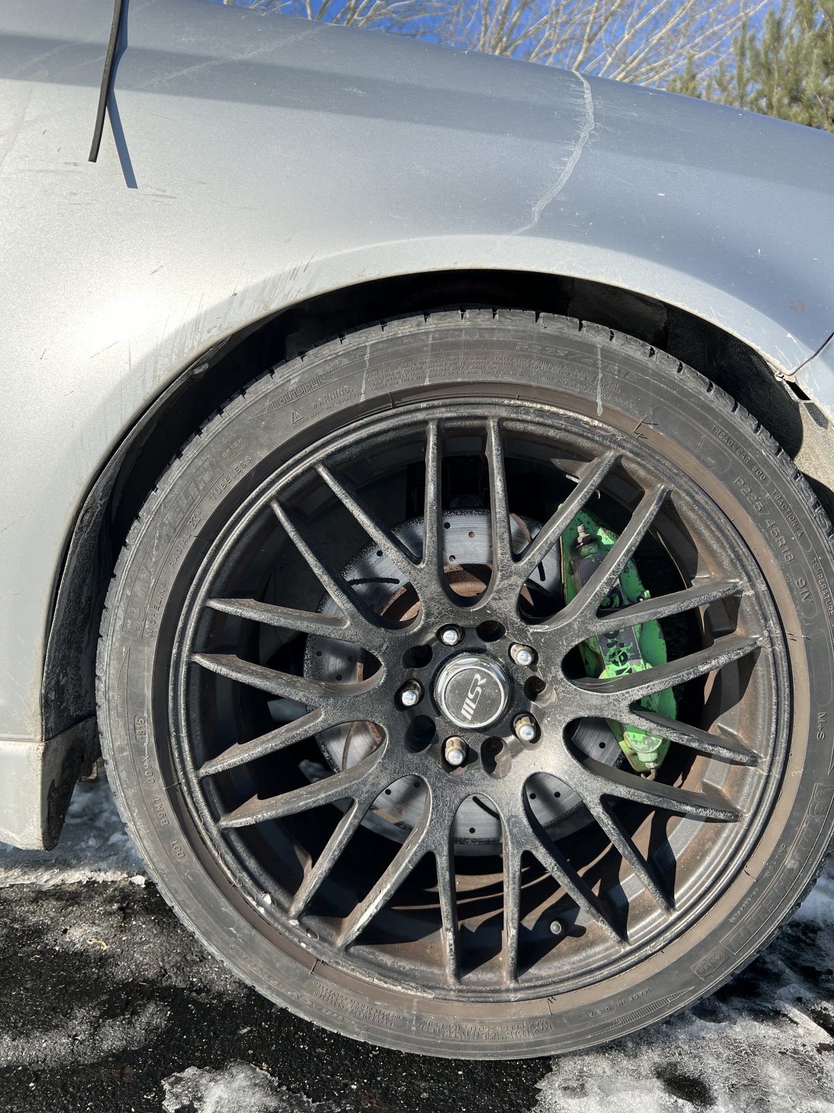

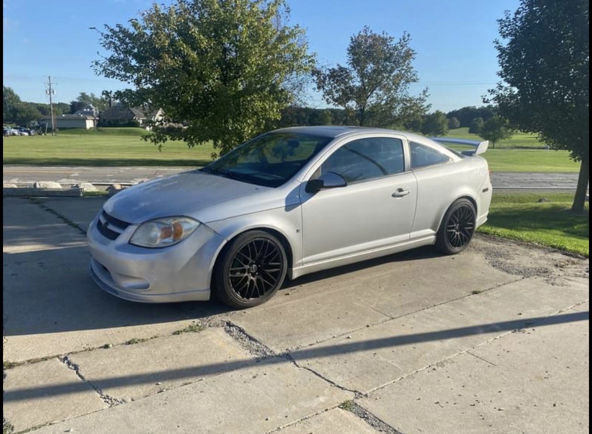

Today was a big leap forward, Picked up the donor car. Some issues but nothing too crazy as of yet. It ran and drove home. Engine supposedly has 80k on it and the body is at 107k looking under the hood it looks like there is some work, a zzp 2.8 pully and intake. It has a AEM wideband, and a aeroforce scan gauge that wasn’t working. It is however a G85 which is a nice surprise but no recaro seats.
Sounds like the previous owner was hitting the pick-a-part or Craigslist to put on some later model year upgrades. :D Those Brembos will fetch a fair price on the resale to help offset the donor cost.
Ghostknife
Perfect! Or I need to figure out how to put them on my Cruze lol. I’ll have to clean them up and sell em.

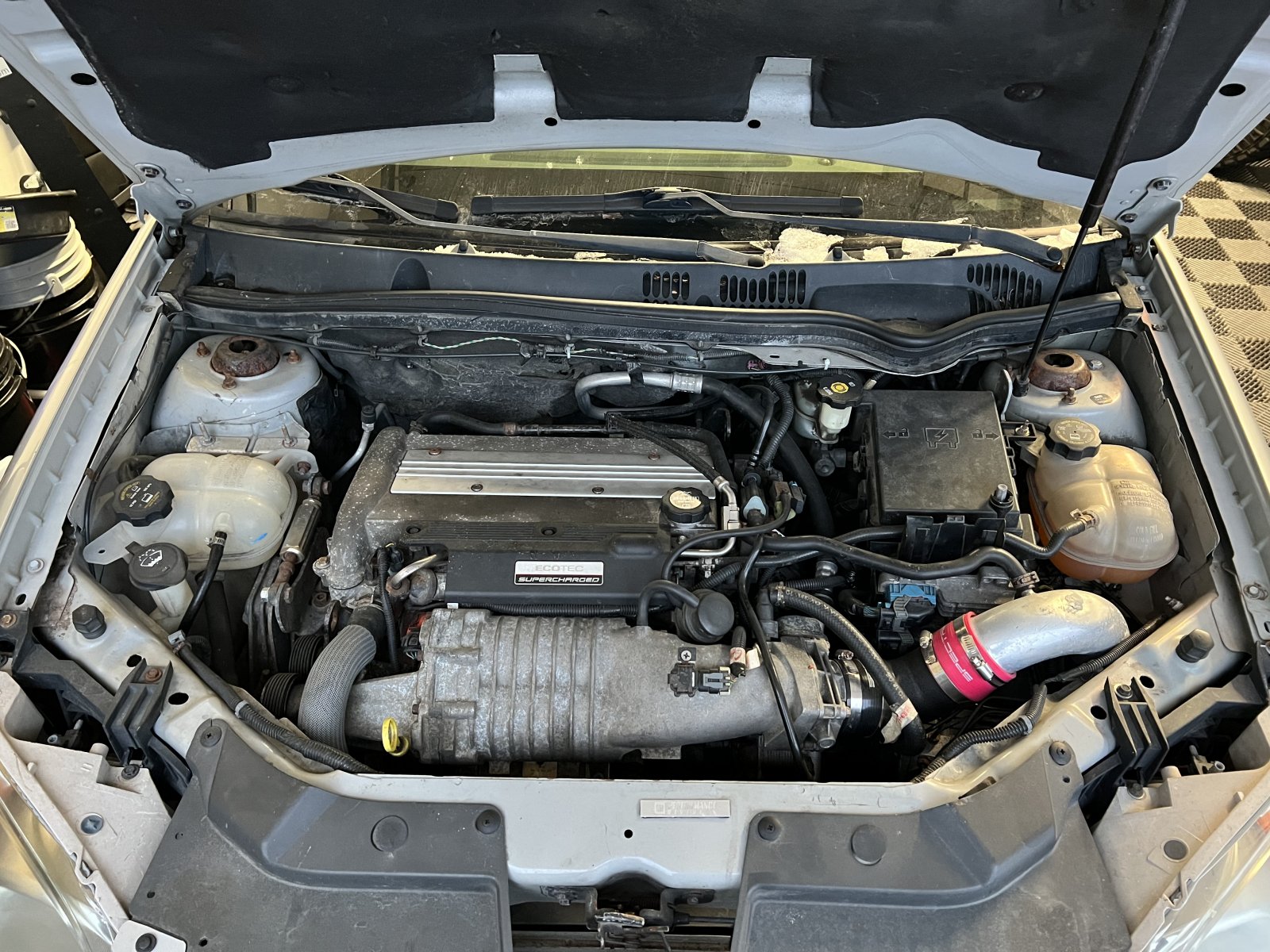

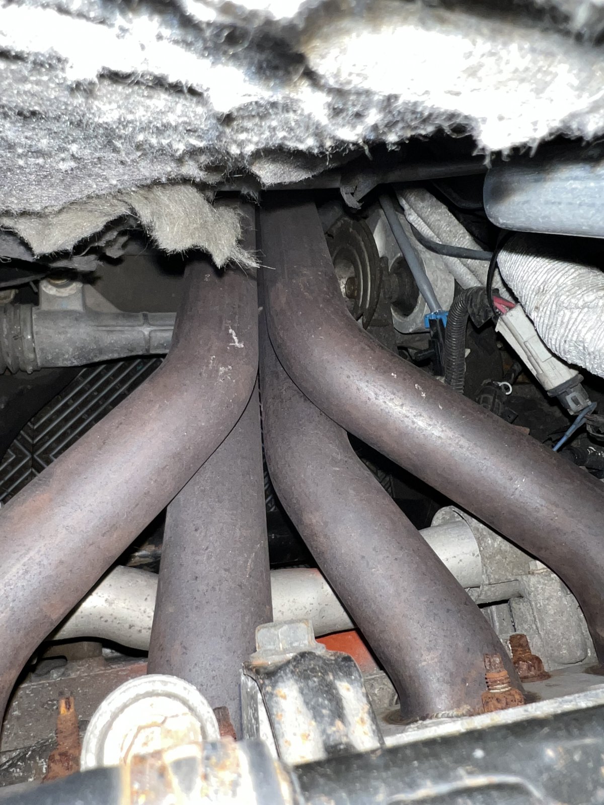

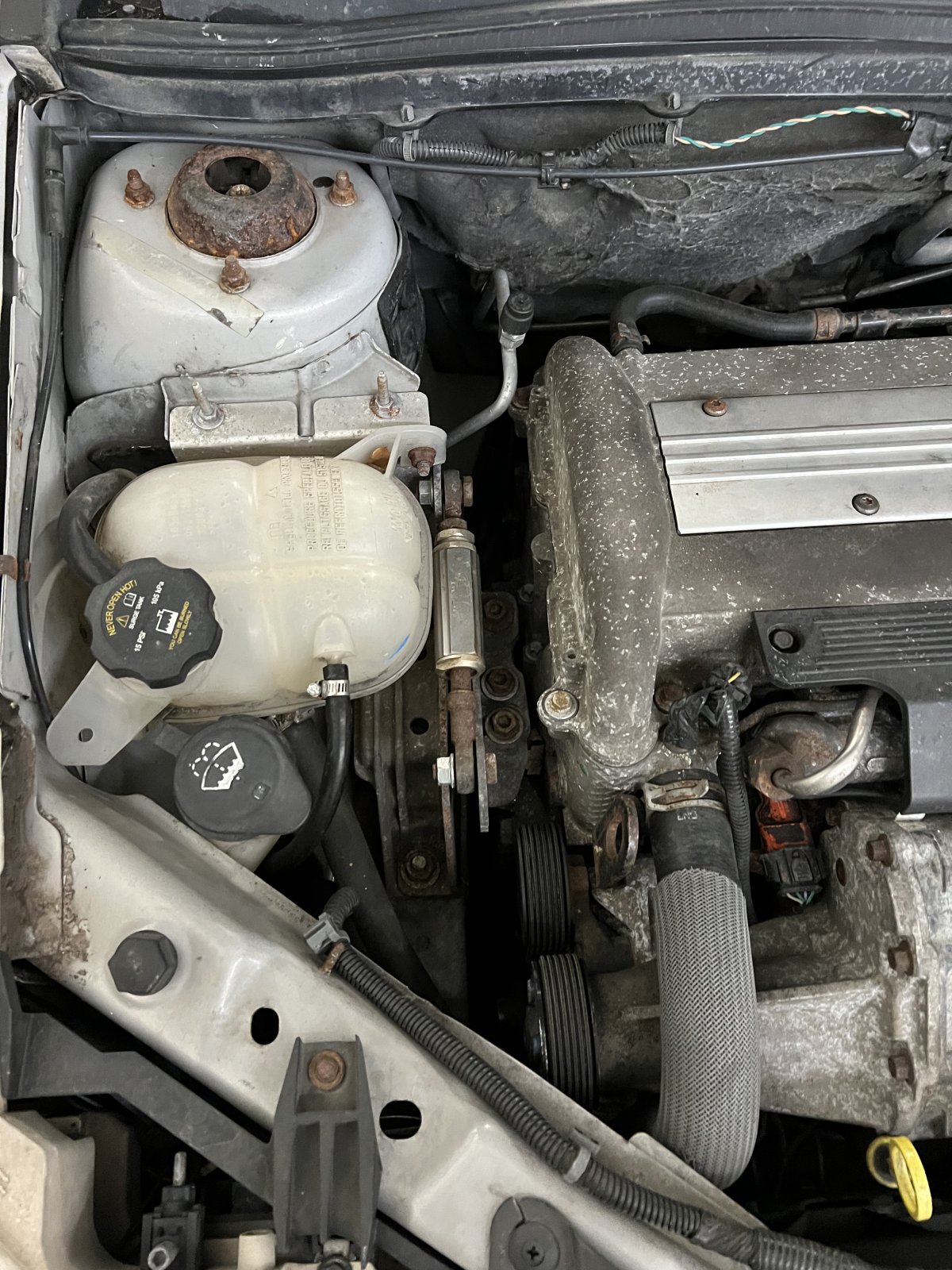

Ok, the fun is starting! The person I bought the car from didn’t know anything about the car, they bought it to be a project and it never took off. On the way home I got hit with the engine power reduced and was able to limp it to the house. Pulled the codes and had a P1133 and a P2135.
The ad stated it was a “stage 3” car and noticed there is a 2.8” pulley on the SC. In talks with ZZP, they stated:
“However a 2.8 pulley is a very aggressive pulley which would require our stage 3 kit, dual pass end plate, stage 2 cams and valve springs, header, 3” down pipe, 3” car back, and/or E85 fuel”
Of course I put 93 in the tank not knowing, which I’m hoping is the cause of low power mode. Got some work to do, have to pull the injectors to find out what’s in it. It looks like the Option B was done but not the dual pass. Since I know everyone loves pictures.
pic of the face of the pulley? From the front pic, it looks like a GM stage 2 pulley. The 2.8 requires shaving the snout of the charger down to clear and it looks basically stock. Hard to tell from the pics.
Ghostknife
Ill take a pic and post it in the am, Im working until 5am.
Looking at my pics, it’s the 2.7 that requires shaving the snout. I’m using the 2.9 and am happy with it. The pulleys are inexpensive and easy to change. It’ll all depend on what they have done eternally with cams and such.

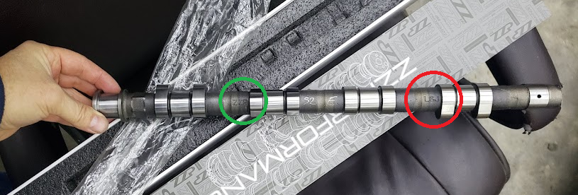

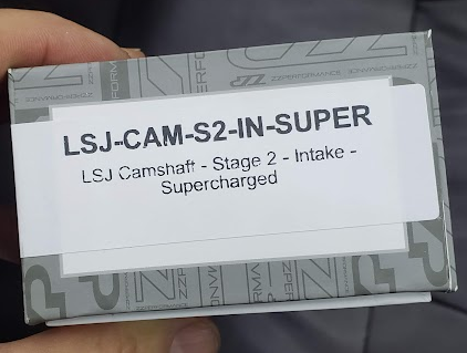

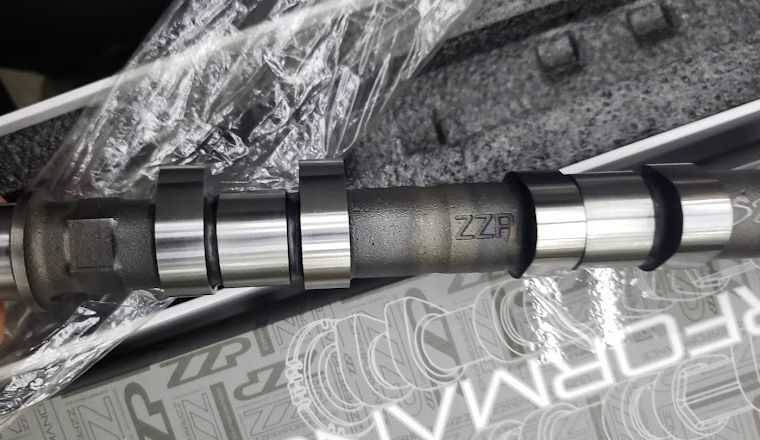

Is there a way to differentiate cams if I pull the valve cover off? How would I know if I have aftermarket cams/ valve springs?
That, I don’t know, but others may. I would think there are numbers on the cams that can be matched to zzp.
There is ZZP cast into the cams at the green circle, and LSJ cast into the red circle, on both the intake and exhaust cams.
