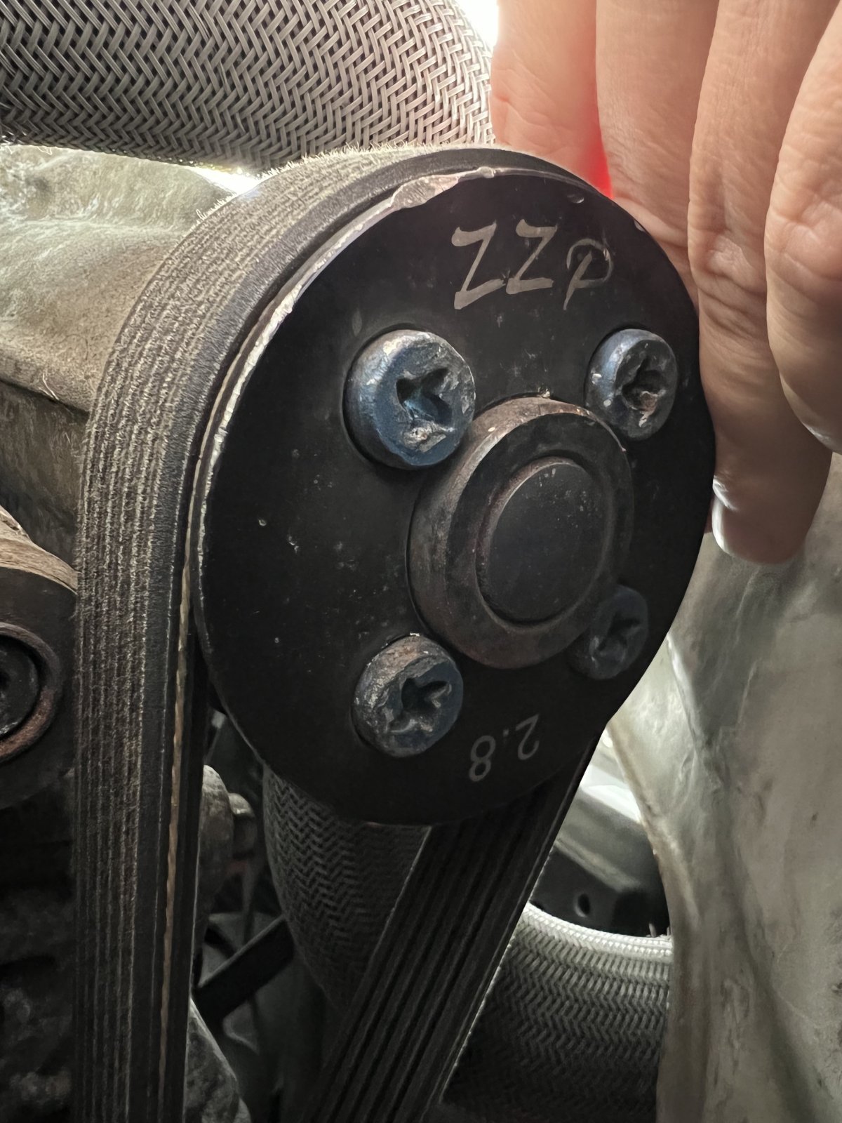

Here’s the pulley
Sharpie pen ZZP marking on the pulley with hammer installation and alignment - I would be very skeptical of any information provided by the previous owner for performance upgrades and the correctness of their installation. :rolleyes:

Right…. Tomorrow parts are going to start coming off to check and see what injectors are in there if I’m able to identify them.

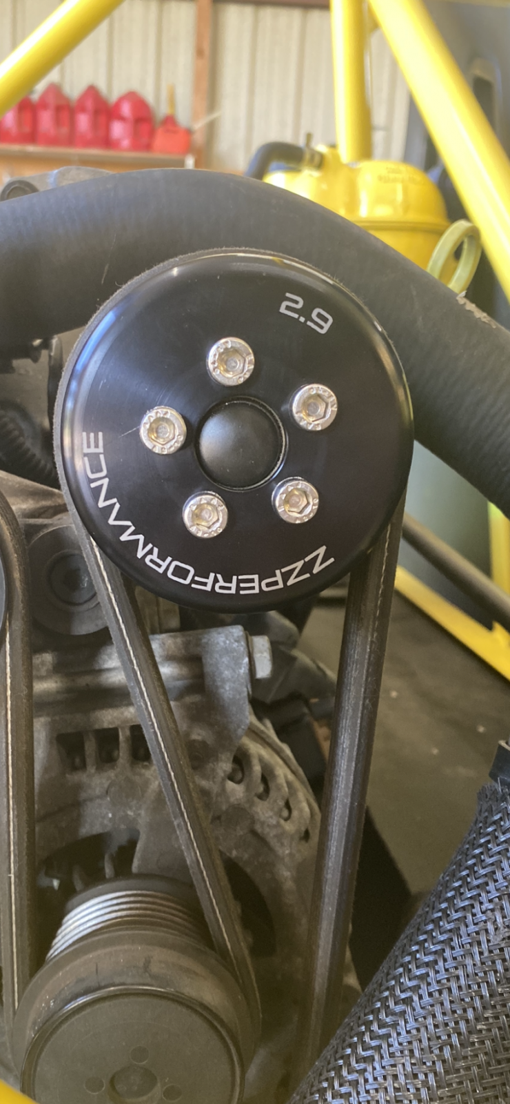

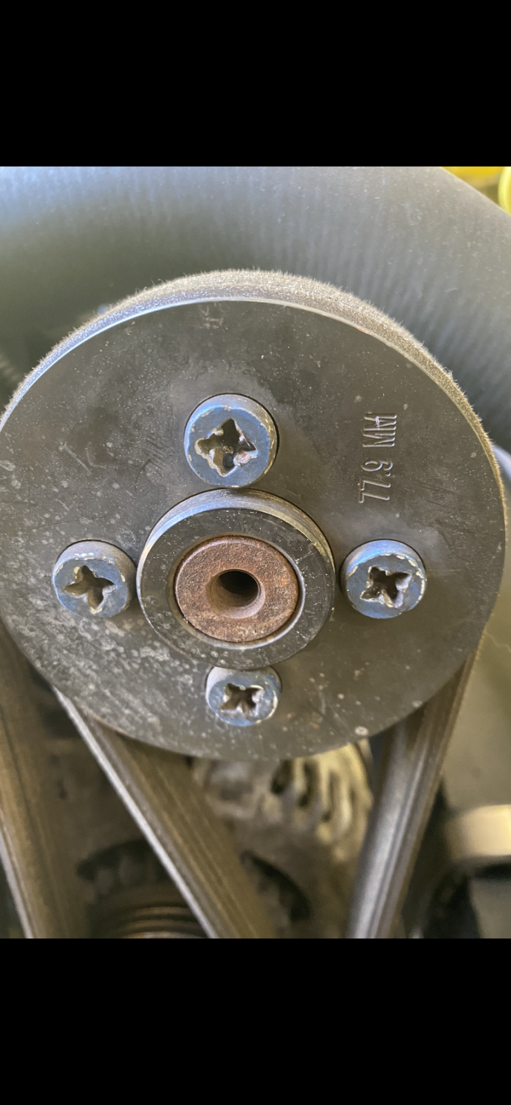

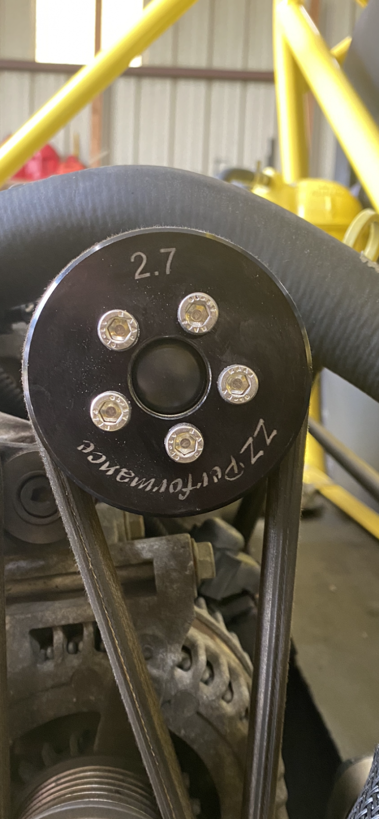

So that’s interesting. I wonder how old that pulley is. Zzp uses 5 bolts to hold their pulley on and GM (upgraded) used 4 like your picture. Plus zzp has changed their logo over time. Interesting to find the history on it.
Ghostknife
So that’s interesting. I wonder how old that pulley is. Zzp uses 5 bolts to hold their pulley on and GM (upgraded) used 4 like your picture. Plus zzp has changed their logo over time. Interesting to find the history on it. View attachment 29917View attachment 29918View attachment 29919

ZZP’s response:
Wow! Well that is our pulley and original logo from 2000-2010 but we haven't made those since I think 2007. So GM offered a stage 2 kit back in the day that came with a 3.2 and used a 4 bolt hub. For a while we made smaller pulleys for the GM hub. We then decided to make our LSJ pulleys for the 5 bolt hub we already made for the 3800 market thus discontinuing the 4 bolt hub versions.

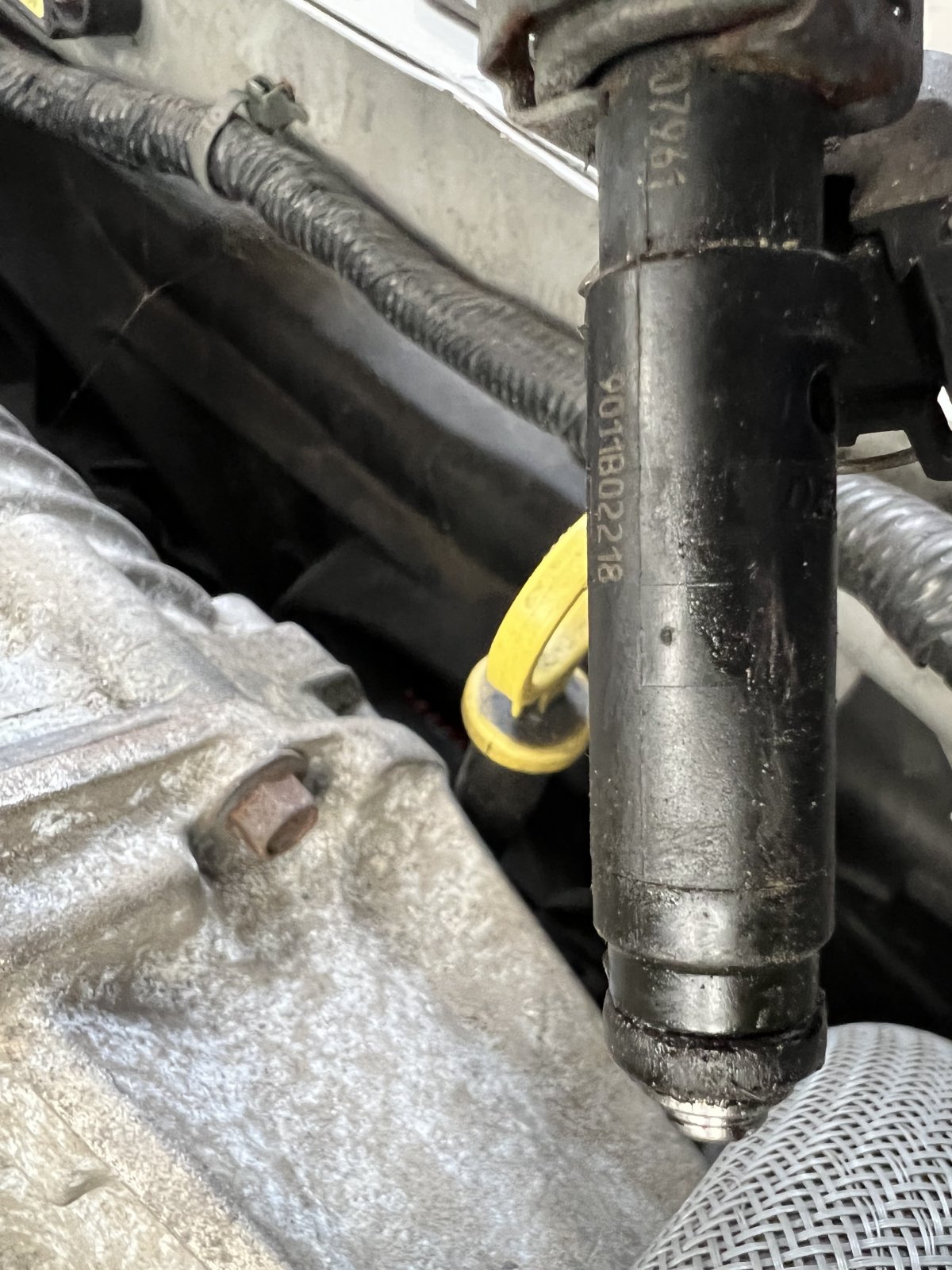

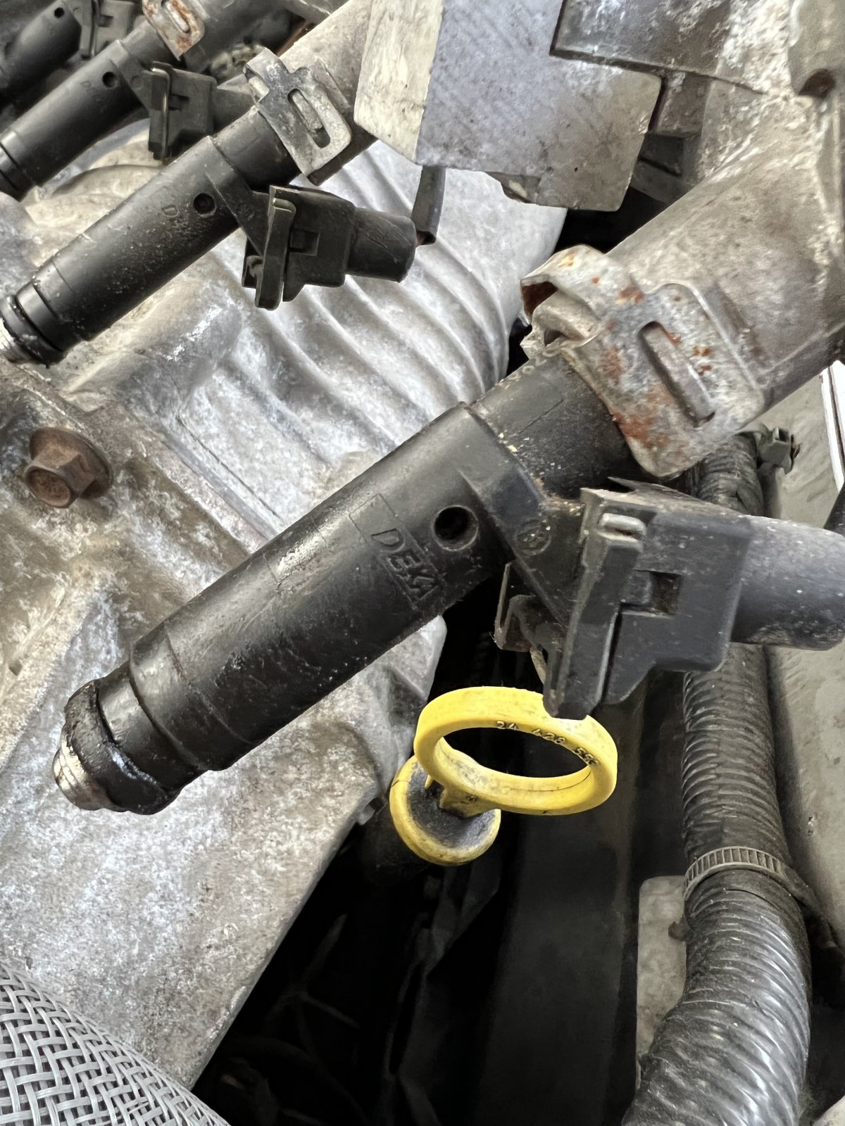

Ok so I found a bag of papers in the trunk and the add from the original owner was in it. States ZZP stage 2 package and 3” exhaust….. lol. Pulled the injectors and I’m guessing they are 60s? All I’m seeing on them is deka 9011B02218.
Not sure. Looking up the numbers, I’m getting a lot of info on 60# injectors but none of that number. I’d assume it’s as old as that pulley. Zzp may know though.
