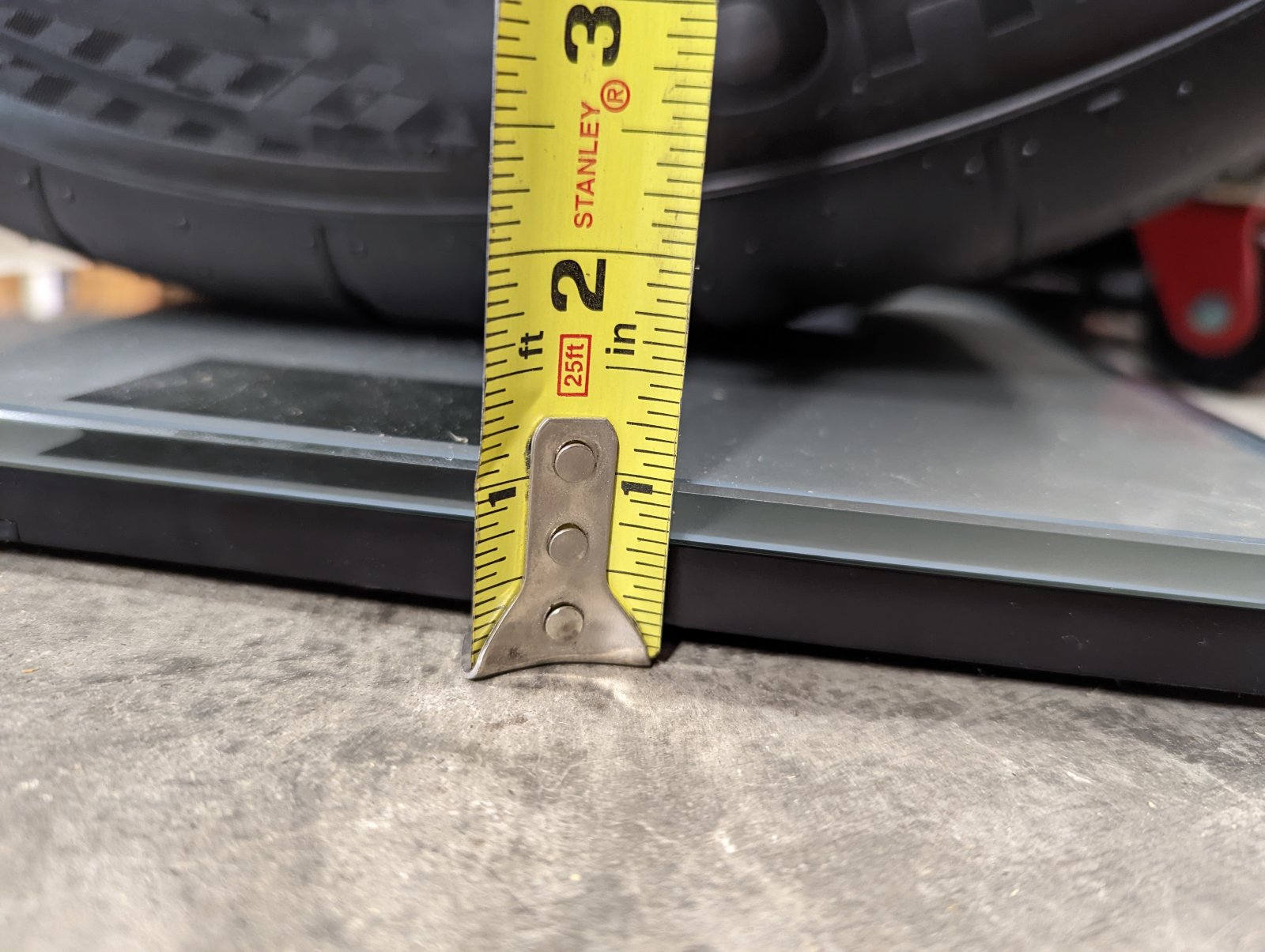

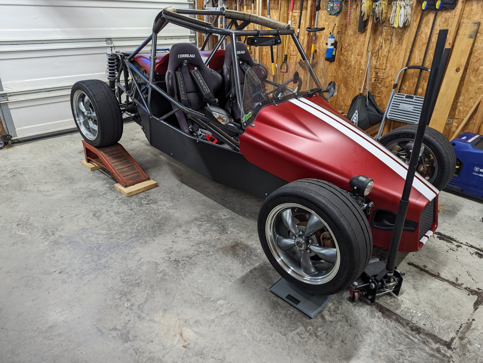

One idea to add in case someone has the tools: you don't need to have a professional level corner scale to get the front weights. Without driver, my Goblin is in the ~300lb per front tire of weight, a bathroom scale can work for this range as long as it's not the cheaper type with a max of 250-300lb. One front wheel can be on a block of wood to bring it up to level with the side that's on the bathroom style scale. In fact.... my bathroom scale might have a high enough range to check this out.
baustin
Disclaimer: these numbers might be accurate enough for DS but they seem to have a little error which is expected with a bathroom grade scale vs accuracy or race corner scales. If anyone has race scales that have enough weight range to weigh the rear tires, the side to side tip is more significant weight shift and will yield a more accurate CG height.

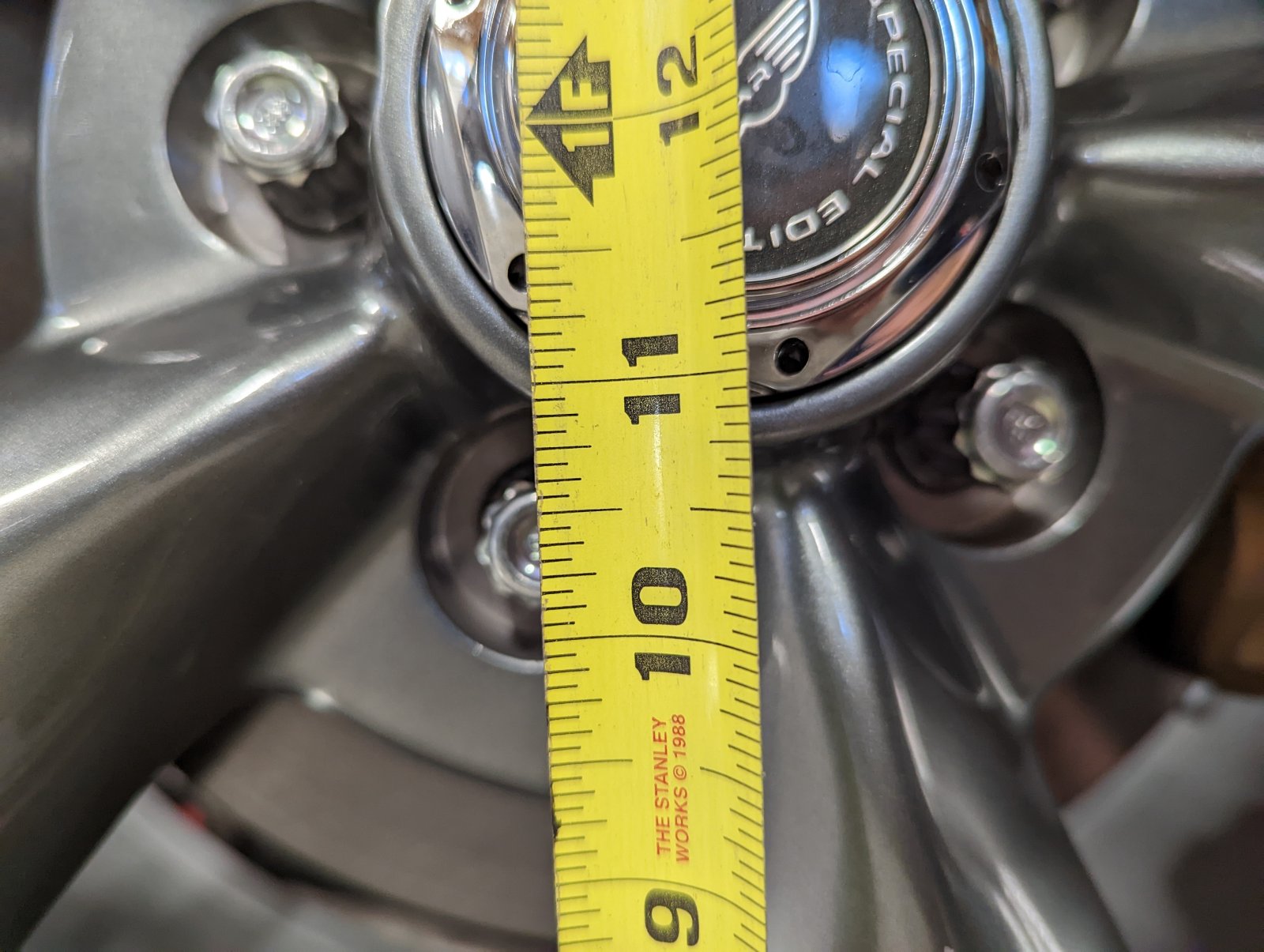

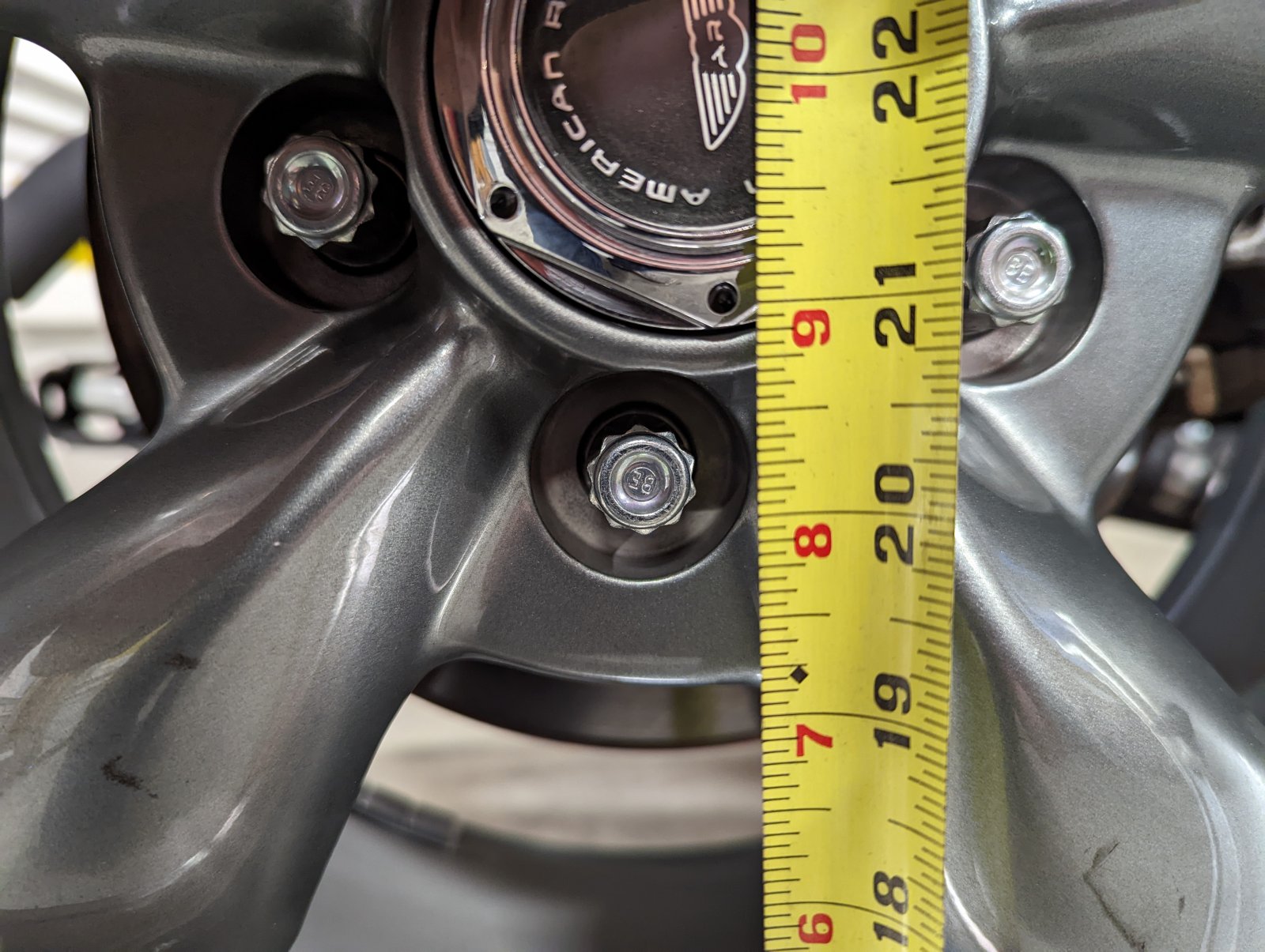

I lifted up the rear of my Goblin and set it down on ramps/blocks of wood to get close to the 10" lift target. At the rear I measured from ground up to the bottom of my center hub: 20.875". At the front I measured the scale @ 1" tall and from the scale to the center hub: 10.875". Resulting weights are based on 9" lift at the rear axle vs the front.
All 4 wheels on the ground
Driver front: 295.2 lb
Passenger front: 297.8 lb
Rear wheels lifted 9"
Driver front: 304.2 lb
Passenger front: 302 lb
These weights are with repeated lift/lower onto the scale to confirm it's as accurate as the bathroom scale will be. It seems odd that the driver front was lighter when the car is flat but slightly heavier when the rear is lifted. Either that's due to the accuracy range of the scale I used or it's due to fluid movement like the gasoline in the tank. My tank is likely around 6 gallons full. The ramps on blocks aren't 100% exact height since my tires are wider than the ramp flat surface and the tires are sitting on the edge of the ramps, maybe the driver rear settled into the ramp and the passenger rear stayed on the edges?

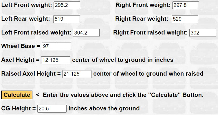

Plugged in the numbers from @baustin for the front weights and the rear weights from @Chubbs (all of which are within 1%) to get the following:
This calculation indicated 21.3 inches above ground level.
So from this information the CG appears to be between 1-1.5 inches above the fuel tank and 2-2.5 inches behind the b-pillar roll bar loop - with a 5.5 inch ground clearance to the bottom of the frame.
baustin
I think the CG height from that website needs a correction put in due to how I measured. I measured to an easy to read edge, at the bottom of my wheel hub covers. The wheel hub cover is 2.5" diameter, so any center of axle values need to include +1.25". I listed my total heights as relative to the ground but while on the scale, my 'ground' was 1" above the concrete.
Height from ground to center of axle: 10.875 + 1.25 = 12.125"
Center of wheel to ground when raised: 20.875 -1 (scale lift from concrete) + 1.25 = 21.125"
This still leaves a lift of 9" like I mentioned previously but the final CG height shouldn't be up at 21.3". The accuracy of the bathroom scale I used really messes with the results and could be related to my garage not being purely smooth and the 4 contact points on my scale getting an odd split of the weight.
I get 20.5" if I use my front weights and Chubbs rear weights. When I've measured my entire Goblin previously I was just around 1600-1610 lb I think so his numbers should be close:

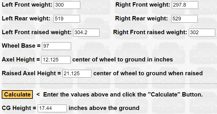

However, since something seems odd about the driver being lighter when on the ground but heavier when the rear is lifted, I tested with Chubbs driver front weight of 300 (driver stays slightly heavier in this example):
36283
With that 5 lb measuring difference and since I only could tip my car to 9" lifted on the rear, the resulting CG is 3" different. For most situations that would not matter but I think it might impact your design calculations. Of course a driver will impact things as well but you can easily add them into the calculations.
