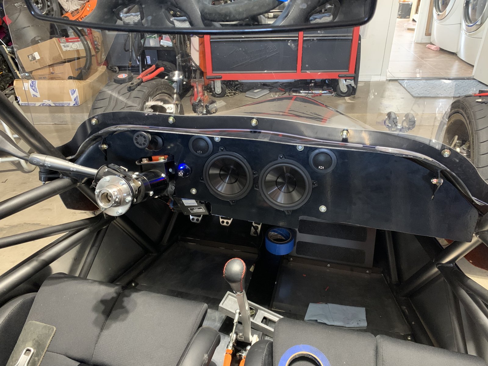

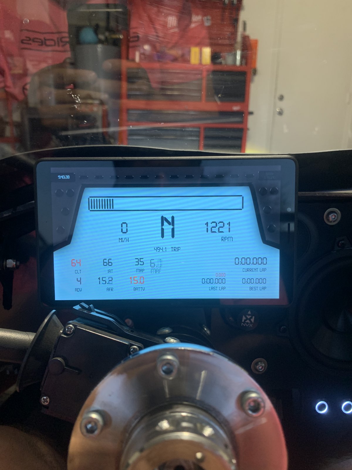

Mattc3366
40397
Mattc3366
Here’s my setup. Realdash app on $80 Lenovo tablet , NVX Bluetooth controller , Memphis audio powersports amp and nvx 5.25 component setup. Loud enough to listen to music at highway speeds and the controller knob is nice to use to switch songs or adjust volume without touching your phone
