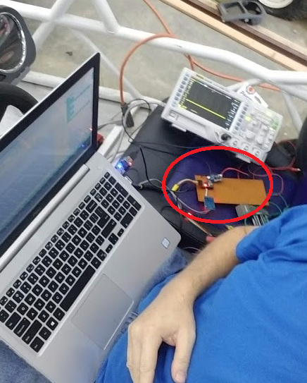

My oscilloscope is showing data on the GM Low Speed LAN when my instrument cluster (IC) goes dead.
So I'm guessing that some data is missing that the IC needs.
I went and bought a CAN BUS module for an arduino, did a little circuit board soldering, then plugged then into my PC.
I was able to modify Mike McGuire's code, to read the GM Low Speed LAN.
17443

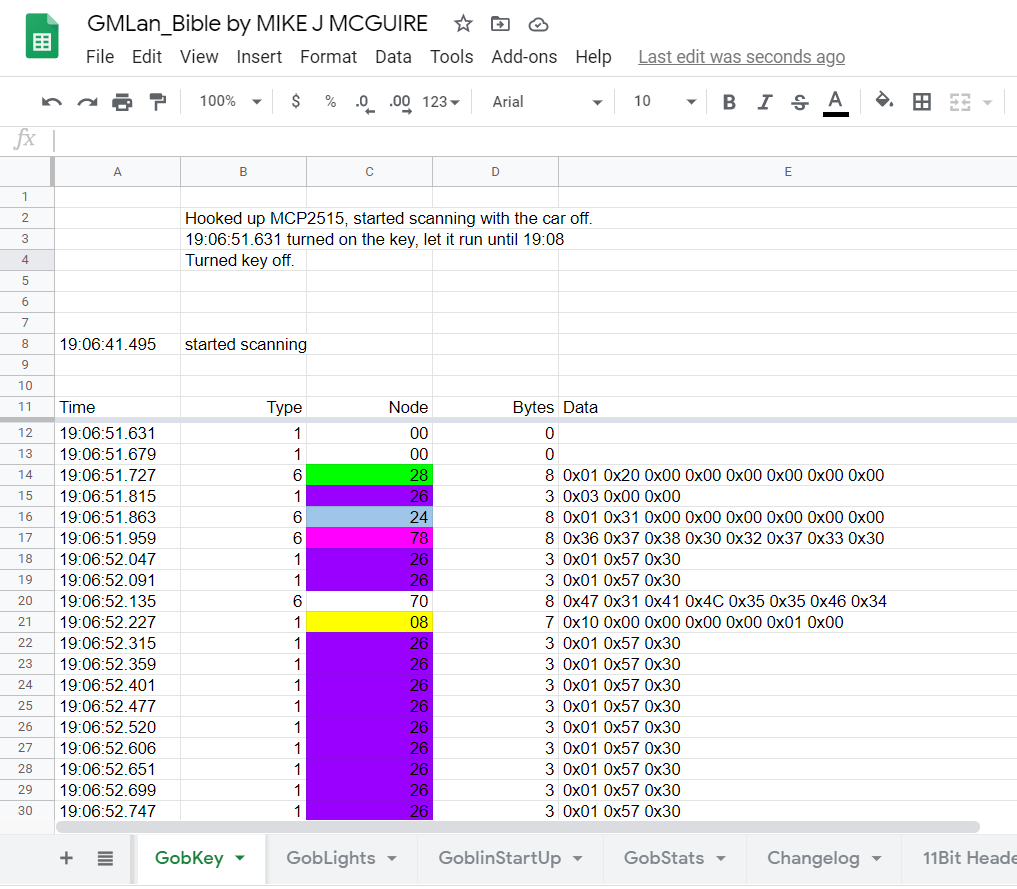

Here is a small snippet of data, lasting 1 second, when the engine is running. The Extended ID is the header, all the data seems to be of the Extended type on my engine. DLC is the number of data bytes, and then the data is shown.

The file I created with an engine start is here.
Also created a file where I turned the key on, but didn't start the engine.
