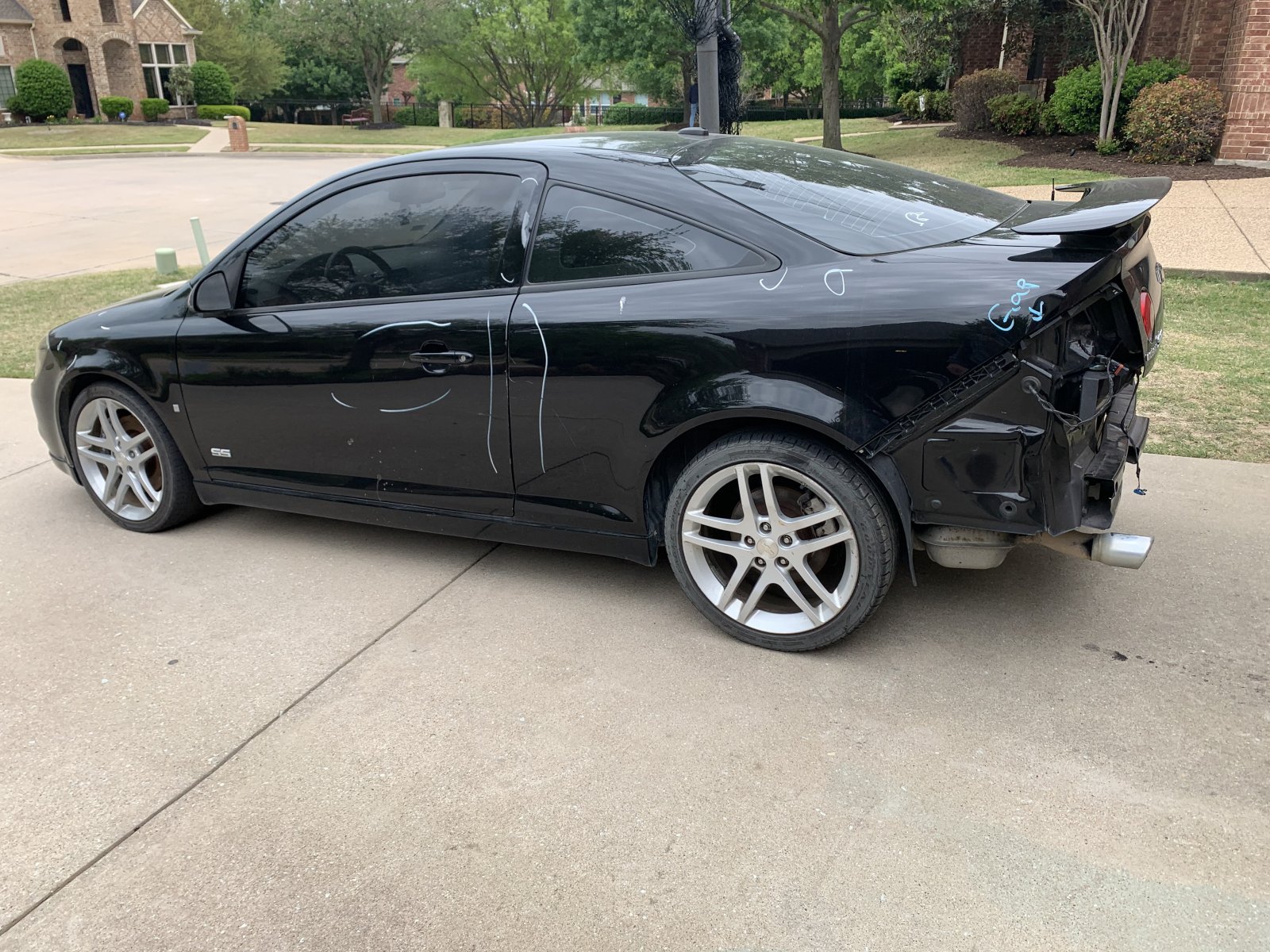

Hello. I'm new to the forum. I just bought a rear-ended 2009 turbo SS via online insurance auction. I've been able to get the battery charged and have been able to start the engine. I noticed some white smoke coming from the exhaust, but since it hasn't run in a while and had good oil and coolant levels I was going to run the engine up to temp to look for engine leaks. After a few minutes of revving the engine my wife observed more white smoke and then some fluid (looked like diluted oil) spraying from the exhaust, so we shut the engine down. I'm thinking (hoping?) it is just a head gasket. Any other thoughts given the fluid coming from the exhaust? As I will likely set out to replace the head gasket, I've looked online for instructions/recommendations as to how to approach it on this model car and haven't found anything. Do you have any resources you can point me to, both for the "how to" and where to get the gasket/headstuds/anything else I should do while trying to fix the engine? Thanks for the help!
I don't think you have a head gasket problem or that anything is likely wrong with your engine. Before I would take the engine apart I would run it long enough to see if the exhaust smoke clears up.
Also if it idles smooth it probably has good compression. If it has a blown head gasket it will usually have a misfire.
It was driving down the road when it got rear-ended so if you run it for a while, as long as it has fluids, it shouldn't hurt the engine.
If the smoke is really bad shoot a video and post it on here.

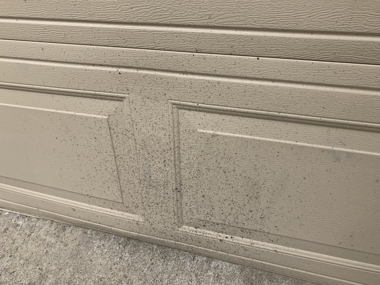

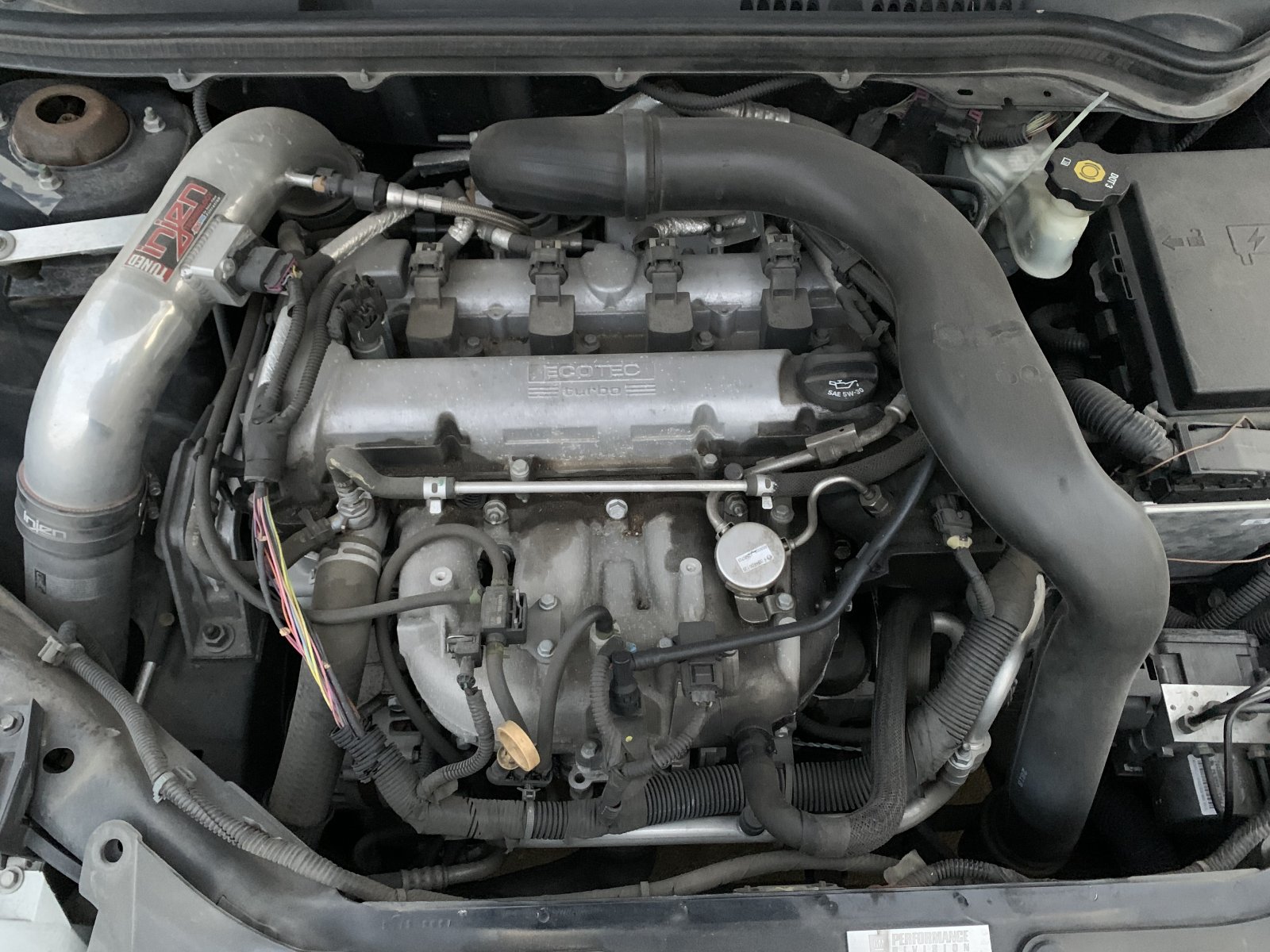

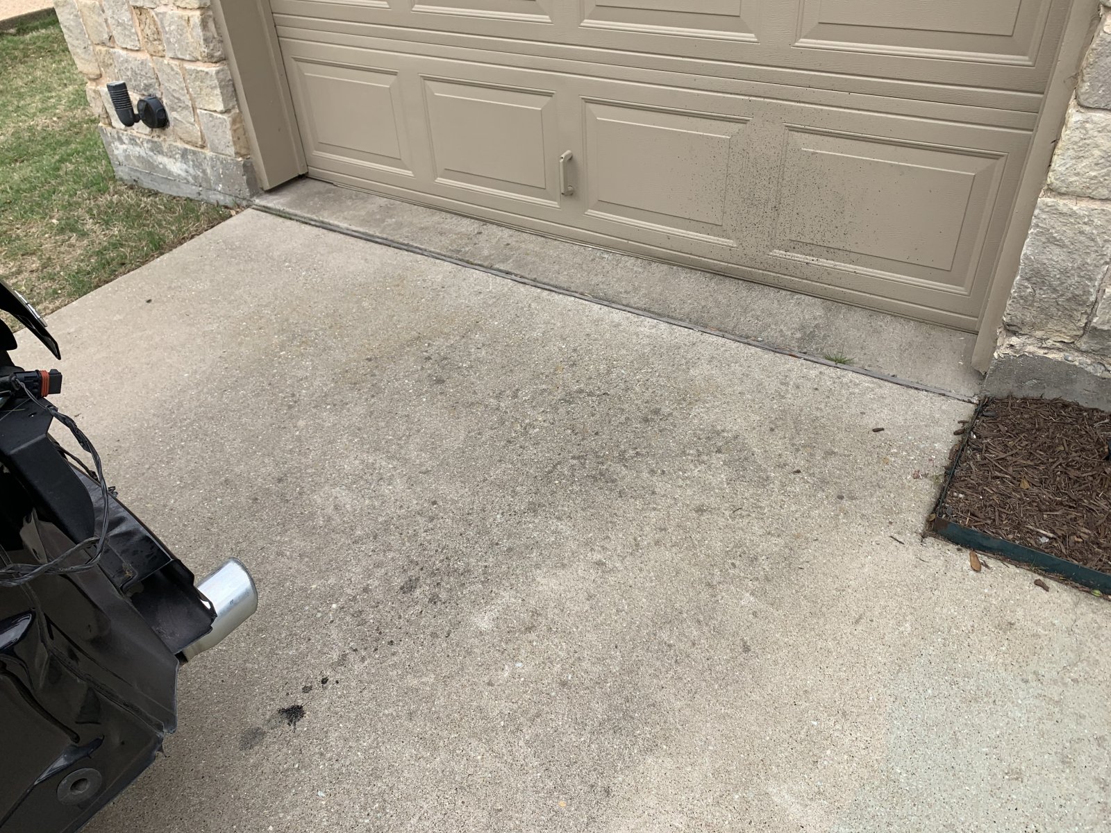

Thanks for the responses. I've attached a couple pics... the donor, the engine bay, a shot of the exhaust pipe with what dripped from it and sprayed onto the garage door, and a closer picture of the spray on the garage door. This evening I hit the door with a mild degreaser spray (Fantastic like) and the spray wiped right off, almost like it was a solid particulate. It didn't seem oily. I'll take a look at it again in the morning when it is light. Thanks again for the responses.
Soot plus a lot of humidity (moisture) can do that. Diesels do this bad. I can’t start mine near anything without making a mess on it. If it’s been sitting, there’s probably a ton of water/moisture built up in the exhaust. I’d run it and keep an eye on it. See if it clears out. if it is broke, it can’t get more broke, so might as well test now.
I agree. It's probably running rich from some bad tune and soot'ed up the exhaust. Mix a bunch of moisture in the exhaust and you get a nice carbon spray. My old 68 vette would do that from time to time. I have a spot that looks very much like that on the wall of the garage.
All exhausts expel visible water when they are cold. After the exhaust gets hot the water comes out as an unnoticed vapor. This is why cars have a lot of white smoke coming from the exhaust on cold days.
