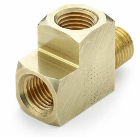

I put a thread on access port.
22233
with a plug
22234
at the highest part of the system, and don't have an expansion tank. The rubber lines do flex a bit, and allow for some expansion room.

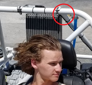

That brass T fitting is behind my roll bar. Without a windscreen, my intercooler gets good airflow here.

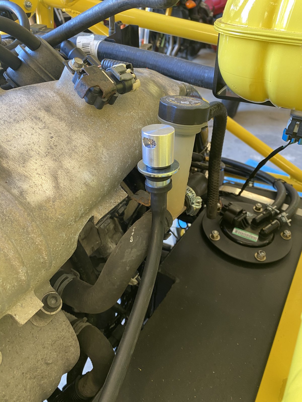

I'm still using the stock “T”, that comes on a sc car, but I’m going to switch to an expansion tank like the main cooling system has, due to adding a dual pass end plate on my intake.
SmsDetroit
Yep. 49.5/50.5 water to Dexcool mix here.
I just got a regular old T fitting. What you have looks way better
