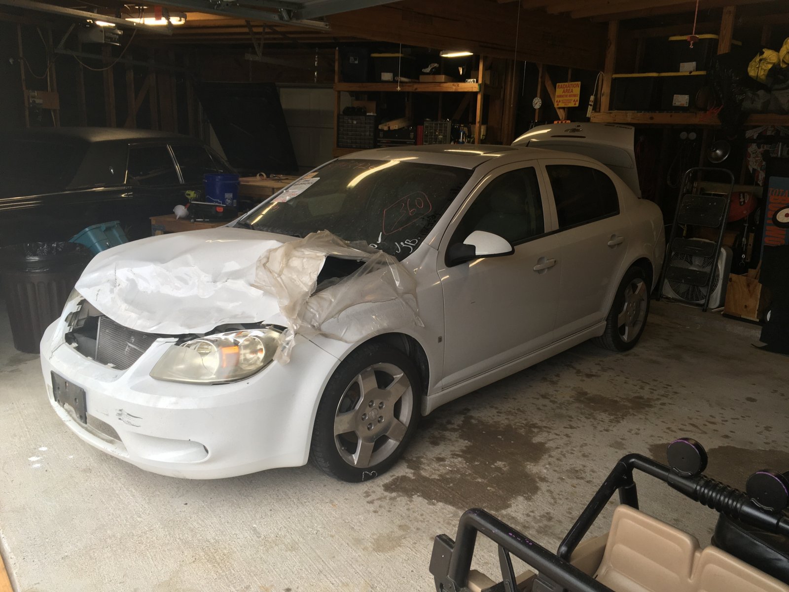

A bit of an update. Turns out I won the bid and now owner of the cobalt. got delivered 3 days early and now sits in the garage. First picture is as arrived and pushed up the driveway. I cost a lot with all the fees but I got what I wanted (I hope). The car comes with the:
LE3 2.4L VVT 171 HP
FX2 3.91 final drive ratio
FE3 aluminum suspension
YF5 CARB emission certification but no air pump
85K miles, Almost new Struts, axles, brakes, pads, transmission flush 2000 miles ago, wheel locks on every stud, pristine interior, not a dent ding or scratch on the body past the A pillar.

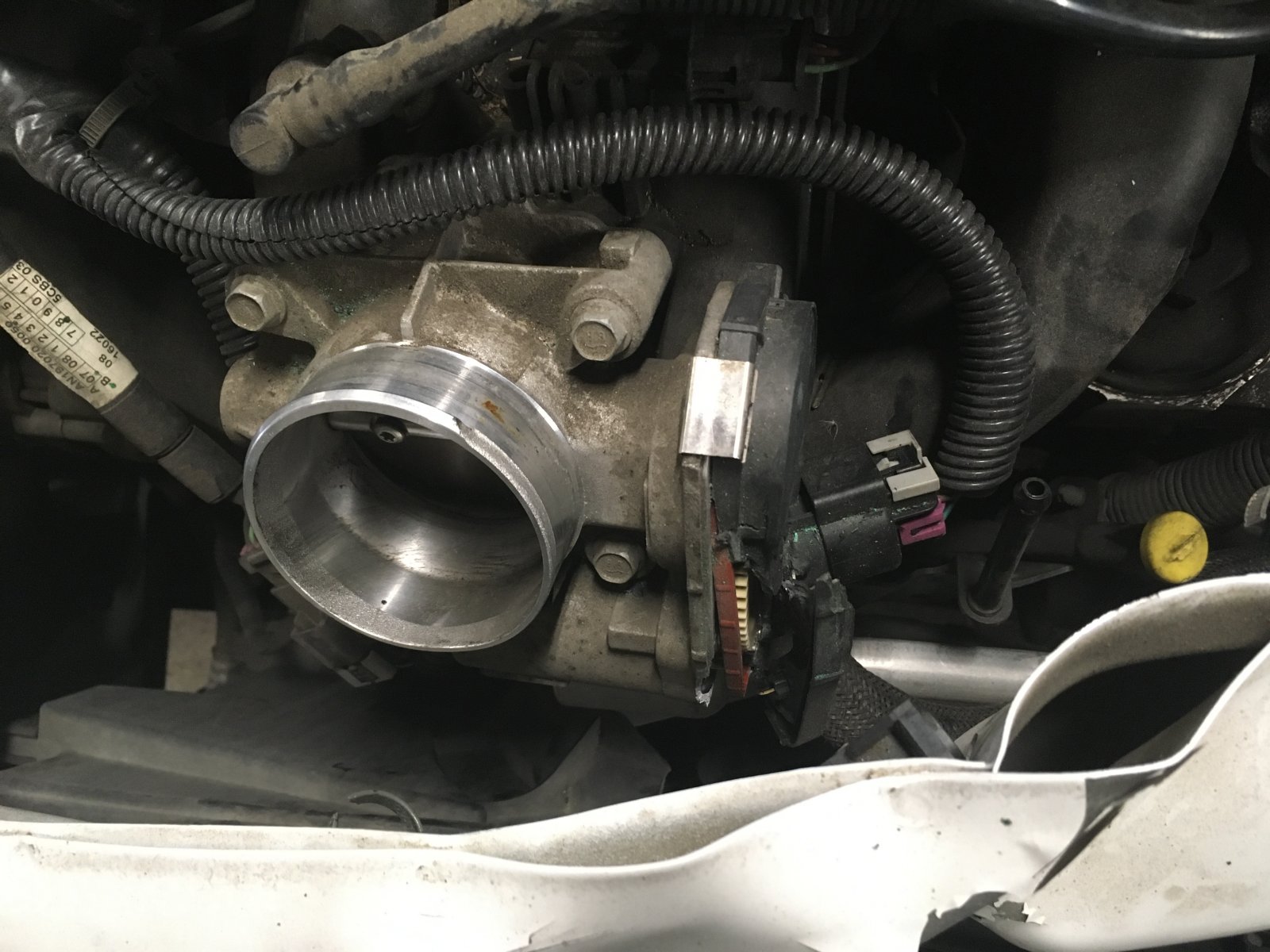

Took the hood off and looked it over. Battery in trunk was in good shape and unplugged. Nice Ingen intake was hose was only temporarily squeezed by the radiator support. Now the bad: Throttle body was smashed and not unexpected. The intake manifold below is intact.

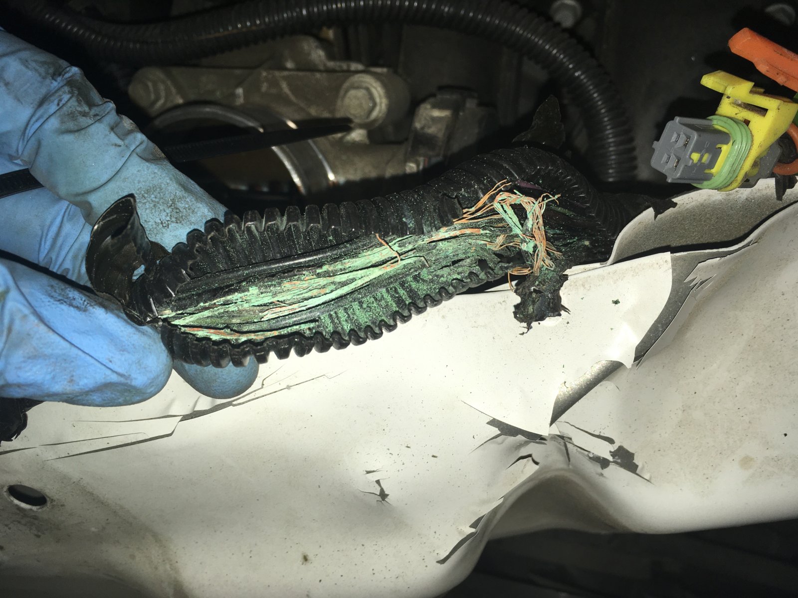

The headlight harness clipped to the radiator took a beating and also found the melted purple DRL resistor wire many people also commented on. I cut out the wire and looped it to itself. and repaired the one cut headlight wire.

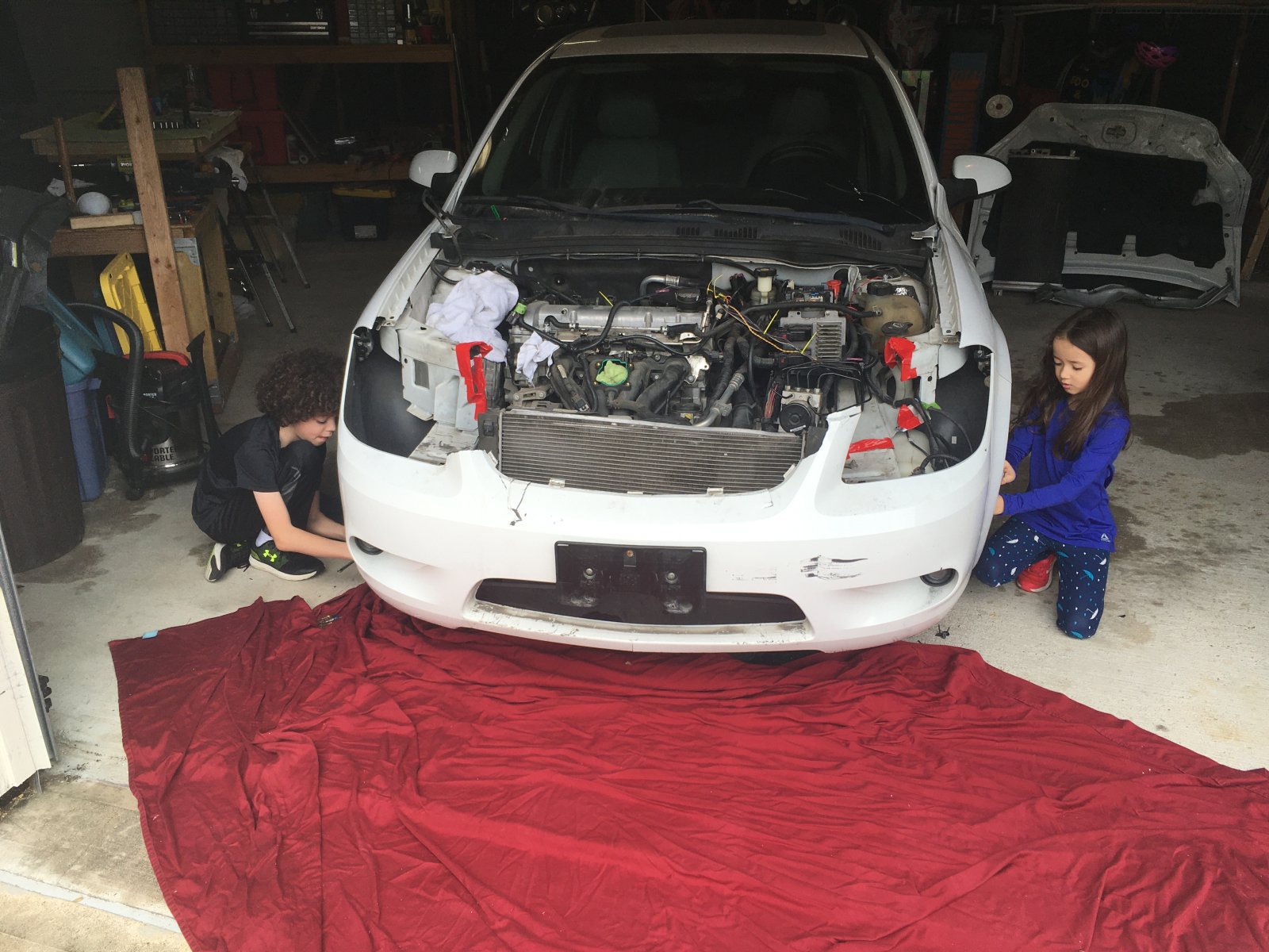

The radiator and condenser were cracked. The ABS module took a beating and ripped the plug off the board but the tube connections are good. and the mounting brackets for the fuse box and the overflow tank broke in the accident......And it does not turn over.
Does the Throttle body need to be intact to signal the ECU to crank the engine? I have a new radiator and TB coming in a few days to get it plugged back together. All other car functions work fine from Radio, windows, wipers, sunroof, turn signals, ect. just when I turn the key, a big nothing and no car lock symbol on the warning lights. I am going to wait on the TB before I start to freak out and think I got an electrical lemon. in the meantime, I got the kids helping pull the front bumper off.
