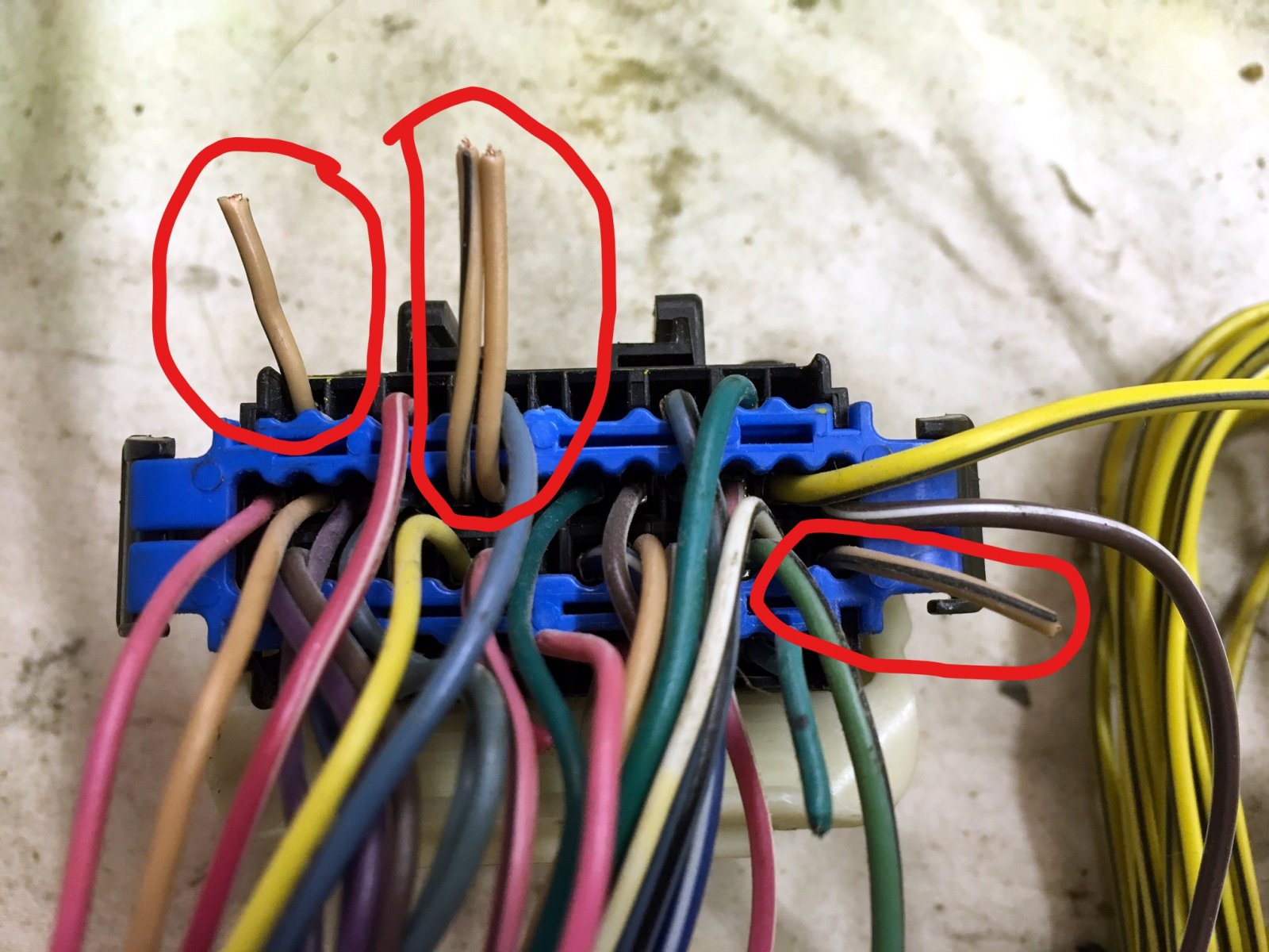

I removed the ABS plug. I will need to solder the twisted pair of wires that went from the ABS to the ECM to the Blue/Black multi-plug of the BCM. But I have found two sets of what look like brown and brown/black on the plug. I'm not sure which set to solder to.
