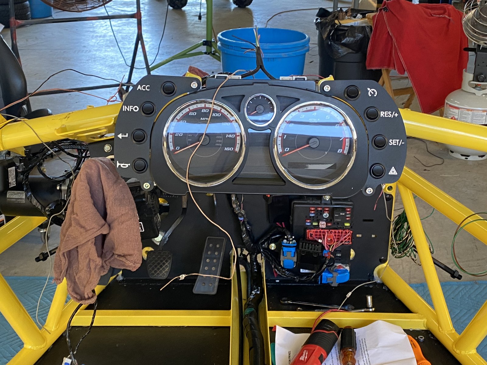

Cluster with button panel mounting

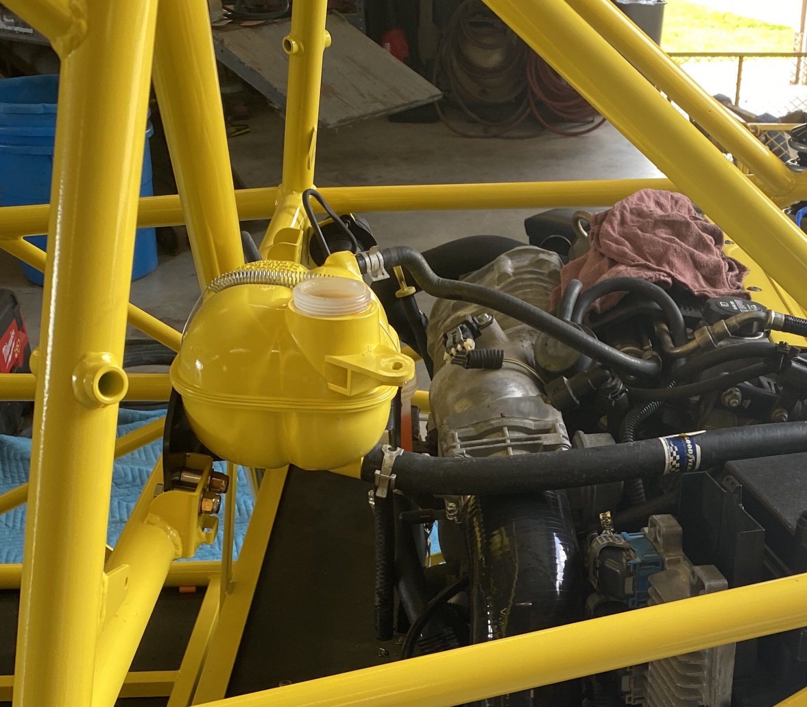

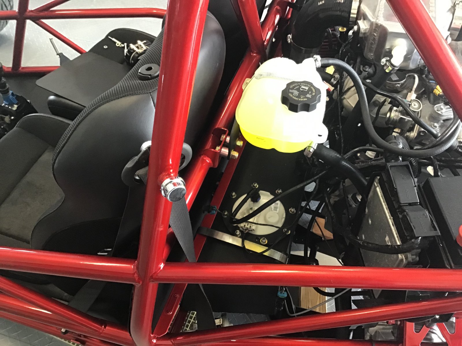

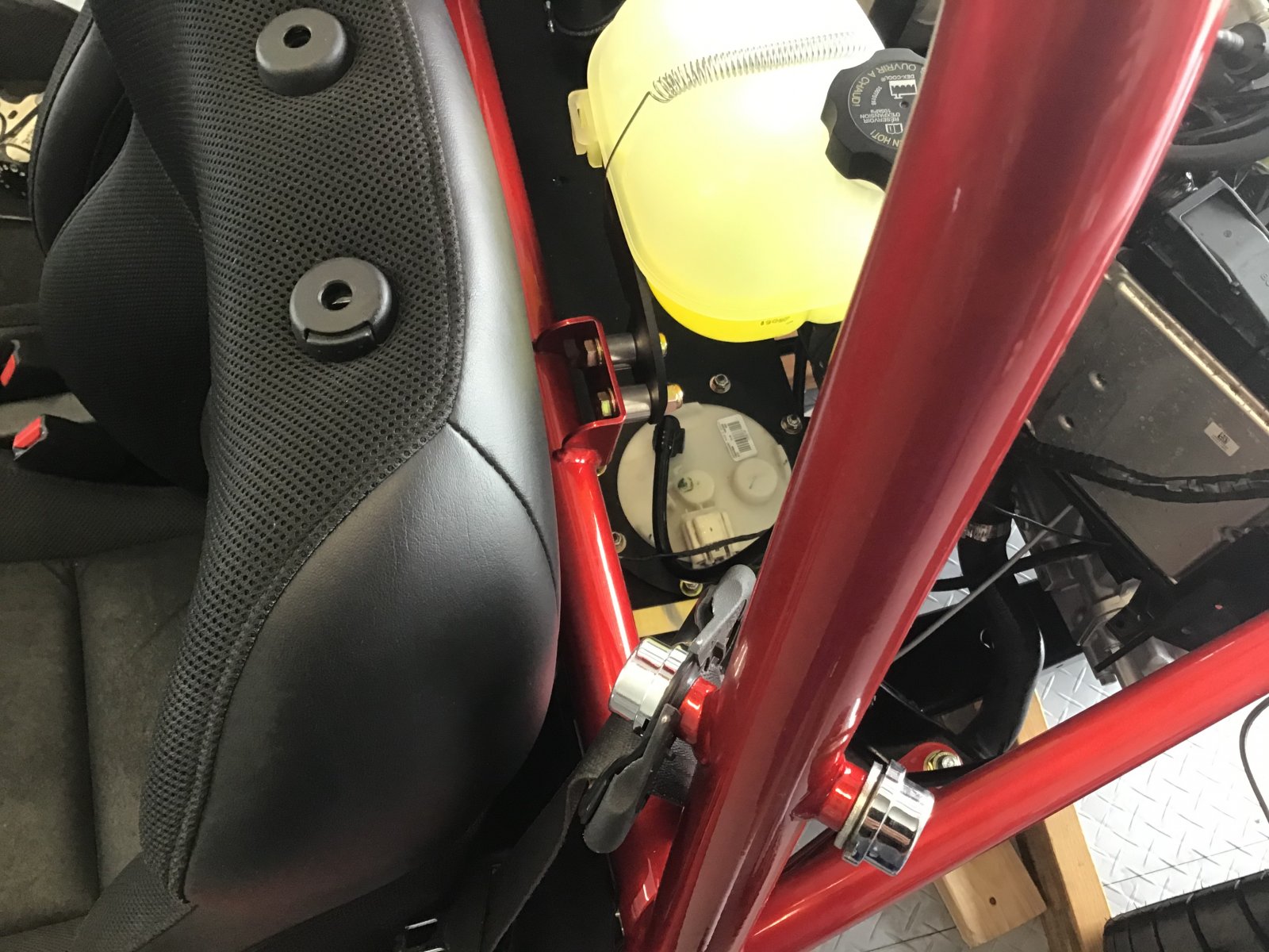

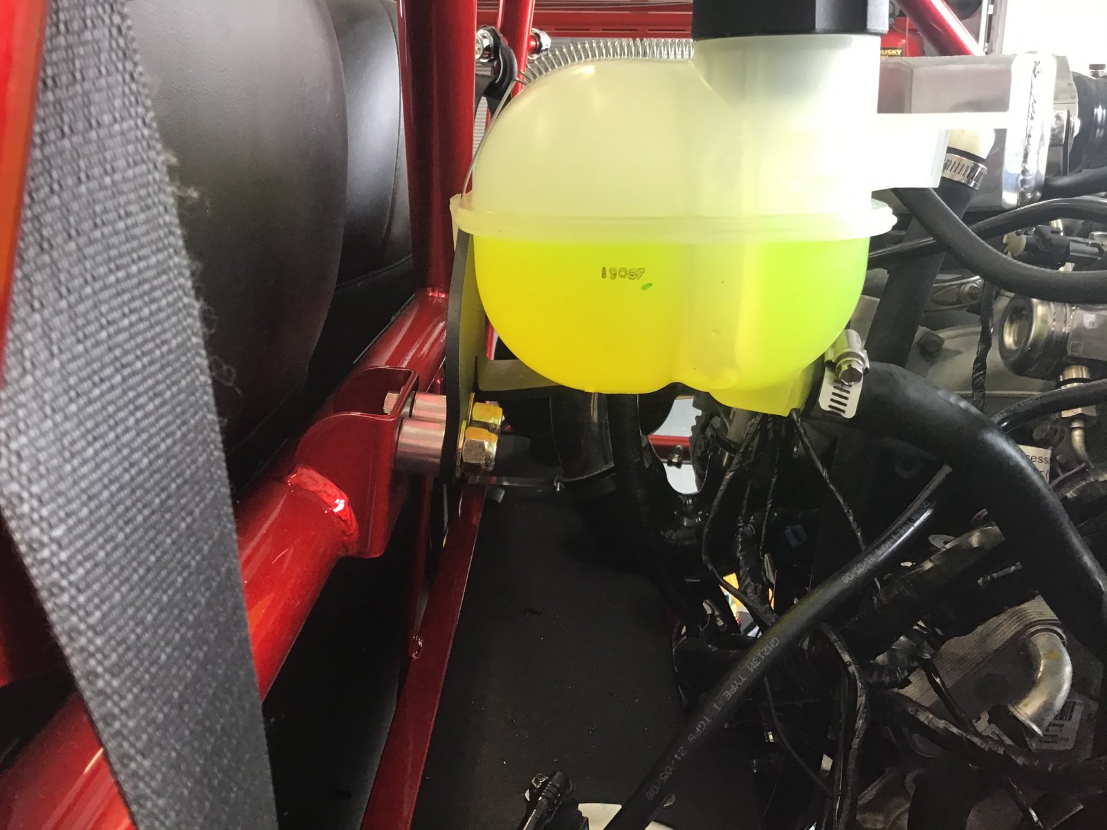

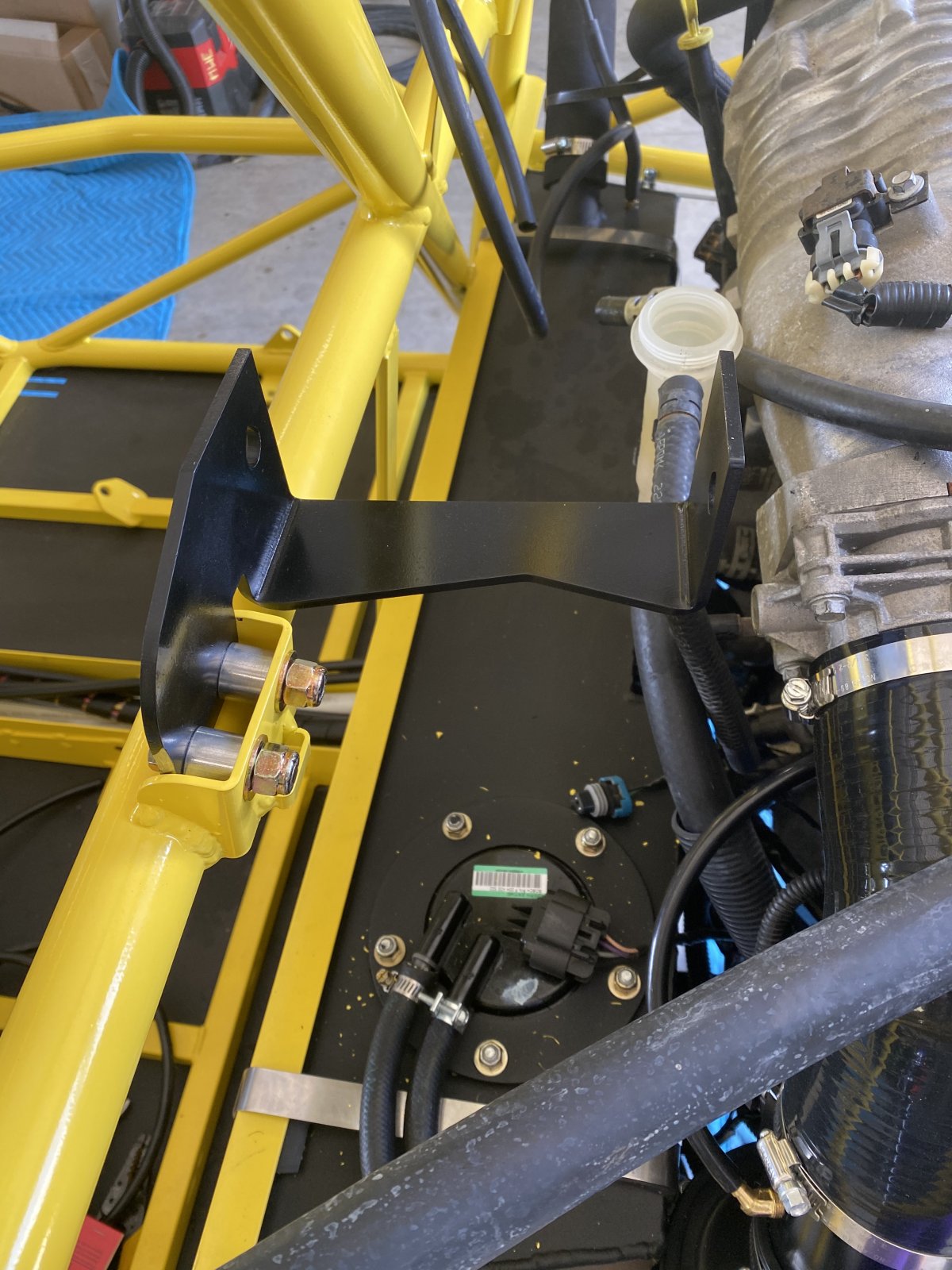

Here’s the updated coolant reservoir bracket. This is the best way I could find on supercharged models.
I had it all the way back with the spacers and the hose/nipple would hit the air intake. Everything was in a bind there.
I moved the bracket to the seat mount (inside or outside of the mount) and it would ”work” but the air intake would push on the hose. I could see this being an issue over time.
Moving the bracket all the way forward with the spacers (like pictured), gave everything enough room to be happy.

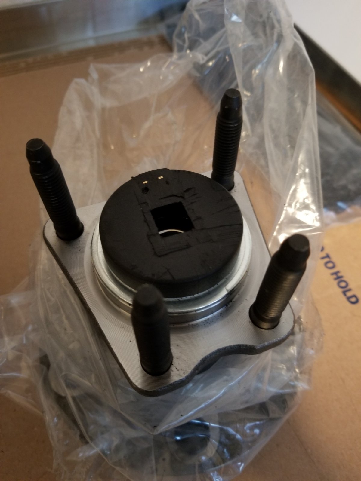

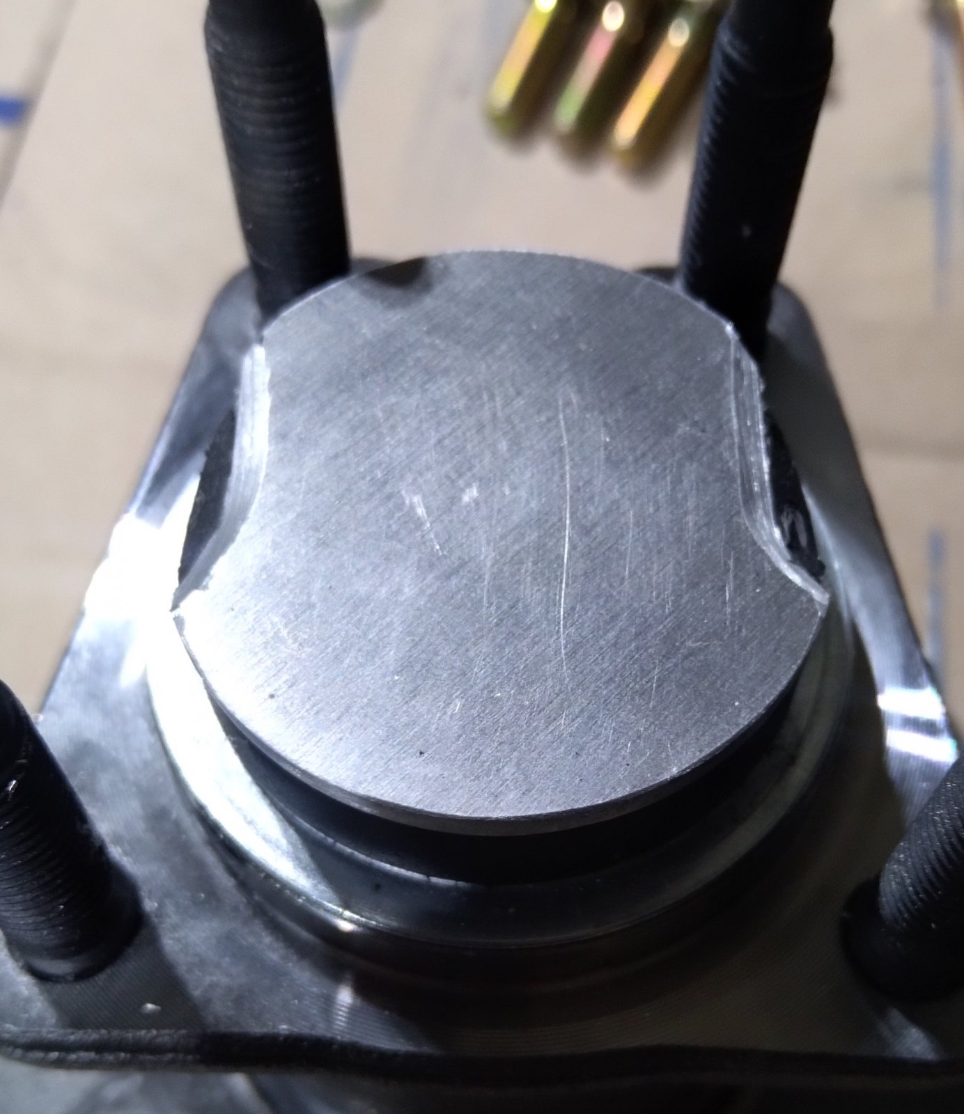

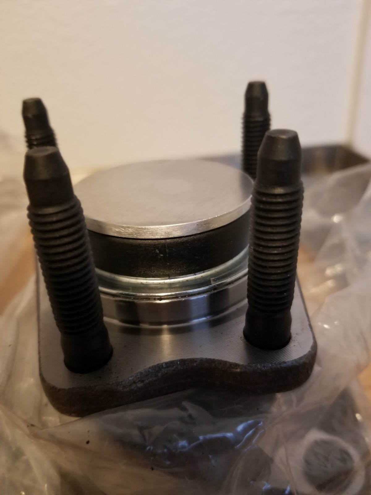

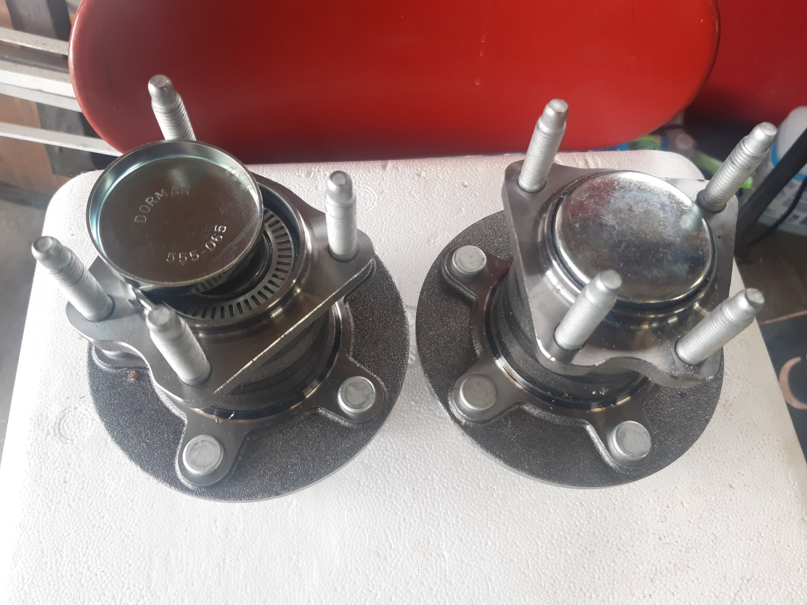

Depending on how the wheel speed sensor is made, you may be able to use a hacksaw and cut off the part that sticks out to far. I was able to remove one of mine without getting to far in. The first one I cut a little to close and had a small hole I sealed with epoxy.
ColoradoCryptoTrader
I cut my ABS sensors on the cobalts rear bubs flush with a mini hack saw, got out all of the plastic bits that fell into the hub with a qtip soaked in iso achohol and then JB welded 1/8" thick aluminum circles (2" diameter) on top that I got off of etsy haha. Cost me $8 total.
I could not get the entire sensor removed and I was not trying to damage my hub in the process.
30775
30776
update:
I had to clearance these caps to fit under the steering arms, but the result is pretty nice.

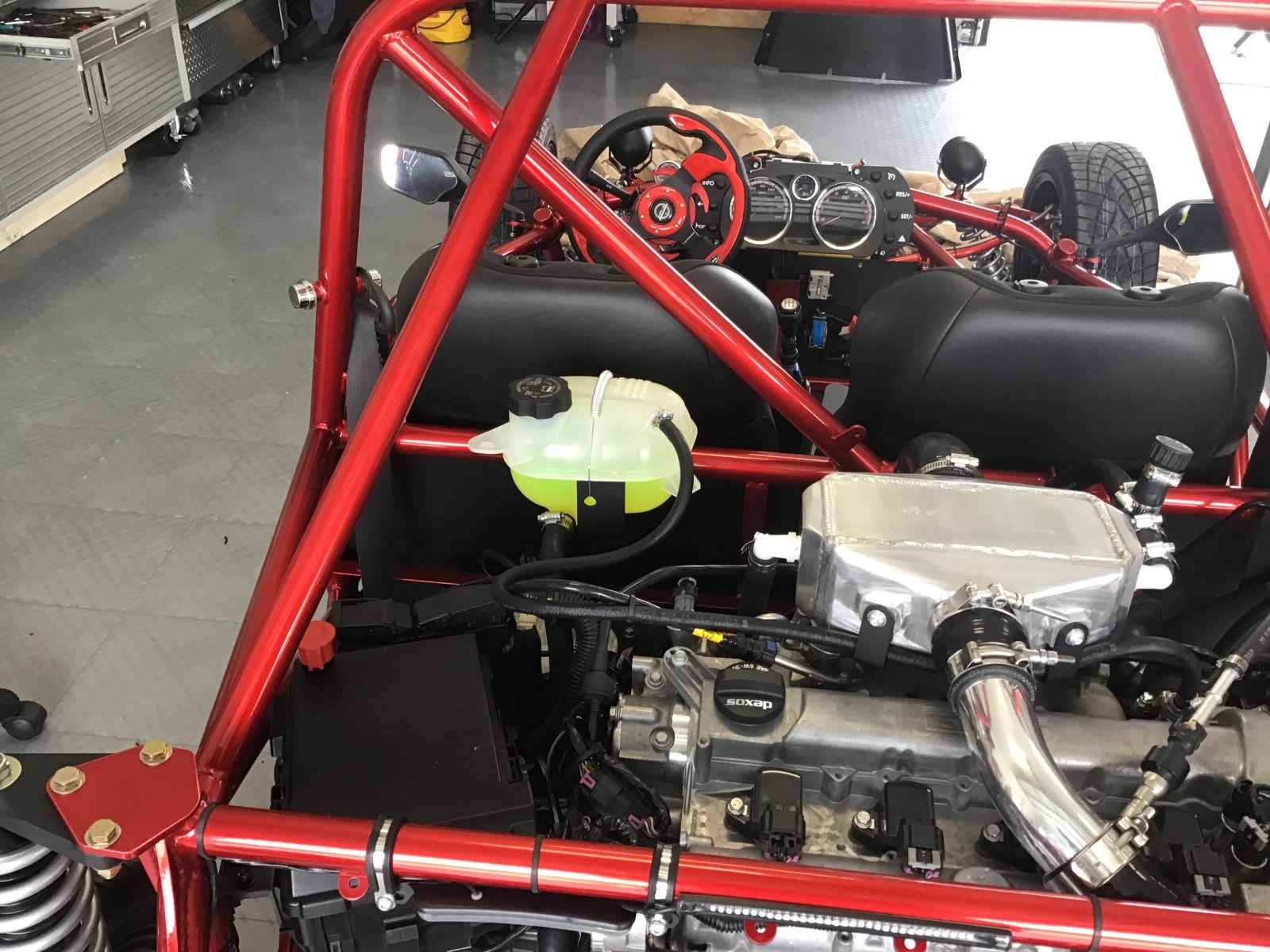

Why would someone want to relocate the brake fluid reservoir? I put mine in recently and was wondering if I need to move it now
No reason to relocate unless of course you have a reason to relocate. Sounds like you don't have a reason. Assuming you have it located as intended by DF in the pictures above.
