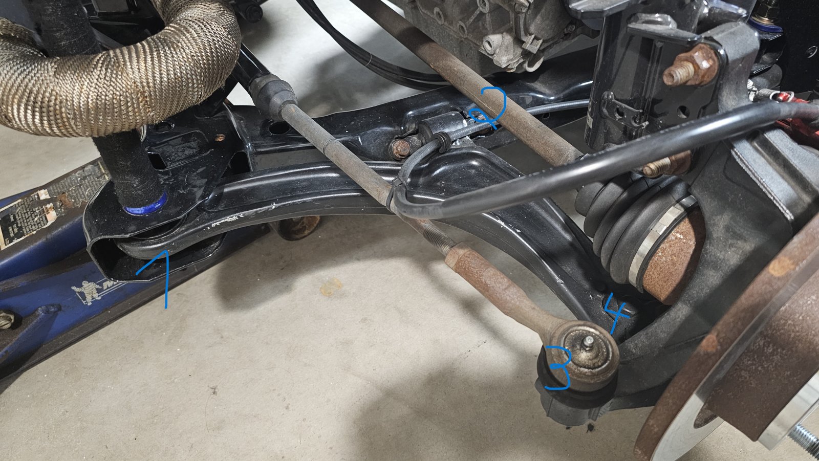

So, I bought this ones control-arm-bushing-sleeve
and control-arm-bushing
What are they used for? I want to get the car solid and no torque steering. As Ross mentioned in this post. It seems like they are not the right size.
I think the points 1-4 in the picture below need to have as little play as possible.
The Mook K201285 seems to be in spot 4
42570
I have aluminum swing arms on my goblin, but the steel one was sitting in my shop, so I used it to mock up the parts.
fwiw everyone talks about replacing the rear bushing because they're always torn up when they come out of the Cobalt, stock replacements are soft and not particularly durable, and there's an affordable and effective upgrade (the Moog K201285)
The front bushing doesn't seem to fall apart like the rear and has less of an effect on acceleration and braking. Its primary loading is lateral, i.e. turning.
Even if the DF bushing fit as the front bushing in the aluminum control arm. I still don't know how it would fasten to the subframe. You might want to try and check with DF on what their intent was.
Chris_WNC
That Moog K201285 goes in spot 1 in your drawing above. #4 is a ball joint. Something like a Moog K80566.
I can't figure out how those DF bushing and sleeve are going to work. Looking forward to your update when you get one.

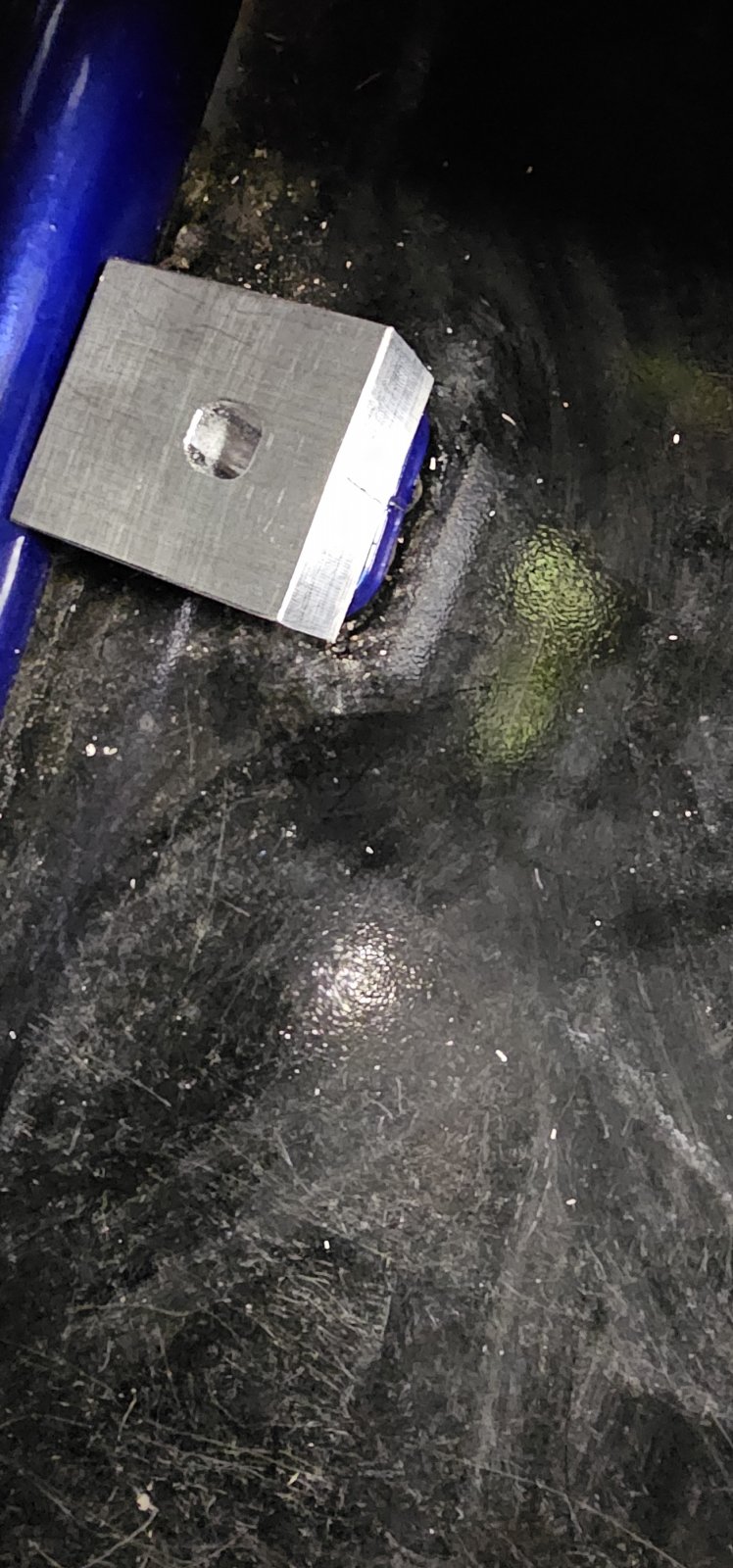

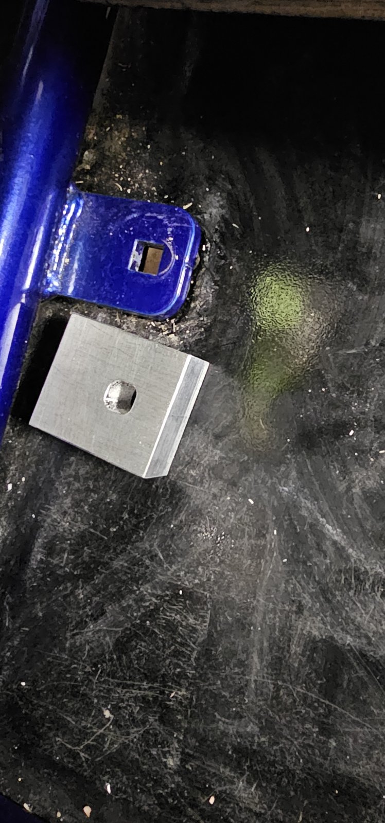

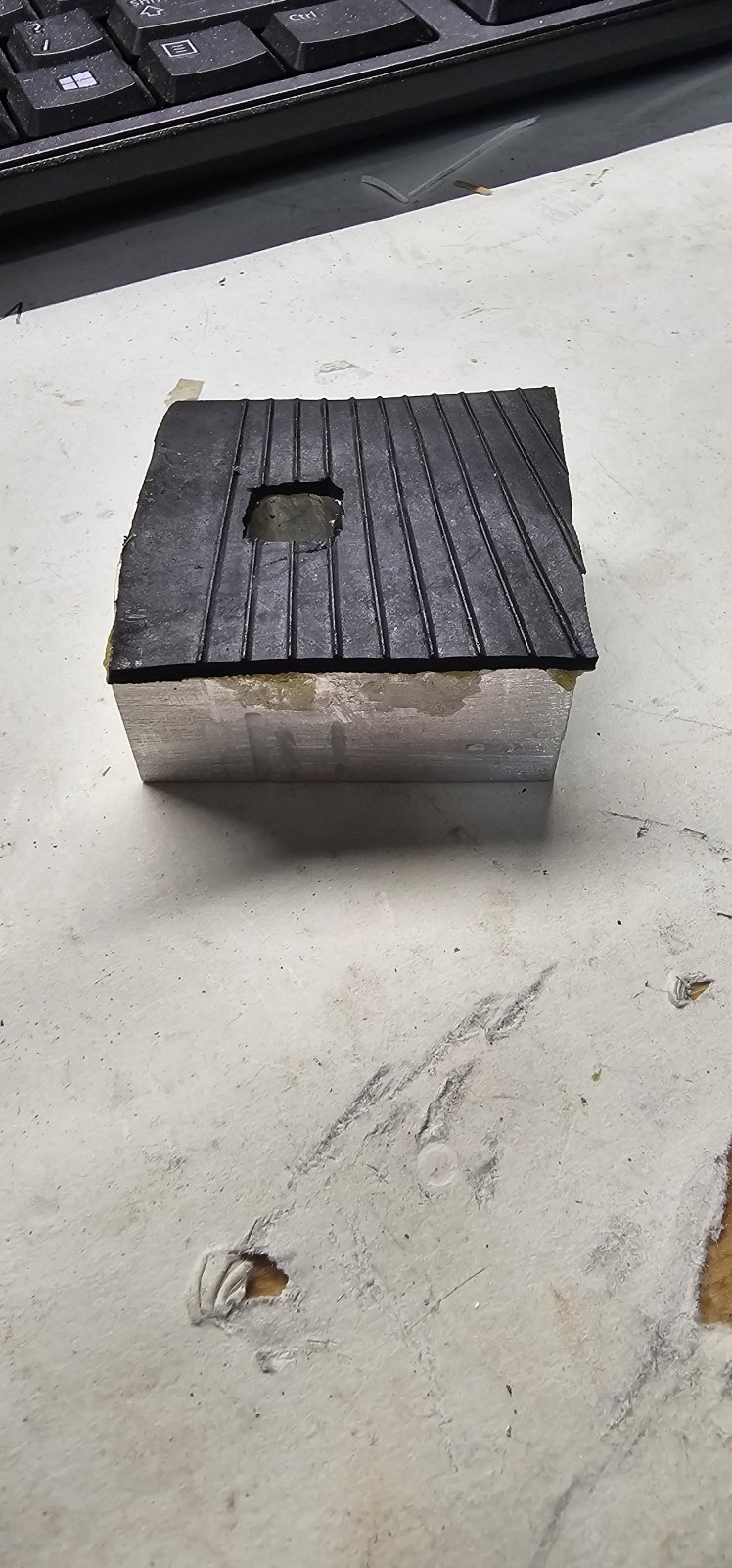

Anyway, was working on the car today, wanted to get the roof cut, but decided to work on my seat. Maschined some seat raiser. If someone needs something like that, let me know. Put some old tractor tube at the bottom, to protect the paint.
42649
42651
42652

Seems like the only things to do now is Moog K201285 in spot 1.
