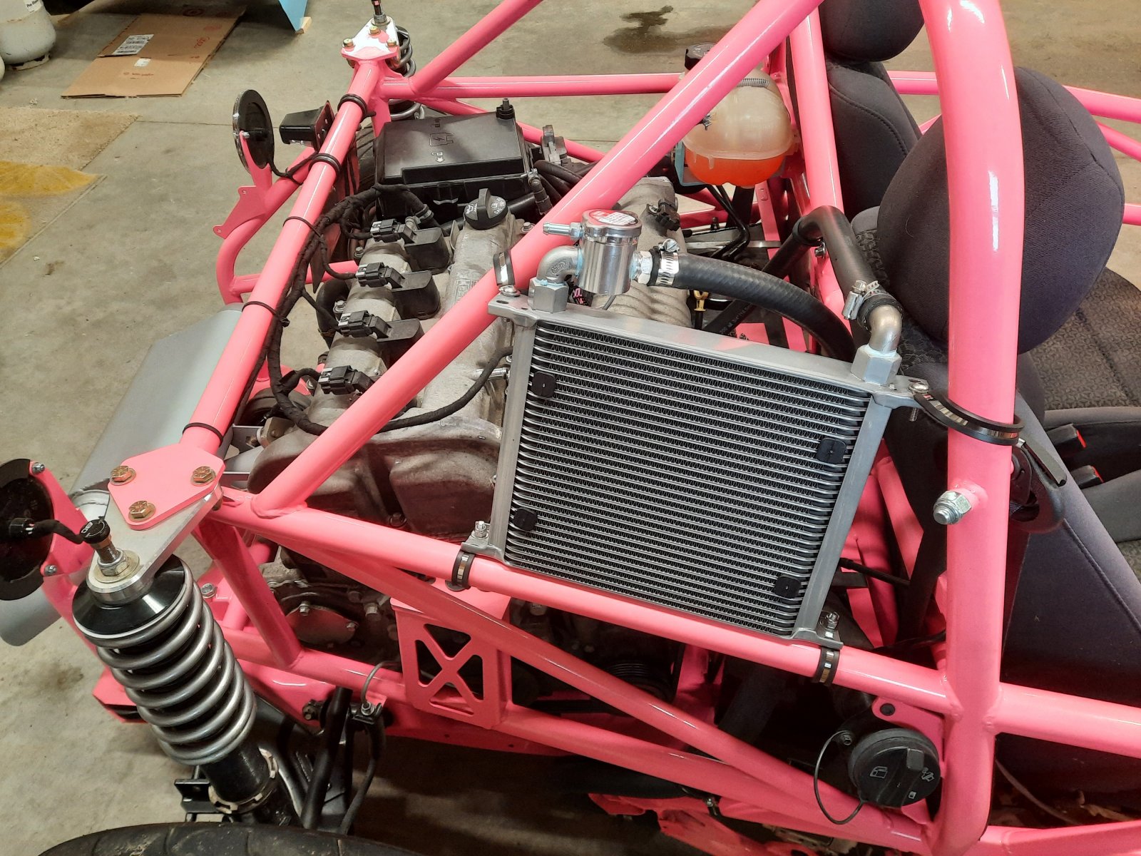

My 2.8 pulley'd SC is also regularly in the 130's, but that's what it ran in the cobalt also, which had a ZZP HE. Even after I added dual-pass and intake spacer when building the goblin. Never have any KR or noticed any issues. This is with the HE fan, no ducts.
