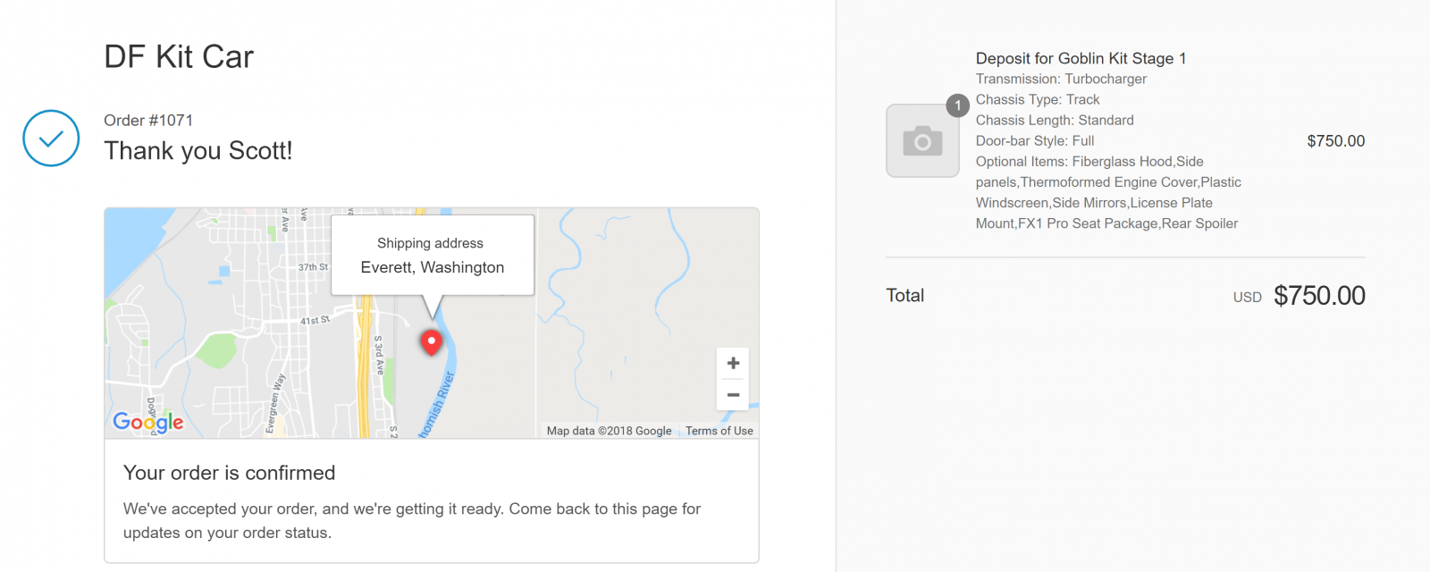

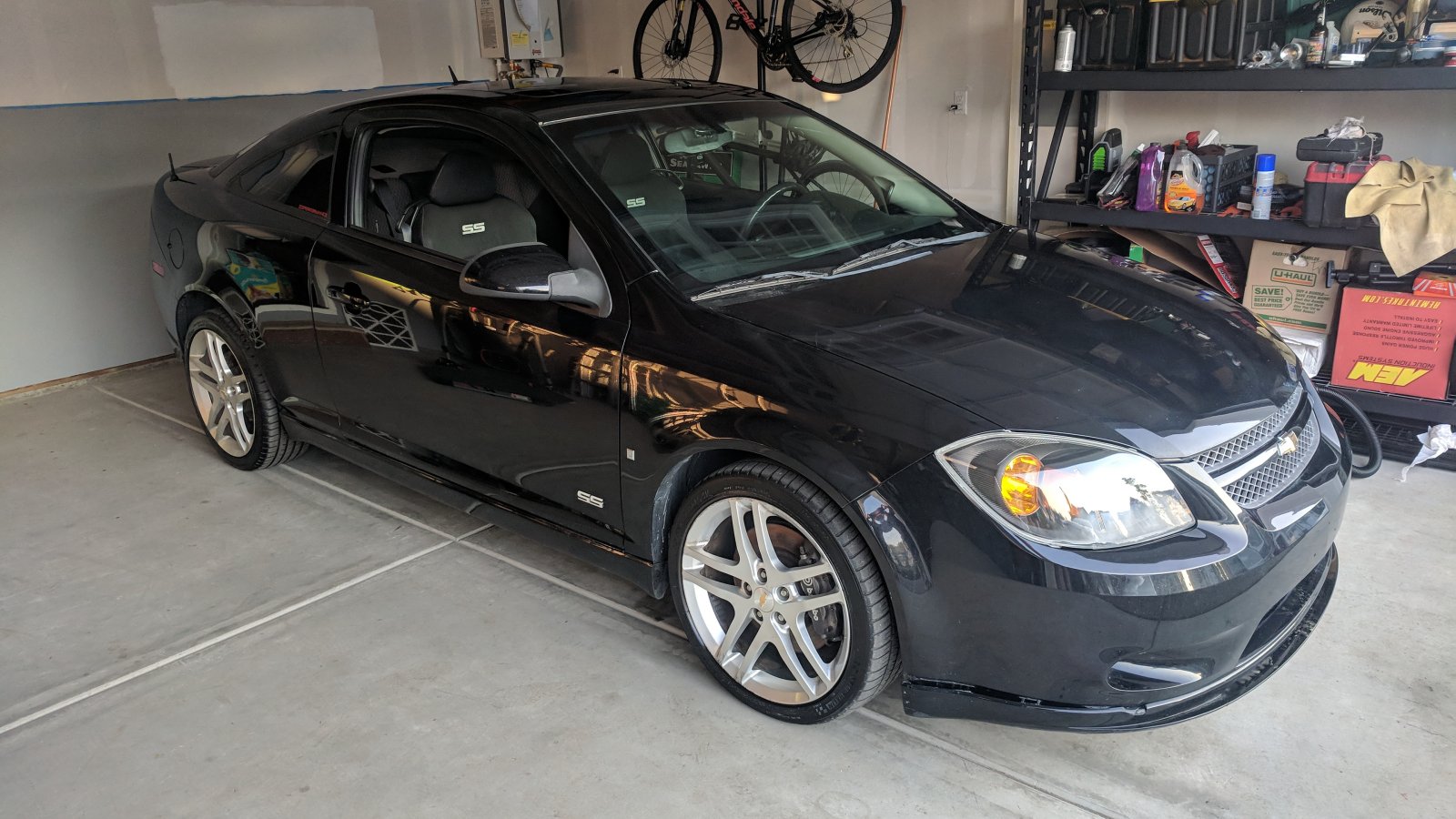

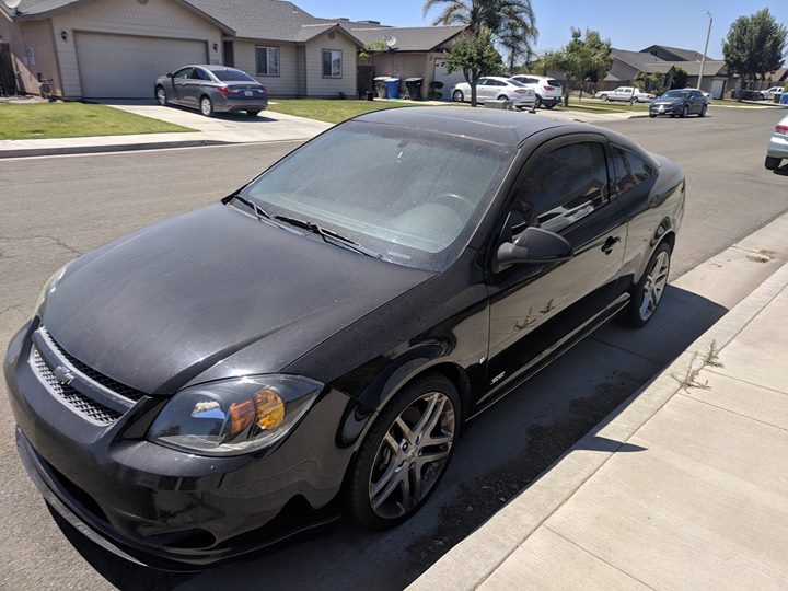

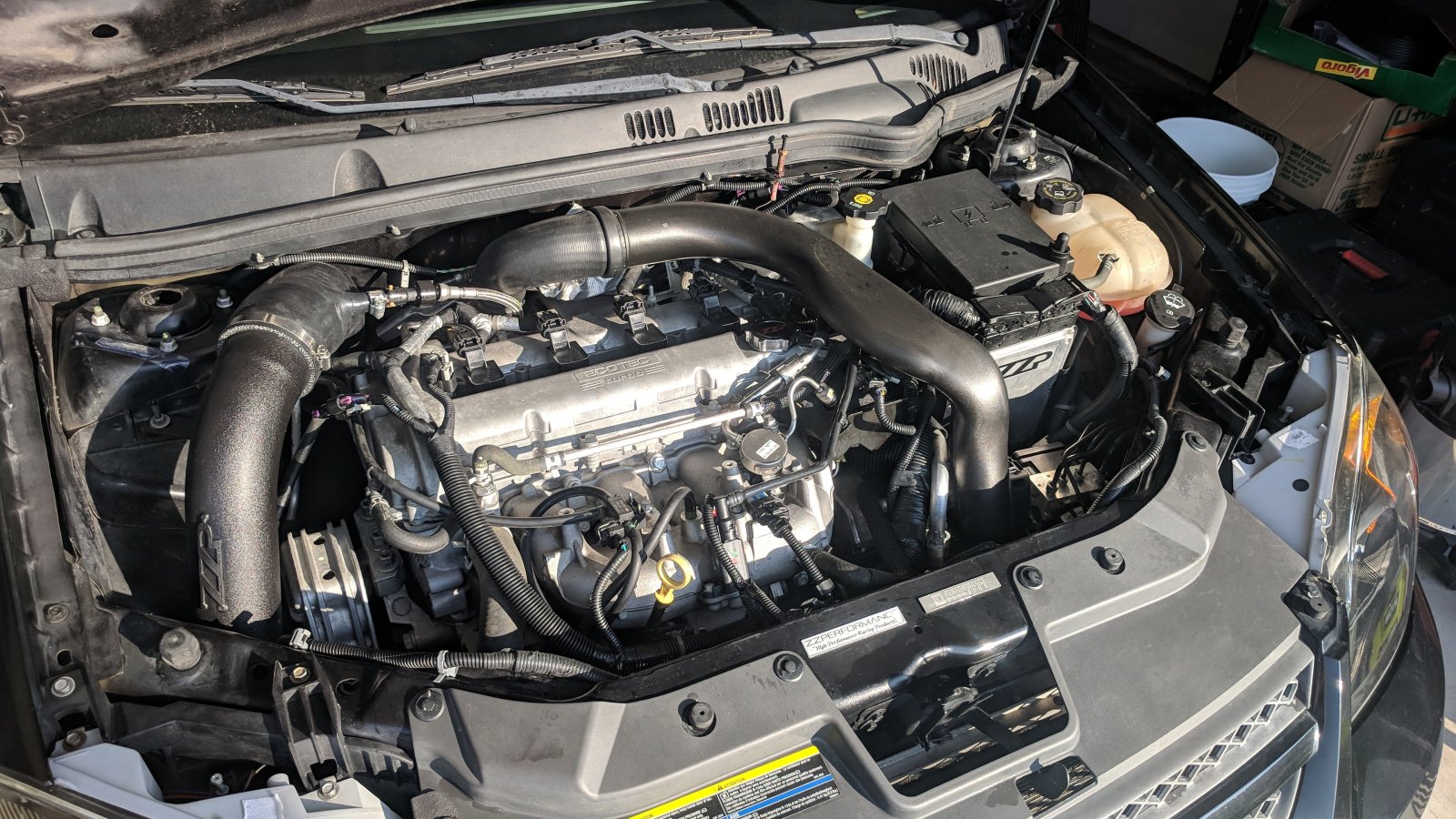

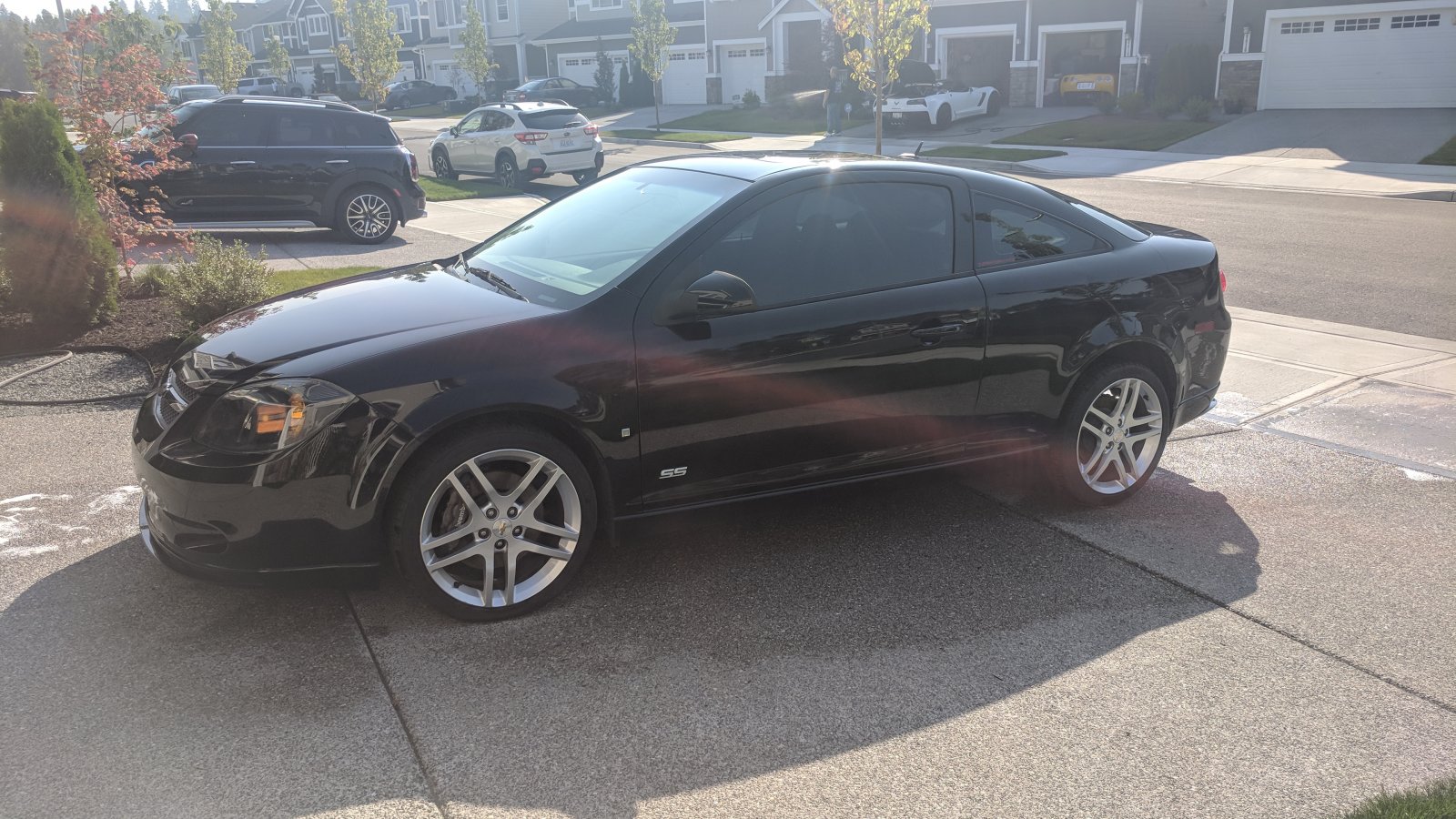

Well it hasnt officially started but I purchased my donor today. I wasnt in the mood to hunt anything down at auctions and I searched awhile for a SC car that wasnt just beat. Ended up buying an 08 TC for $2,300. The owner had the car inspected by GM and it has 50% during leak down in the 3rd and 4th cylinders. It is down in CA so I am having it shipped up to WA state. Overall the car is extremely clean and will provide an easy tear down. My plan will either be to build the engine, nothing crazy but slightly better than factory build or to buy a new engine and just drop it in.
There will be plenty of good parts to sell off which will work out great. The car has 76k on it currently.
I will be going with a track frame and look to have this completed over the winter time. Super stoked! I went back and forth between this and an Exocet but ultimately the cleanliness of the build, community, engine power and design won me over.

Congratulations on the purchase! Welcome to the build process. Glad to hear you finally found your donor car and with 76K, many of the parts should be still good to go.
While you have the engine out, it's a good time to take care of the 3 and 4 along with anything else that might need attention. Then you know you have a good strong, solid build. Being an 08, is this a turbo car? New piston/rings and clean up the cylinder and it should be good. Unless the owner didn't change the oil or run it low like Tiffany's car.
Good luck on the build. Let us know if you need any help.

Nice donor! A few ZZP parts, too bad some of them can't be used. These cars were always tweaked by someone. I wonder if it also had a tune on it by ZZP. Looks like it has a sticker on the ECM. You might consider flashing it back to stock with the new longblock, you never know what kind of tune it has on it.
