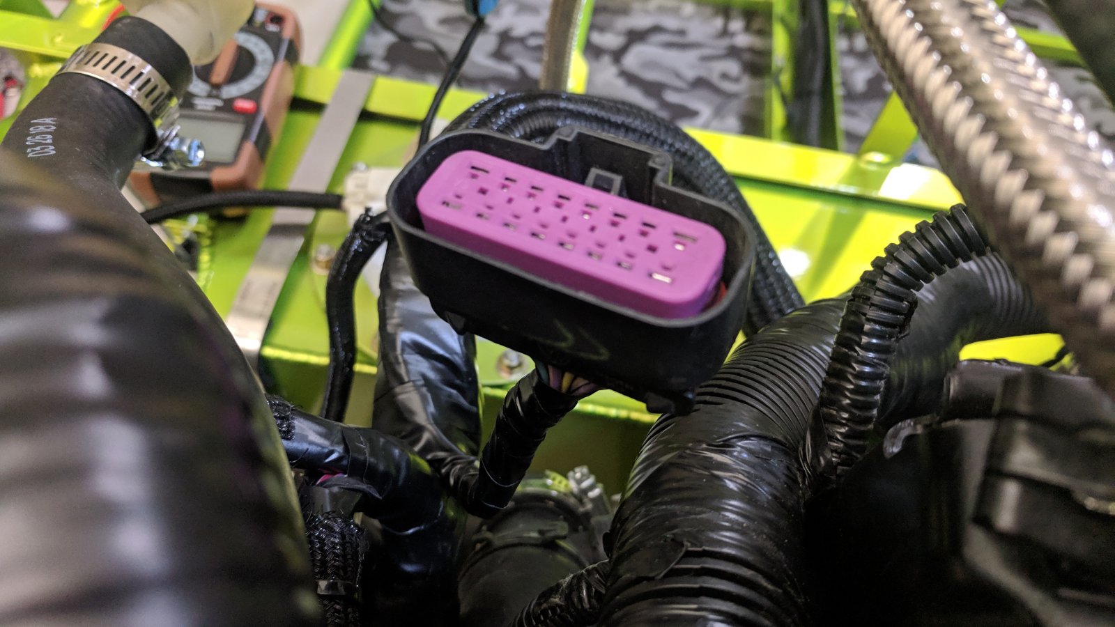

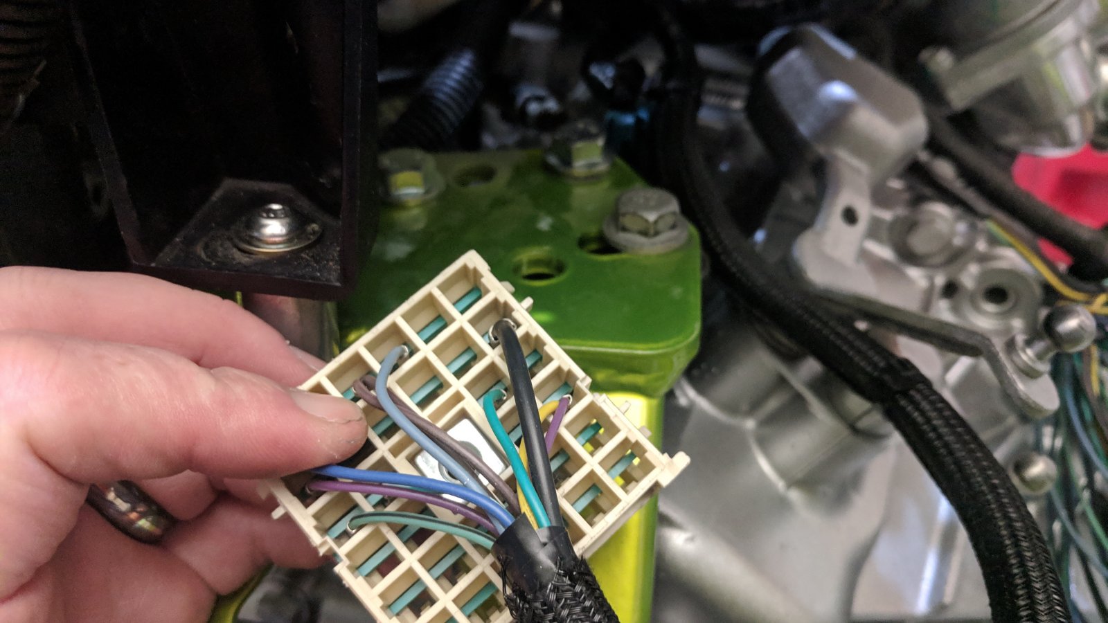

Should be okay then. Unless the ground is poor and with a heavy load it drops out, but I doubt that is the case at this point. Next step, follow the data wires from start to finish, without the communication, it will refuse to even try to start.
The data wires run from the BCM to the smaller of the two ECM connectors. I'm pretty sure they run to the BCM connector that plugs in vertically with a locking handle. I don't recognize the smaller connector just yet.

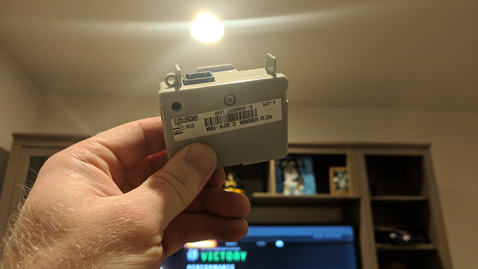

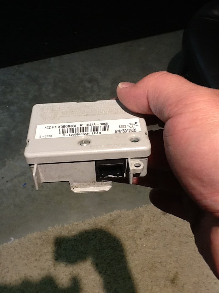

I don't know the exact details but I do know it's important! It's part of the security system. Hopefully I'm wrong and you can get by without it. It's the RF for the remotes and something else.
IDRVSLO
I literally held this thing up as some sort of trophy when I found it. Looked important when I was pulling stuff I guess...so I kept it.
Hoping I can plug this in and get some results before ripping apart the harness.
