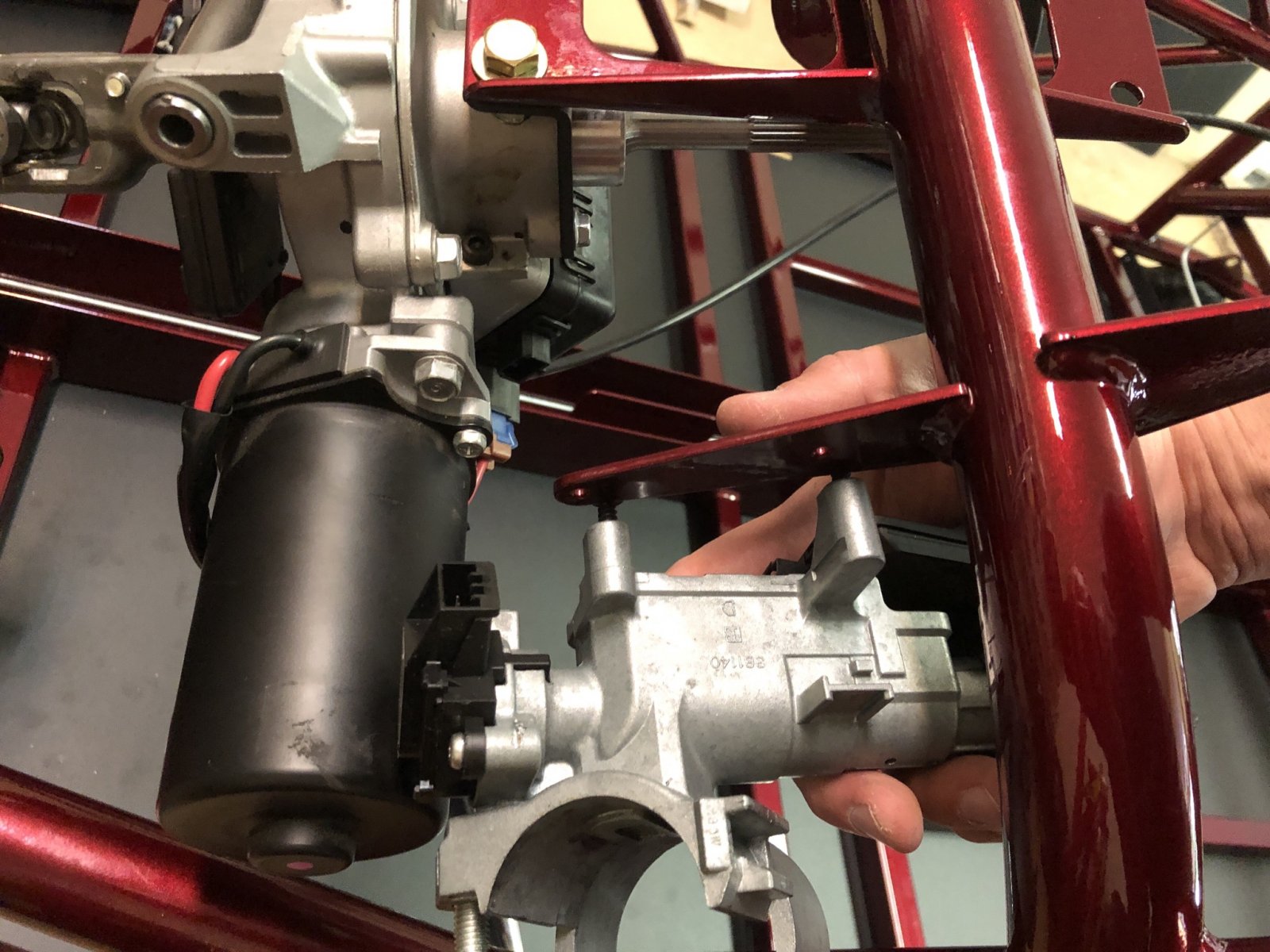

What am I doing wrong here?

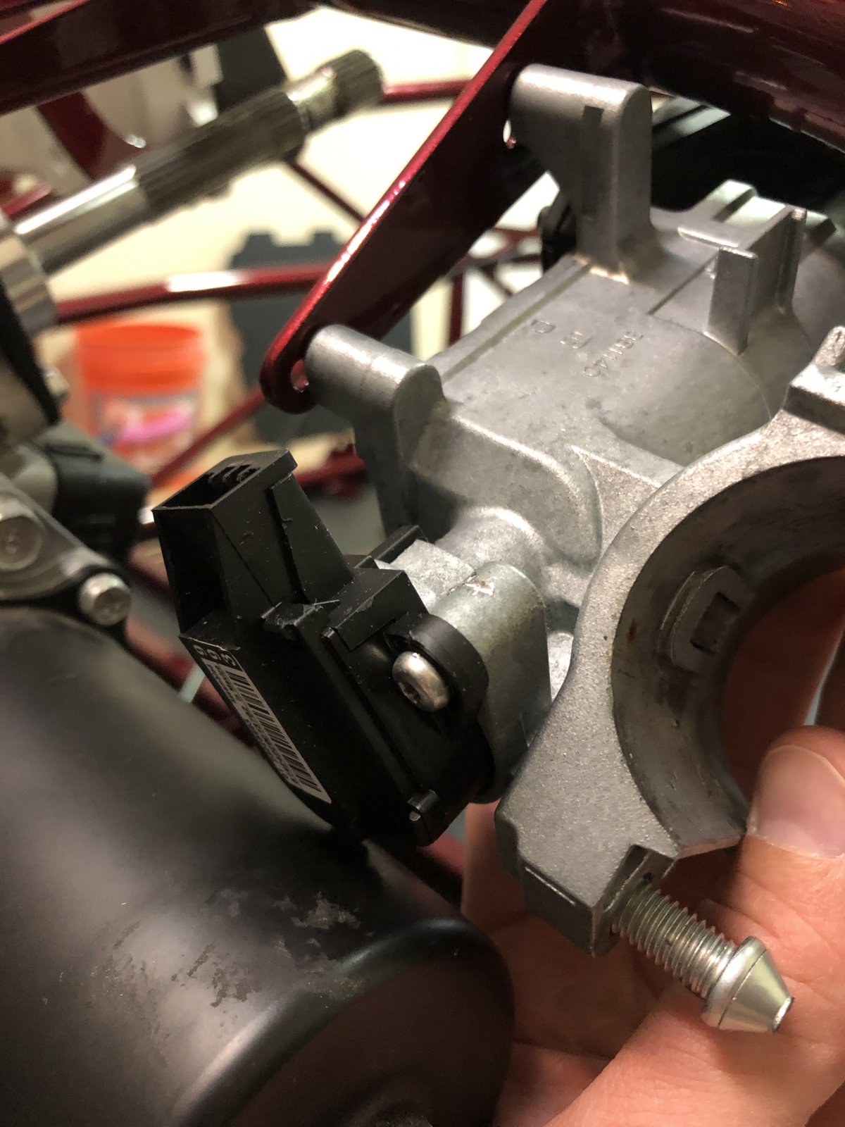

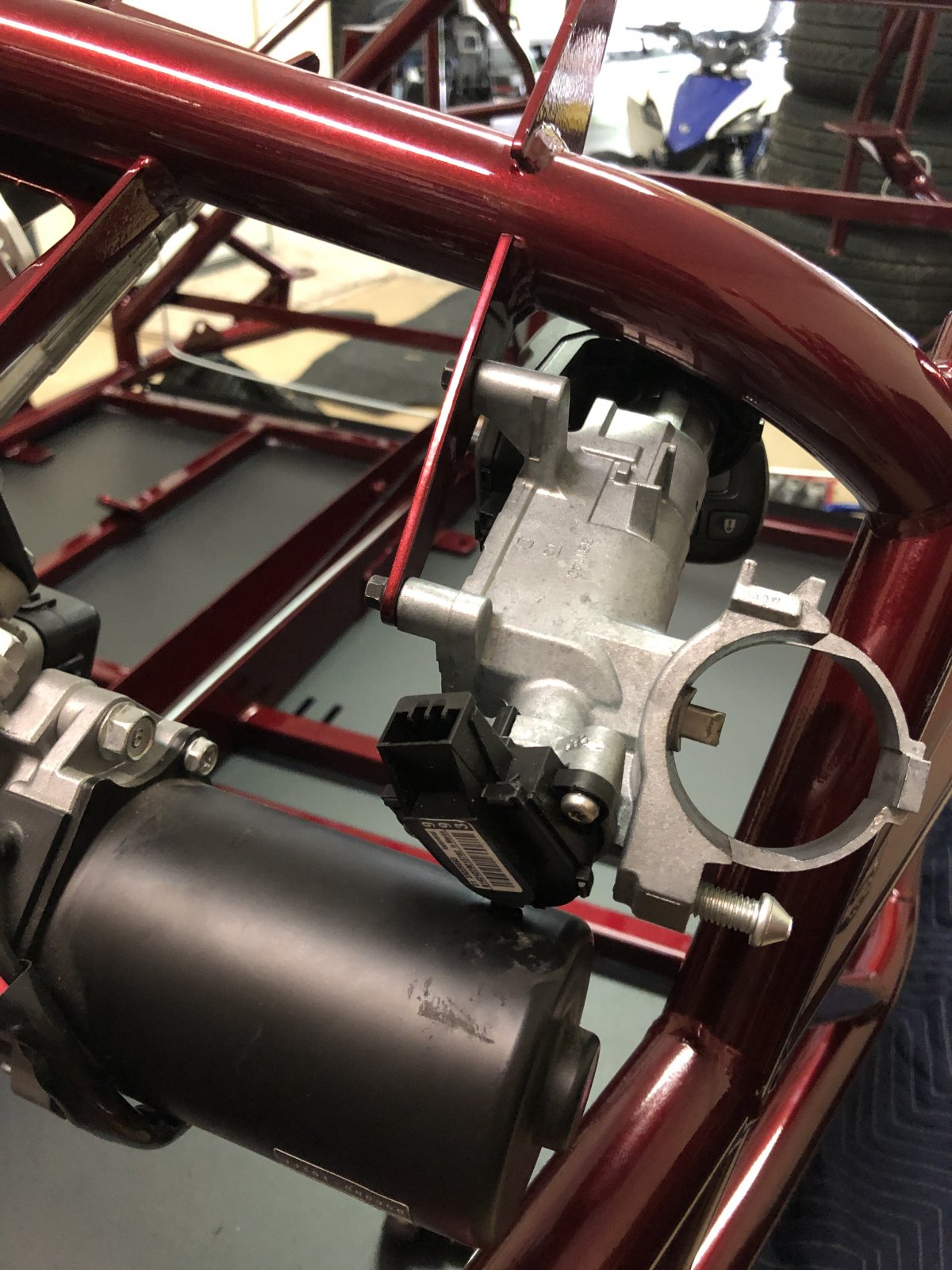

The ring doesn’t have to be trimmed. I just did that since I had time waiting in the frame. I didn’t care for the loop-of-nothing look.
If you eventually want to install a footwell cover you will need to trim the ignition switch and bend the forward end of the switch inward a little.
JSATX
I drilled out the threaded holes in the ignition switch body, used a longer bolt and nut that way you can put the switch on the other side of the bracket. That moved it over almost a full inch and worked really well.
