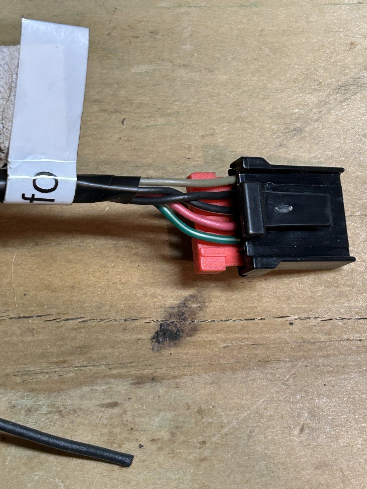

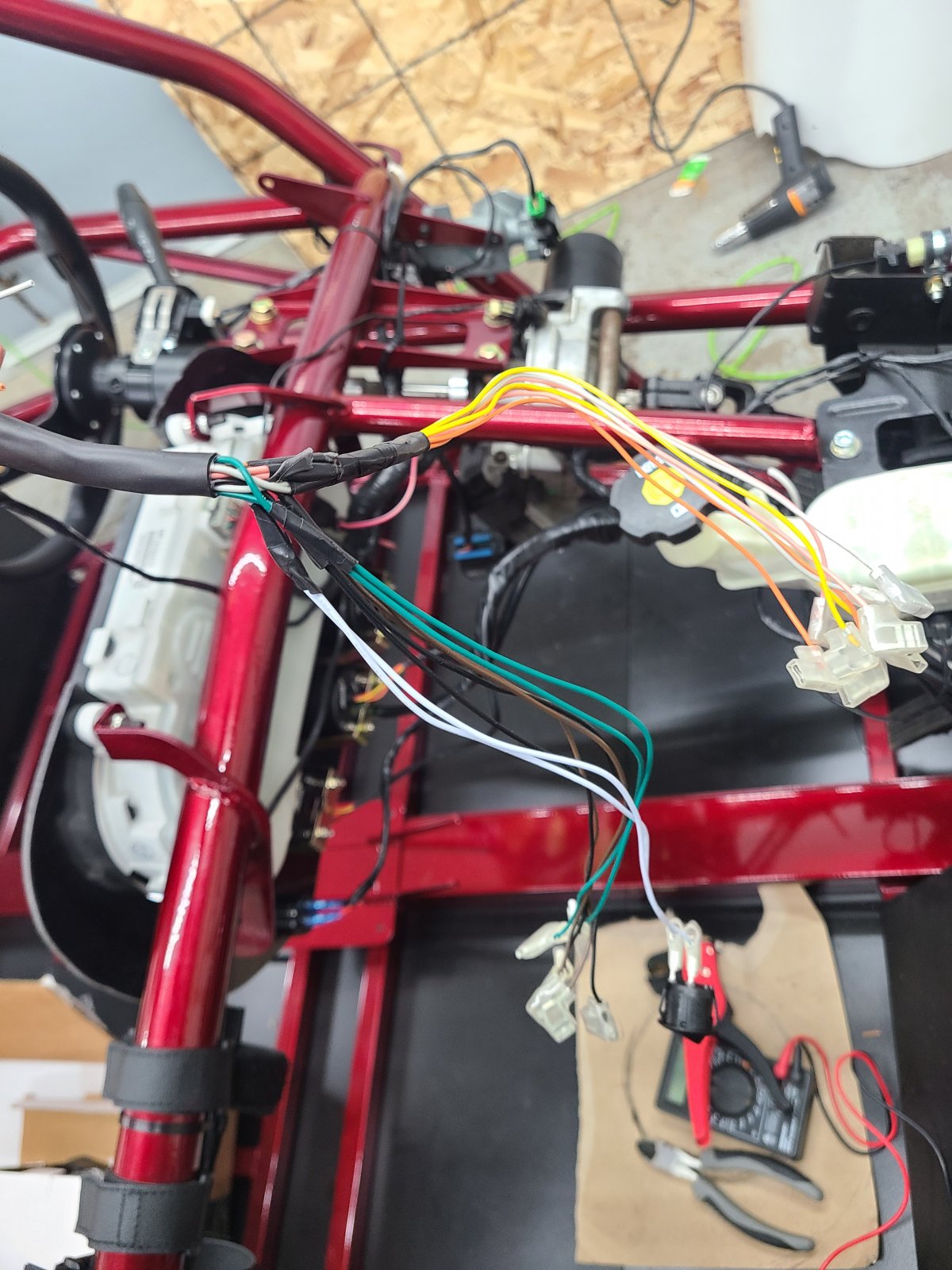

Looking for some help with the button panel wiring portion.
There was no instructions with the buttons and wires.
According to what I have found on the forum it calls for
Black factory - black button wiring. Ground
Tan factory - brown button. Horn
Whitish factory- white button hazards
Green and white factory - green button and the info button doesn't work
How do I make the information and return work? What am I missing?

R
Actually the steering wheel that came off the car ended up being late model.
My car was a mix of early snd late model parts. It's been fun. I think I got it figured out. Thanks Ross
The 2007 wiring is considered the early model wiring.
You need to find the info return buttons on your wiring harness.

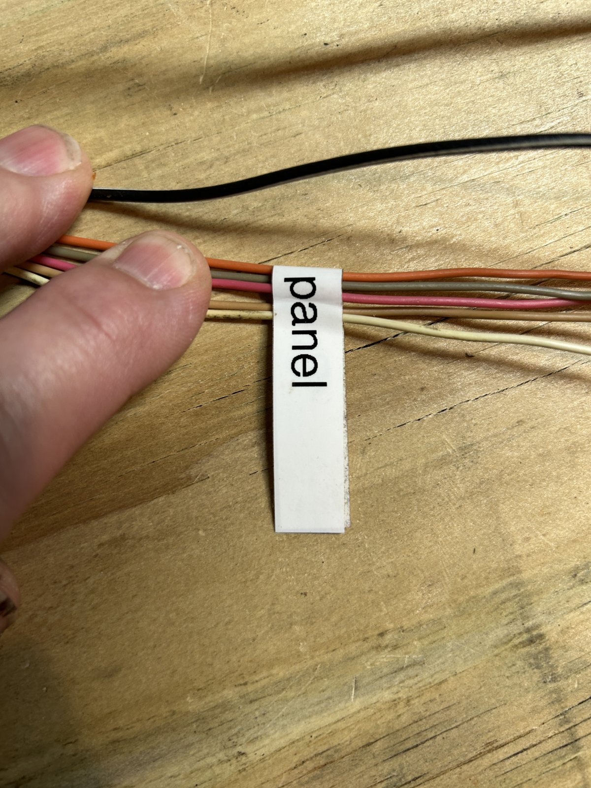

This should be a huge help, as I was having the same question. I thought I followed the wiring videos pretty closely, but I have only 5 wires set aside for Button Panel, plus a ground I added:
38886

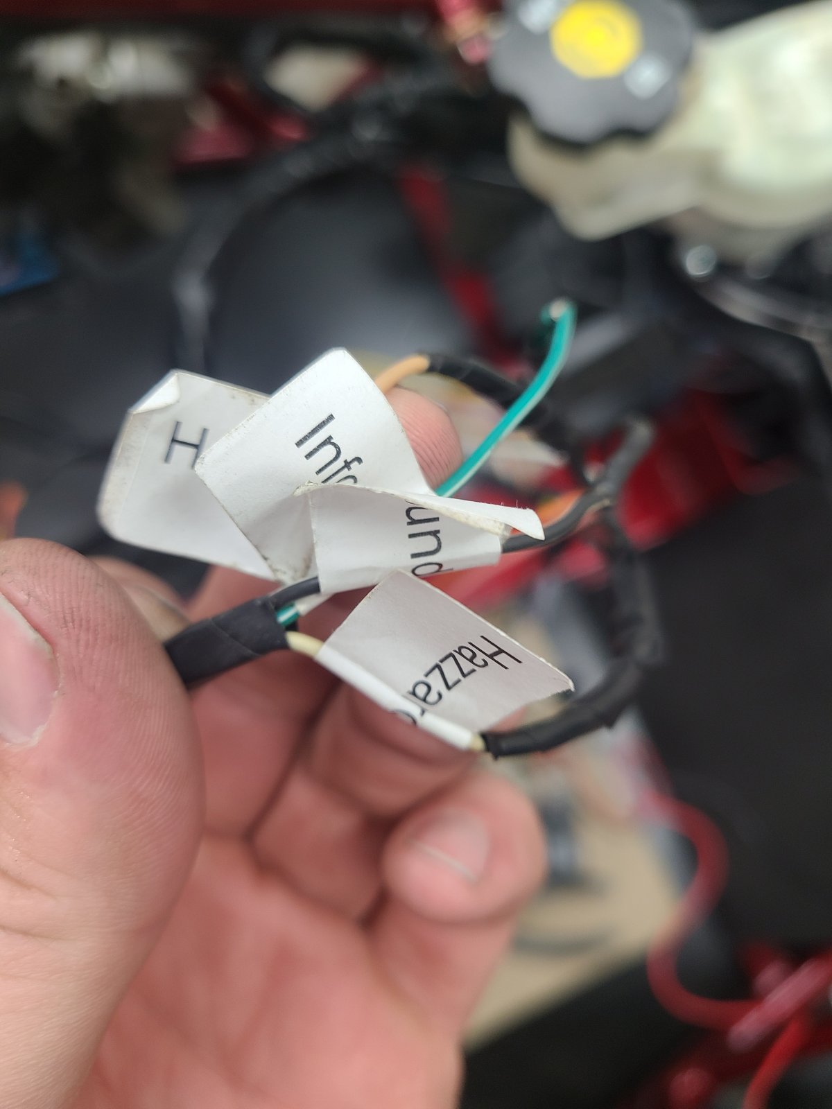

I preserved my info button wires since I don't remember Lonny addressing them in the videos:
38887
I was hoping wiring instructions would be included with the button panel kit, but apparently they aren't. :( Has anyone done a wiring diagram for the button panel?

It’s the pink and green that you (should) have knotted together during the harness videos. Here is how I wired it and it all works correctly.
Sluggonaut
I used labels instead of knots because I watched the video series all the way through before I started and knew I wouldn't remember what all the knotted wires were for at the end. Maybe this is why I don't recall having any difficulties with the panel wiring. It was simply matching colors according to the correct early/late model diagram.
