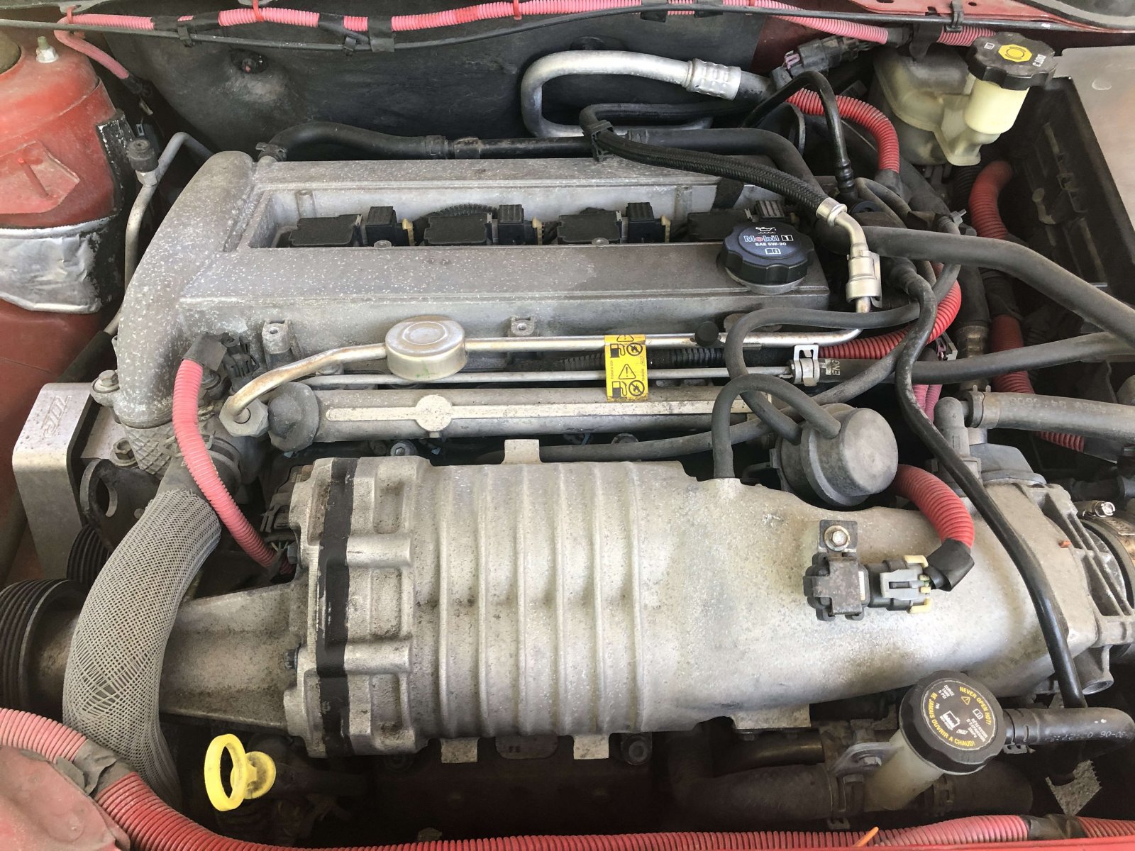

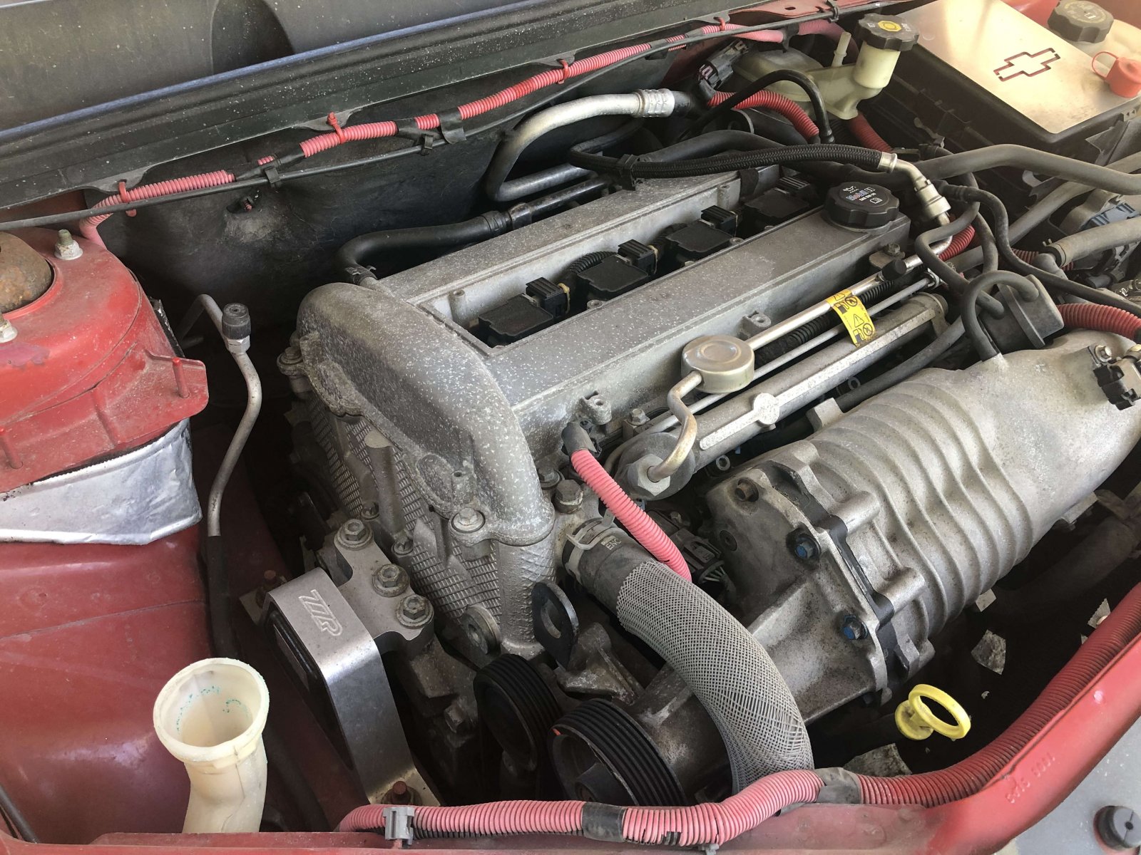

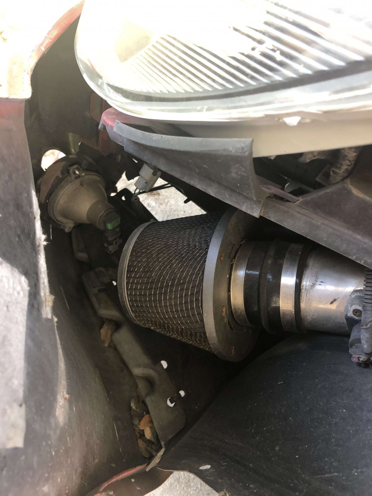

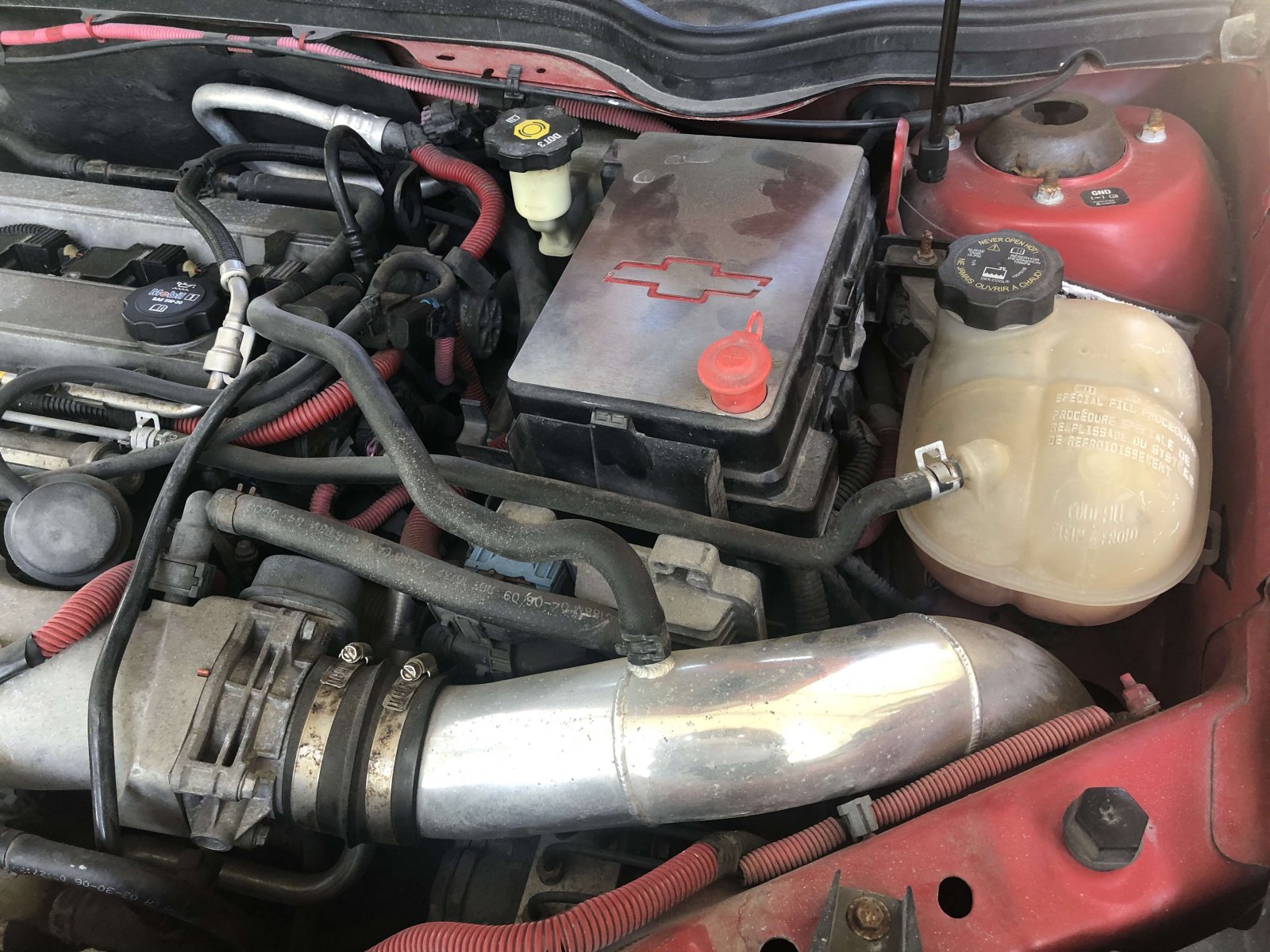

Here are a few pics. I'll look into HP Tuners.

I can tell I'm getting old. I find it interesting what has been done to these cars by the younger generations. Too be honest, I did things much like this, so I'm not dogging on them.
ZZP engine mount.
Looks like the supercharger has been opened for some reason, the black plate is not normal.
Red loom on random wires
plate over the fusebox, why?
CAI

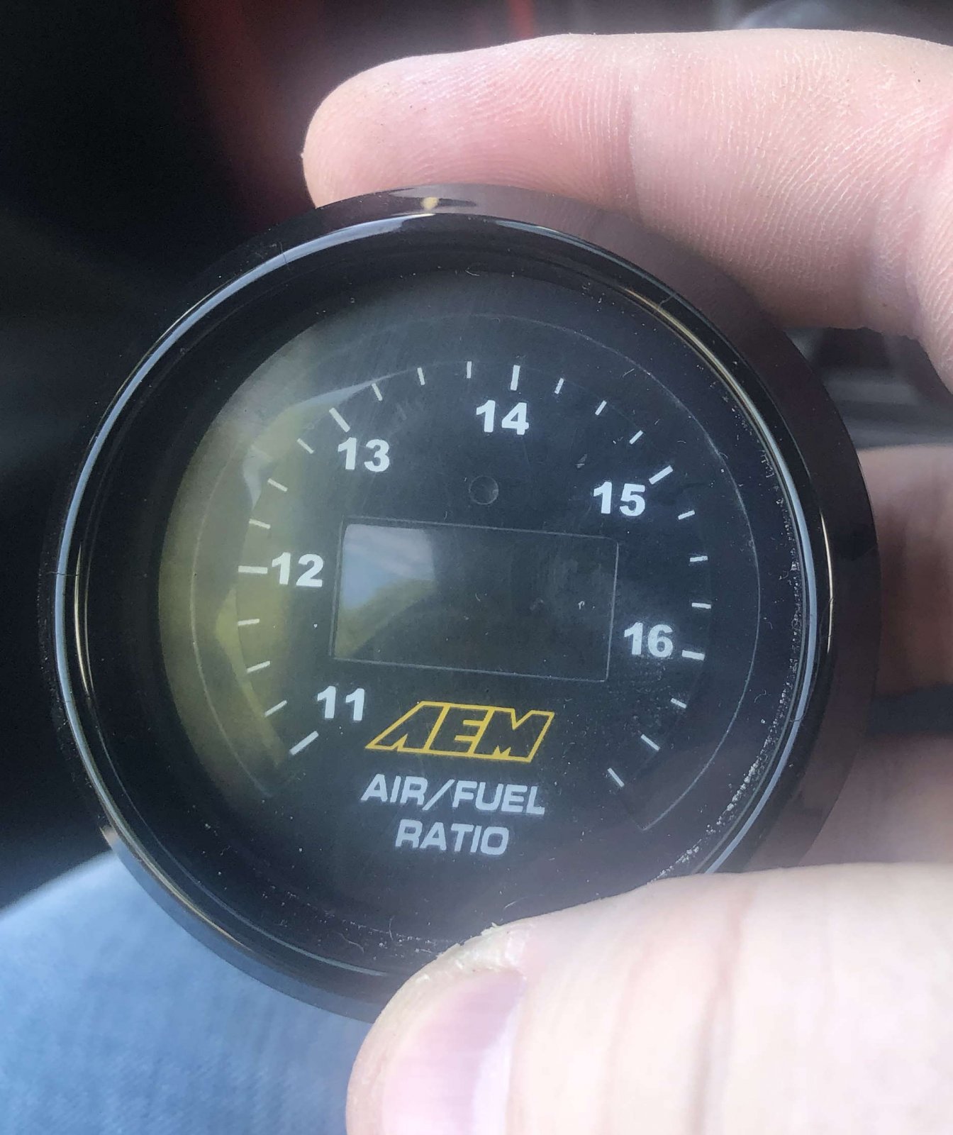

Good news! I found an AEM air/fuel ratio gauge crammed into the little bin on the driver's side that also has the trunk release button.
Bad news! It doesn't work. The photo is from the car running.
