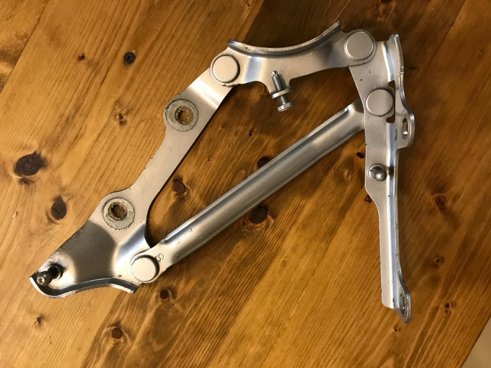

I took a short movie clip showing the motion and how the hood back edge would actually move forward as it raises. But, I cannot upload a .MOV. If you want to watch it, PM me with an email address. And then an address to send them if you decide you want to try them.

Very interesting idea! Since I am not using the stock gauge cluster, and plan on having a quick disconnect steering wheel anyway, I'm not sure if I need the more elaborate hinge setup you are proposing. Also, my girlfriend says we saved those hinges. If we did, they are in my NY garage, as we are snowbirds with about 4 weeks left here in Florida.

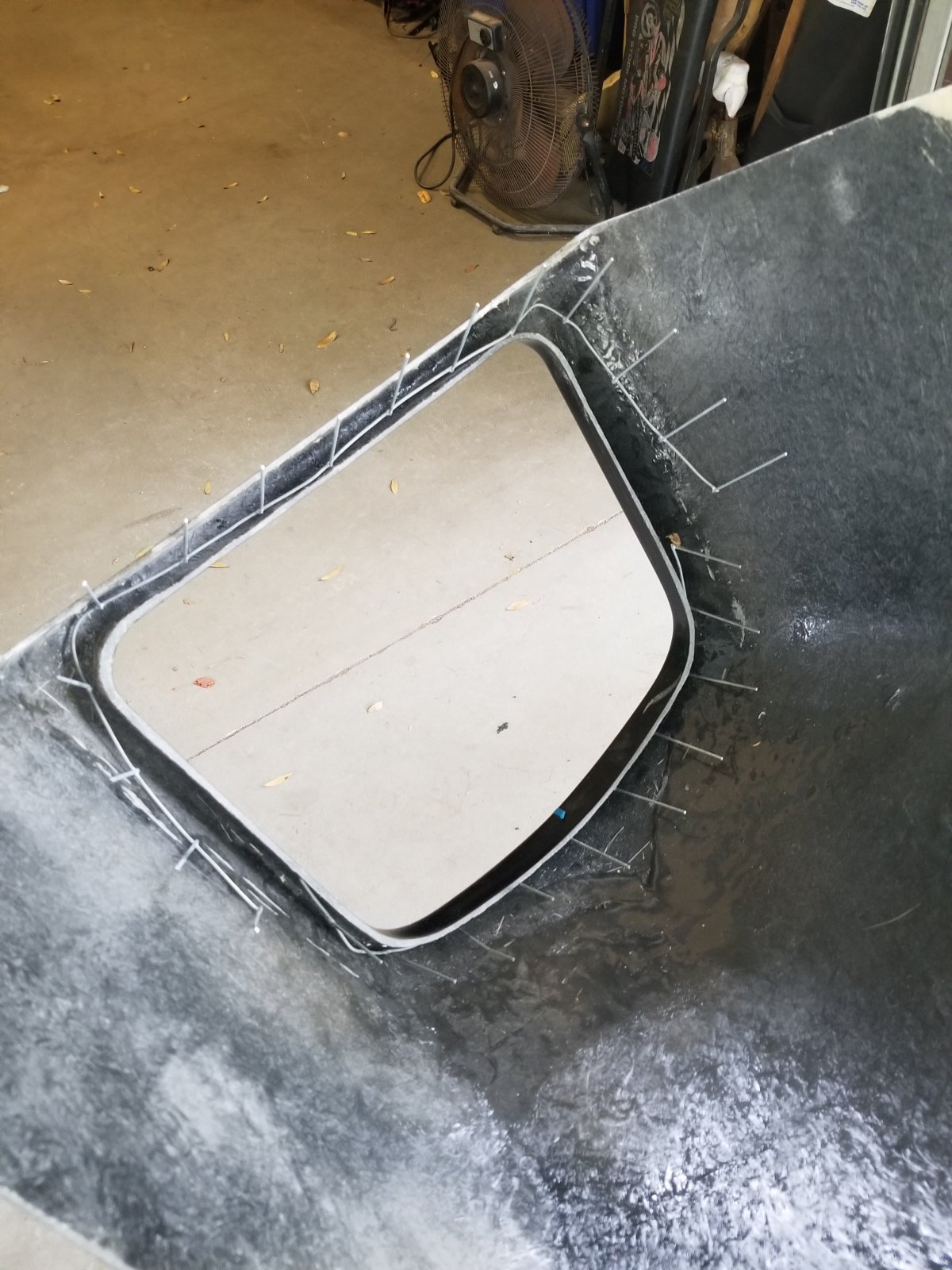

No. I have it. One reason might be I used fiber reinforced bondo in the front to hold wires to retain the radiator grill.see picture

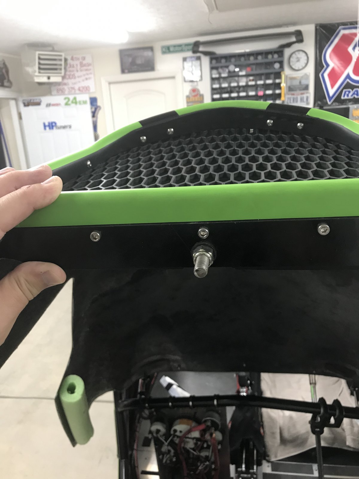

KLMOTORSPORTS

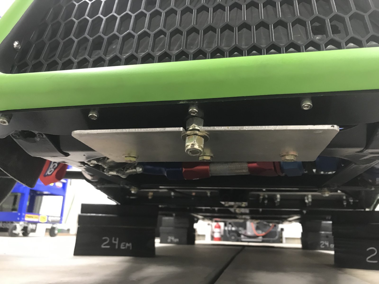

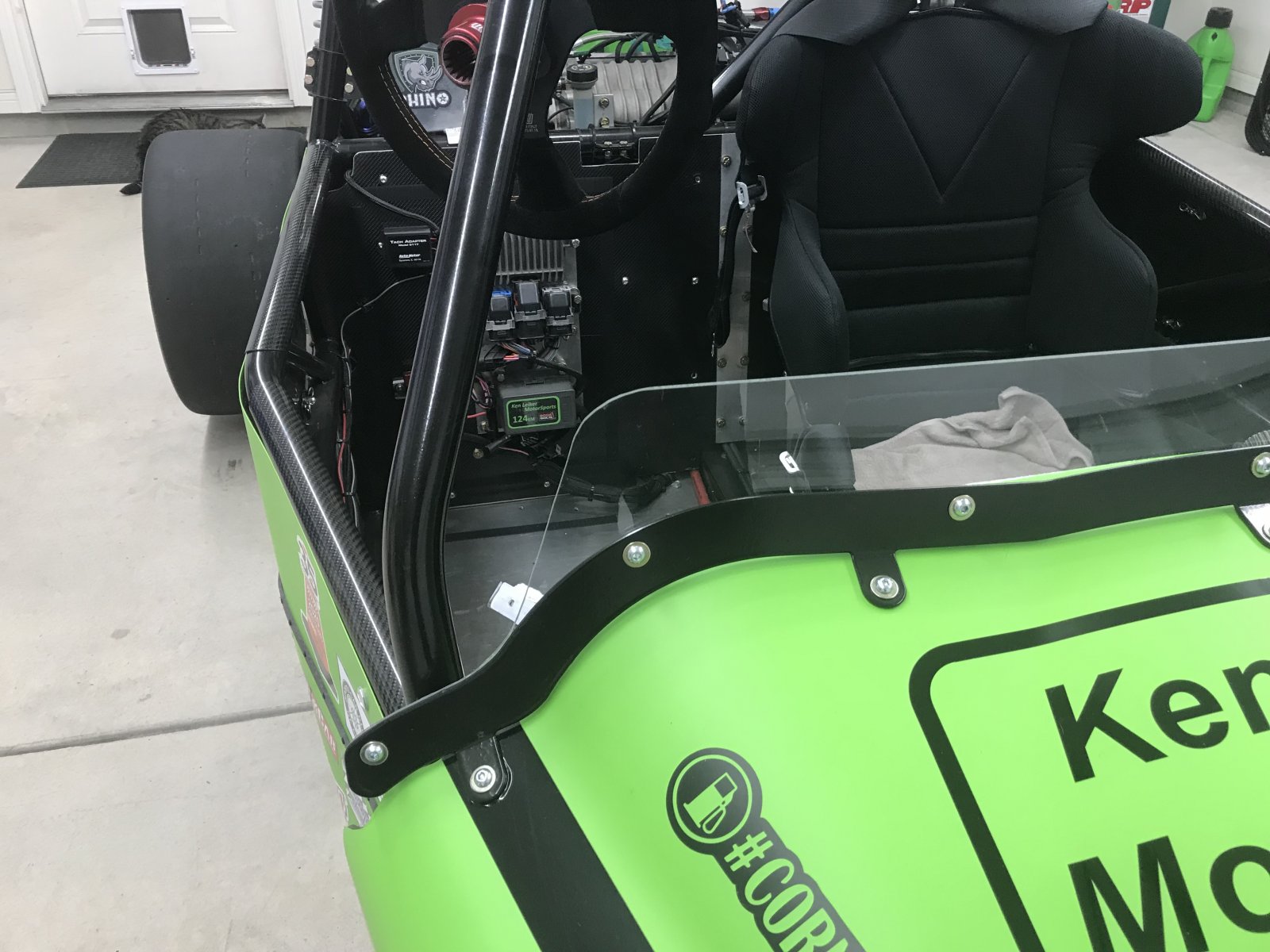

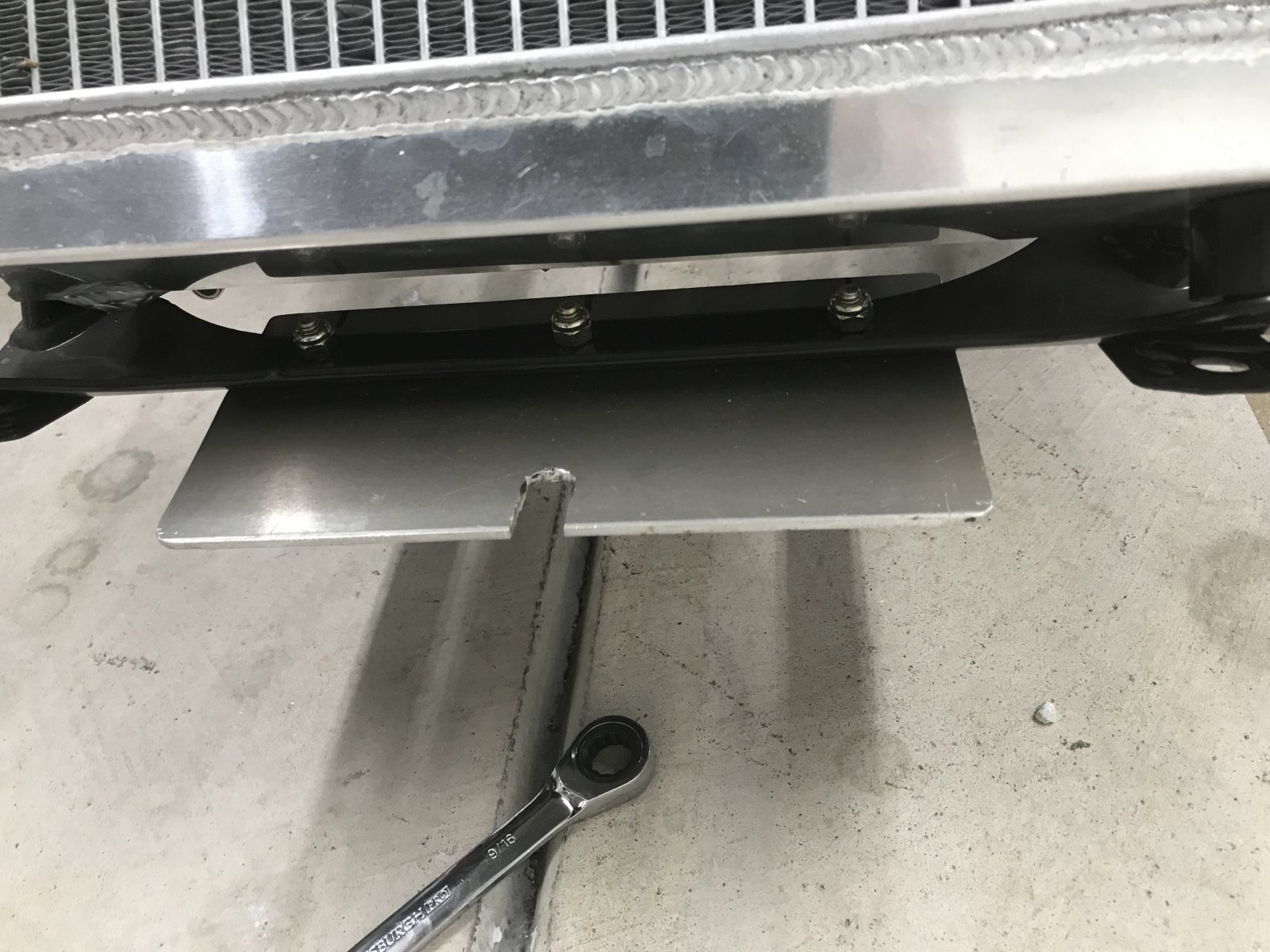

Here are photos of my hood….lifts all the way up. I cut the windshield so it wouldn’t hit the bars and made a plate that bolts under radiator. Simple bolt comes off hood and holds it real well….pretty simple, but effective design
