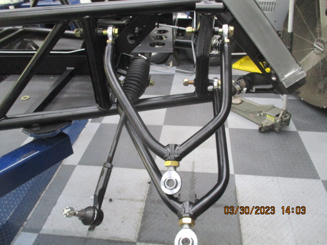

V1 Is this gap normal in the front control arms?
wallace58
wallace58

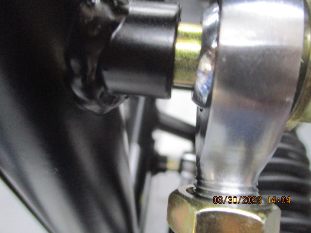

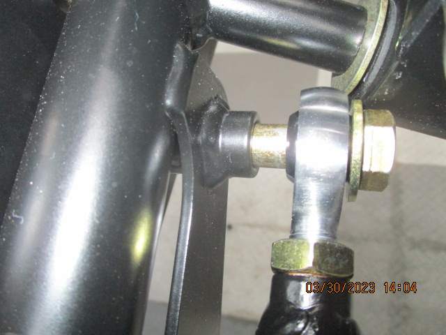

I was watching the archived videos and assembled the front control arms as stated. I have a gap at the back of the arms to the frame both top and bottom. Is this normal and you just torque them down? Or do I have something missing or wrong? L to R arms, top arm gap, bottom arm gap.

I am pretty sure you have them on right. And I think that is fairly normal, mine were also showing a bit of a gap like that. You should be able to torque down and be good to go.
