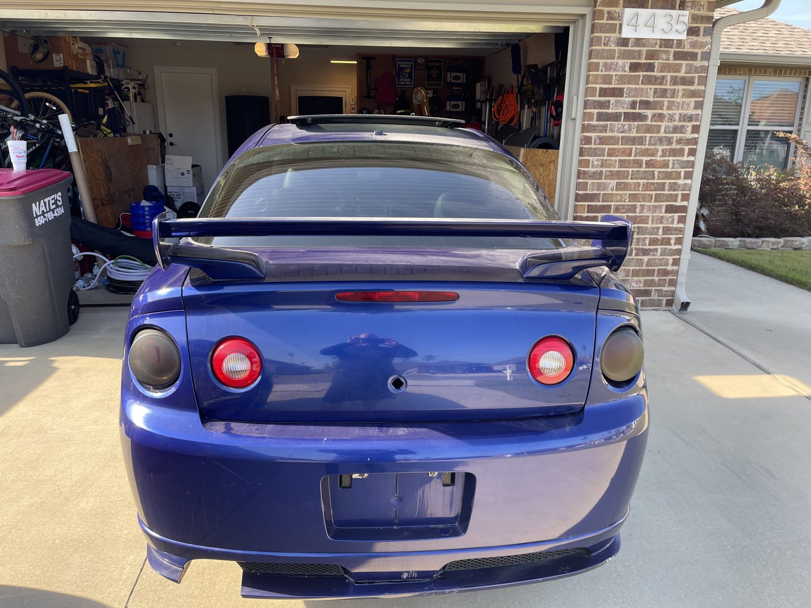

Got the donor off the trailer, had to use a jump pack to get it started. But fired up first try. Something wrong with the clutch, have to have pedal fully to the floor. If you move your foot half an inch it tries to jump into gear and kinda hard to get into reverse. Was able to take it around the block. Seems to run good, will have to replace the turn signal switch, doesn’t turn off when turning. But it’s a start.

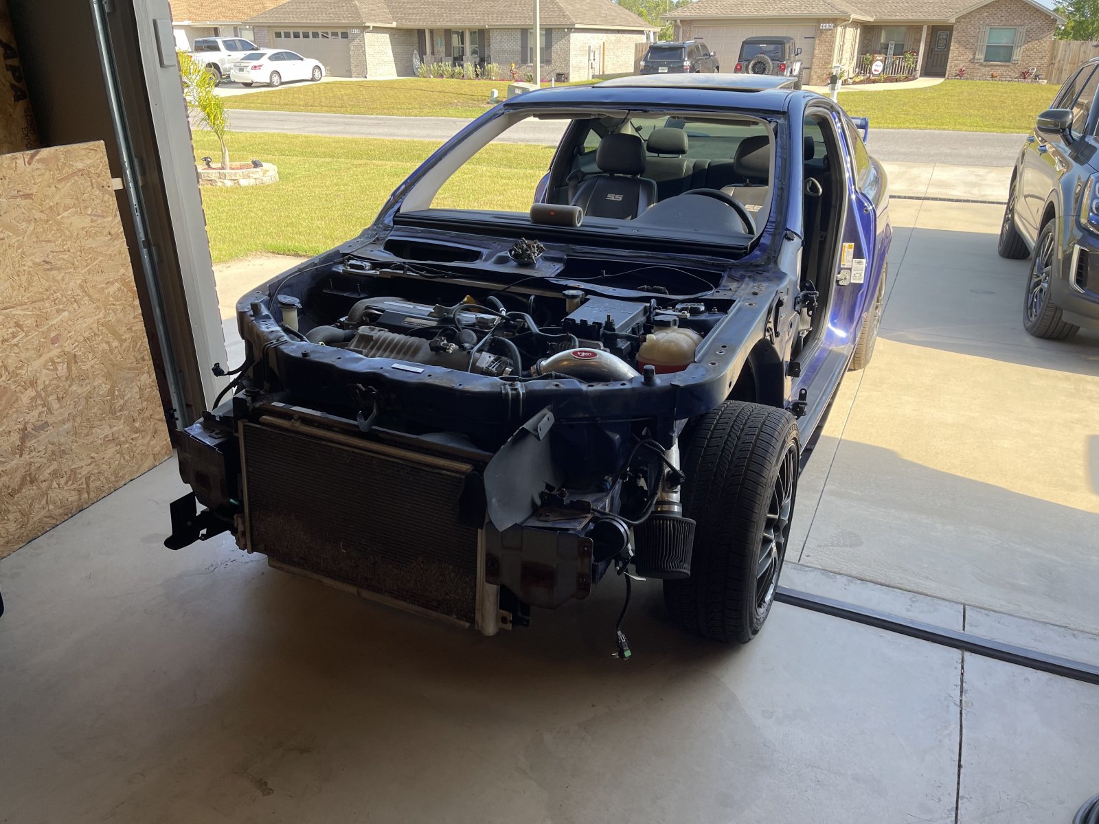

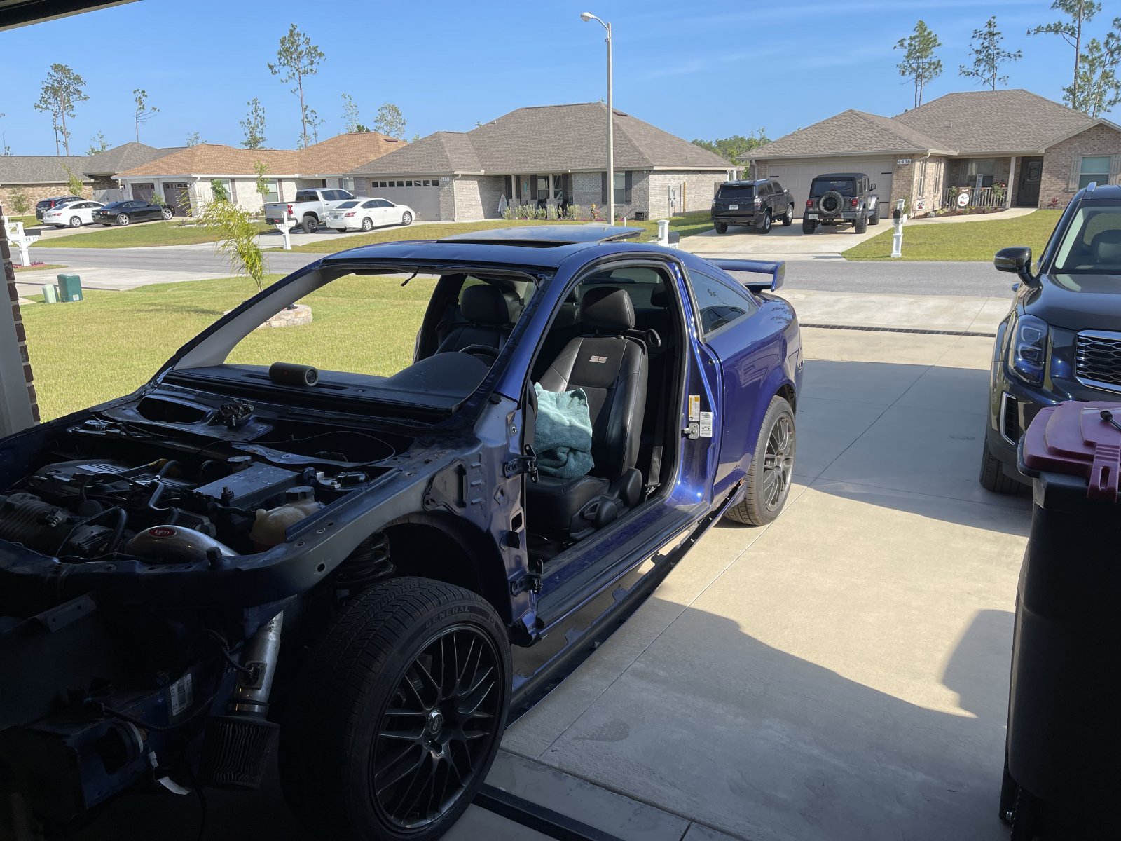

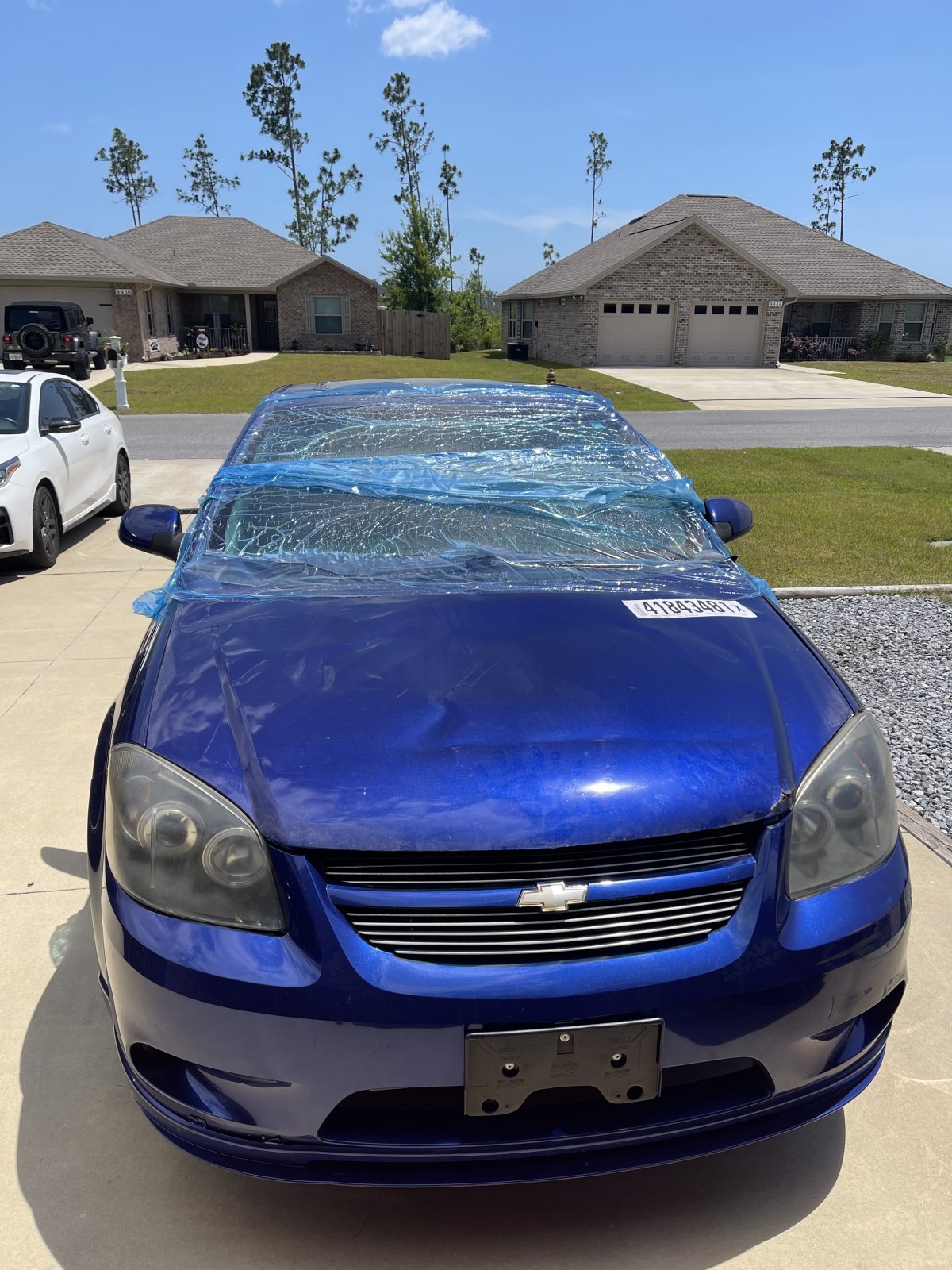

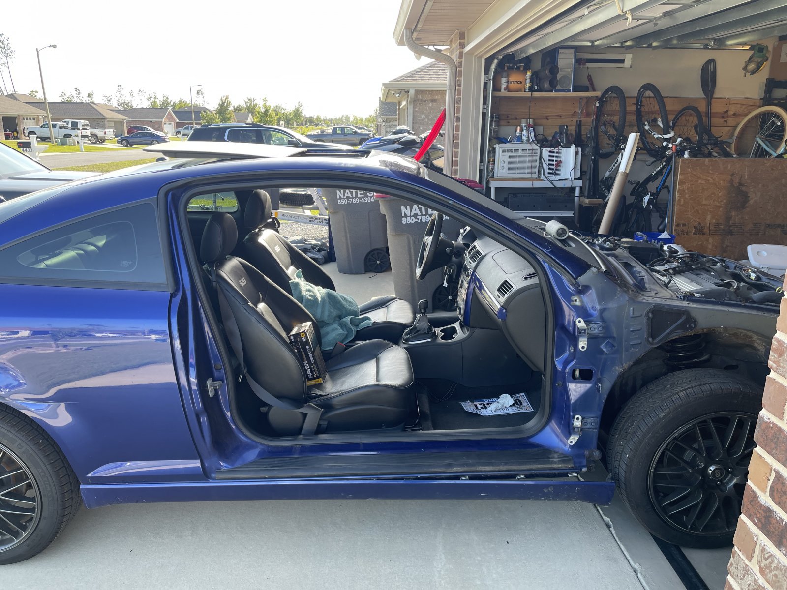

Had a shattered windshield, that was fun to get out. Only cut myself twice and nothing bad. Got the doors, fenders, front end off. Started removing the wiring in the trunk. Figure I would knock out some of the easy stuff. We got the car cleaned before tear down, can tell this thing is from the north, lots of rust.
