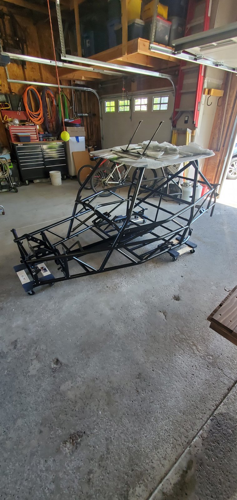

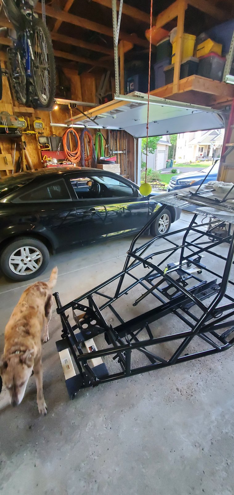

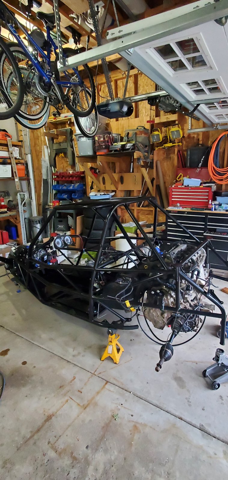

Well, figured I'd start this now. Only pictures I've got are the ones from DF. Donor is an '08 LS 2.2 and it's under a fair bit of snow right now. So I've just been trying to plan everything before for the begins. Plan now is to just get it running, then build a new engine with my kids and throw a turbo on it.

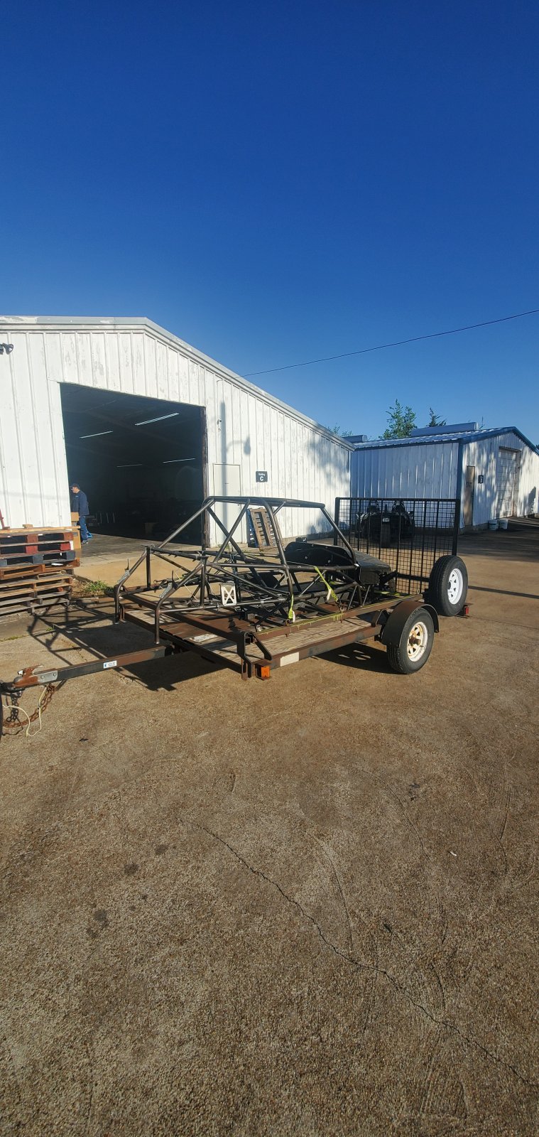

2000 miles in 2 days and the Goblin is home!

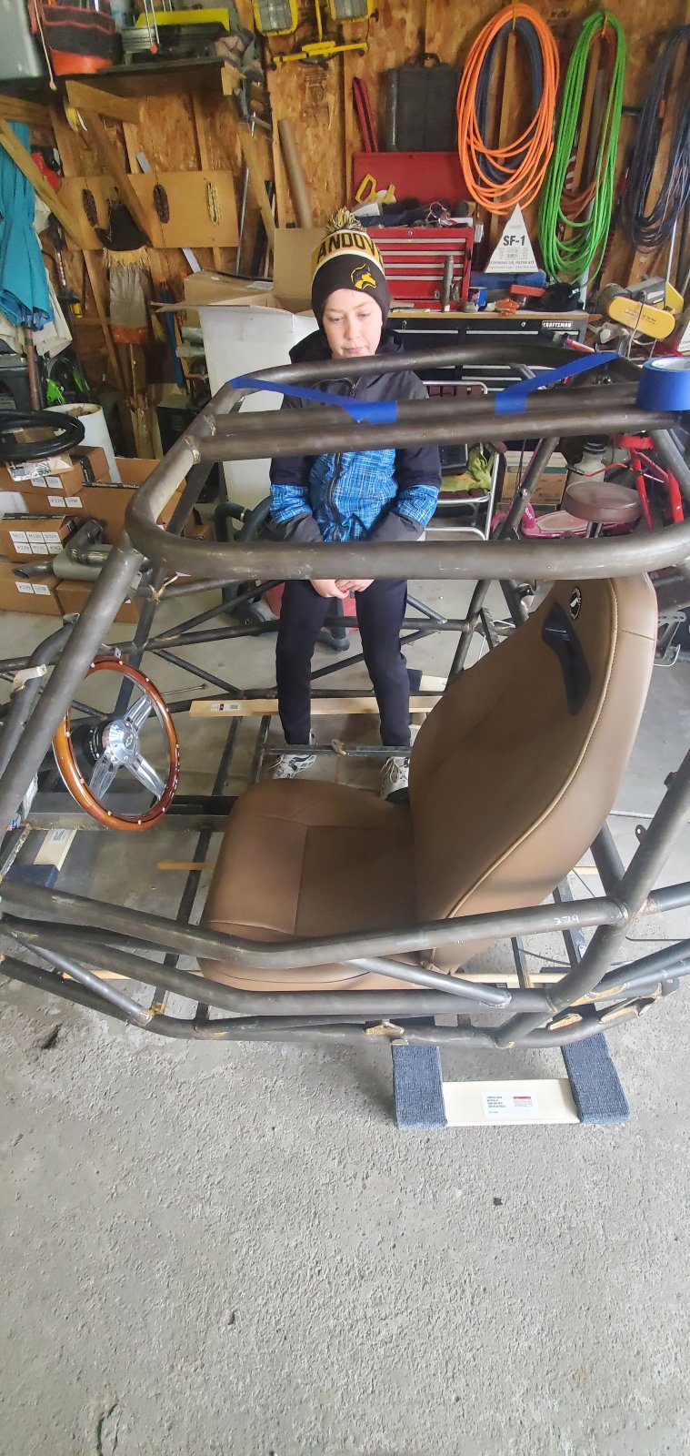

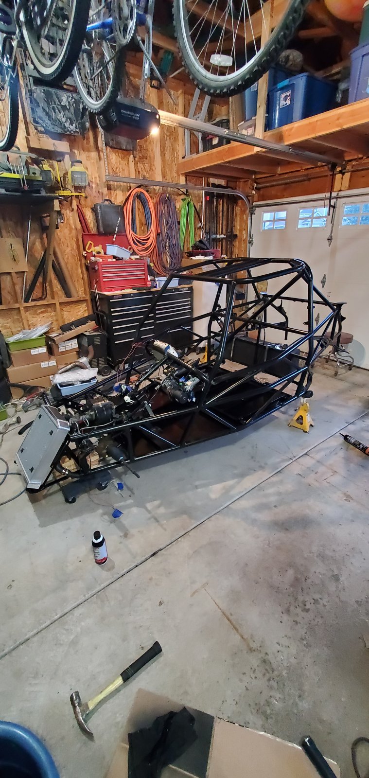

Got the seat mocked up and the brackets figured out. It will be off to powder coating soon.

Frame and parts are back from powder coat. Cobalt is back. Just need to have the ac drained, then I'm tearing into it.
