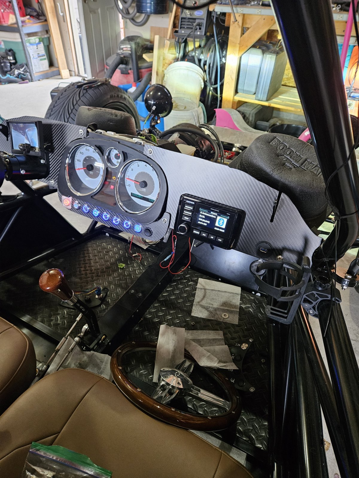

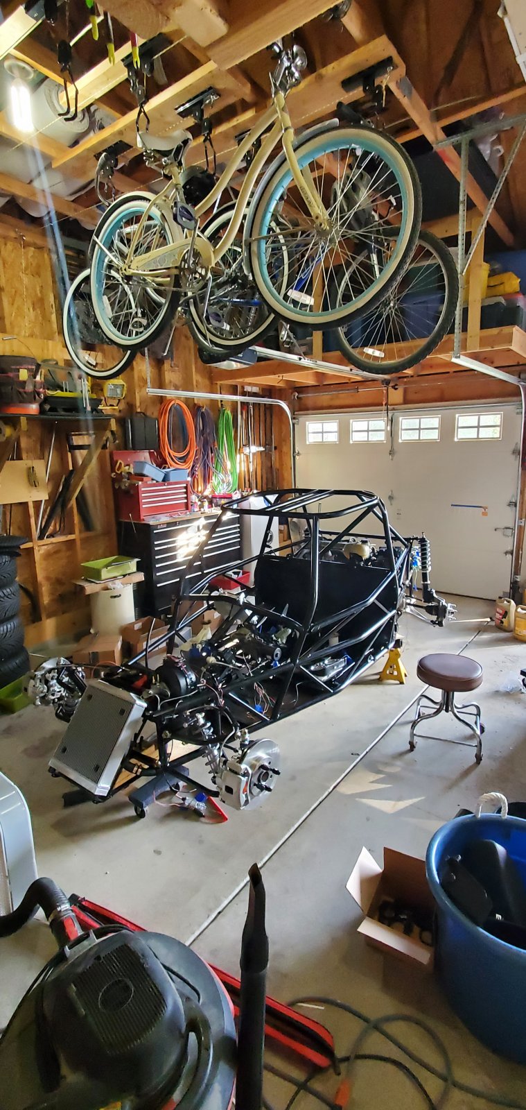

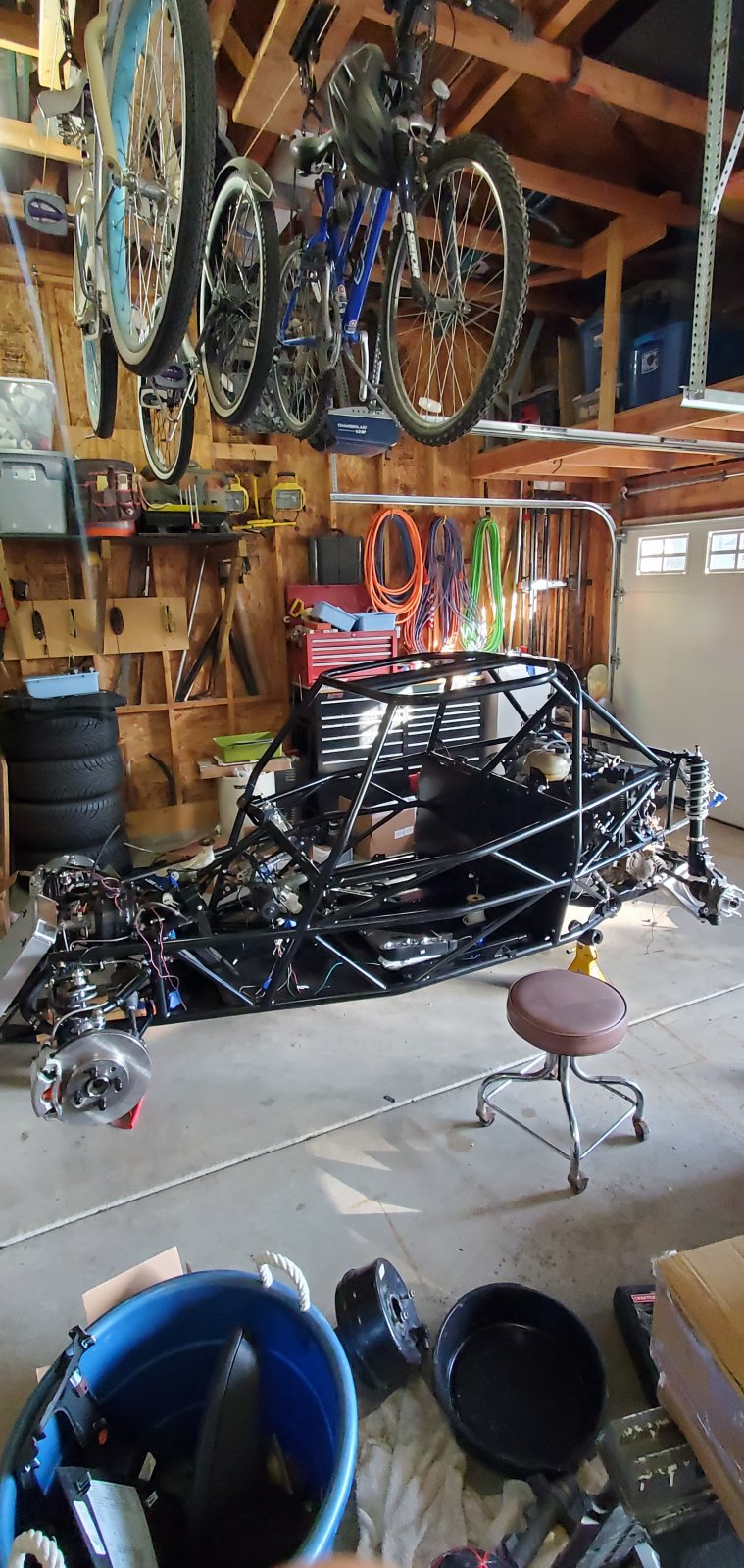

Some of the progress from the last few days

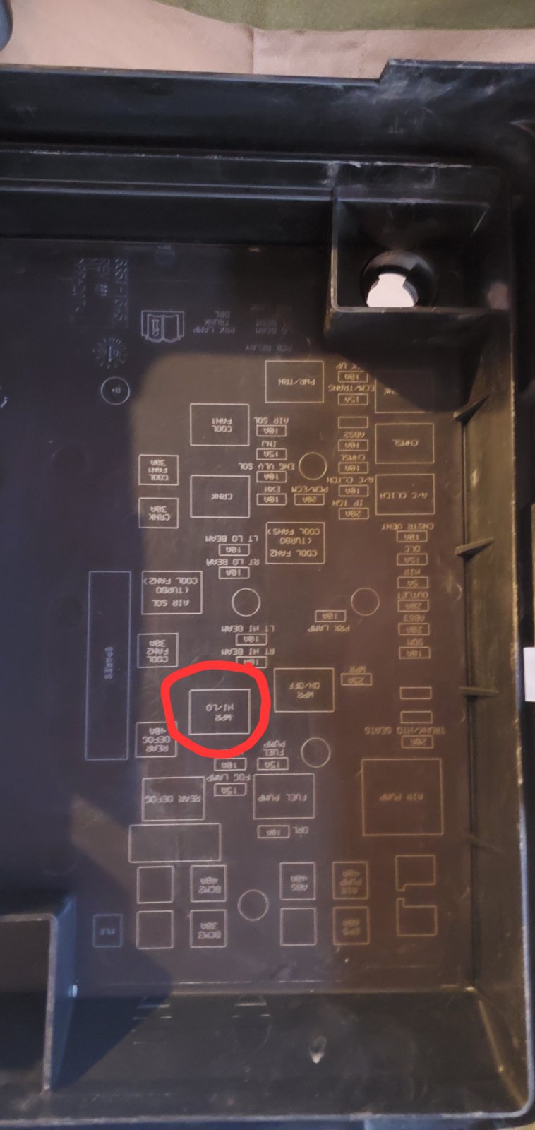

Is there a relay for hi/low beam headlights? If so, think it's the circled one? I'm not getting any change, there's an audible click from the fuse box and the lights flash off for a sec when going from hi beam setting to low beam.
Sluggonaut
I'm not sure about the 2008's, but I know on my 2007 the relays are PCB (printed circuit board) relays and not serviceable. If the PCB relays go bad it means a new fusebox.

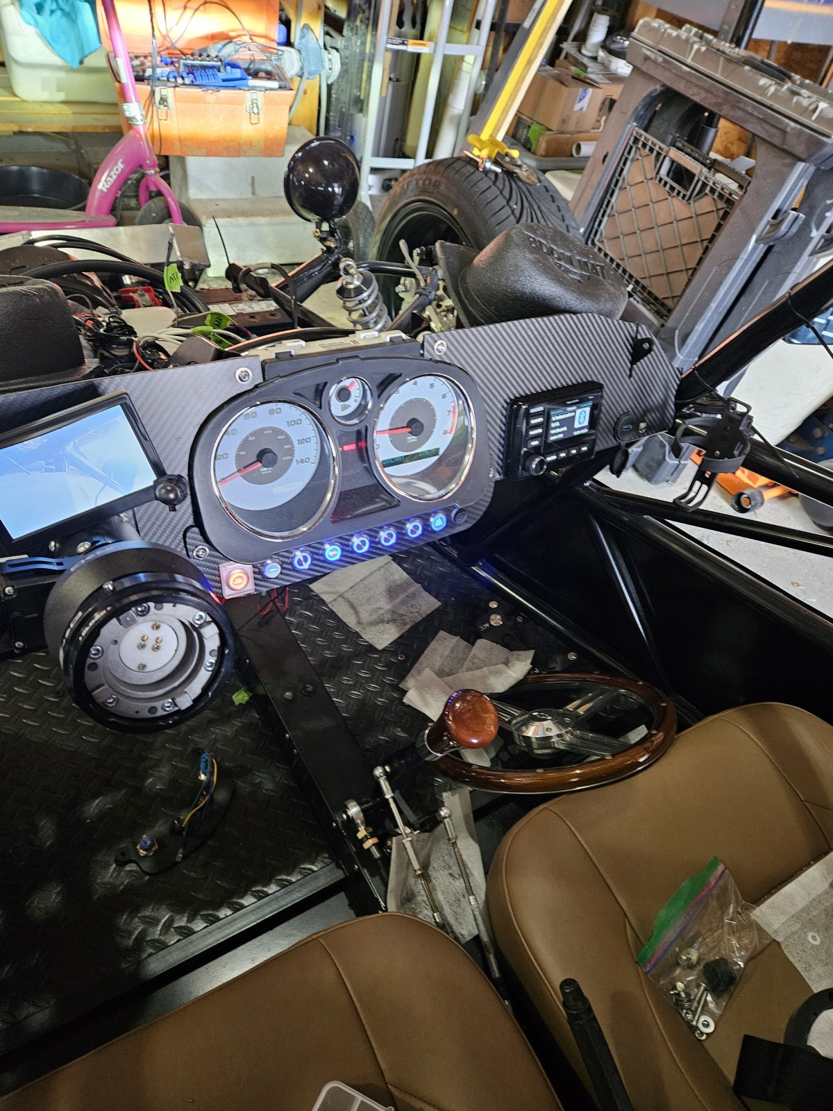

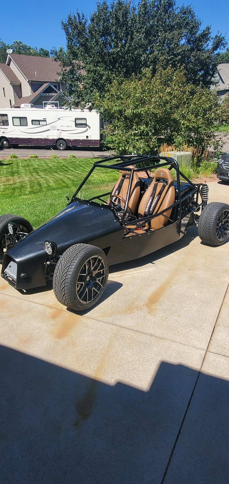

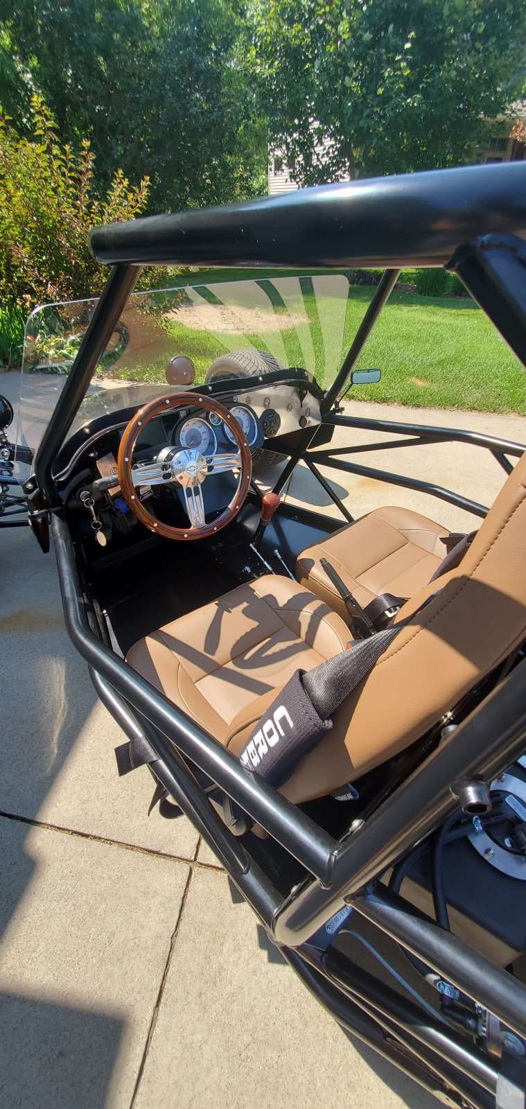

Working on the spring projects. Carbon fiber dash is in with my new button panel. New radio is installed. Need to finish a little wiring and fitment. Then finish up my new taillight idea and hinged hood.
