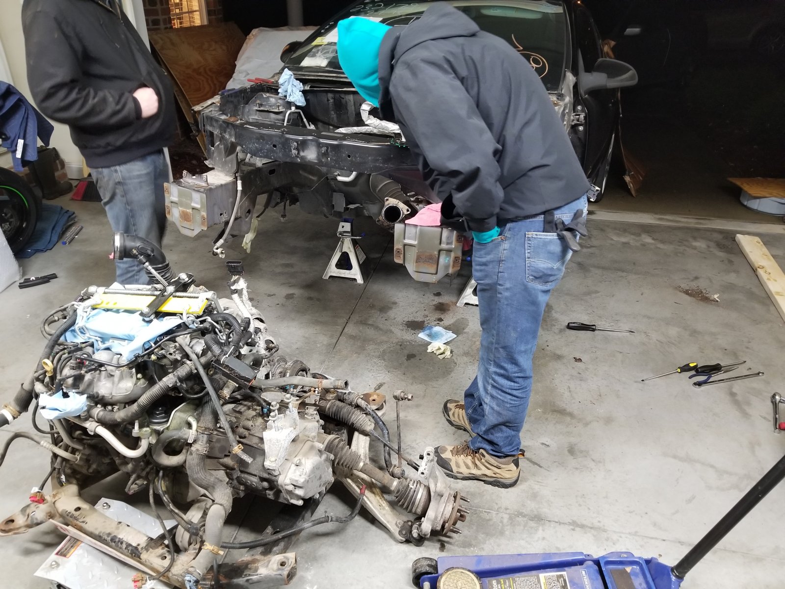

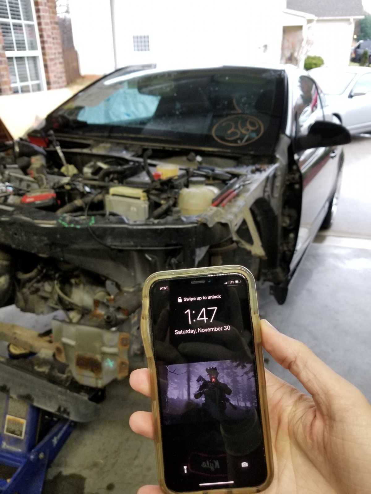

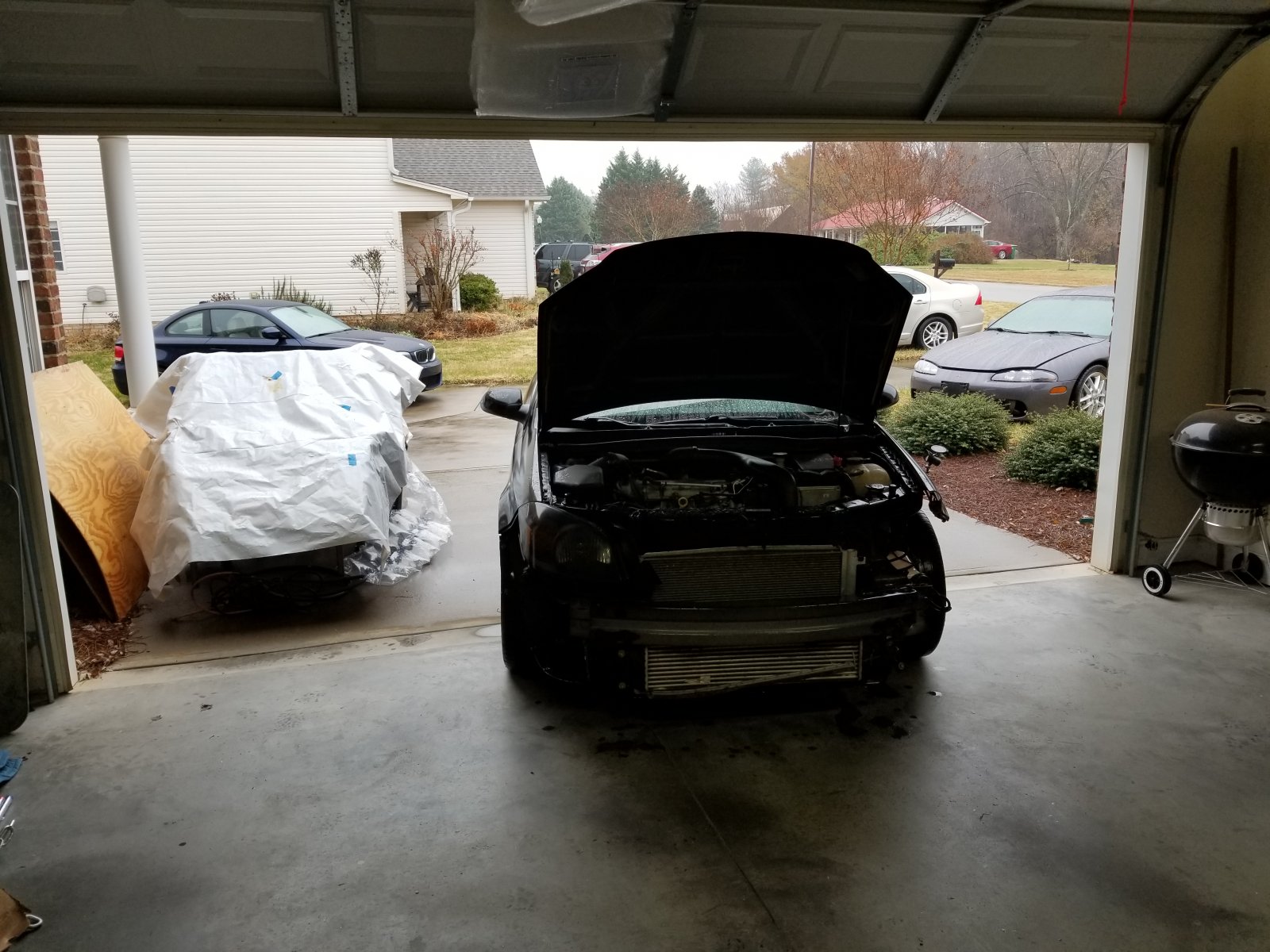

Time for a quick update, this past Saturday I finally got around to 'starting' the tear down phase. Me and a couple friends got started around 10:30 to 11:00AM and wrapped up around 11:30PM. Of course it had to be nasty and rainy ALL day. Had to work with the car half way out of the garage unfortunately to have room to remove the powertrain, but we were far enough in that we weren't working in the rain. All pertinent bolts were bagged and tagged with pictures taken of electrical connectors and their mating connectors/modules.

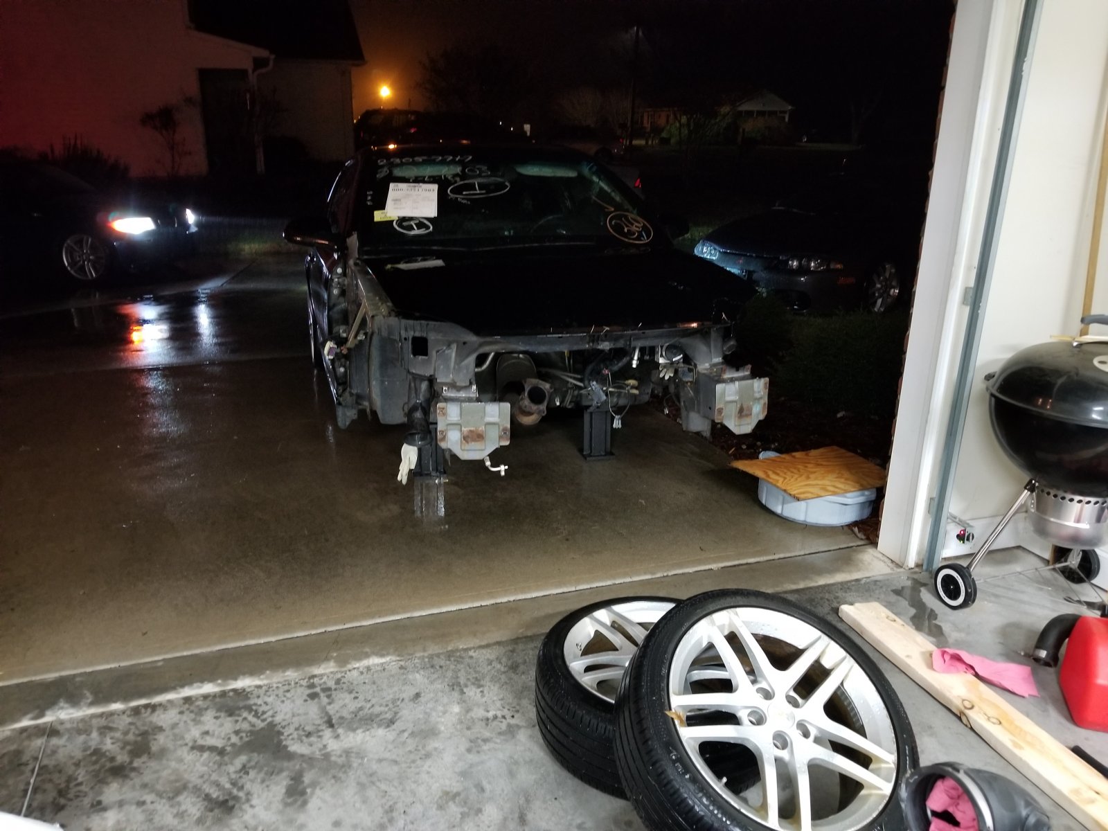

This was just before work began:
That's frame 171 under the plastic that was wrapped around everything for delivery of the kit (glad I kept it).

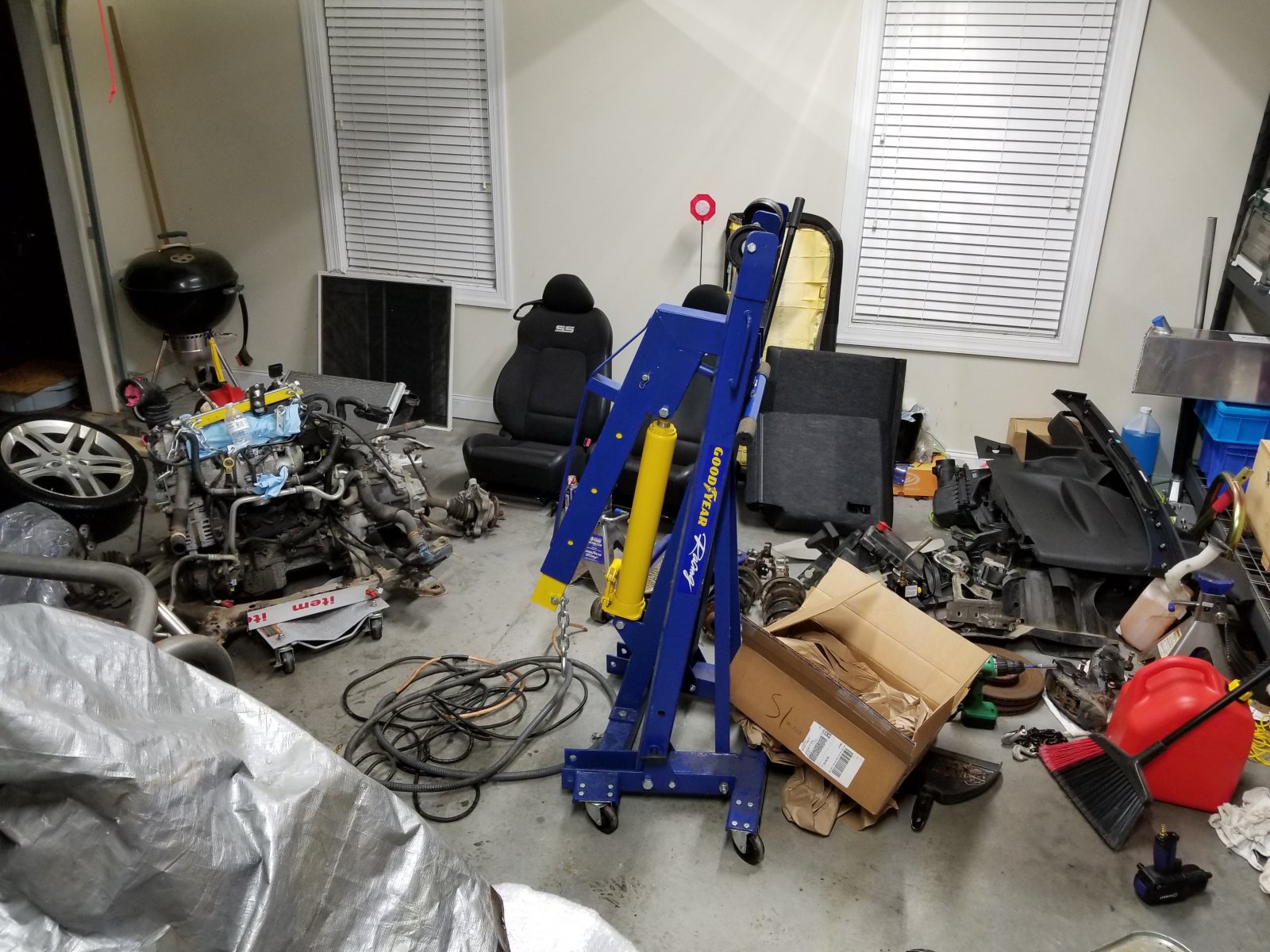

I intended to take this picture prior to starting disassembly. This was about 2 hours in, taking an hour or so for lunch.
10909

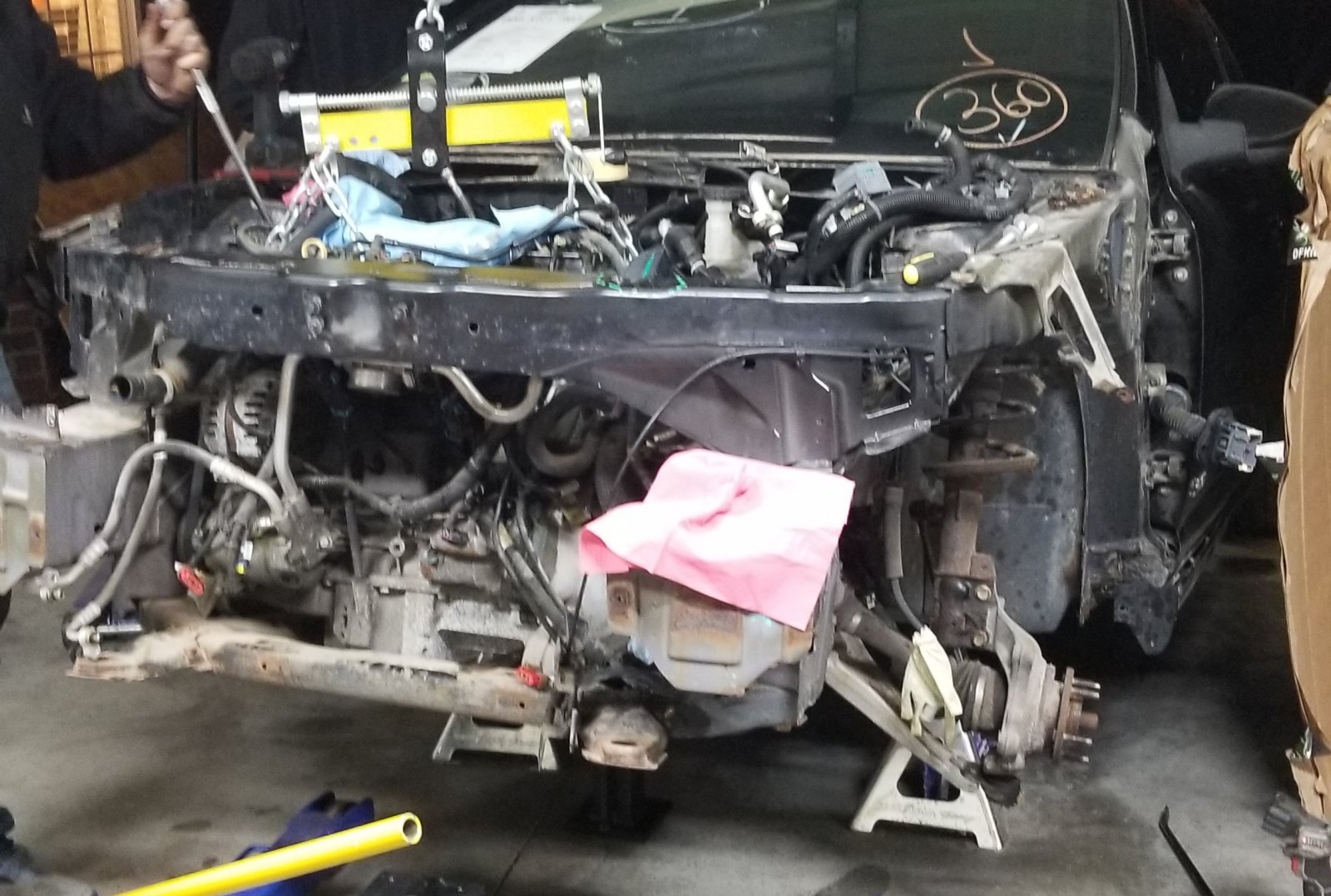

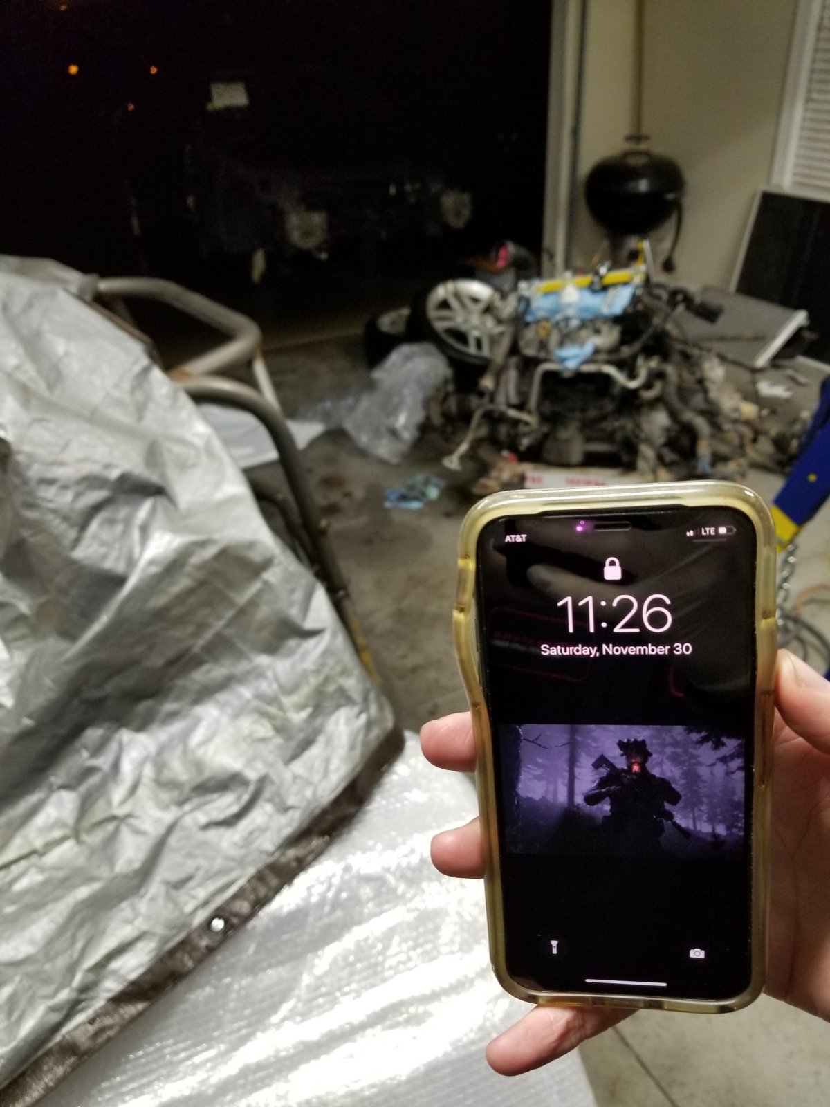

After a few 'short' hours:
10911
10912
10913

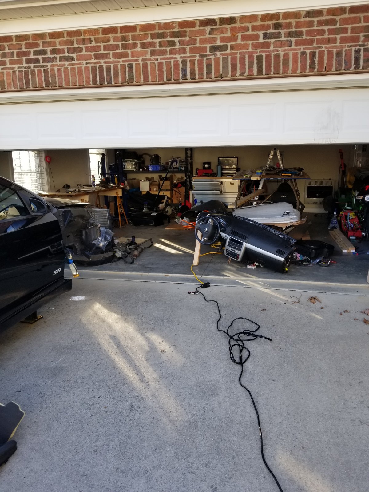

After completely stripping the engine bay and ~95% of the interior, the chassis was back out of the garage and the goblin frame was back in.
The dash is only a few minutes from being out. The shifter cables and ebrake are still in place and main chassis harness still needs to be fished the rest of the way out. Otherwise, teardown complete!

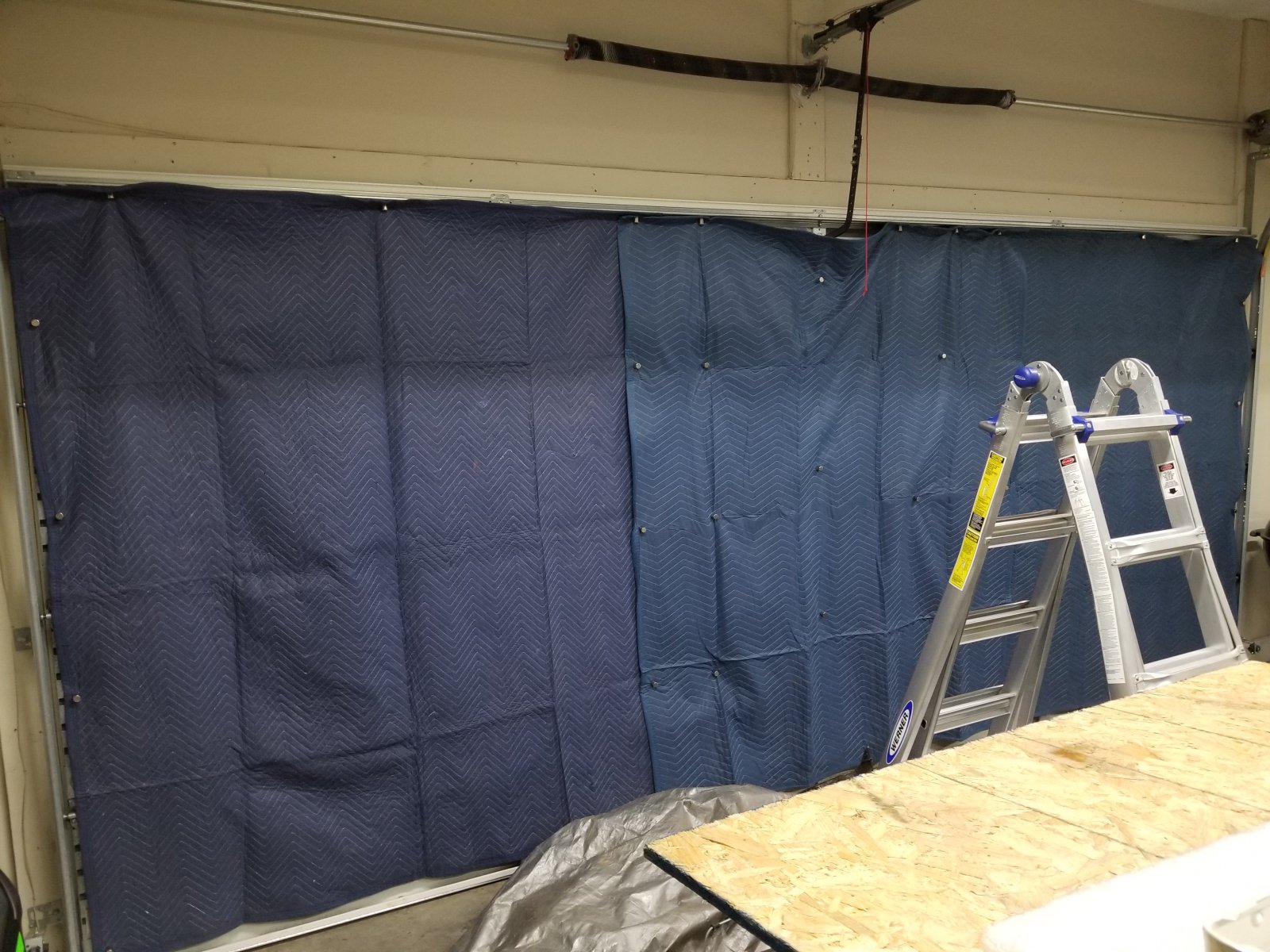

I have also been considering adding blown-in insulation into the attic since the garage was not already insulated. I have researched ways to insulate a garage door and may opt to do a temporary insulating job on it with a bunch of scrap bubble wrap from work, some cheap moving blankets I already had and some REALLY strong rare earth magnets I already had around, so basically for free. I've already experimented with this and it seems promising. The door will rarely be opened. Lastly, I've been back and forth on heater types, electric, propane or even natural gas since my hot water heater (natural gas) is located in the garage.

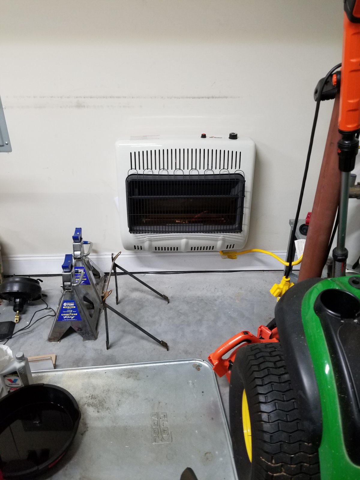

Got the natural gas (Mr. Heater) installed and have used it a number of times now. Seems to work pretty well, gets the garage from upper 40's/ low 50's to well within 60's within an hour. But haven't used it during extremely cold outdoor temps yet. My temporary garage door insulation actually works reasonably well, especially considering it didn't cost me anything.
11152

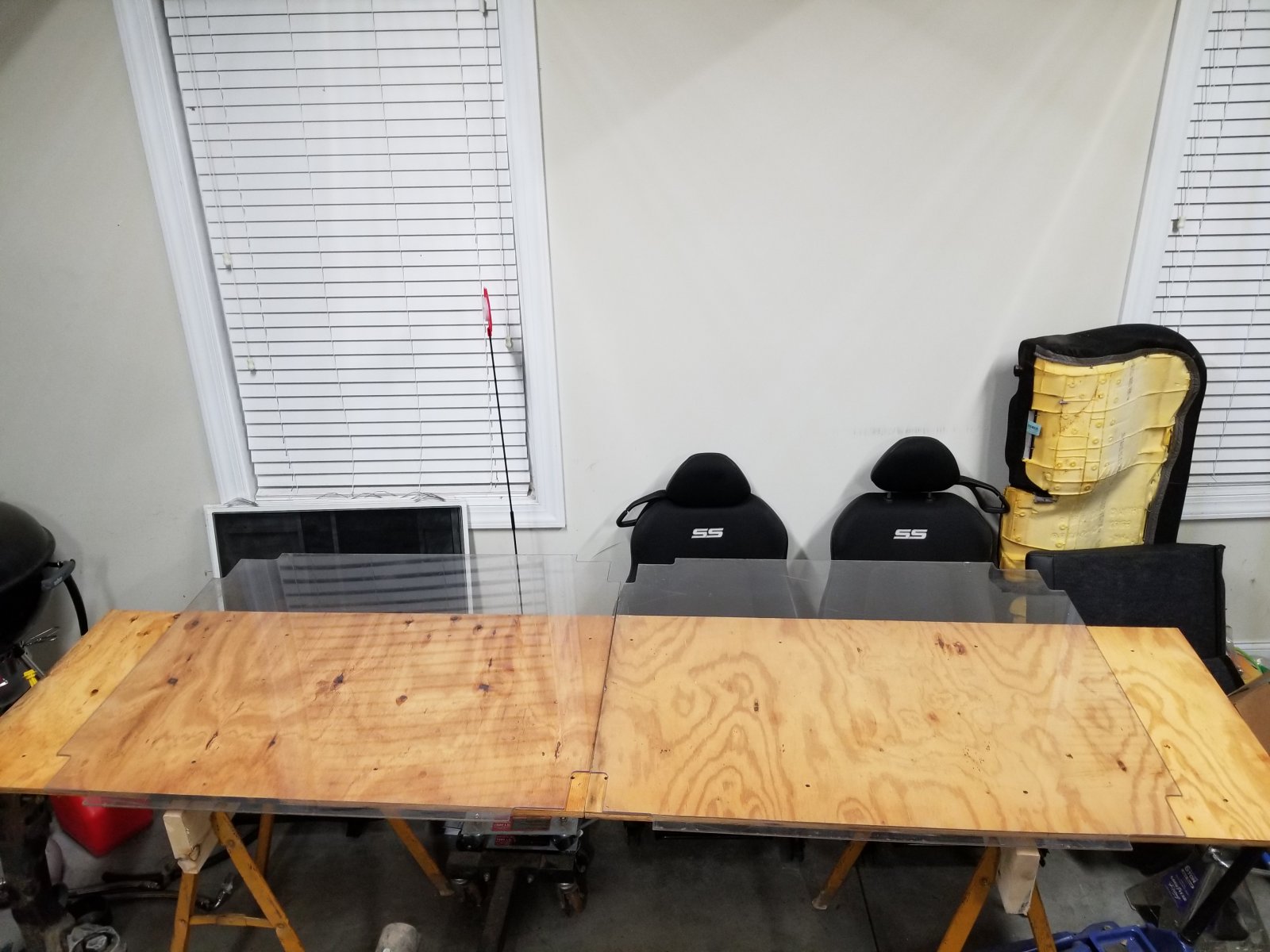

A friend/ex co worker brought some supplies by and helped me build a work table that has already proven very helpful. A couple of lexan panels just crudely sitting on top for easy clean up.

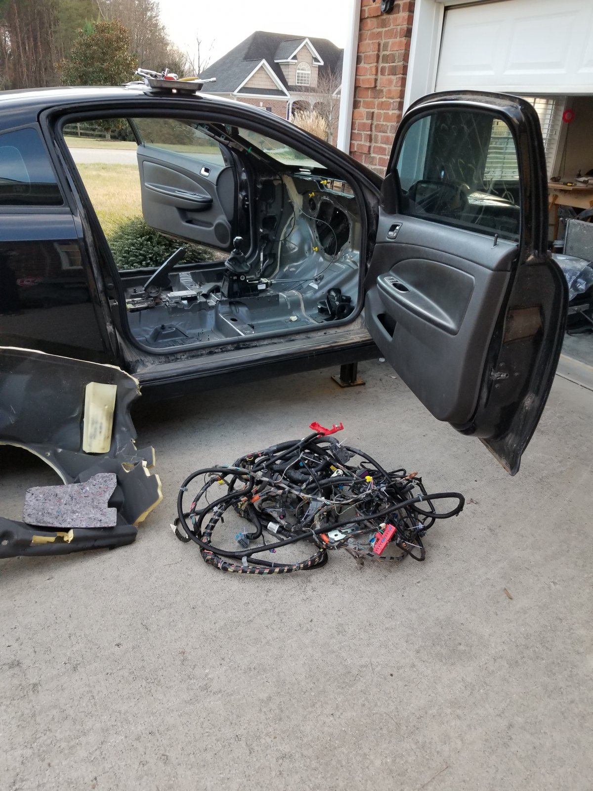

Finally got around to removing the dash and main chassis harness from the car.

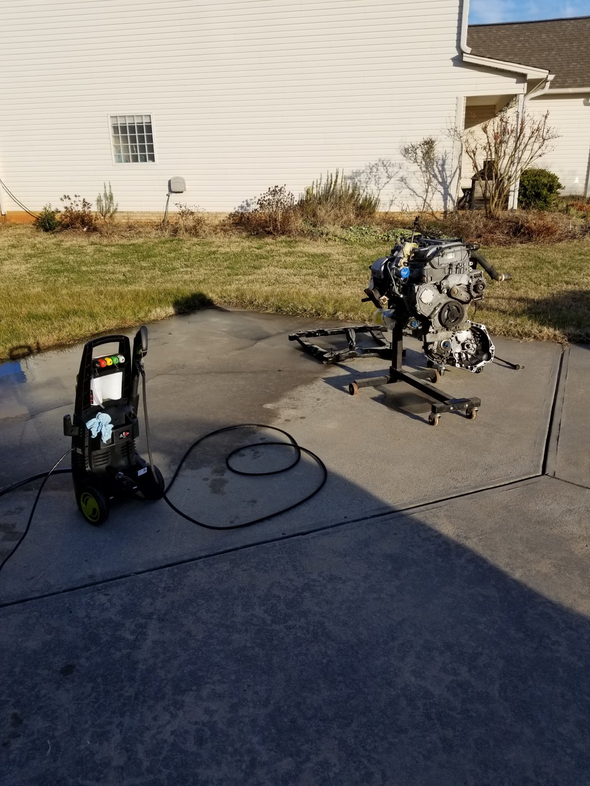

I recently removed the engine harness and split the engine and trans. Did some pressure washing on some things today. It was a huge improvement, but it all still needs more. I'm looking to buy a media blaster primarily for walnut media. Any suggestions for size/type I should consider. Harbor Freight has numerous options ranging from $40 - ~$140. I already have a 30 gallon air compressor that I believe should keep up reasonably well.

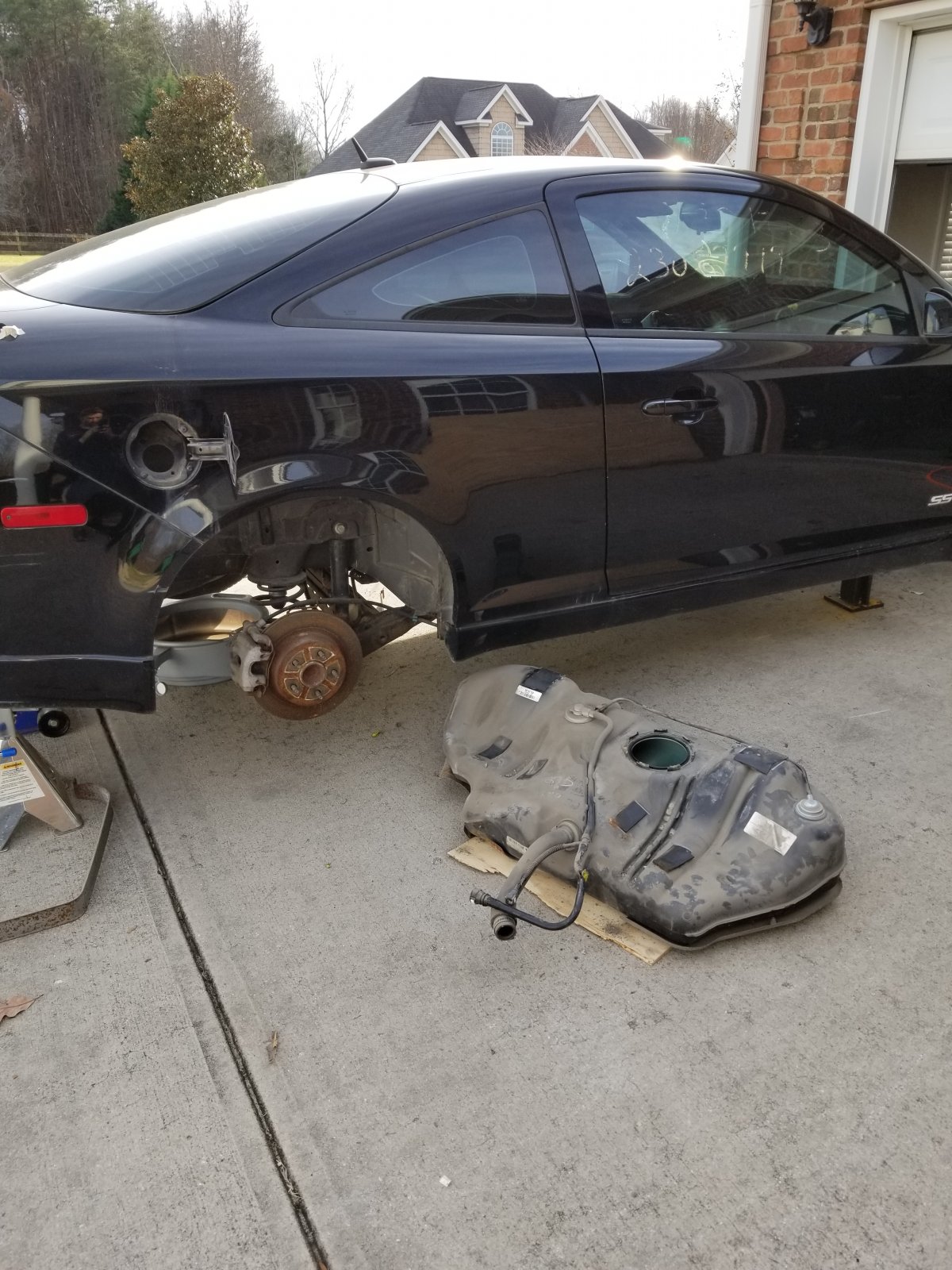

So I've just dropped the tank, and removed the filler neck and fuel pump. Last thing is to remove the emergency brake assembly, unsure how difficult that will be as I haven't seen it documented yet.
While I have the rear end up I'm wondering, is it only the hubs and rubber brake lines that are to be saved from the rear end? I was planning on buying new brake lines anyway and will probably buy new hubs. This will make it easier for me to move the shell around as well as getting rid of it. I know a guy who's interested in it that will bring a couple wheels to throw on the rear (keeping the SS wheels for now). Am I missing anything that needs to be saved from the rear end?
