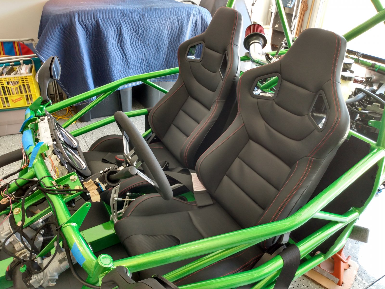

I would go with the Rear Coilover Kit because you don't want to mix new shocks on the front and used on the rear. Even with new stock shocks as was mentioned, the adjustability is great!
As for the seats, I picked up a cheap pair on Amazon for about $275 for the pair. It's an exposed car, they get wet, they get stepped on, and if I have to I'll replace them in 5 years but for now, they work fine. Also, they recline. I just had some angle iron welded in for the brackets.

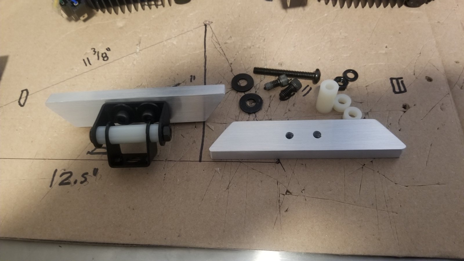

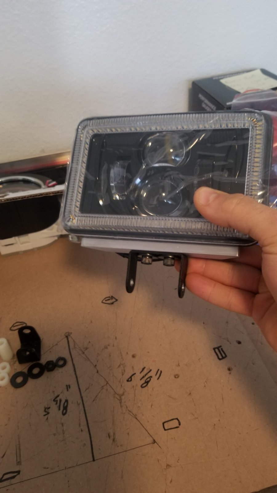

Headlights are your call, a lot of people do their own thing. As for rectangular ones, I made mine out of a combination of lights and brackets I fab’d up. The sky (and your fabrication abilities) is the limit

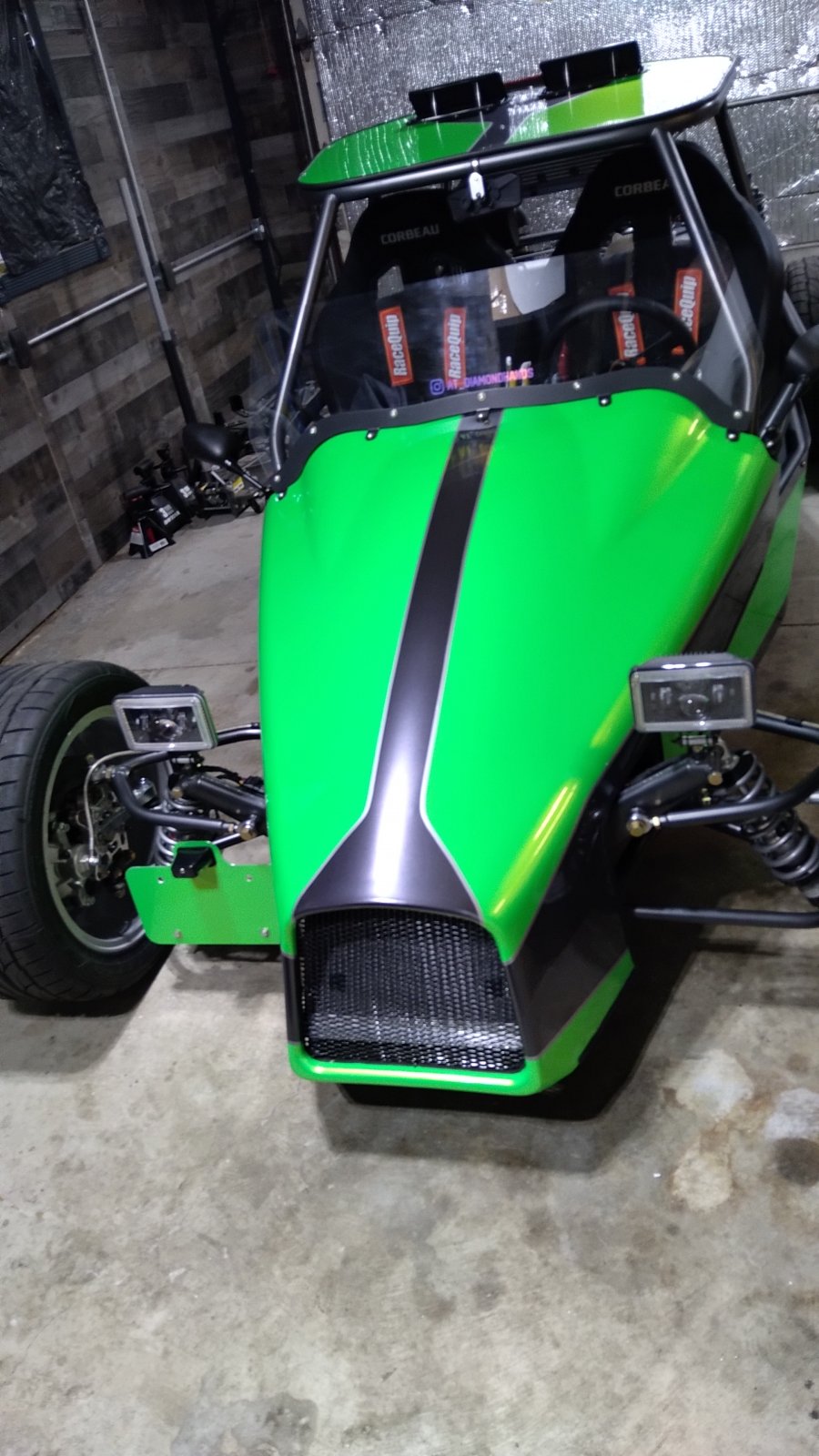

Pic showing my headlights:
37437
I could see me doing something similar on seats. Could you send a link so I could take a look at them? Did you do a 5pt harness?

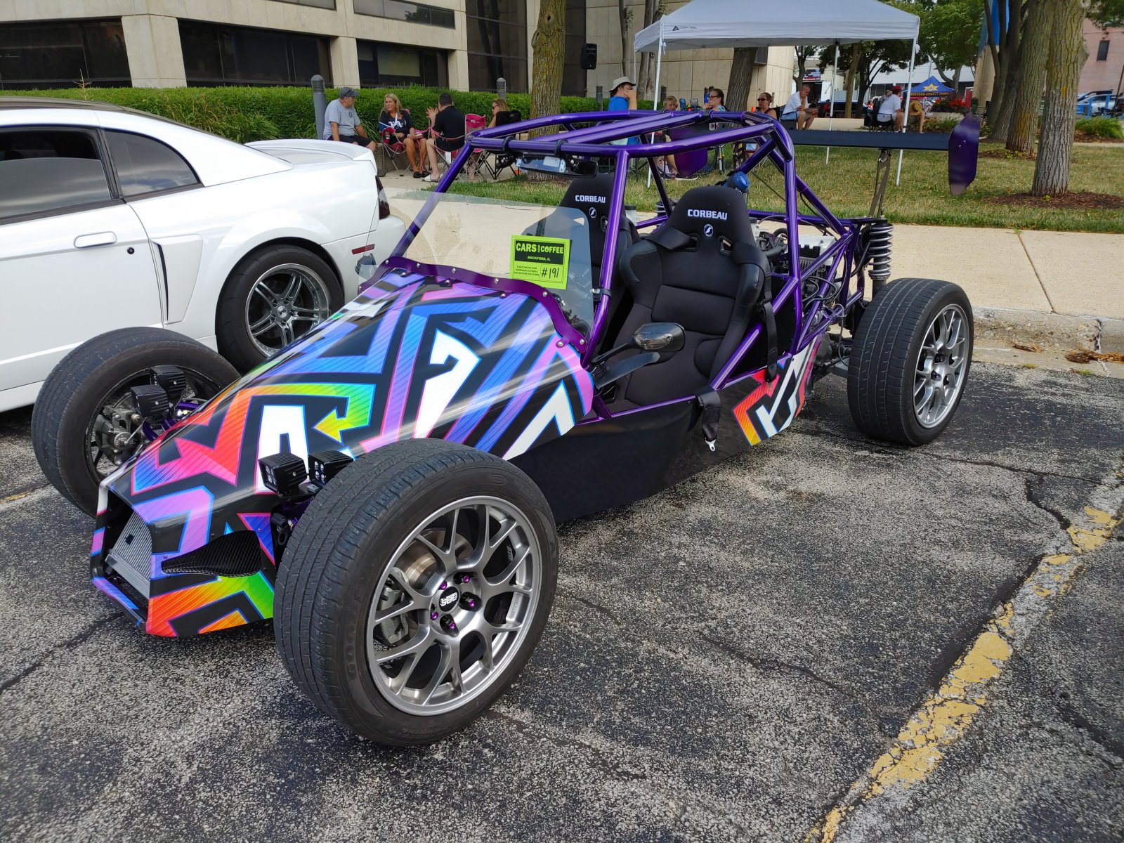

I used Lumen semi truck 4x6 with built in turn signals. had to make my own mounting.
I like the DF supplied tail lights, I like how bright and compact they are.

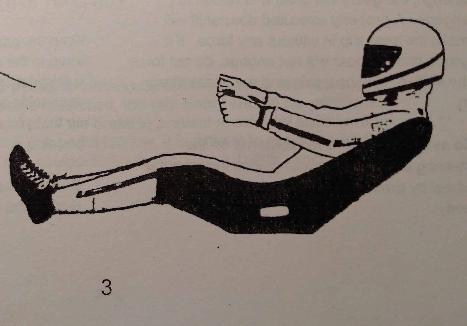

I got 5pt harness' but didn't use the 5th belt. With the angle of the seat back, it's not needed. Most formula cars have a back angle of about 35 degrees.
37476
That's why the anti-submarine belt (aka Soprano belt). With the reclining back on these seats, I run about a 55 degree angle on the seat back. You just want to make sure to tighten the lap belts, on your HIPS, as tight as possible. THEN snug up on the shoulder belts. You don't want to pull the "LAP" belt up, with the shoulder belts, into your stomach.

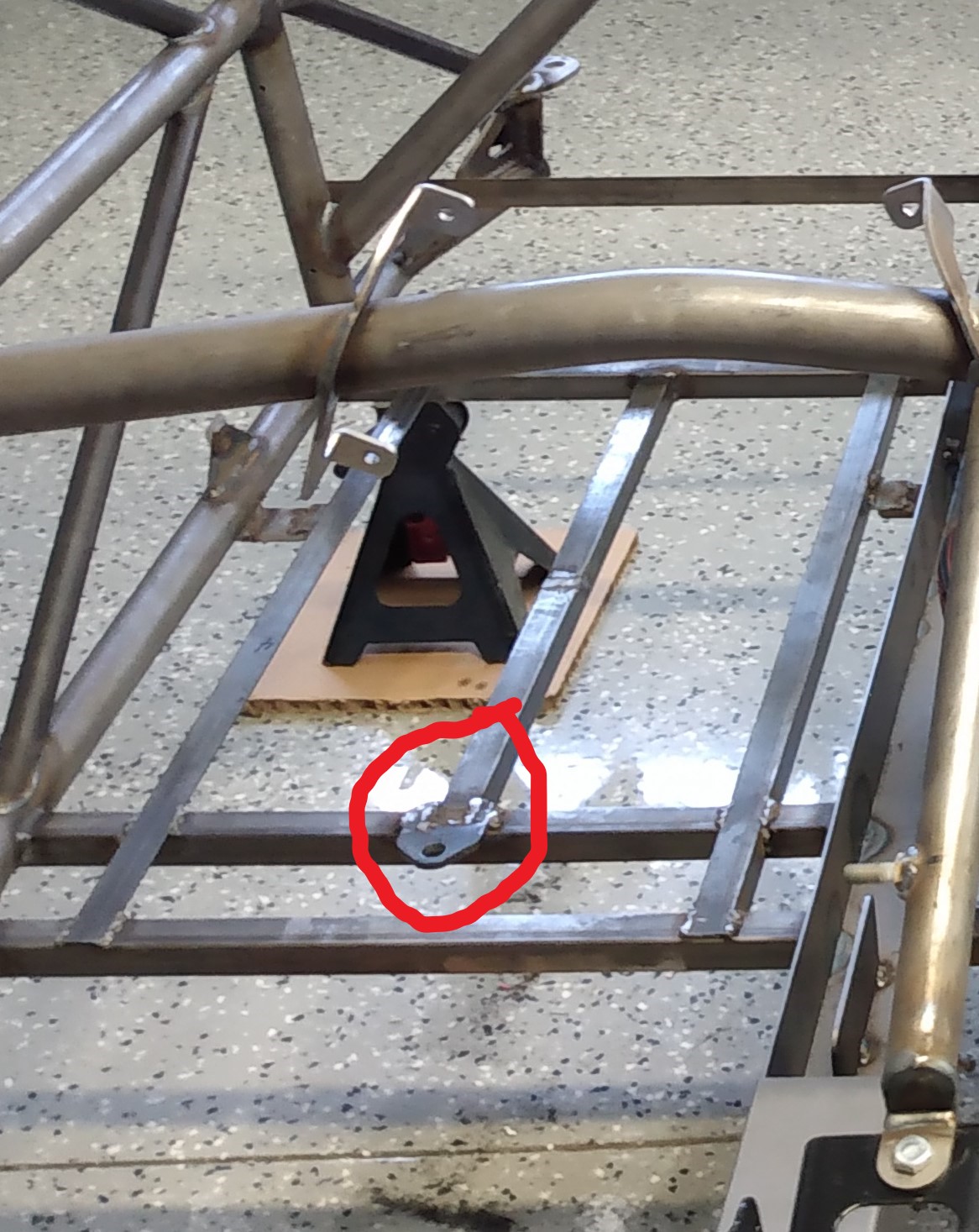

I had some angle iron welded in for the seat supports and I had the 5th seat belt bracket layed down and re-welded so I could mount the seat as low a possible.
37479
With this location I can add the 5th belt if ever wanted/needed.

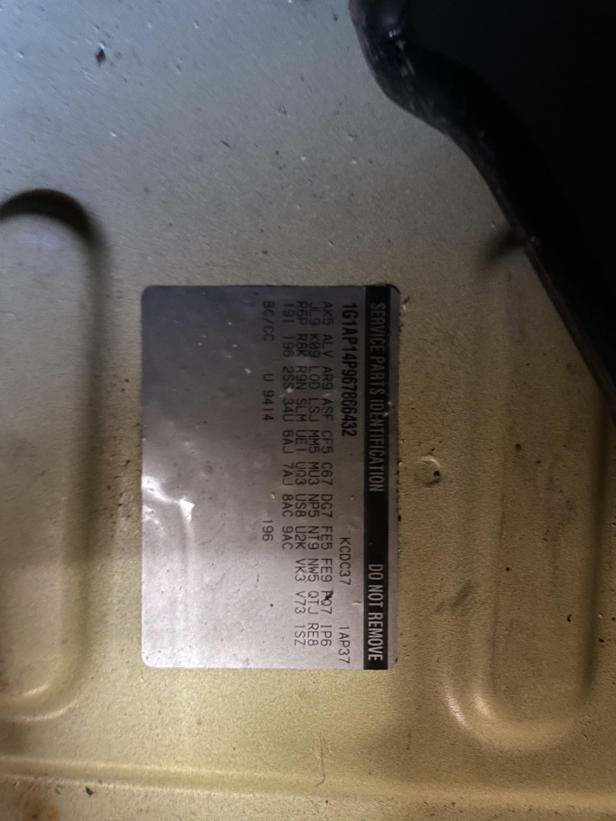

E

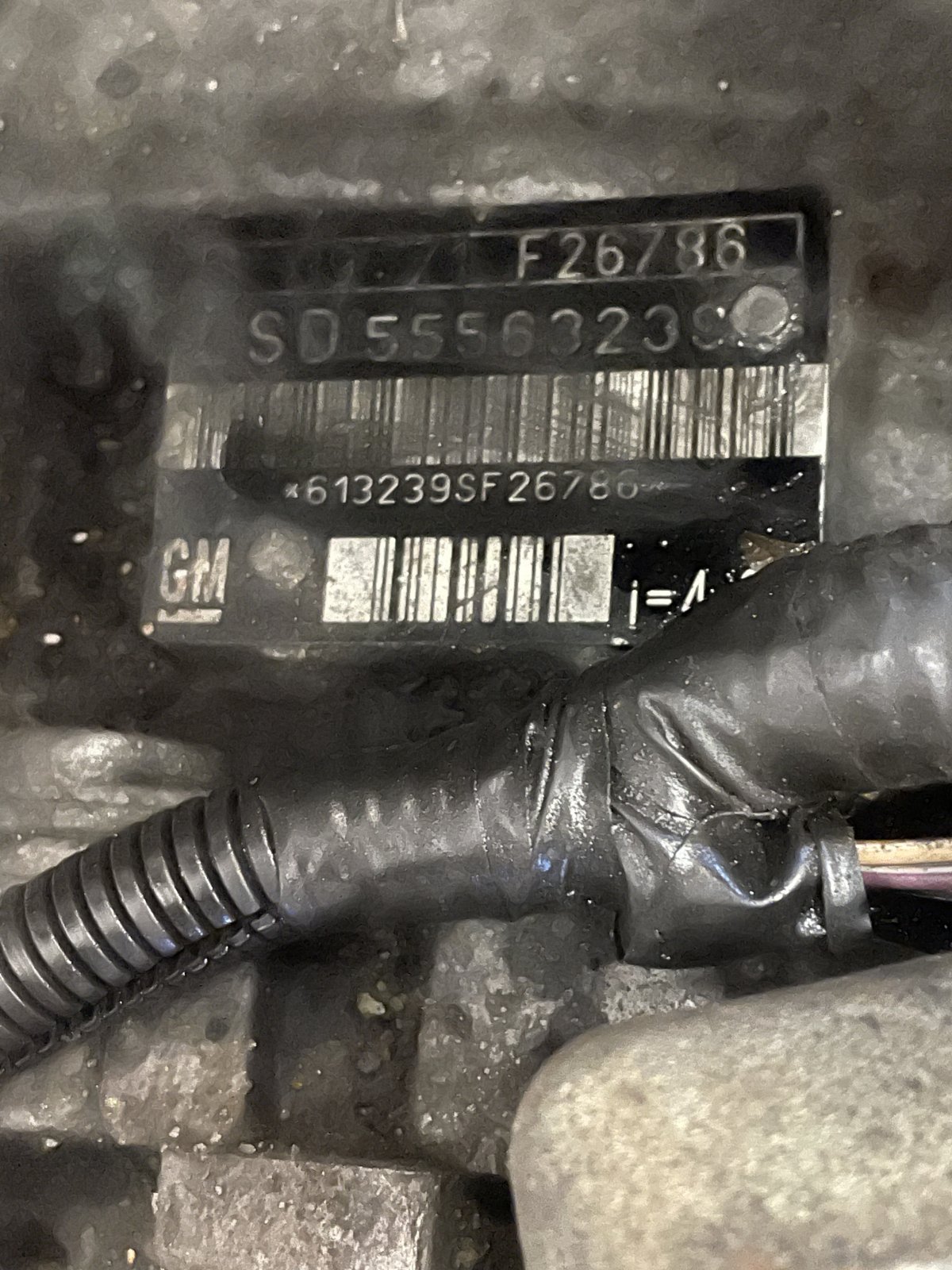

Yes, you should have the F35 5 speed transmission. Check the trunk build sticker for the G85 code to see if it's a LSD. The tag on the top of the transmission will also state 'LSD' if it equipped.
Interesting the transmission is marked LSD but the trunk sticker doesn’t have G85 code. Photos attached.
