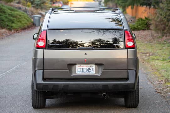

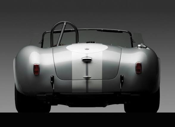

One thing I immediately noticed is the rear is 1.5 inches more narrow than the front. I don't like it a bit. the aesthetics is all off for one. it is not quite a trike but man that just bugs me. This narrow rear end does not fit the car lifetime experience. I have seen folks on the forum swear it will handle better but my mechanical engineering degree and vehicle dynamics classes and books do not back that statement up- unless we actually want to talk trikes and CG for those is dramatically different among other things. So these are likely anecdotal opinions perhaps? I can also point out dozens, if not many many more, examples of performance vehicles where this is absolutely NOT the case as well as some of the worst performing vehicles on the planet having narrower rear ends. . .ford vans and citrons just two of those. My Stalker is extremely wider in the rear than the front and the Stalkers (Locost/clubman/super 7/etc) hold more road course records to this day than ANY other car- but then its weight bias is to the front where I am very sure that the Goblin weight bias is to the rear (I haven't weighed it yet but it should be obvious) .
So any chance one of the folks making the claim that a narrower rear end is better are able to produce the graphics and math?
Meanwhile, I am off to hunt for wheel spacers. . .which may end up helping me locate a set of suitable rear rims until I have actual math data I have 6 cars to try and standardize my wheel/tire combos. Hopefully, it isn't a 6 time mistake. lol
I try and not get hung up on perfect geometry/setup on anything I have and just concentrate on learning to drive what I have. That said, I don't see that 1.5" will make that much difference anyway. Maybe not mathematically the best, but practically probably not that much difference.
I don’t have an engineering degree and I didn’t stay in a holiday inn express last night, but my CDO won’t let me keep the rears narrower than the front. I used 1” spacers in the rear for a long time, when I had a “square setup”. I later went with larger rear tires to give the illusion of it being square. I have no idea if it affected the handling in any way or if it’s better or worse than stock, but my CDO is happy. :D

My wife calls all my cars my mistresses; and I like a little shape to 'em rather than looking like an old dudes butt. lol. How many folks remember this ad? should be the same lookin at em in the garage.

Old dudes butt:
Mistresses butt:

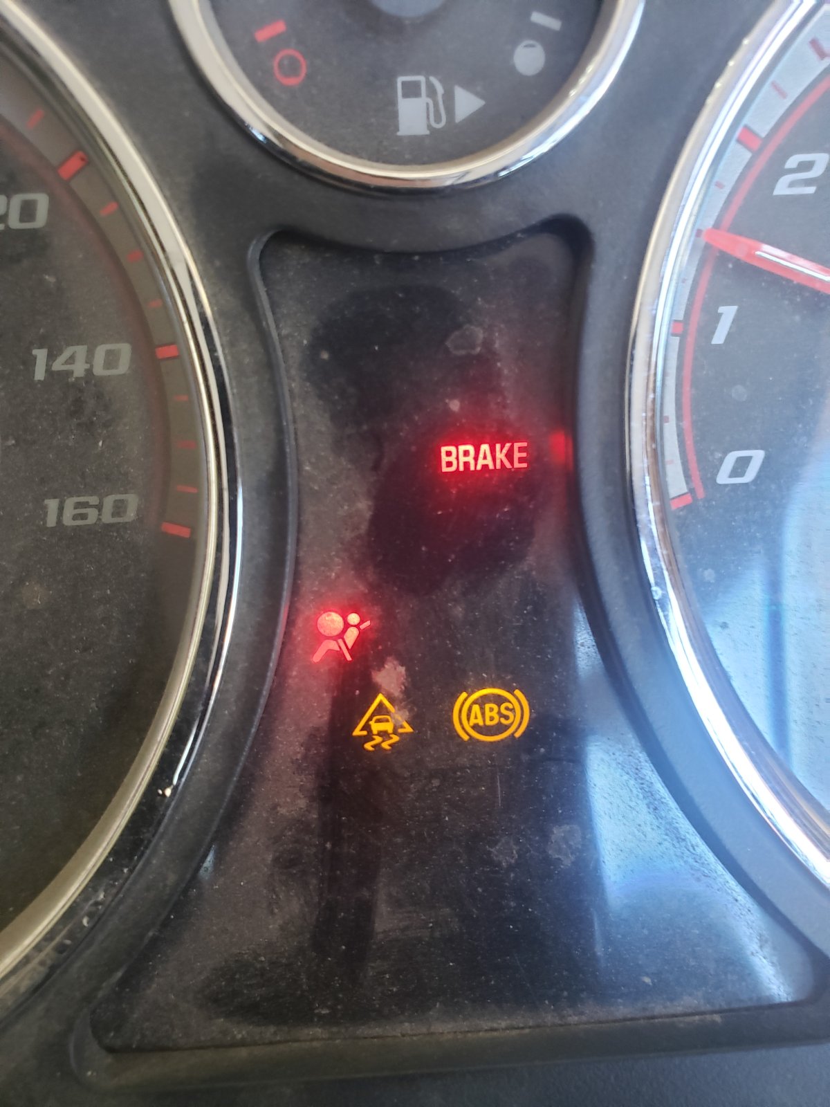

I have some CELs to address-- mostly the same ones over and over.
P0036-HO2S heater Control Circuit Sensor 2
P0100- Mass Air Flow (MAF) Sensor circuit
P0449- Evaporative Emission (EVAP) Vent Solenoid Valve Control Circuit
P0452- fuel tank pressure sensor circuit low voltage
and some instrument cluster lights that i think the computer needs sent in to be programmed for (air bag, abs, traction control, parking brake- are there wires i am missing for the parking brake?)

Clear the codes and see what comes back. the MAF and fuel tank pressure sensor may be the only 2 of concern. Evap and second O2 are gone, so those need to be programmed out.
you can’t program out the abs, srs, or tc lights. Easiest is to open up the cluster and put electrical tape over them.
everything else is normal goblin stuff you’ll get use to.
i cleared the codes on each drive and these do come back.
Did you send off your computer to ZZP to be re-programmed after starting your goblin? if so, what did you tell them to do?
The tank pressure isn't a problem either. Only the MAF code is a problem. And if the MAF isn't working right, it will make the turbo do weird things since the ECM really won't know what is going on.
The EPA has been hassling the shops that tune ECUs. So HP Tuners got scared, and removed all their race engine tunes from their library, and they updated their software so that it couldn't remove some of the instrument panel lights. I don't know if ZZP can remove those lights because they use HP Tuners, just like we do.
Use tape to block off some of the instrument cluster lights, and fix the the MAF, as that looks like a real issue.

I used the same method as Ross to turn of the airbag light. Our donor didn’t have abs but if it did it would’ve gotten the same treatment. The purge solenoid and the fuel tank pressure sensor codes ignore. Check your fuses for the Maf code or check for power the pink wire on the Maf connector.
