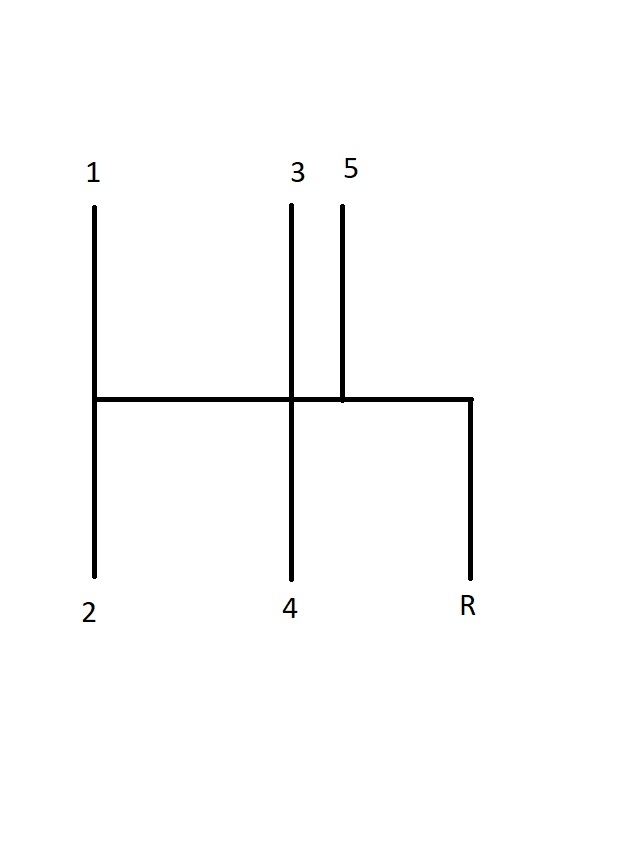

found my 5th gear finally on the way home by accident. . .thought i was down shifting to 3rd and low and behold car lugs MORE. turns out 5th is super close to 3rd- something like this:
makes things VERY difficult for normal driving let alone spirited
Hmm, the same shift fork rail that engages 5th also engages reverse in the F35. Unless there is something misaligned or worn in the transmission, this narrow gate between 3rd and 5th has to be something with the cable adjustment or alignment.

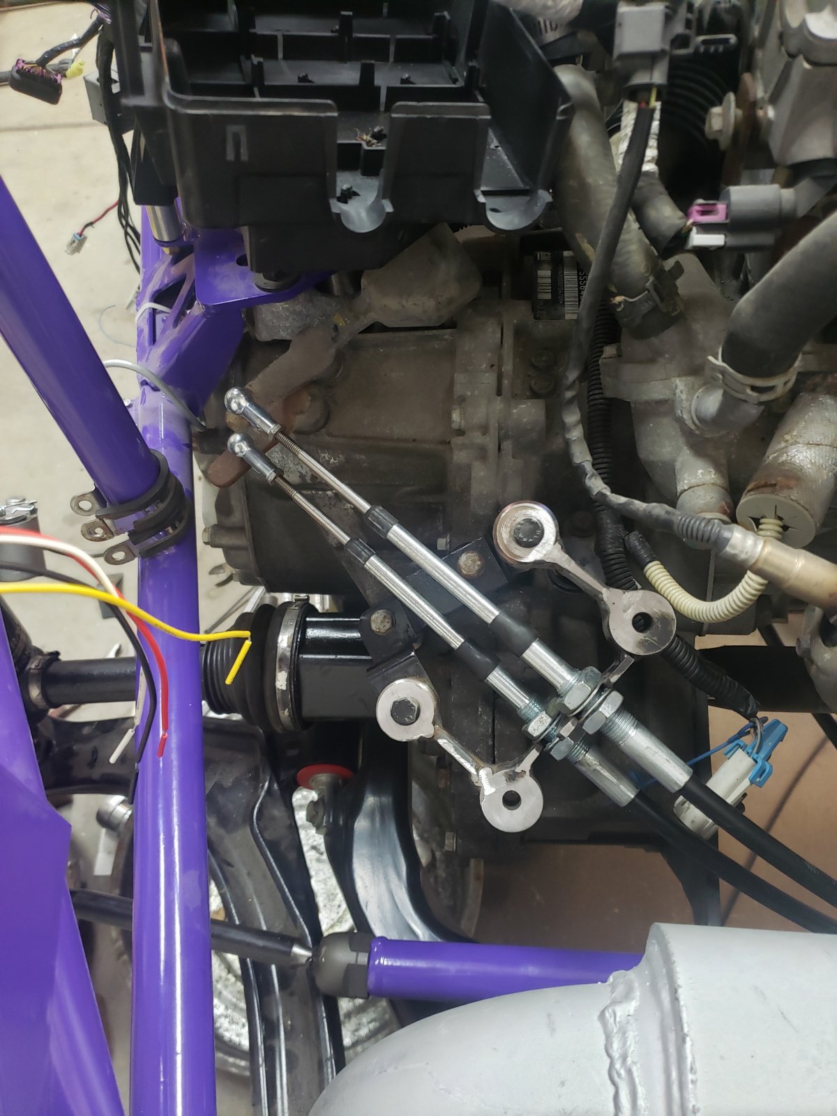

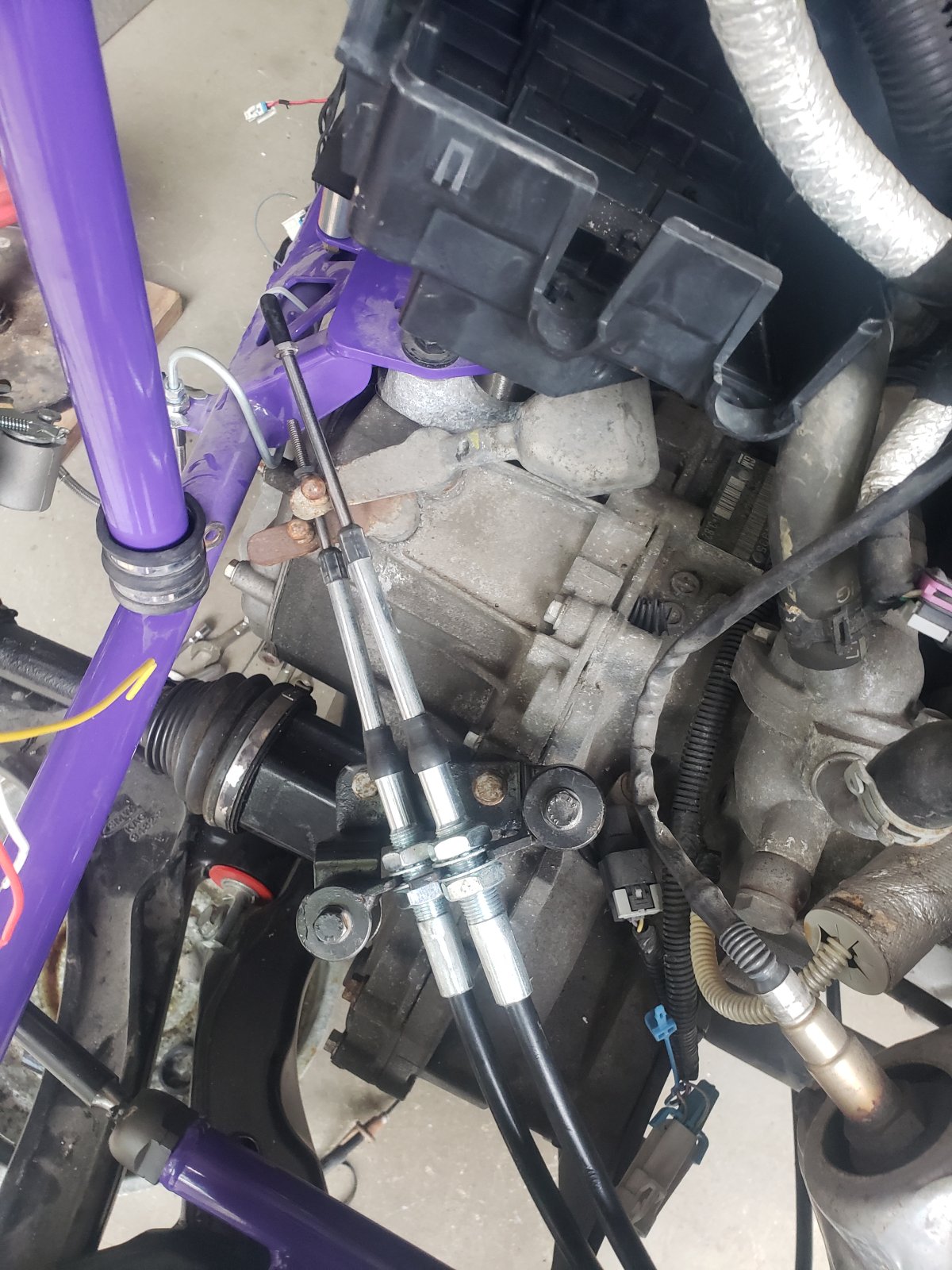

so original cobalt bracket was too close to use the supplied shifter cables- didn't get a new bracket in my kit so was out operating all alone. . .
my upgrade bracket was much much more in line with what was needed and actually used the original in its makeup so cables had same angles. photos not take at exactly same location or angle but i can assure you it is a parallel offset for the extra cable end length needed. . .

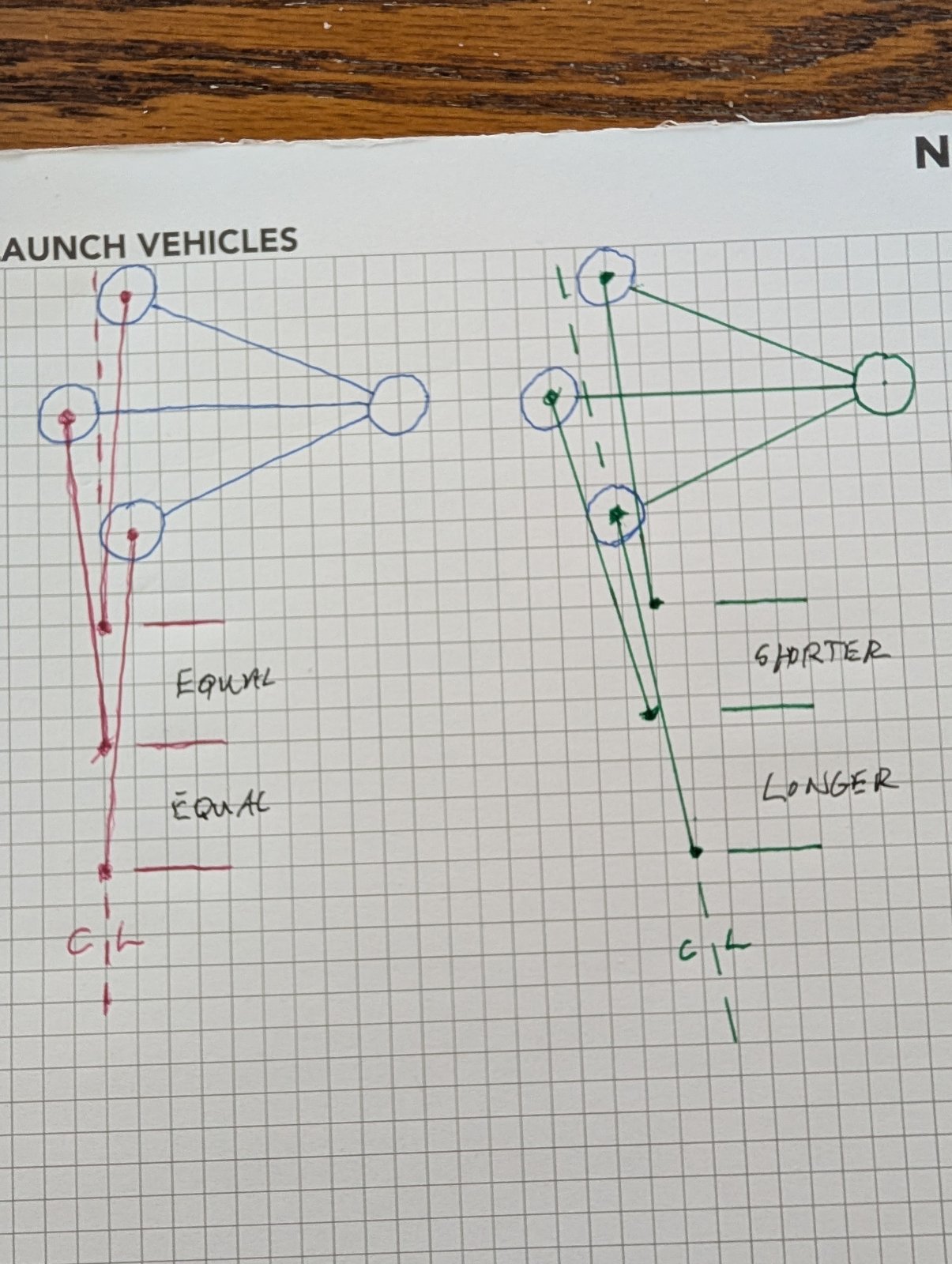

This is my thinking how you could get a narrower gate side to side for the 3rd to 5th separation versus the 4th and reverse gate.
Essentially with the cable not being perpendicular to the shift lever in it middle position and will travel an equal amount when moved forward or back. If the cable is at an angle to the shift lever in the middle position, the movement forward will be less (or more if the angle is the opposite direction) than the movement rearward. The steeper the angle from perpendicular, the more difference there is between the movements forward and aft.
Don't know if this is case, can't quite tell from the photos. :D

ahh. yes i see. most EXCELLENT point!!! Man we do have a bunch of smart folks on here. i sure was practically selling the whole DF brand at the cars and coffee the other day talking ya'll up but not nearly enough! hey if you ears were ringing yesterday i was indirectly mentioning a forum member with a penchant to drill holes in every bit of his car. lol

So the shifter cable issue on closer inspection may very well be that the cable anchors are not 90degress to the transmission levers. not on the stock form of the cobalt either but having to be offset at least 2 inches to account for the kit cable ends makes the swing even worse. so maybe in the morning i will also be mapping out a new shifter bracket that is 90 degrees from the pivot center when in neutral
