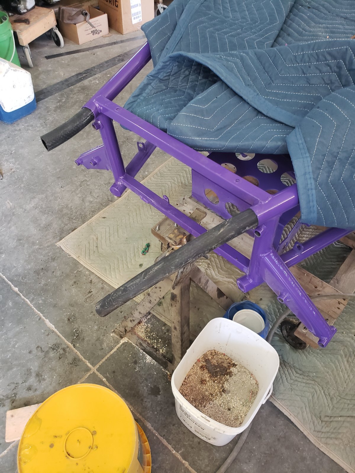

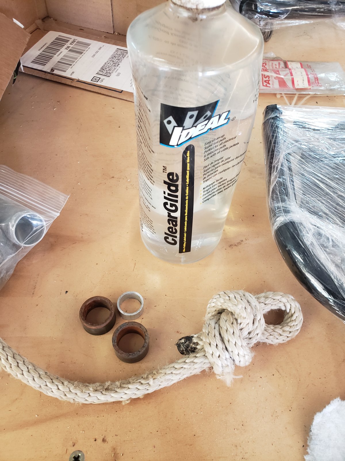

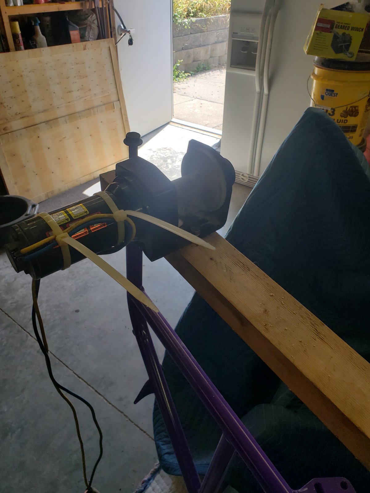

This week we succeeded in getting the radiator hoses routed! We did change things up a bit. for one we used the ATV wench, coupled with a larger metal ring as our hose to rope clamp so that it would be further up the hose "taper". We also switched up to electrician lube and doubled up our rope when we found out the bigger one we obtained was too fat when knotted.

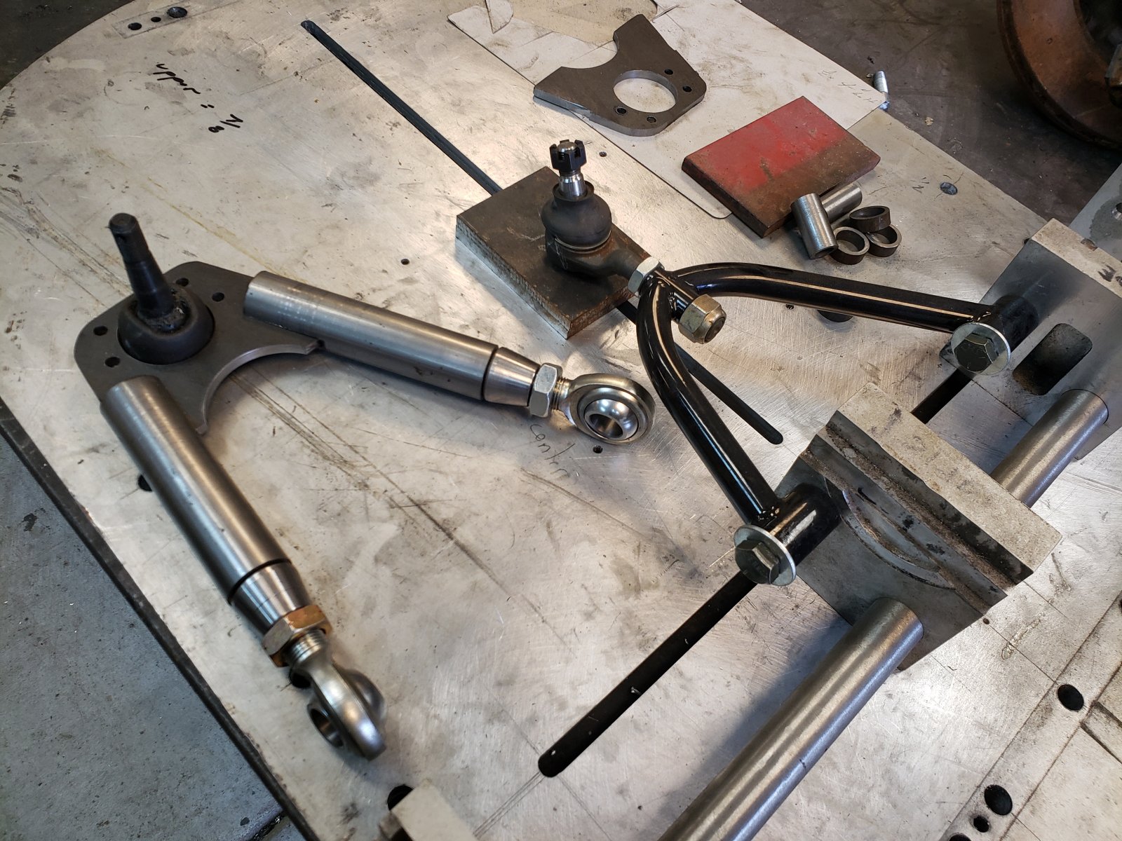

I have 3D models/dimensions of the stock SS/TC control arms I can share, I had a post about making tubular arms that were compatible with stock ones.
I built my own tubular arms (not compatible with stock). You can replace all of the bushings with heims easily. You can replace the ball joint with a hiem by using a custom pin that fits the knuckle.
Let me know if you want any additional info.
AWESOME! yes i do love 3d files. I believe yours was the thread I read yesterday about the tubular project. That looks like a lot of effort but very well done.

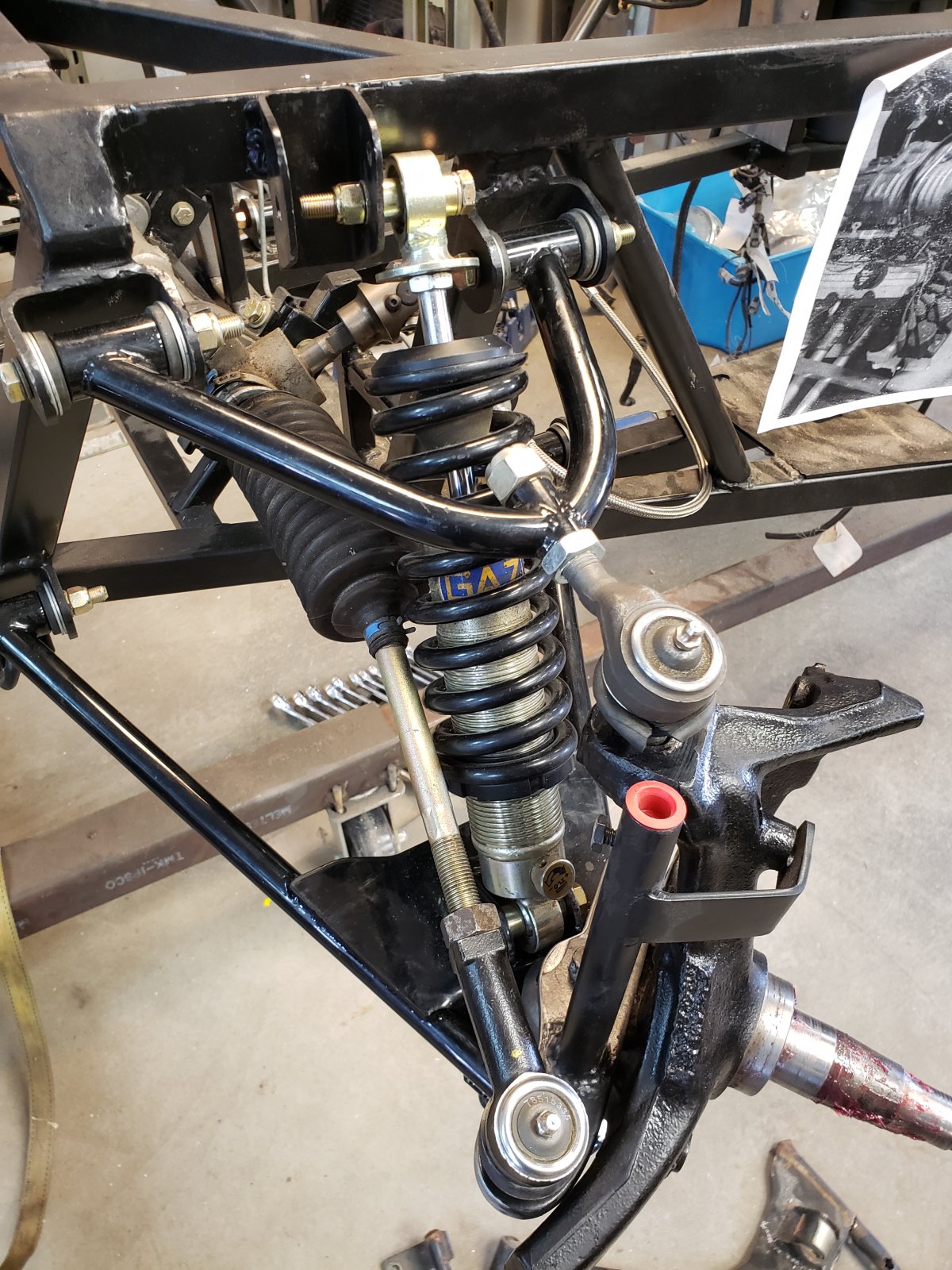

So i don't know if ya'll saw my stalker on the other builds thread but when i got it both front wheels had been ripped off in a track accident of simply hitting the candy cane too fast and the car did a belly slide and needed a whole new chassis too to be put back together. the Stalker for ME was a million lessons on how NOT to build a car.
Above the black arm is the upper Stalker control arm. You might notice a tie-rod end- yes a tie rod end, , , , that Brunton used for his upper ball joint- and the tubing was VERY thin. . . .1/2 dia 16 ga or maybe 18ga!! the ends of the tubing had cast in place rubber and were not adjustable. the Silver A-arm was a incomplete prototype of the EXACT same geometry as the stalker arm but it used off the shelf S10 ball joint for the S10 uprights Brunton used in his car. My prototype has 1/4 plate for the first version but ended up with heat formed/rolled edges 1/8" plate. it also had A LOT more room for the front shocks. . . Don't seem to have a picture of my version mounted, on this computer, but you can see the problem with Brunton's arm here:

My Stalker is 17 years old now with all original front suspension parts and bushings. Sorry you had a problem with it. Check your lower control arms though. They may be on the wrong side?? The shock mount on the LCA is angled so it positions the upper shock eye mount in the frame bracket -- not to the back. The bolt should be through the bracket, shock eye, bracket again??
Just curious!!

I can send you the mesh file generated from the scan data (.stl) and another file of primitive shapes that were fit to the scan data (.step). These 2 files share the same coordinate system, so if you drop them into fusion, they should overlay and give you a mesh to view and some geometry to work with.
I still use SolidWorks, so I can export the ball joint custom pin setup I did as an .iges or .step. It wont be parametrically editable in fusion but you can still modify it.
Shoot me a PM with your email address, I should be able to get you the files this evening.
Just curious!!
Hi Dale!
The picture was taken YEARS ago- in out 6 year rebuild process. Yes, the shock did end up getting captured inside the upper bracket- eventually. We managed to get all new upper and lower arms from Minehart (SP) at Brunton cars about the time they were wrapped up in bankruptcy. The lowers were 100% identical with no twist at all between the lower shock brackets and undrilled- i am pretty sure my Flickr page has some of the drama about that mess notated. I do not know if something changed along the way. The arms also came without the rubber bushings inside and that alone caused a lot of grief.
Either way I am VERY partial to my version of the arms (lol) which we do not actually intend to run on the Stalker. . . .we have another car under development I refer to as the legacy car that is pretty much a morphing of lessons learned (and hopefully improved upon) from the Stalker and the styling of the 28 Bugatti powered by a LS3 that the arms are intended to be used on.
