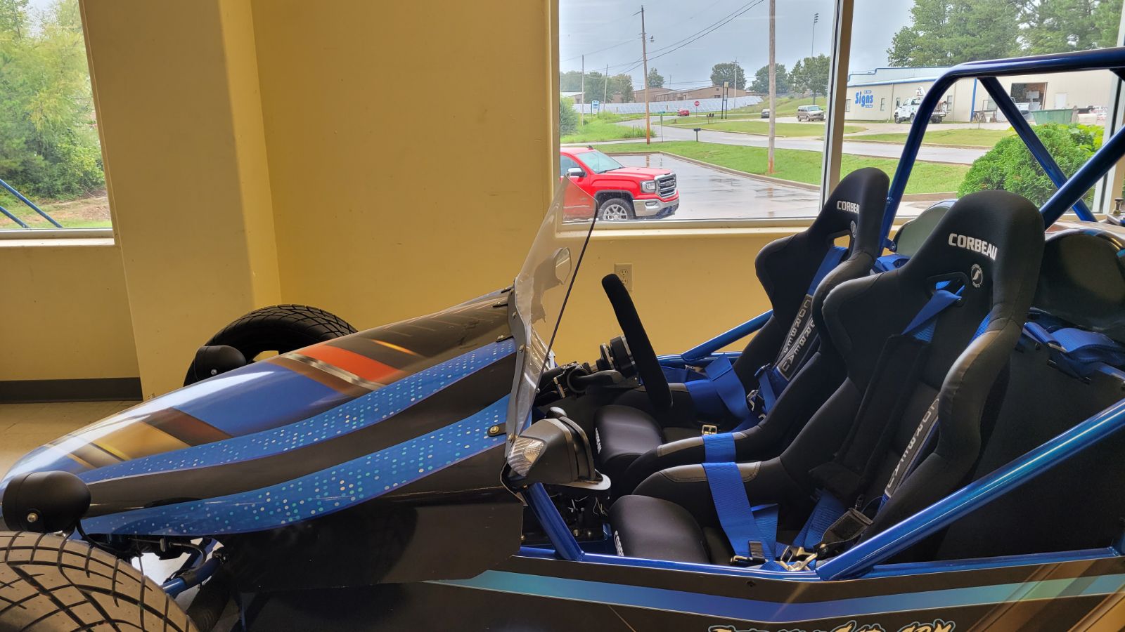

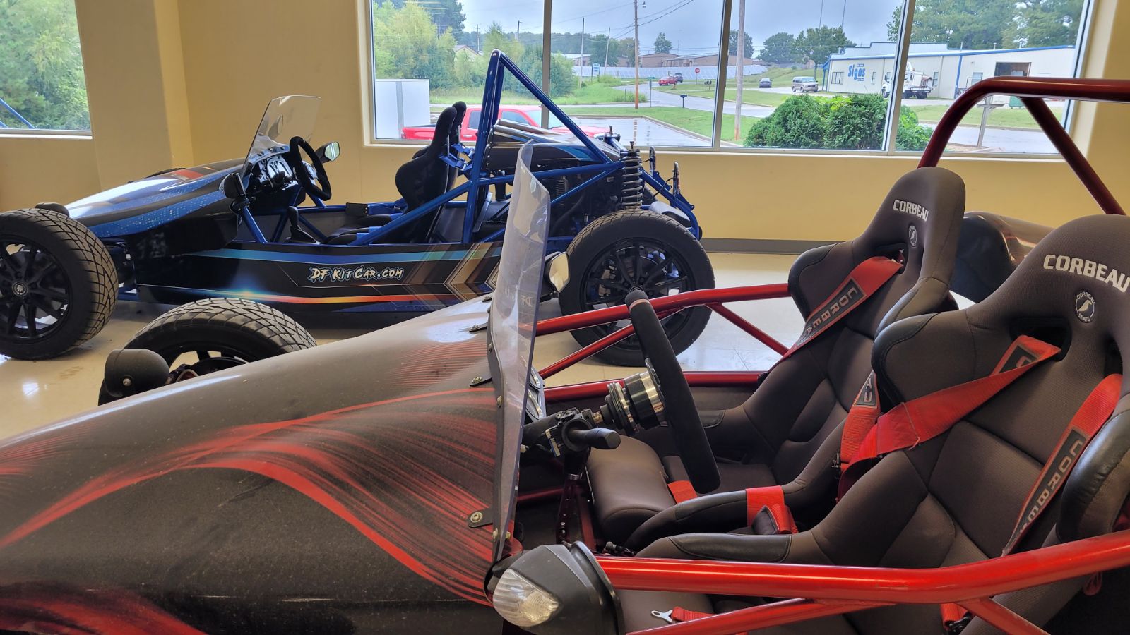

Per Lonny. The frames at least through 254(which is mine) the windshields were set at 38deg. The later ones were leaned back to 28deg. I took mine off and using 2 crescent wrenches and a rag to avoid scratching the powder coat I was able to lean it back 10deg. But to be honest I wish I went another 5
SmsDetroit
The red one is at the 38deg and blue is at 28deg
