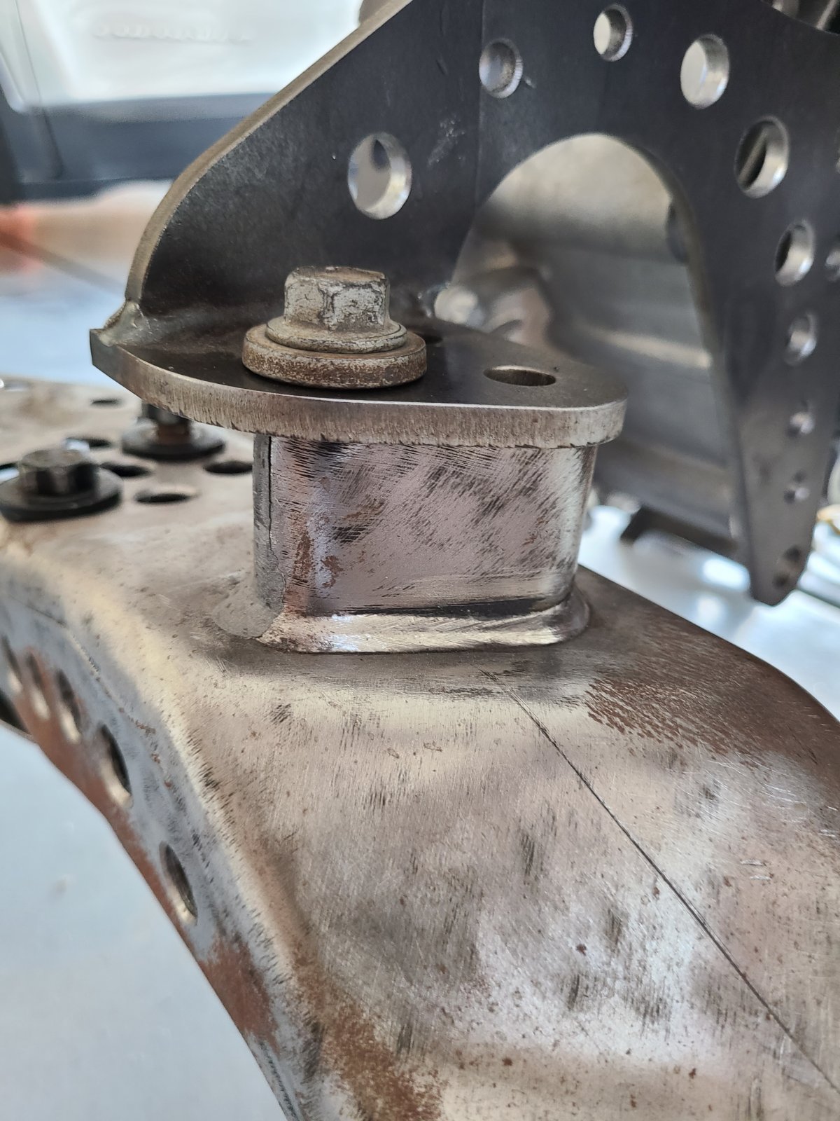

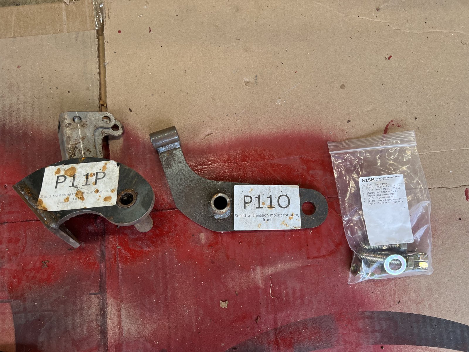

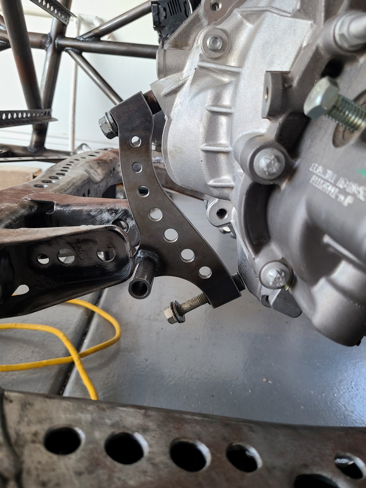

Guys, I recently finished the last build video, #24. I was going thru the parts that I have left and came across these two metal brackets (parts P11O and P11P) and a hardware bag (part N15M) that are all labeled Solid Transmission Mount for Auto. Never saw these parts in any of the build videos. Did a search here on the forum and couldn't find any matches. I feel like I probably should have already installed these. Can anyone show me where these parts are to be installed?
36829
P11P is the rear mount that bolts onto the raised triangular three bolt pad on the rear side Cobalt subframe. P11O is the front mount that bolts onto the double ear mount on the front side of the Cobalt subframe.
The mounts should align with bolt holes in the transmission case - I don't have an automatic so I don't have photos. These are photos from the manual transmission solid mounts, the automatic mounts should be mounted similarly.
W
Ok. I see where these are supposed to go. I actually reused the donor transmission mounts front and back, and have those bolted in so I think I'm good to you with this. I'll just put these parts to the side.
Thanks for reply.

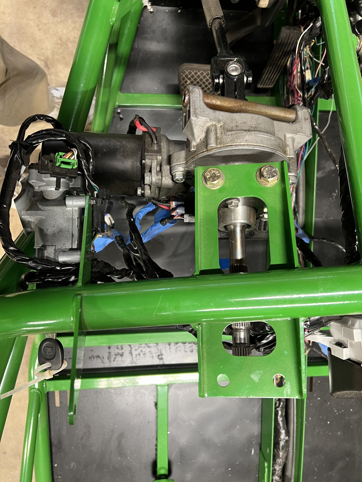

Guys, I decided to try and get the steering wheel installed. I see how the steering column hardware gets installed on the frame and extends toward the inside of the Goblin with the shaft in the middle of it. Thing is, my steering wheel shaft doesn't even extend to the end of the top bracket that the steering column hardware attaches too, as you can see in the pic.
36970
I read some stuff on the forum that made me think the steering wheel shaft should be able to slide in and out. My shaft does not move so I'm not sure if that is right. Maybe I installed something wrong? Backwards?
Can someone shed some light on what I'm missing here? Thanks.
