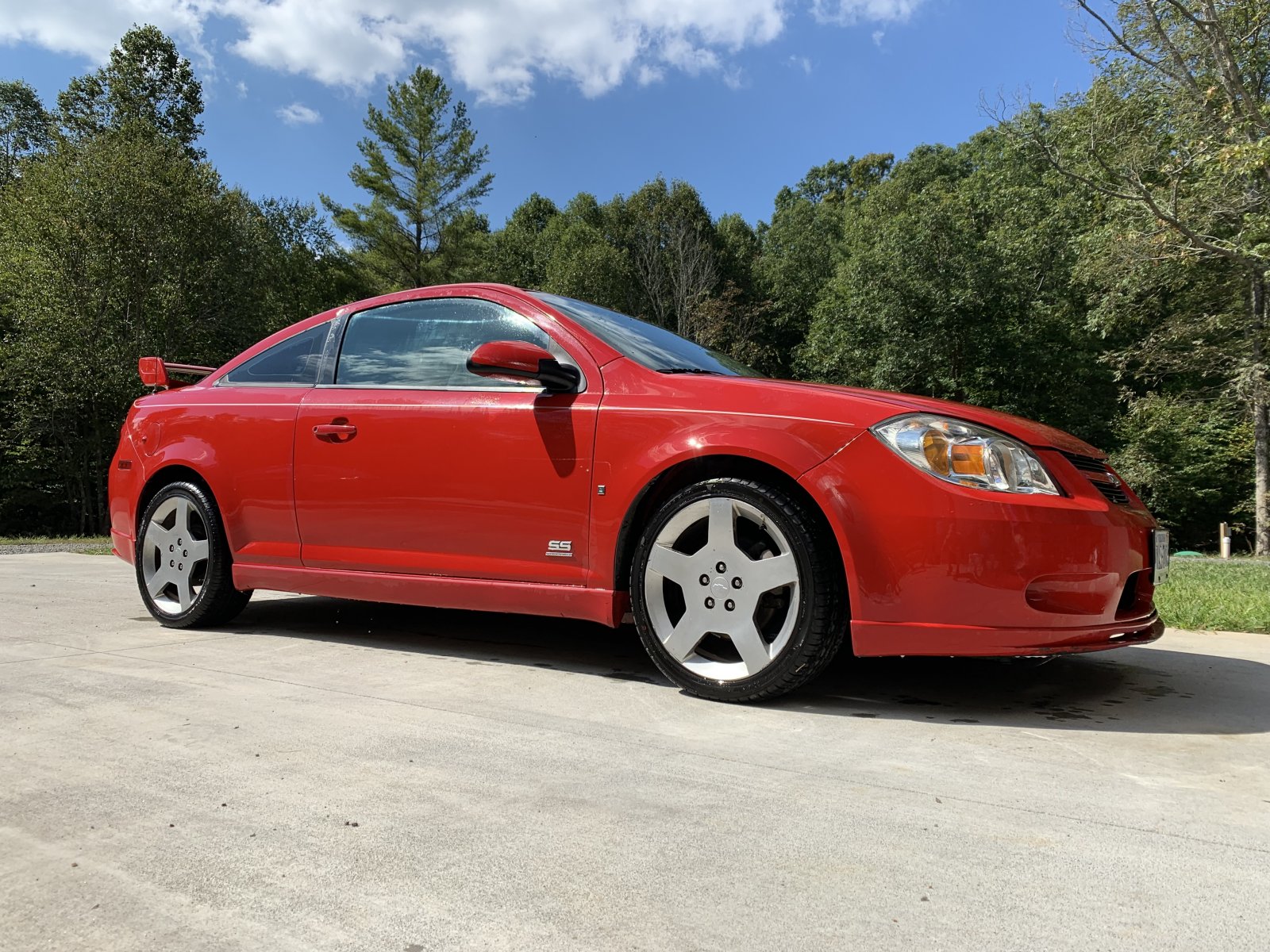

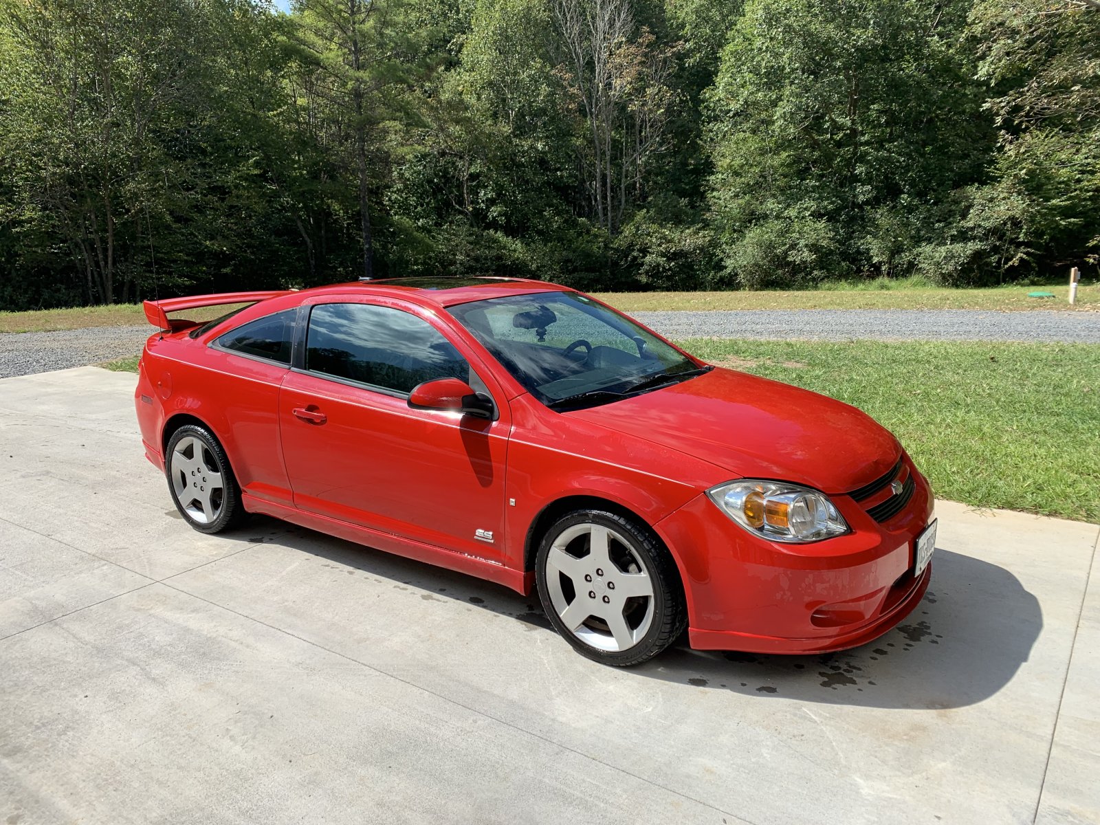

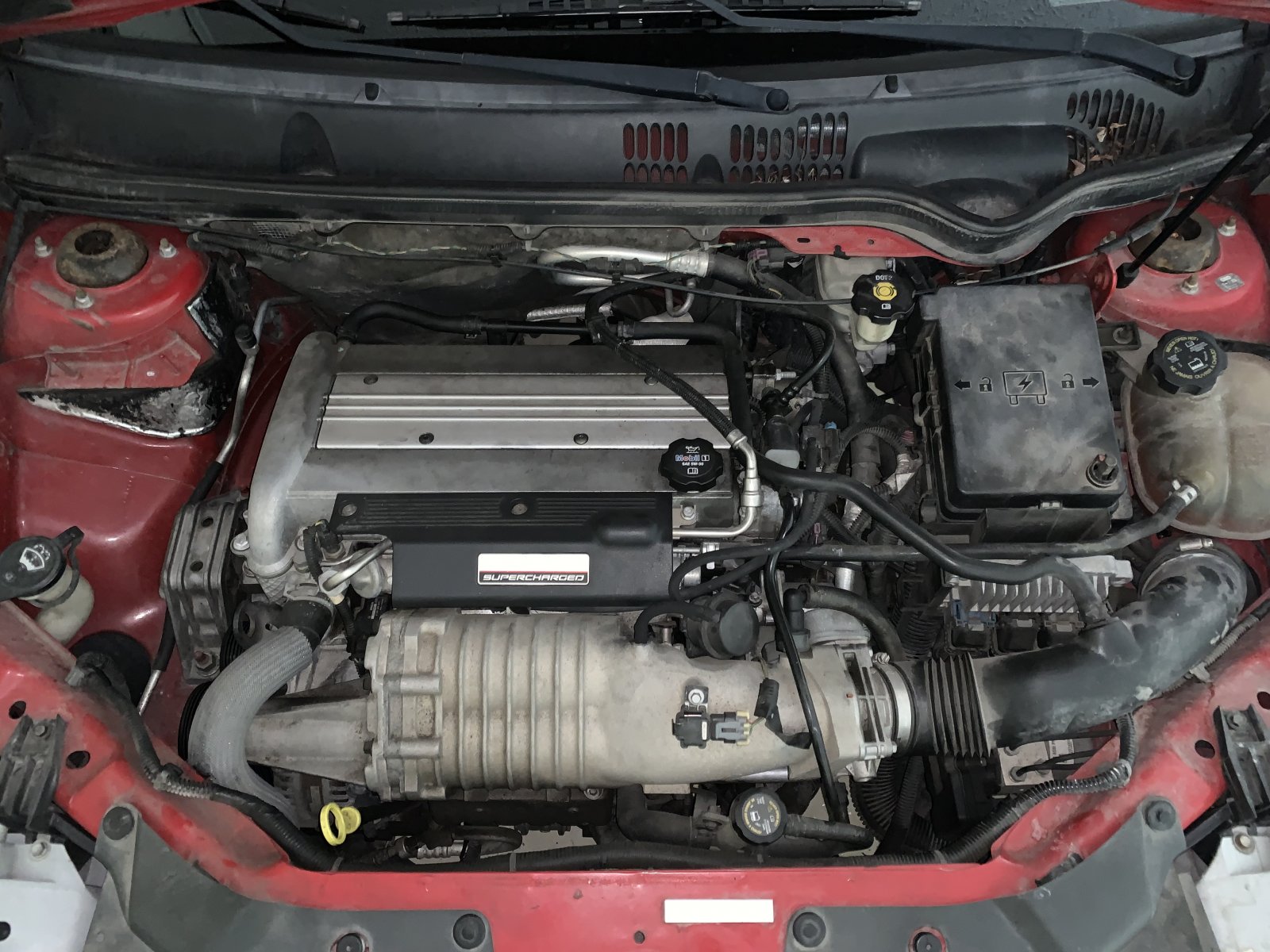

Hello all,
Chassis #173 has been confirmed. Stage 1-3 currently slated to be ready mid-October. The donor was purchased on 09/07/19 here in SW Virginia for $2200. 203,XXX miles, normal wear, completely stock, functions great overall. I have only built turbo vehicles (YouTube link below) so I wanted to try the supercharger realm.

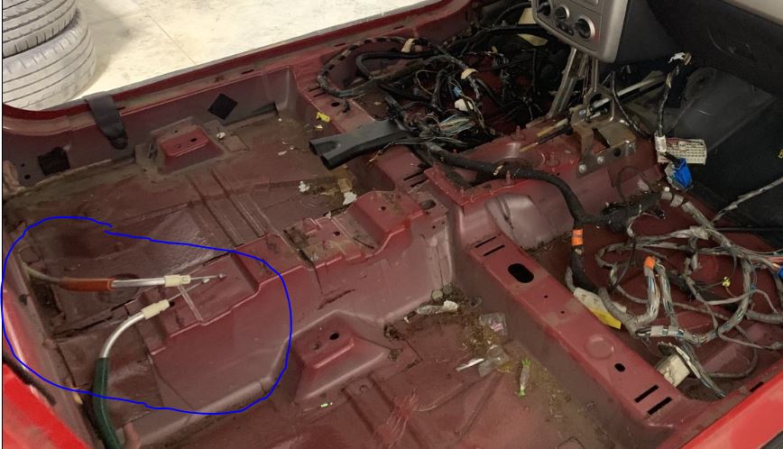

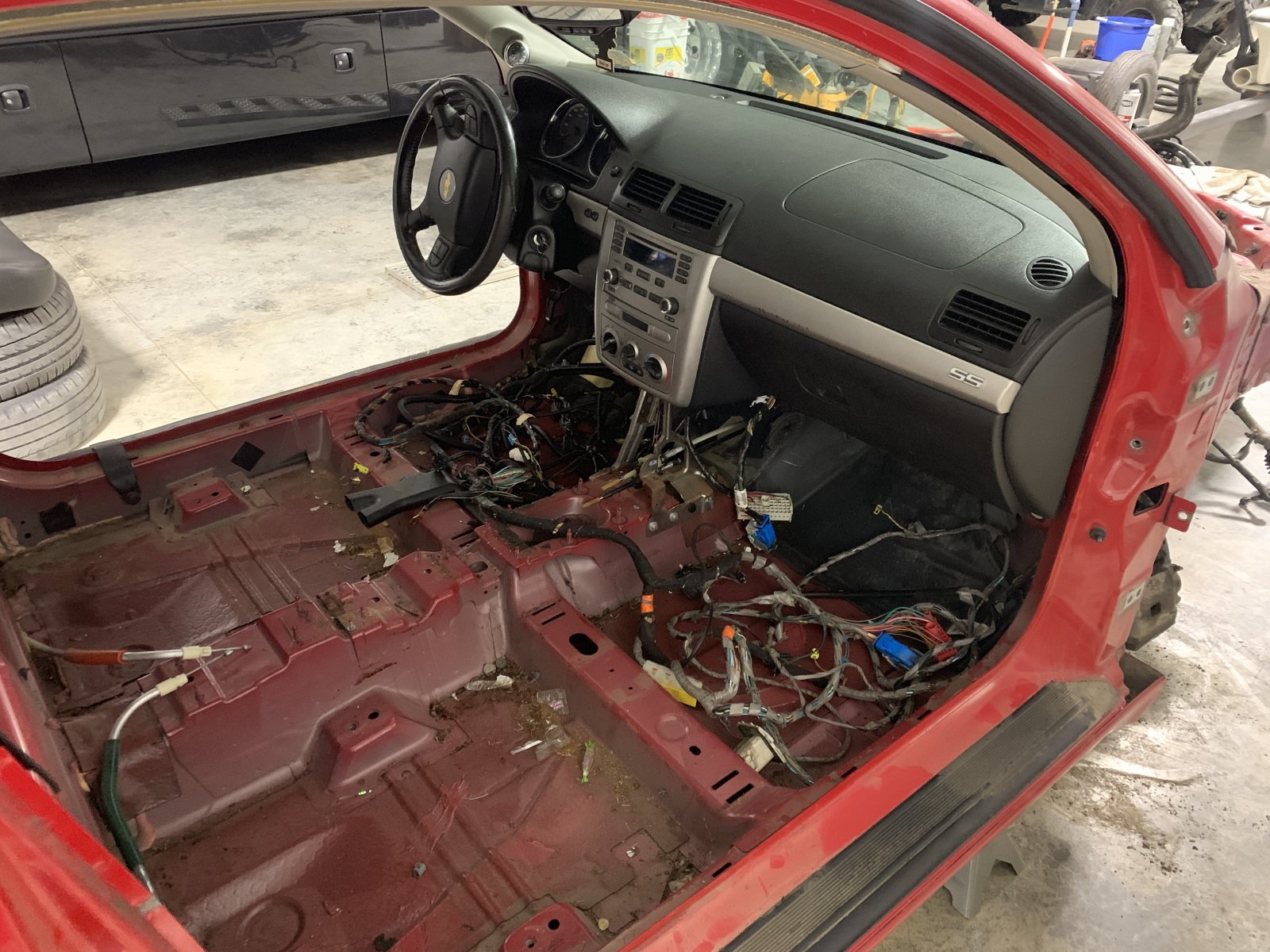

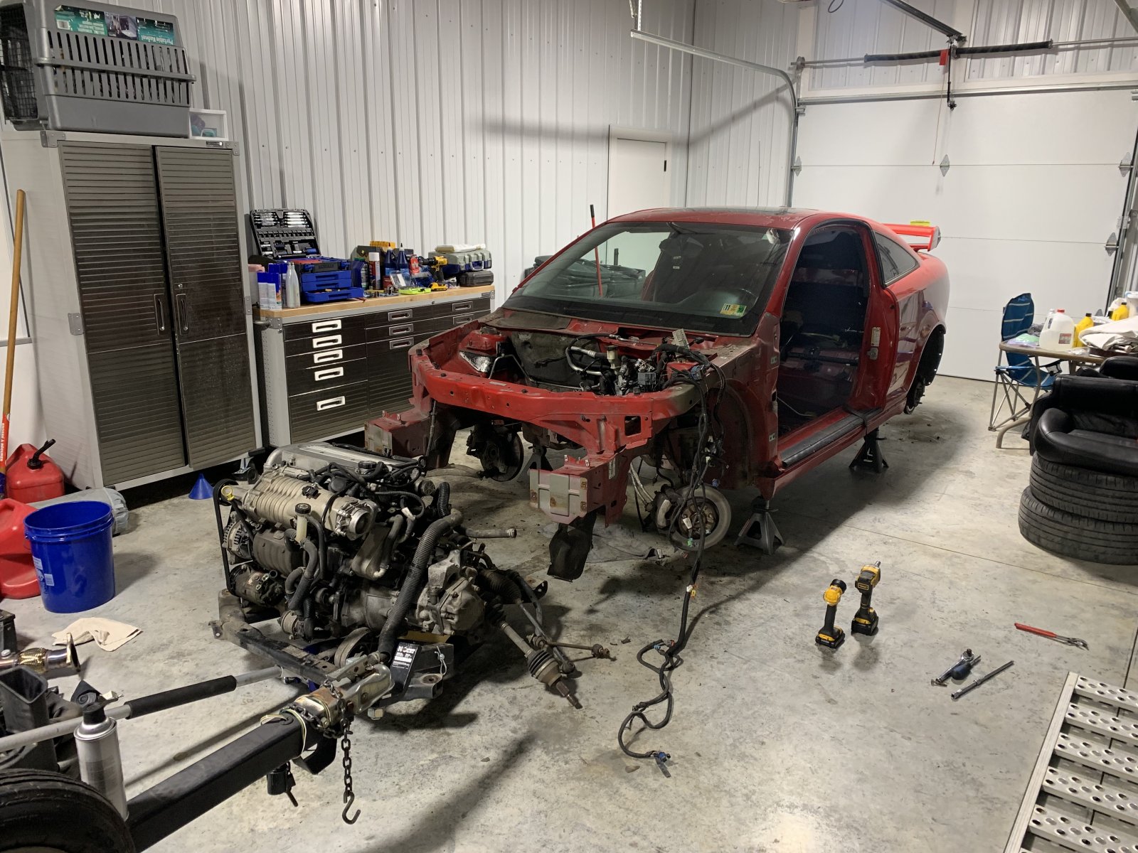

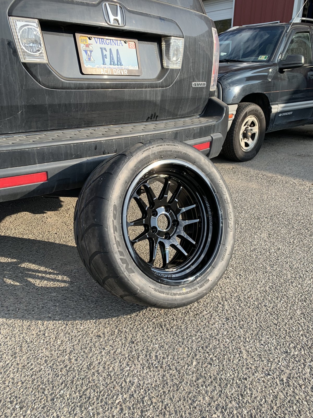

It was a very productive day. Tires were mounted this morning and I began stripping the car. I need to double check the retained parts list, but only a few items remain in the car. I plan to pull the dash, drop the fuel tank to get the sender and filler neck, and get the harnesses ready to ship in the morning!

Don't forget to keep your parking brake cable conduits. I forgot them on the first donor because they're not on the retained parts list. This is assuming you're putting in a parking brake, of course...
When you say conduits, you mean the cable and everything? I cut my cables yesterday thinking I was good to go :(
Welcome Lechlis! I take it your getting the wiring service. I am too and I purchased in Aug and haven't heard from them yet. Did they say how long the wiring service takes? Looks like I need to reach out to them
I do mean both, I apologize. But, the cables can be bought online relatively easily, while the conduits seemingly not. My searching might have just been weak, but, that was my experience.
For those in the same shoes as me: https://www.rockauto.com/en/parts/dorman,C661271,parking+brake+cable,1696
$14 -- not bad at all. Thanks for the insight! Sorry to hijack
Also a potential option: https://www.speedwaymotors.com/shop/speedway-motors-brake-lines~8207-10191-4295-3-478-30467
