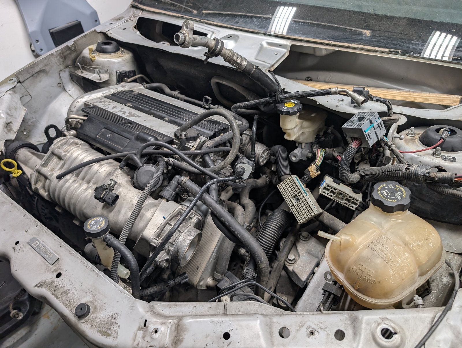

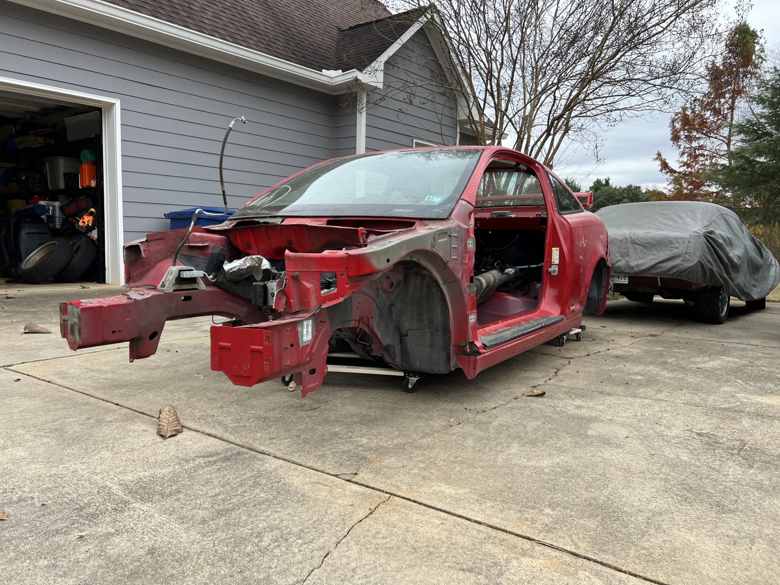

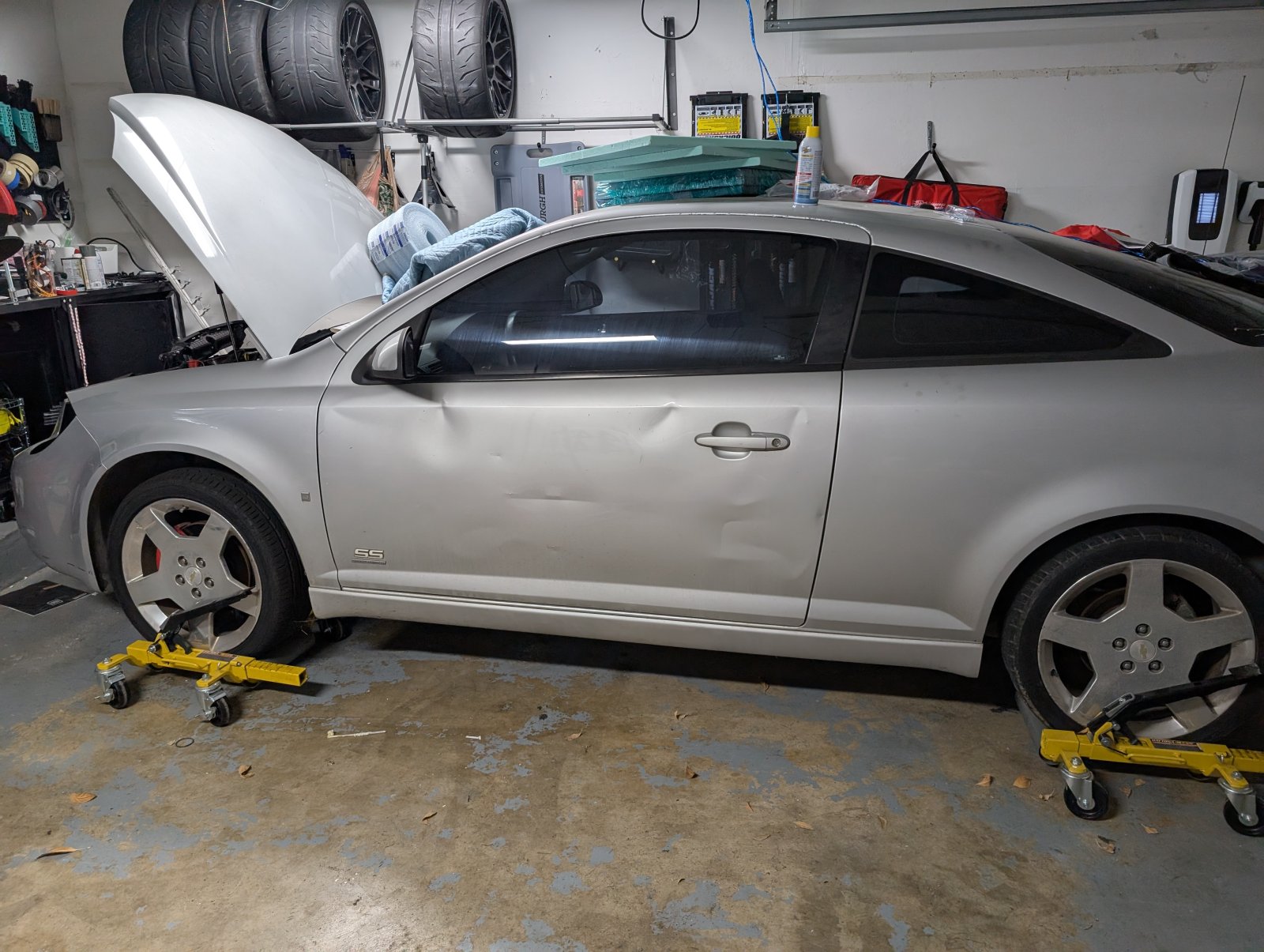

Donor still mostly intact
Donor as of 2/24/25

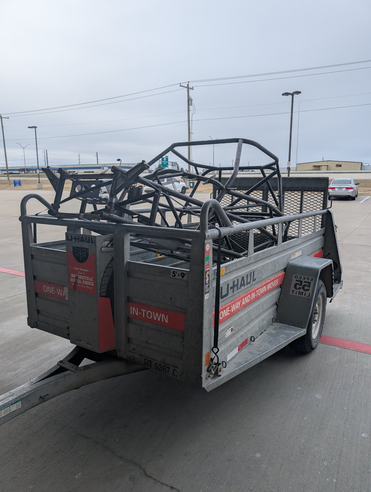

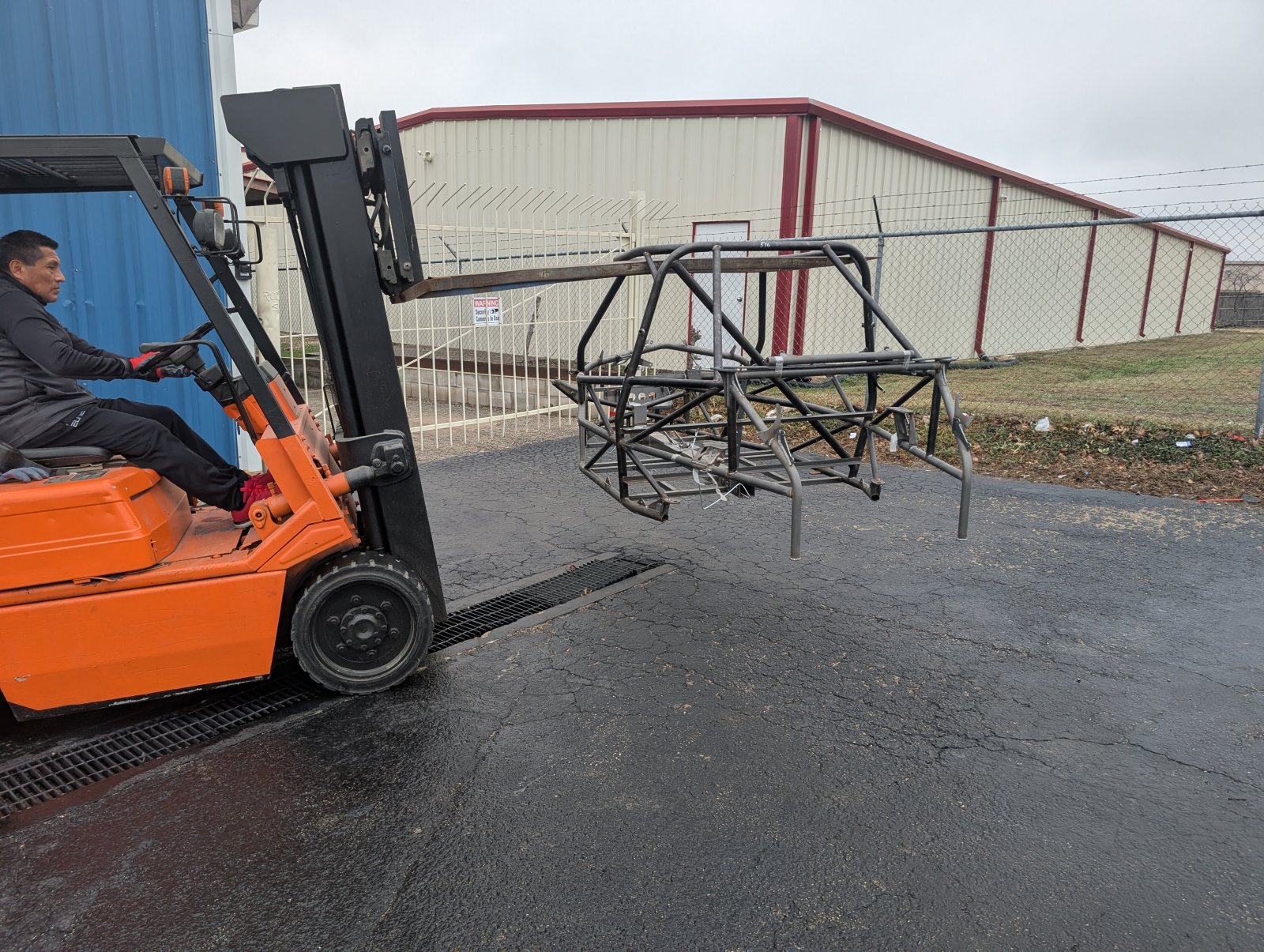

Chassis fits well enough in a 5x9 UHaul Trailer
Dropping it off for powder coating

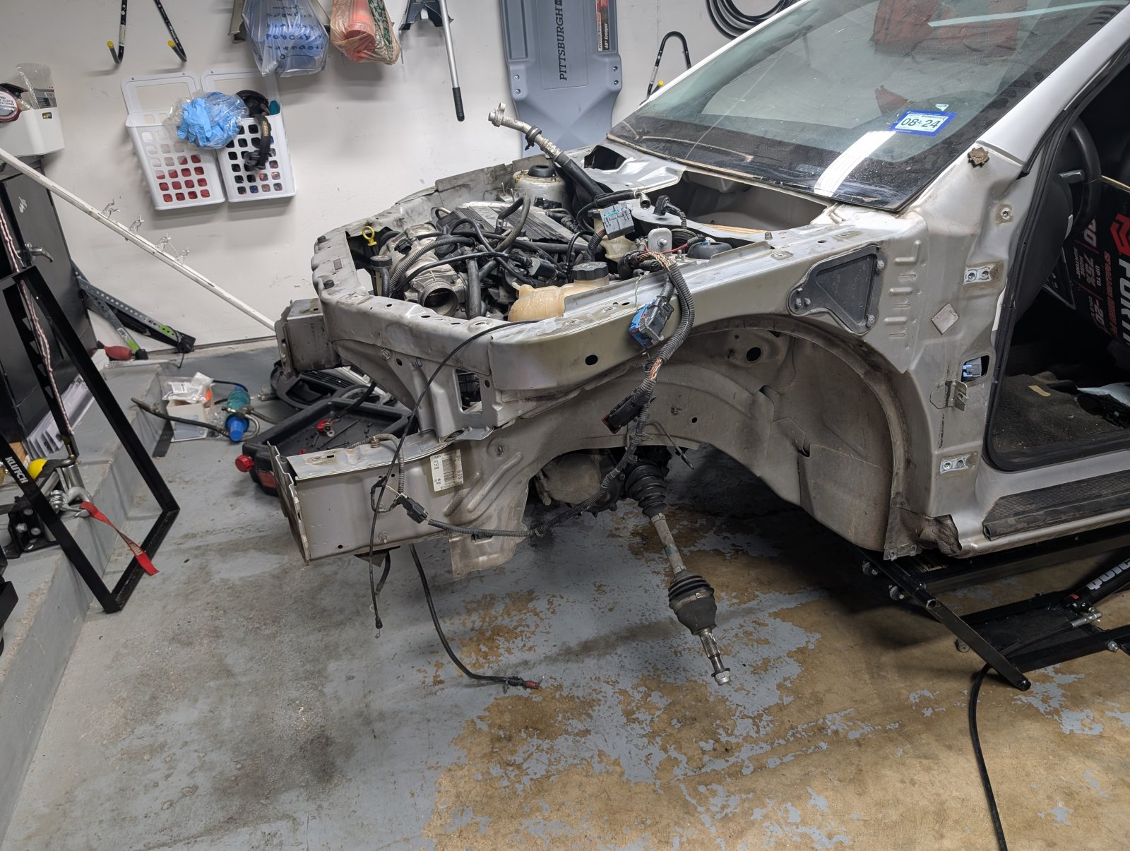

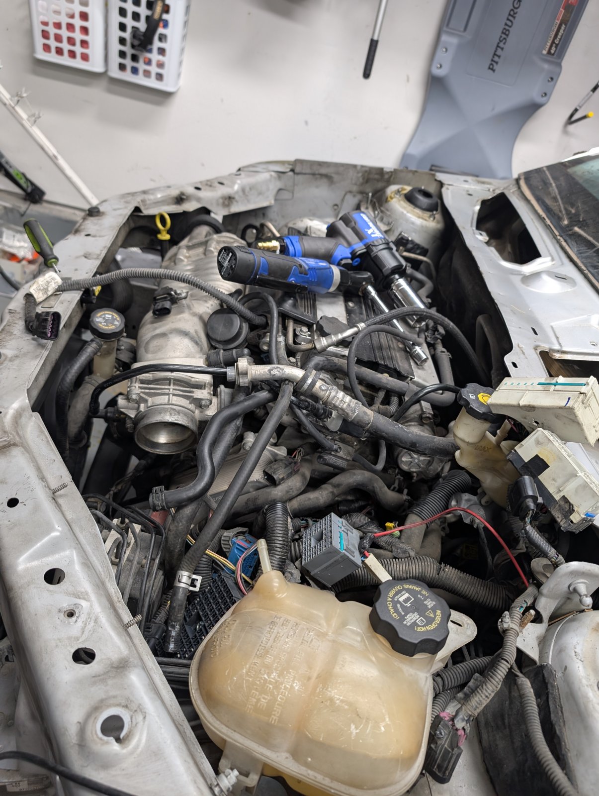

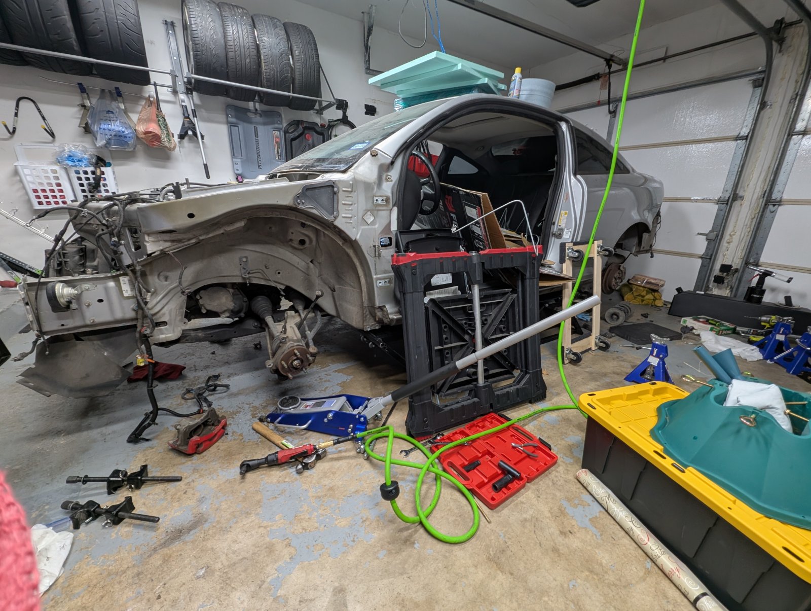

Update: I was a little chaotic on my approach last night. Continued on the suspension components, the instructional video went into draining the transmission next but ADHD kicked in and I decided to start extracting the harnesses.
- Knuckles and hubs removed
- Fusebox removed
- Harnesses mostly freed from under the hood
- Coolant drained (to a nice spot on the floor right next to the pan I was aiming for)
- Some AC hoses removed
I have never been happier to spend money on the harness service than I am looking at the chaos that is this harness. Tonight I'm going to continue harness extraction, I'd like to get it in the mail to DF to get the ball rolling on that while I work on other stuff.
Next week I'll be recovering from surgery so won't be able to do much physical labor. I'm hoping to get the subframe and powertrain out this week so next week I can sit next to it and clean it.
-John

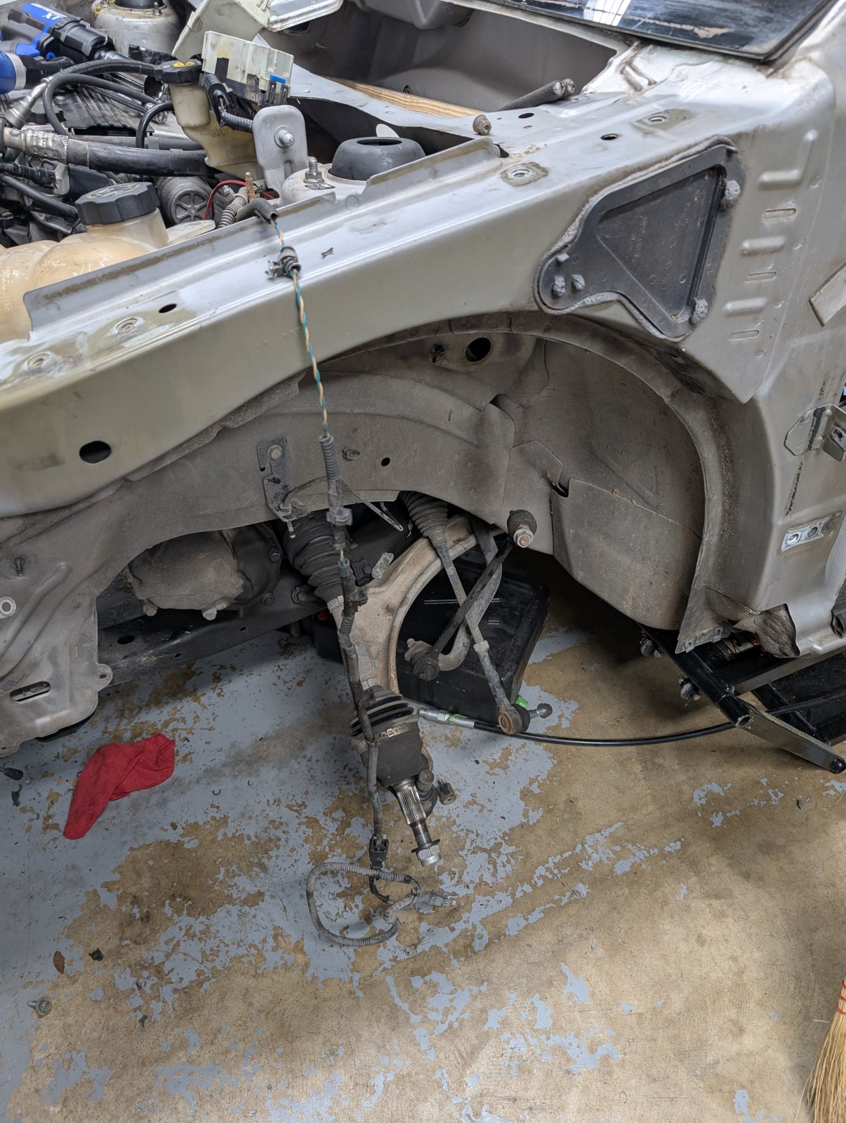

Knuckles/hubs removed:
Electrical chaos:

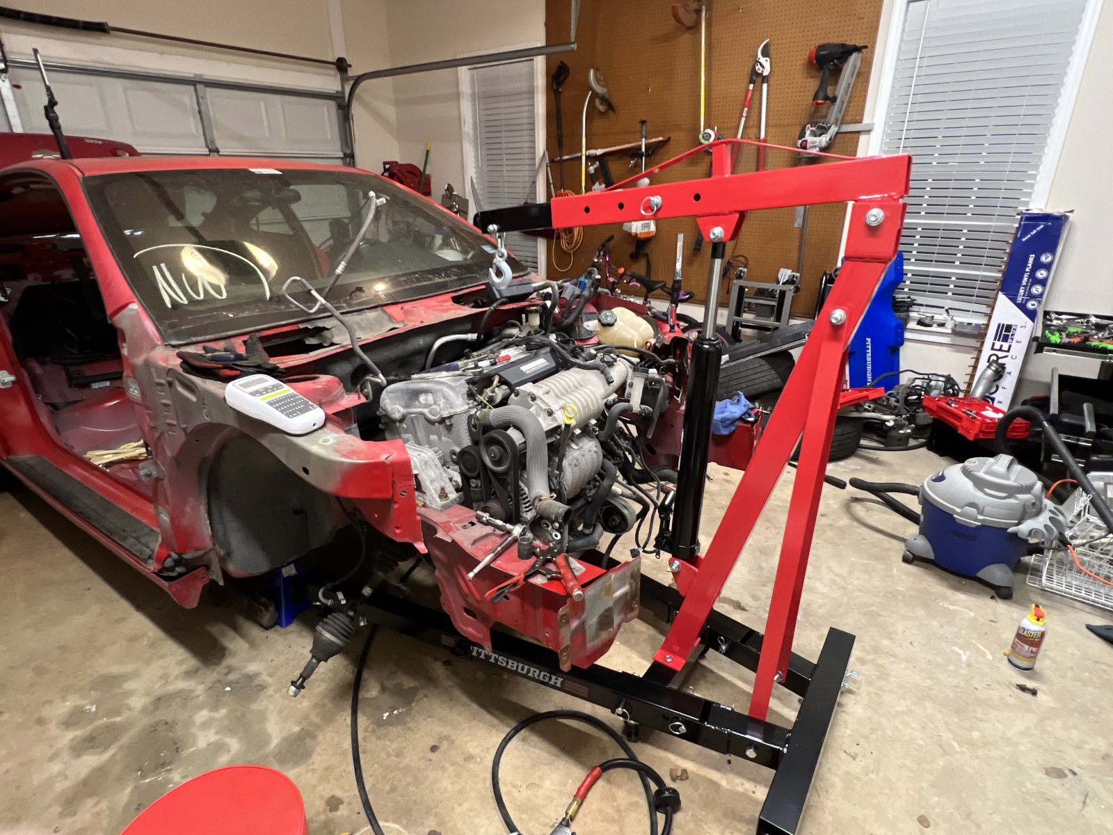

Update for tonight:
Dropped the subframe, and removed the radiator/condenser off the front to make removing wires easier.
Engine appears to be free at this point except for the exhaust, which is taking a bath in PB Blaster for the night.

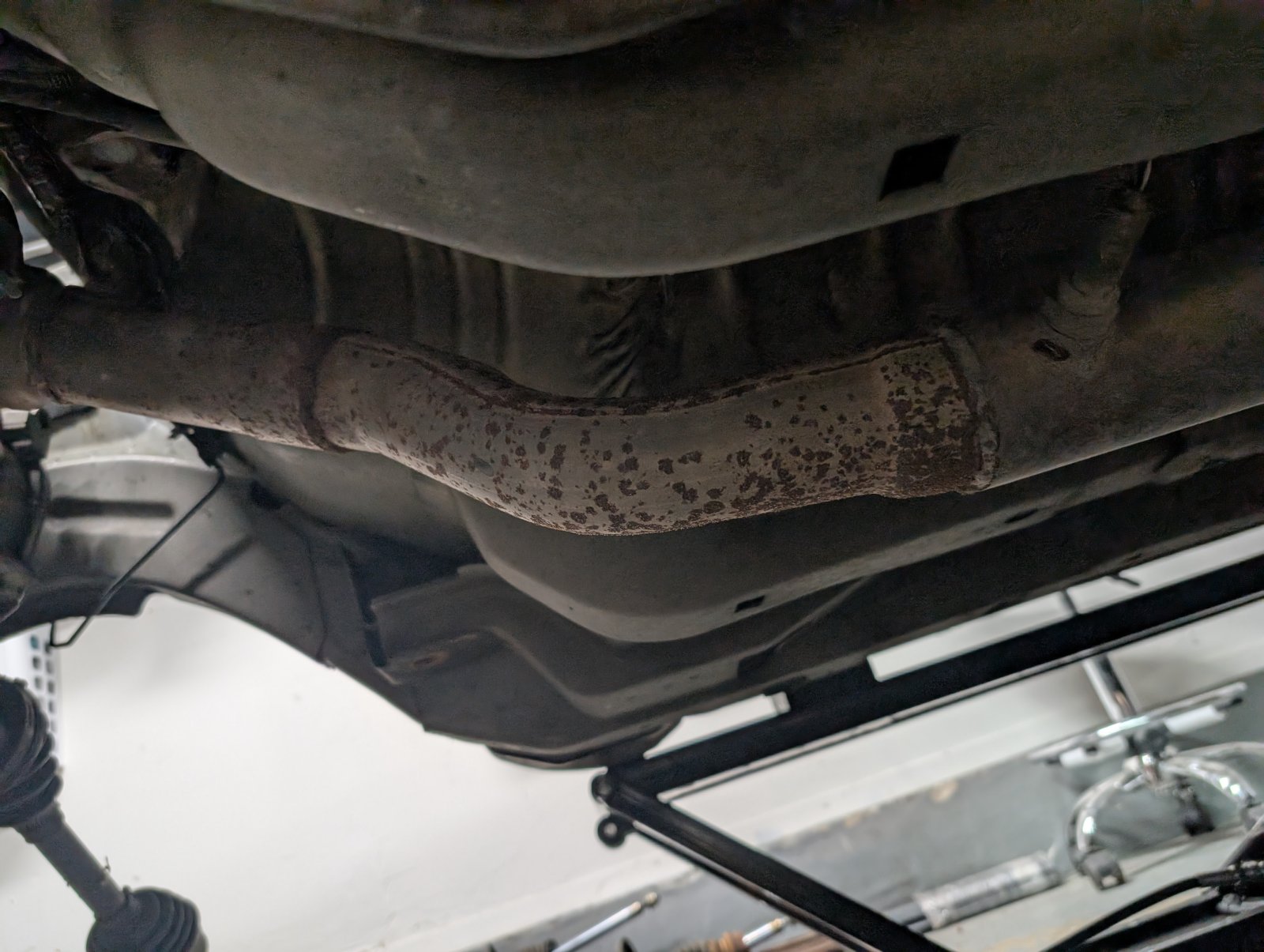

I also confirmed a previous owner installed an ultra high flow cat:
Getting the powertrain dropped tomorrow is seeming pretty feasible at this point, but when looking for a place to attach chains, I see one real obvious anchor on the passenger side front of the engine, but can't for the life of me find another. Should I just be looping chain under the trans on the driver side?
-John
-John
cut the exhaust. no reason to be gentle with it.
As for getting the engine out, I found it was much easier to lower it onto a furniture dolly and then sawzall the front of the frame. Then you just roll it out.

If the impact can't handle the exhaust bolts quickly, I'll bust out the sawzall.
I already planned on dropping it to a dolly but cutting the frame I hadn't thought about.
