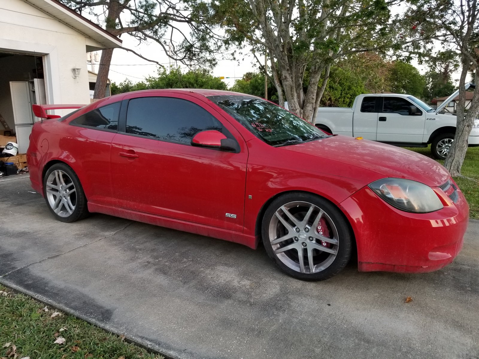

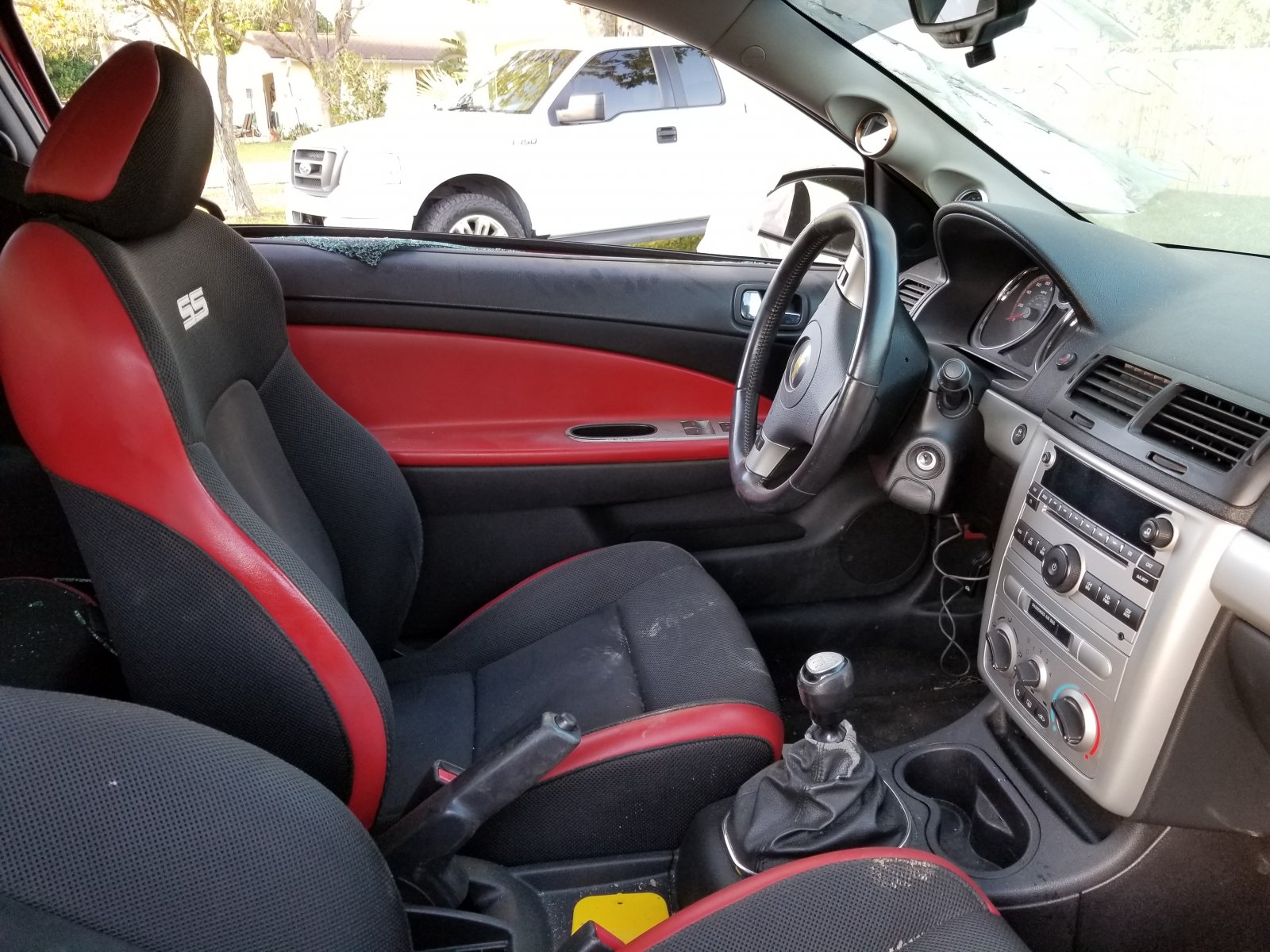

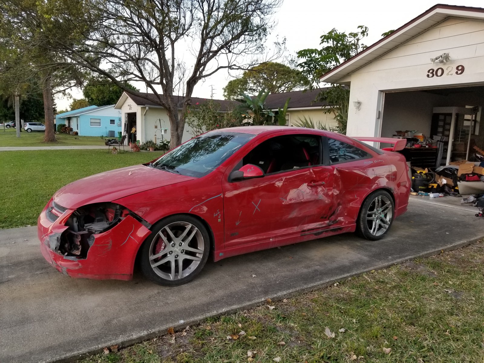

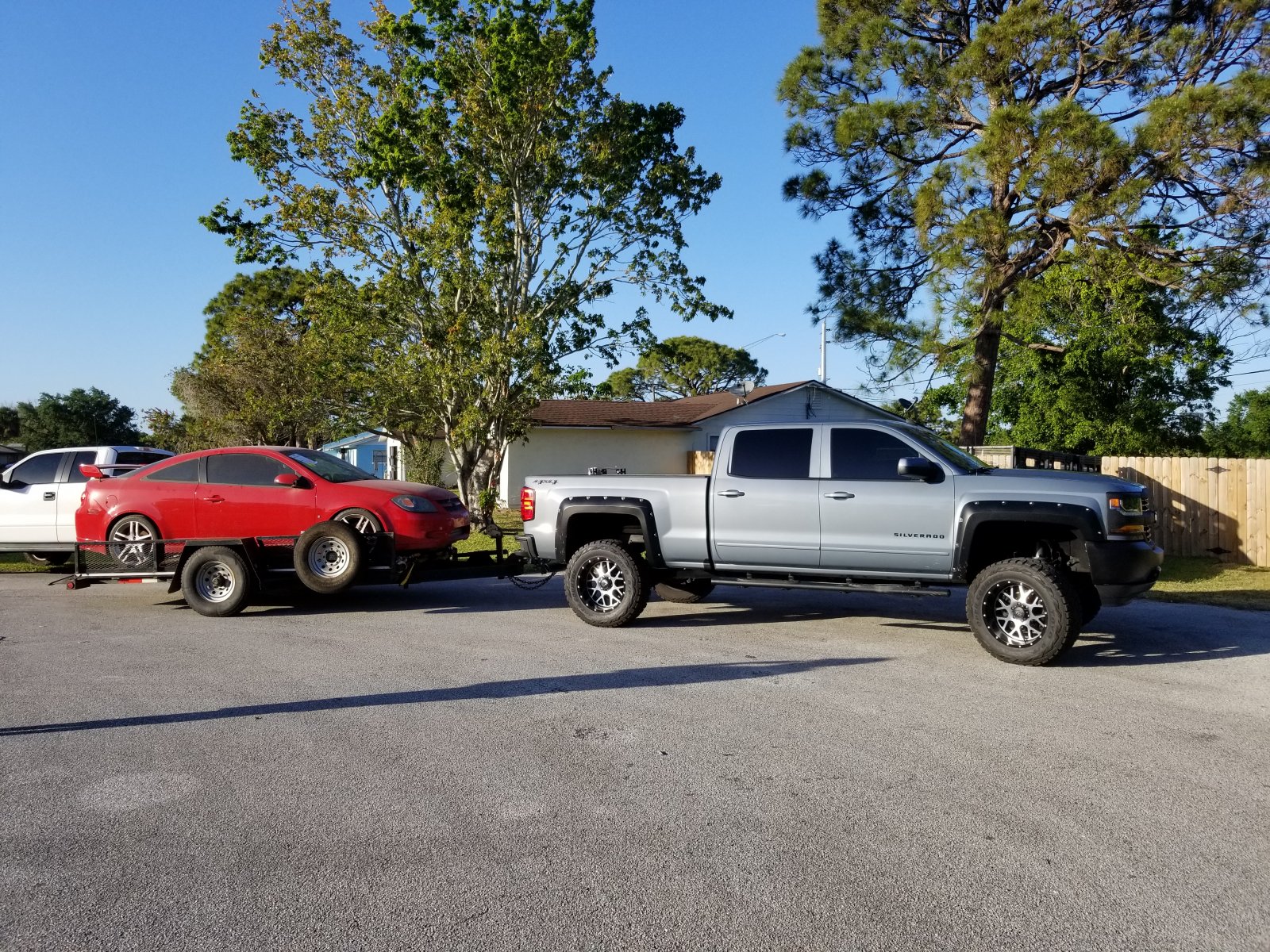

Just acquired my donor and I'm super excited about getting this thing torn apart. Now it's just finding the time haha. The car has 68k on it and drives great even after the NASCAR sideswipe. I'll be updating this as I go along!

Congrats on getting started. When I first saw the first picture I immediately thought. What is this guy doing taking apart this clean car...then I saw the other side.

Thank you! Lol ya, she looks good from the right. Im in Merritt island fl and I just ordered it the other day. It's going to be a extended city with easy entry!

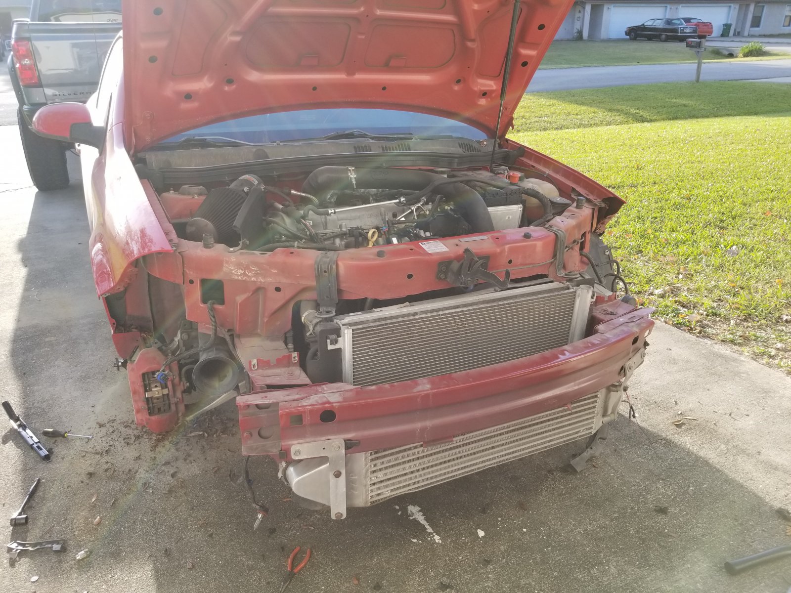

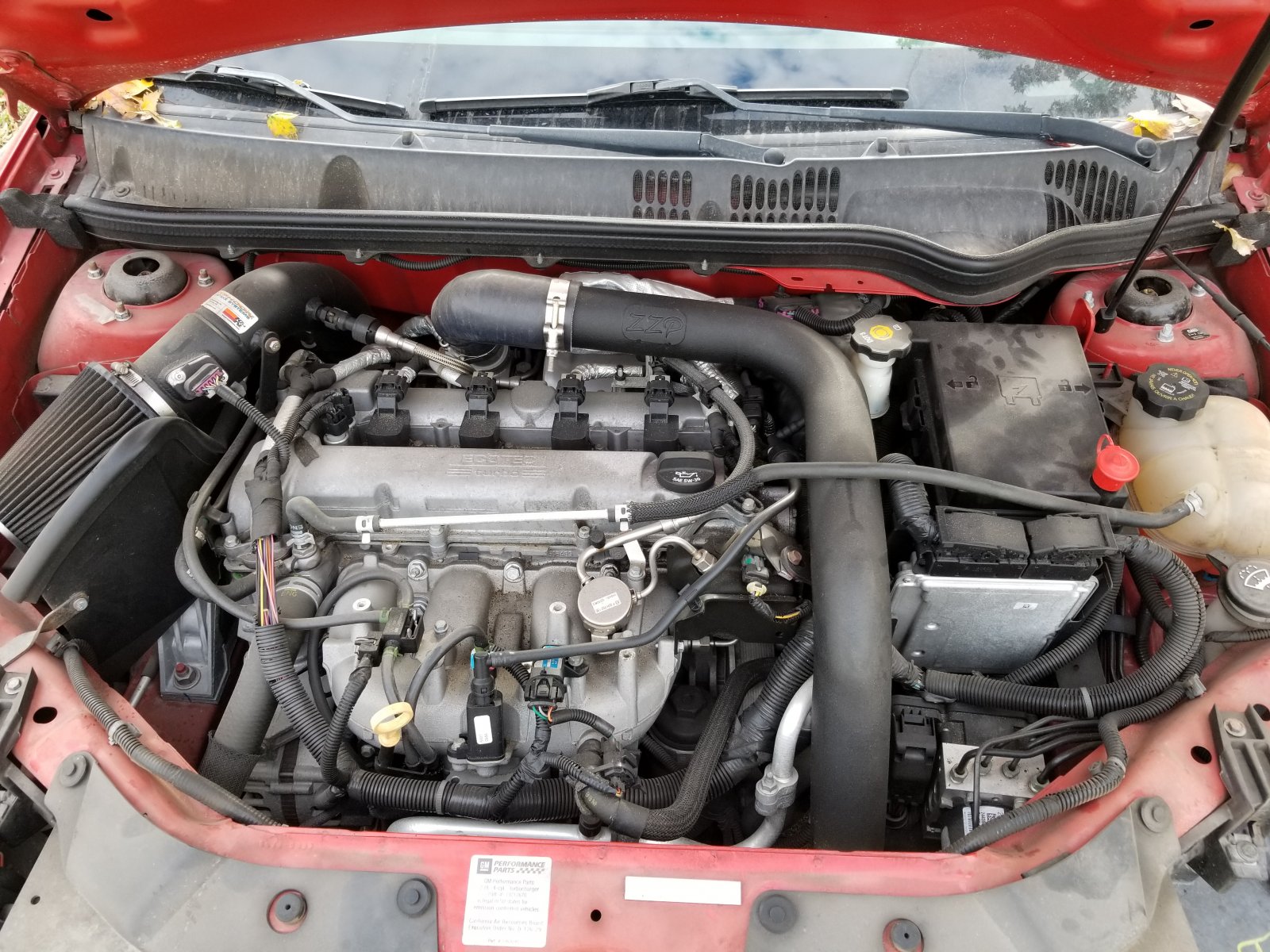

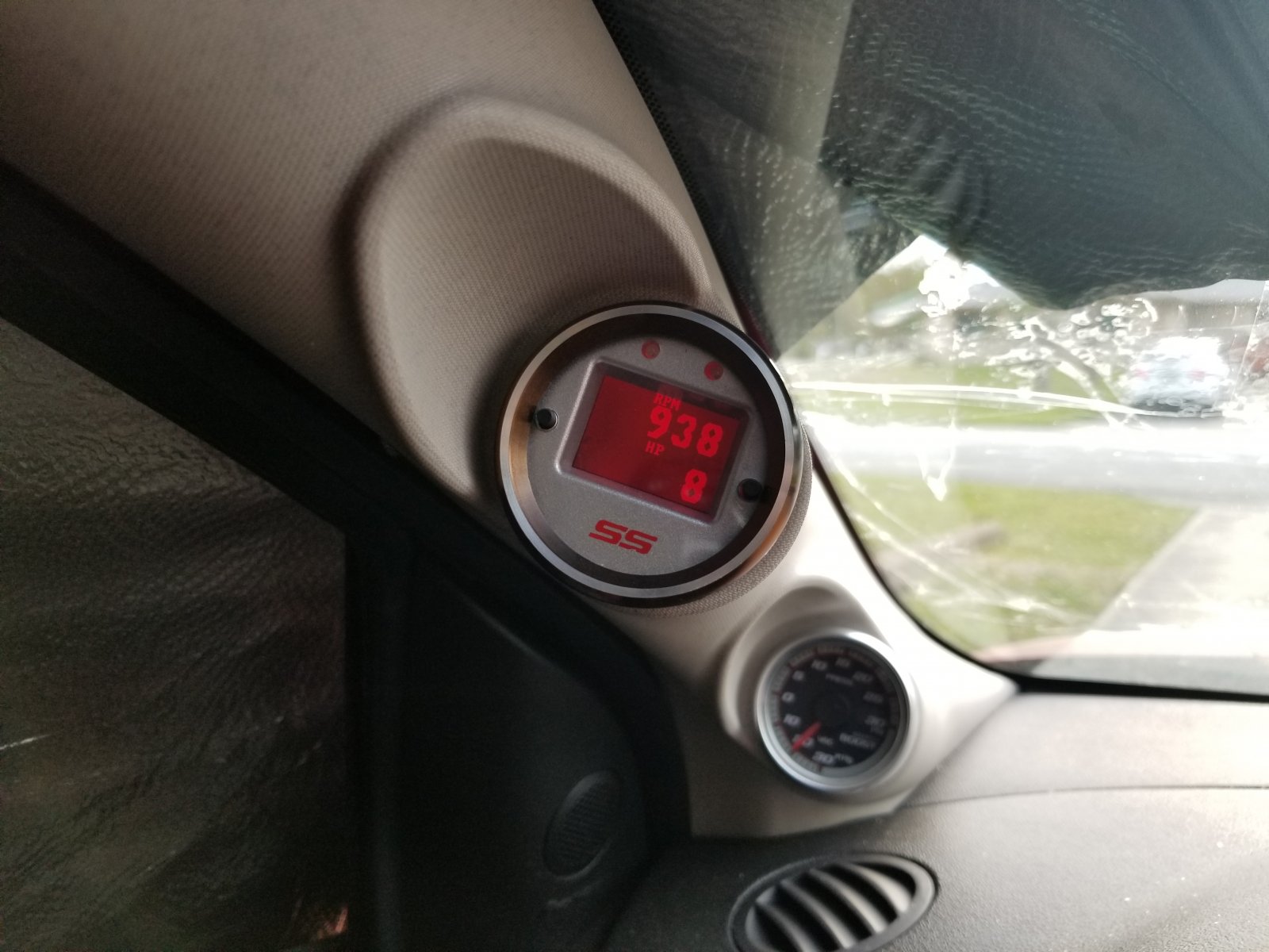

With that donor you're off to a good start. Looks like it has a number of upgrades too. Is that a wideband on the pillar? "Saving" money already haha.
Lethalcast
Lol steady saving money over here. It's a scan gauge and I don't see any kind of boost controller anywhere. Have no idea what tune is on it but it was hitting 23psi

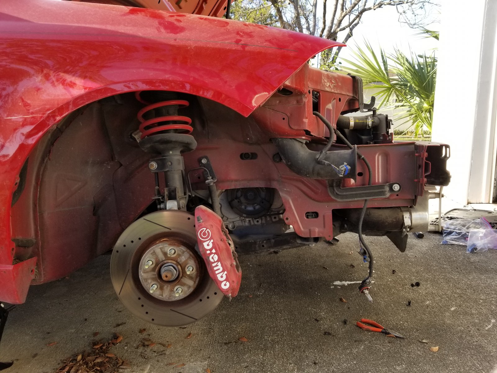

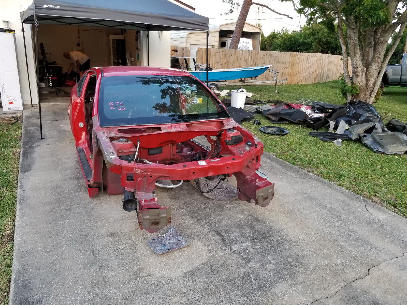

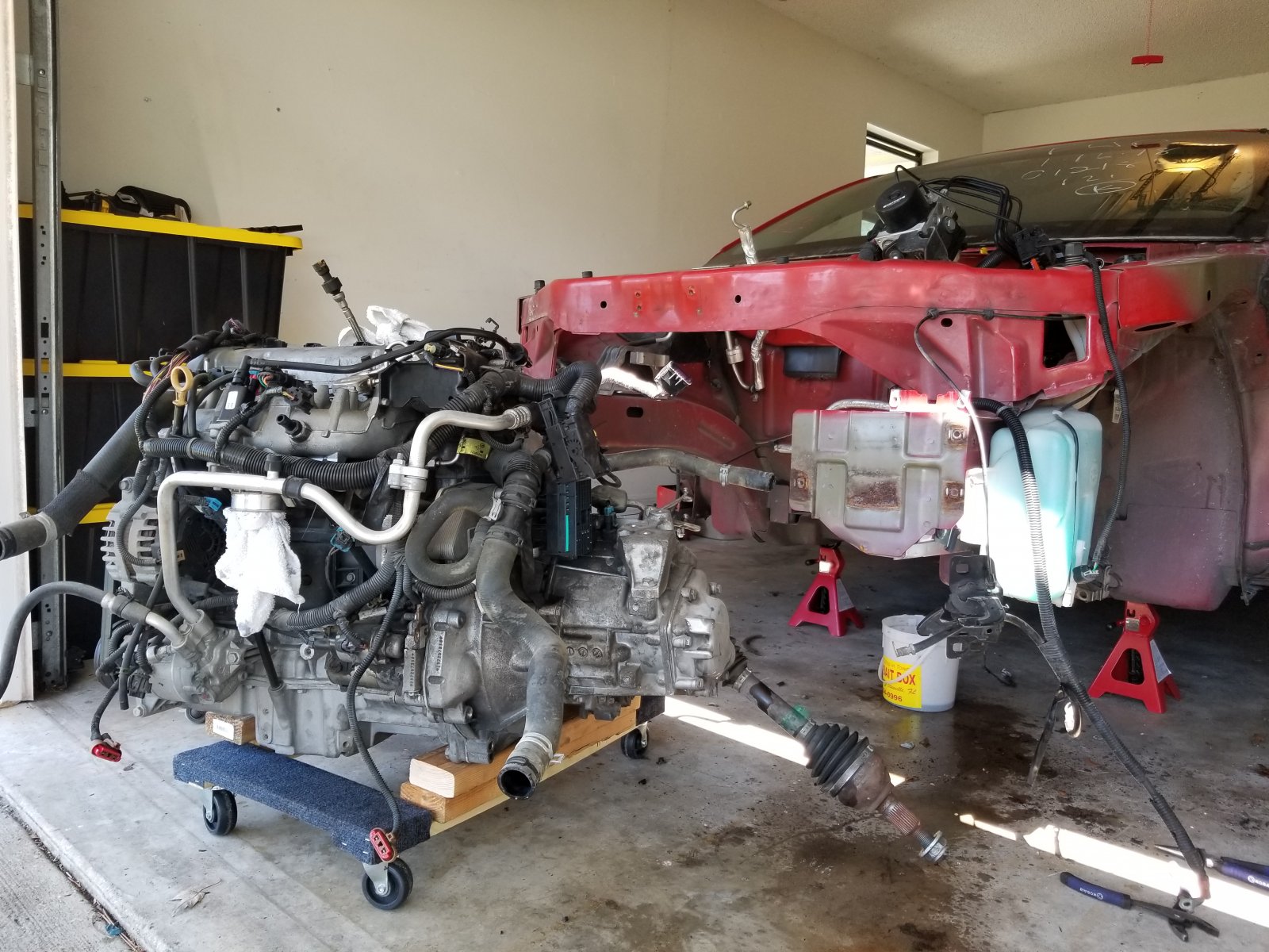

Been a little bit since I posted but I got the donor torn apart the other day and it's ready to hit the scrap pile. Now the wireharness fun begins.
Looks like a bunch of extra goodies! Nice find. That's a perfect car to use in a Goblin.

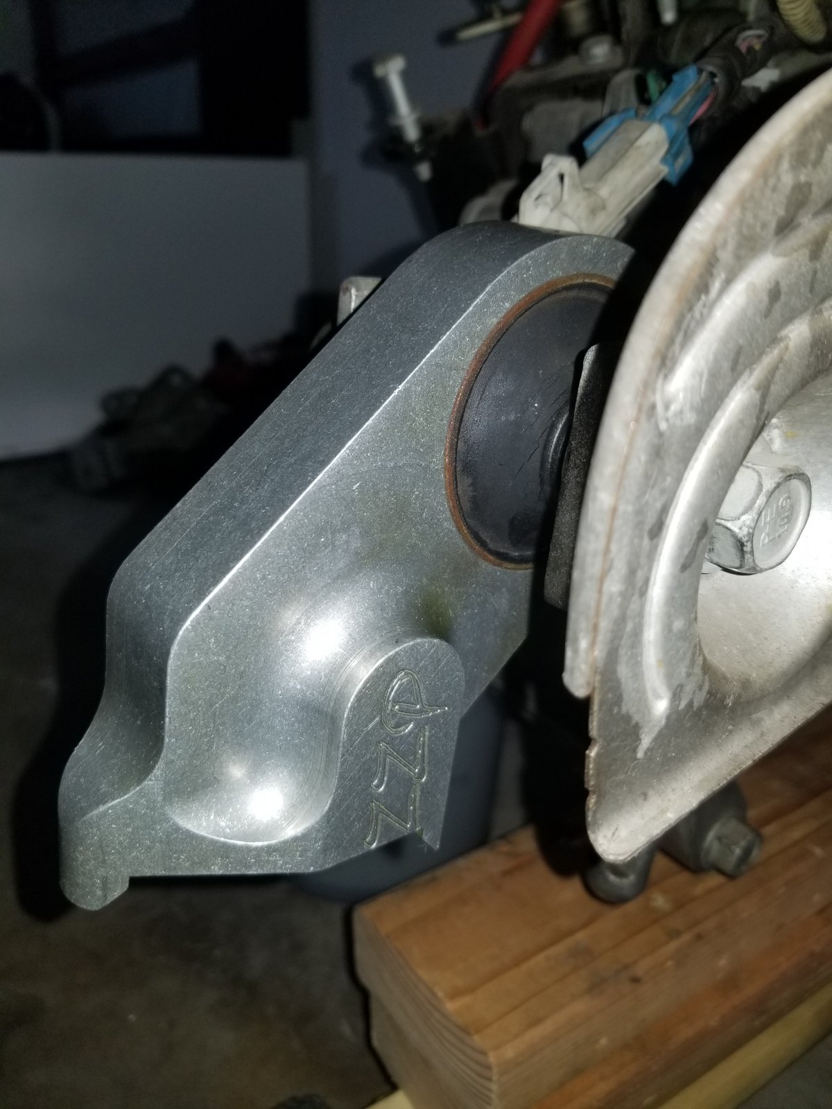

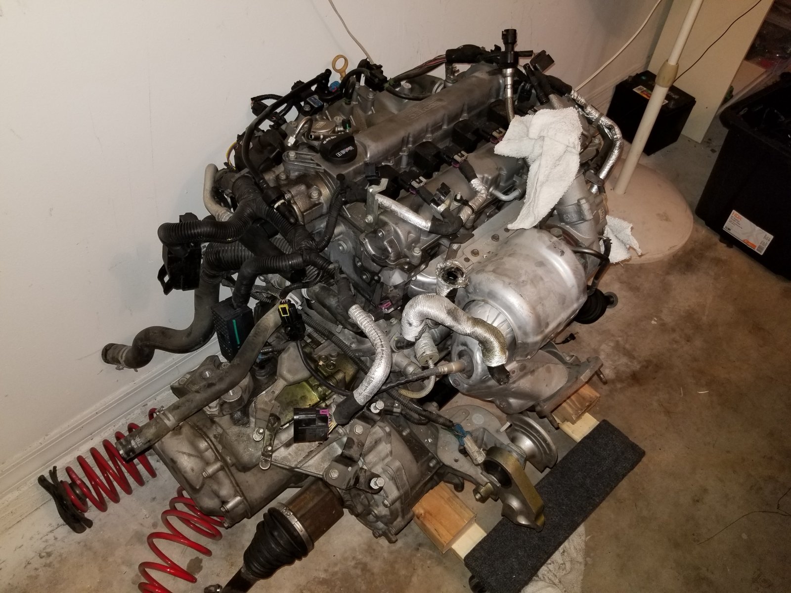

Looks like some sort of aftermarket engine mount in the last picture. That doesn't look like any of the others I have seen.
Keep posting your build! Glad to have you aboard!
Lethalcast
Thanks ctuinstra! Ill keep updating as i go! The front and rear mounts are zzp but I can see cracking in both, Idk if I should use them.
The reason behind the solid mounts is that upper frame mounts are solid and if the lower two are rubber, they can allow for some torque movement of the engine/transmission and put extra stress on the upper two solid mounts. This is especially so on the higher power SS vehicles. The base models don't have to worry so much.
