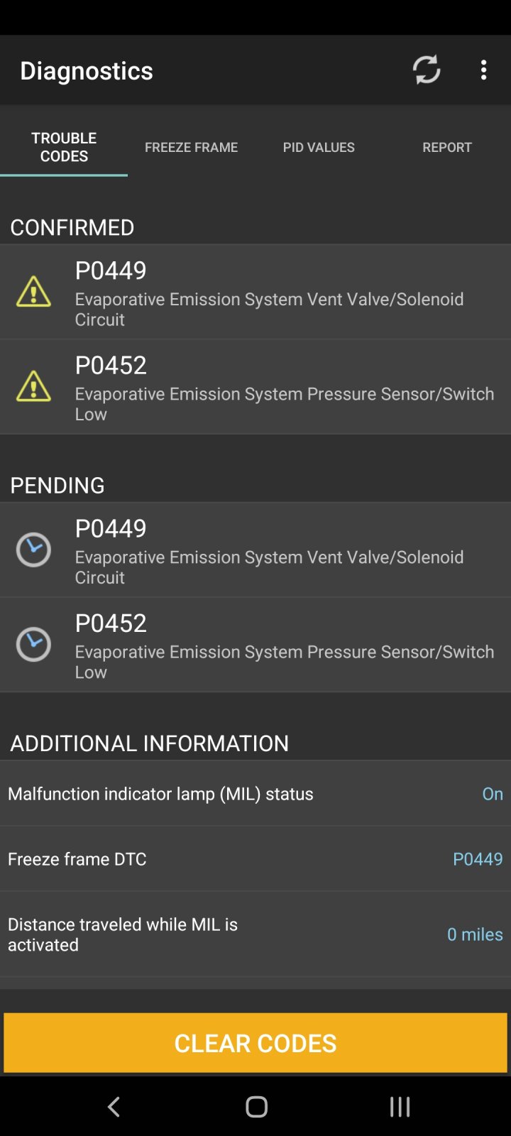

When I cold start my ss/tc. It idles up like it's still trying to get the cats hot. Which is no big deal but while it does this high idle for around 30 seconds or so it runs rough and pops out the intake and exhaust. It will do that for a bit then it sounds like the bypass valve opens up. After the whoosh sound of what i assume is the BPV the idle drops and it runs normally. Both MAP sensors and MAF are new. I had a crashed donor so I don't know how the motor ran before and my pcm is from LKQ and came out of a solstice that had an LNF. The video is a mild version of what it does since the motor was a little warm already and it doesn't set any codes that look related.
