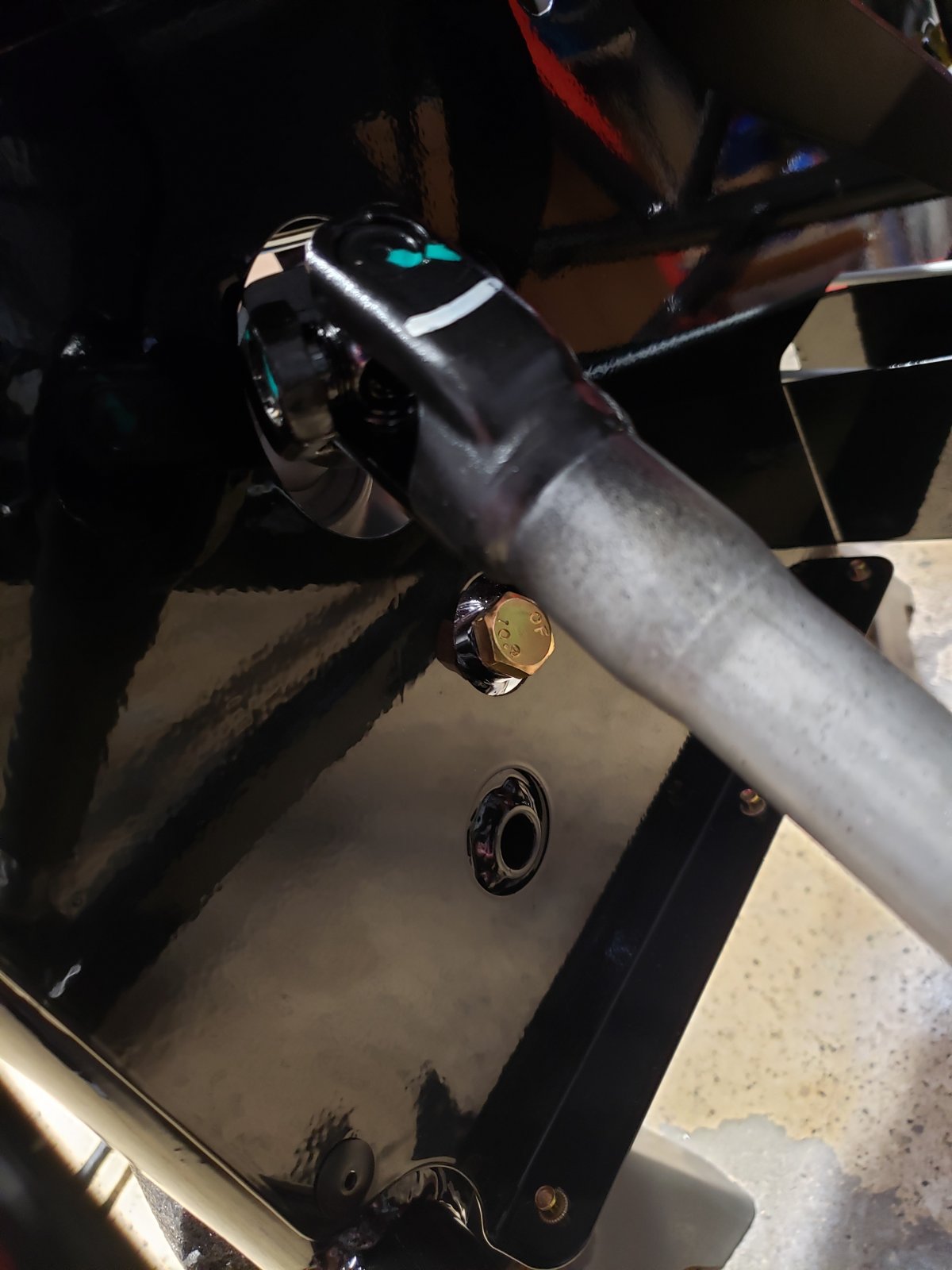

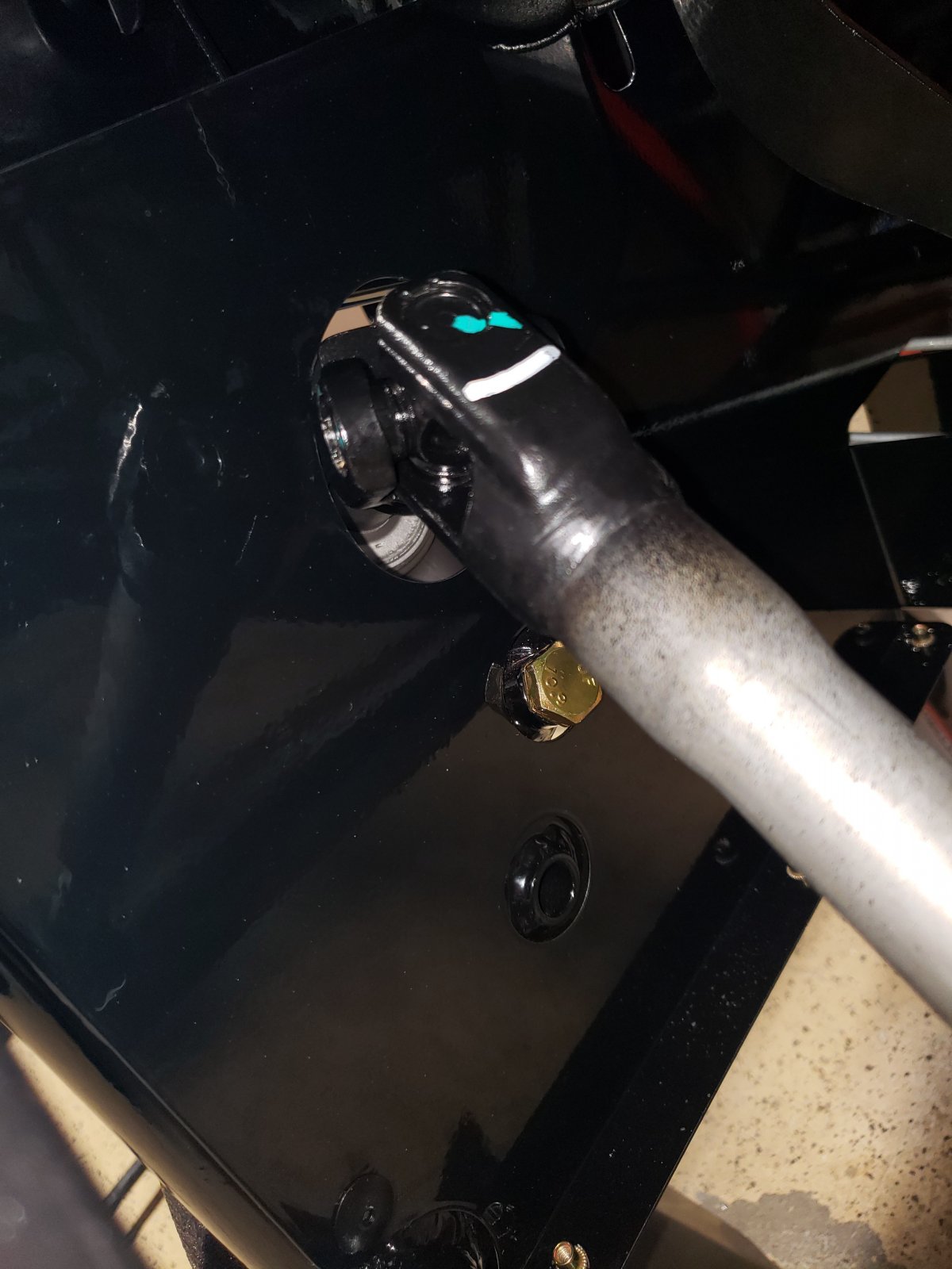

Anyone else have clearance issues between the intermediate shaft and hole in the firewall?
21705
21706

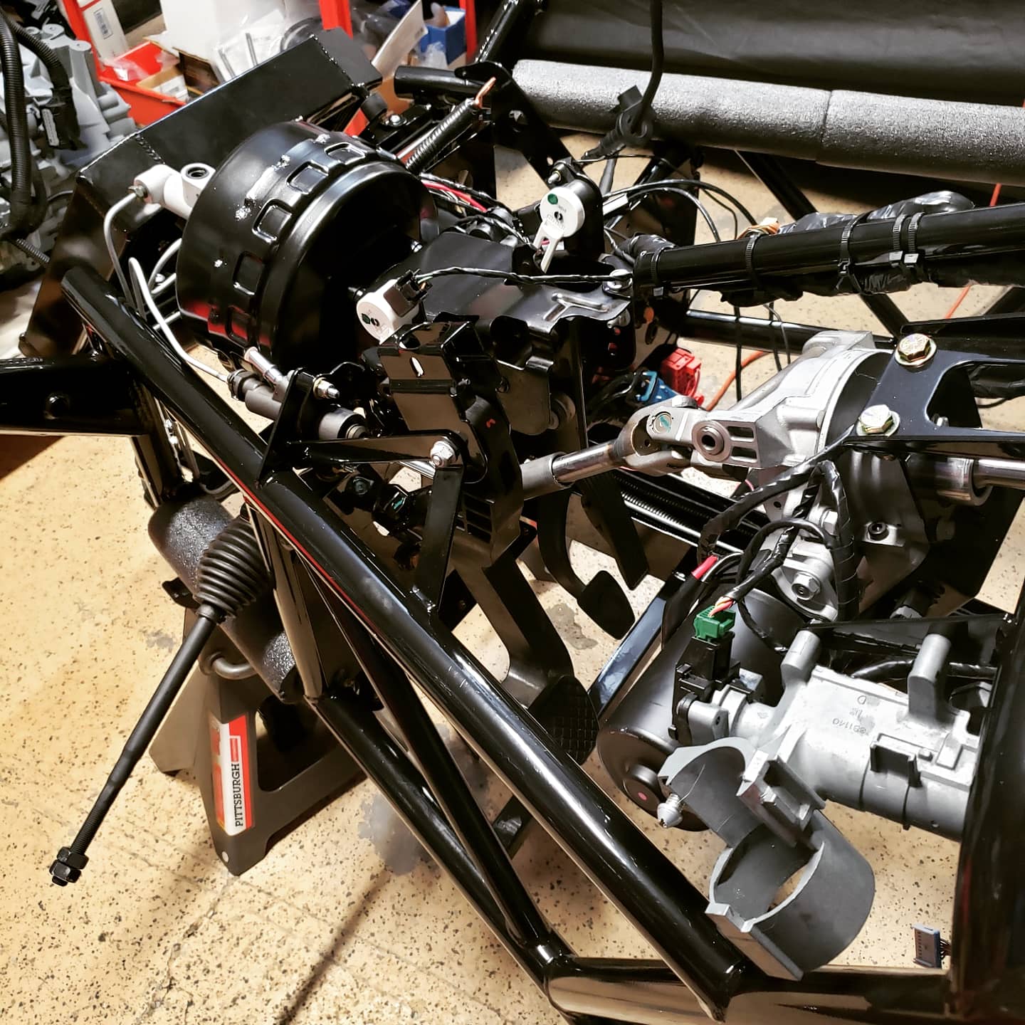

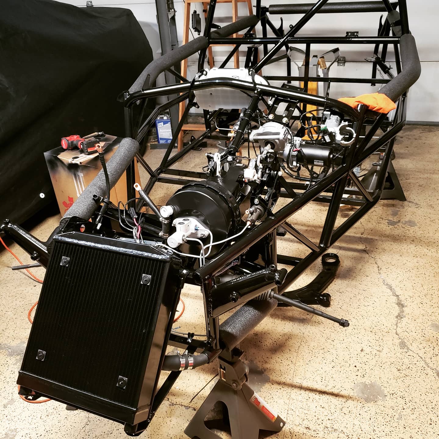

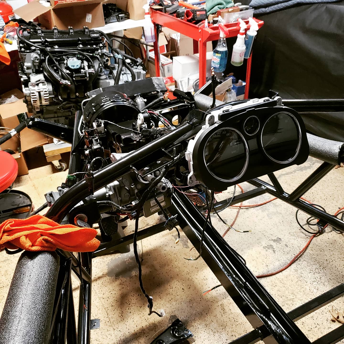

Radiator in
Clutch in
Most of the wiring up front done. Need to add some connectors that i'm waiting on.
Brake lines upfront completed.

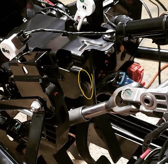

look at the brake push rod, it’s probably at an angle. That squishy spacer goes on the other side.

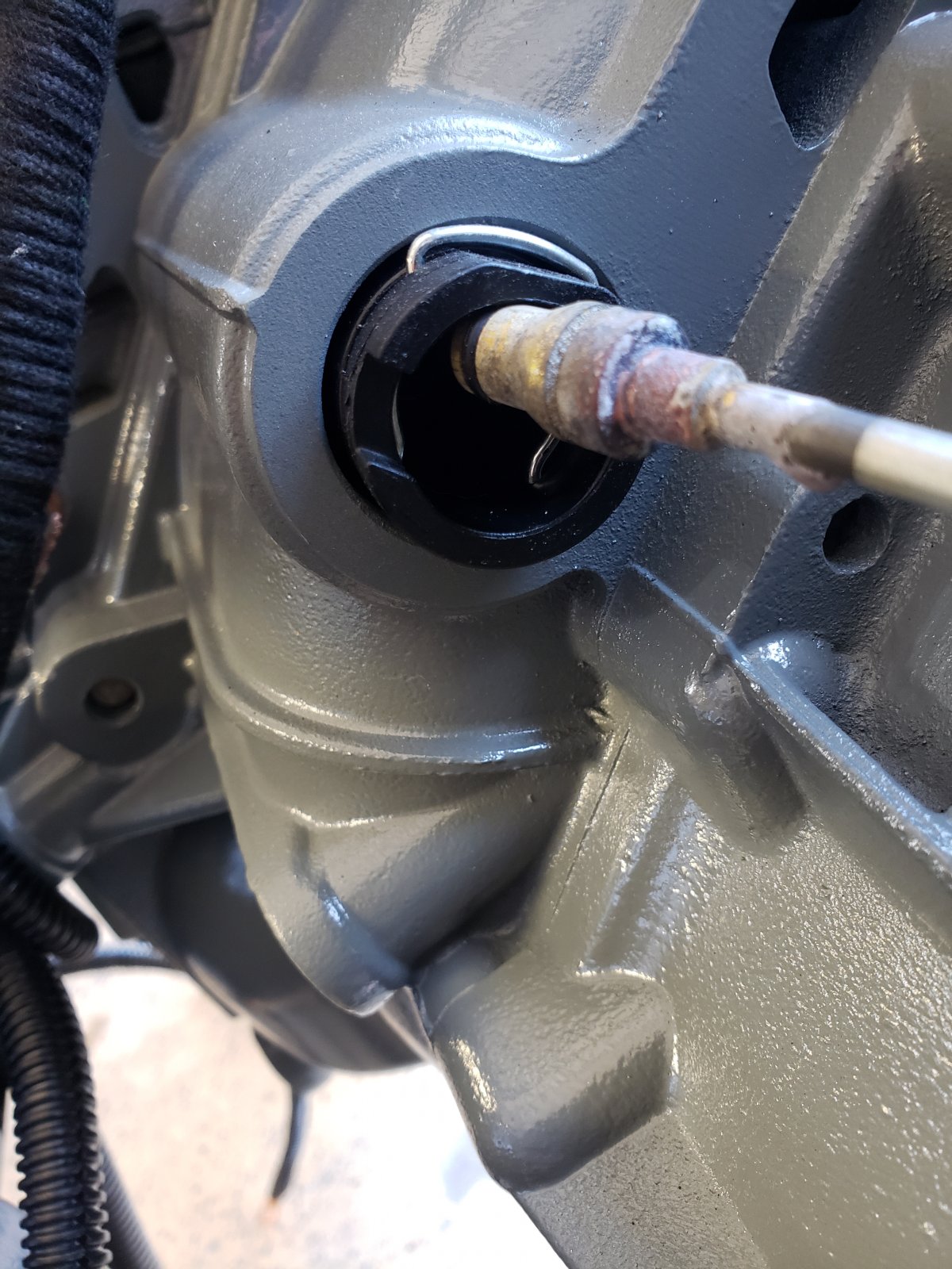

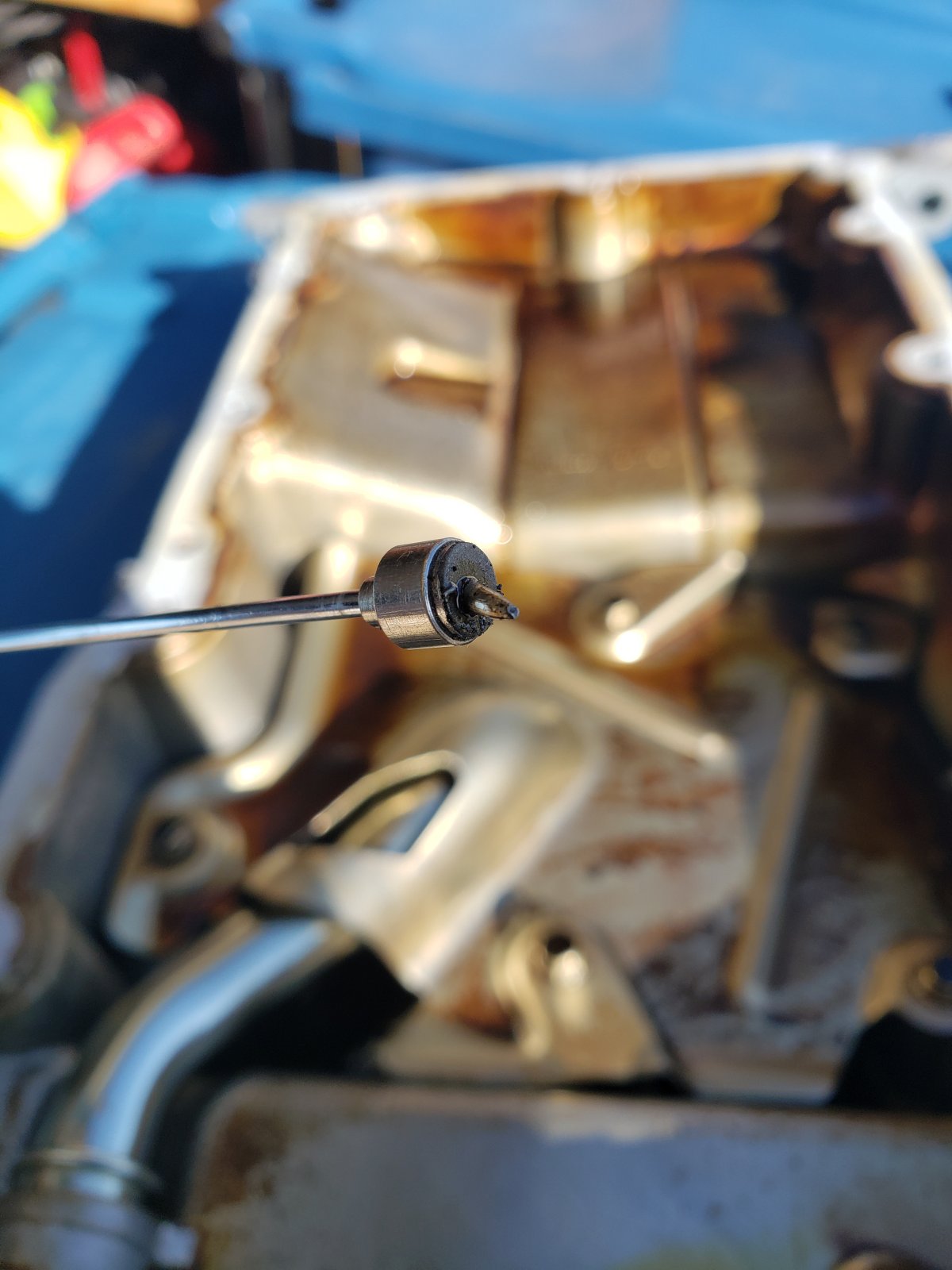

Found the small piece I broke off trying to remove the broken dip stick.
removed and reinstalled oil pan.
installed new dipstick tube

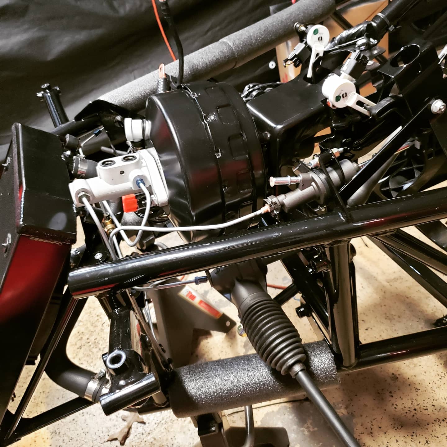

scratch my head with the clutch line still!!!!!!!
installed fuse box
waiting on BCM :/
figuring out missing piece from the kit. Seems like either you need extra coated clamps or I'm missing a few among some things.
If anyone can help me with what is needed for the clutch line. What is needed between the DF supplied line and the slave cylinder?

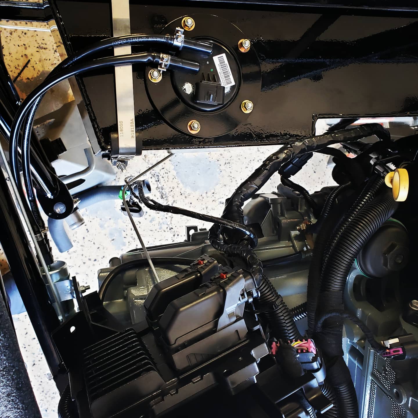

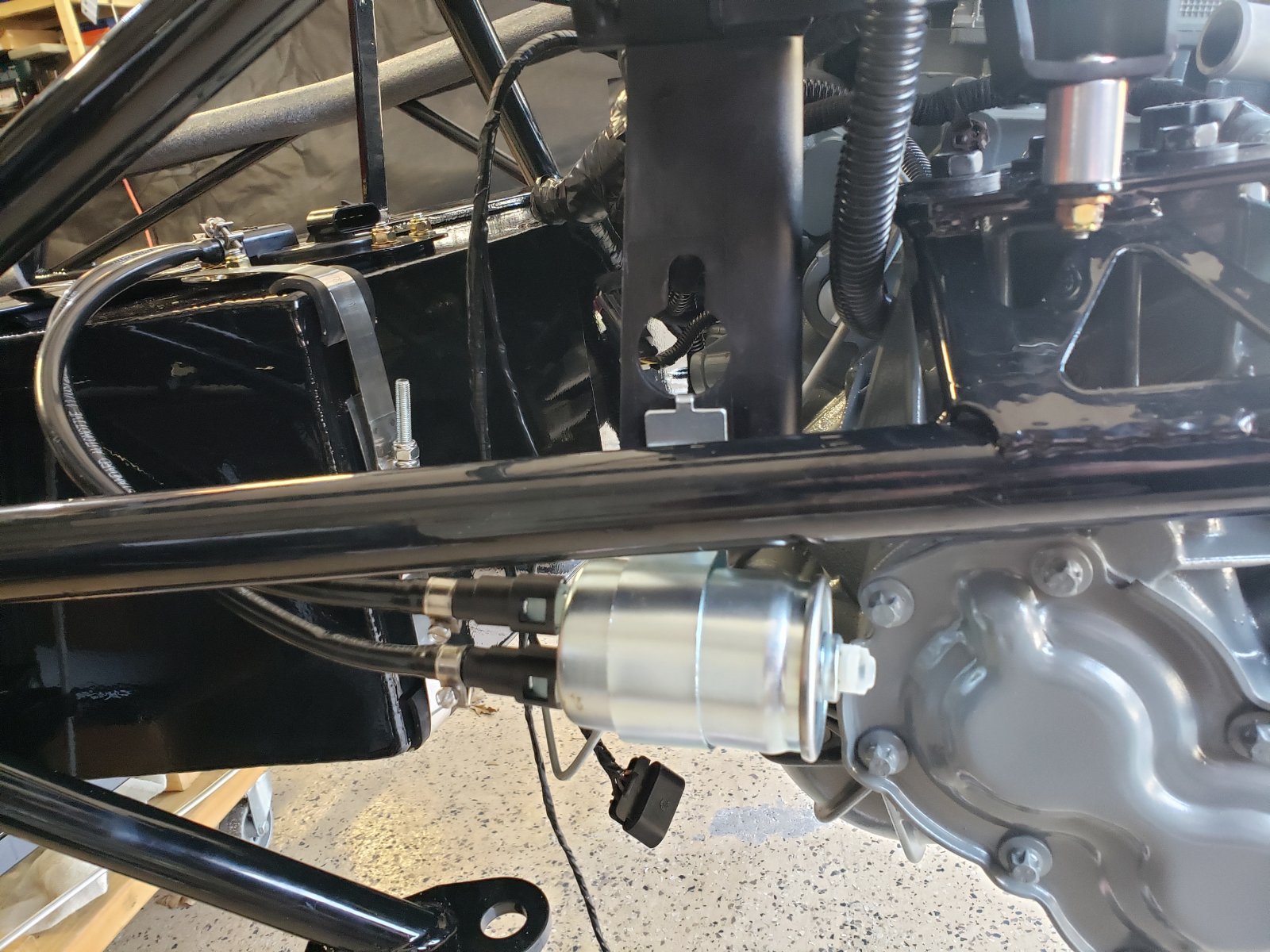

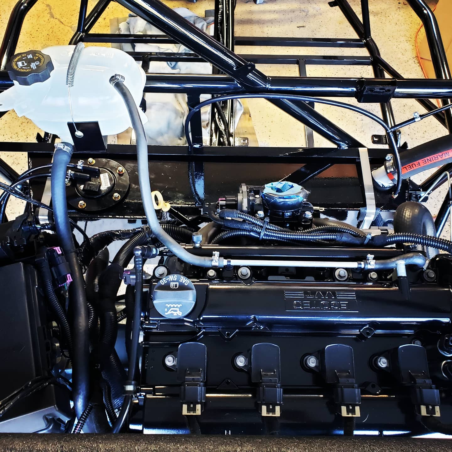

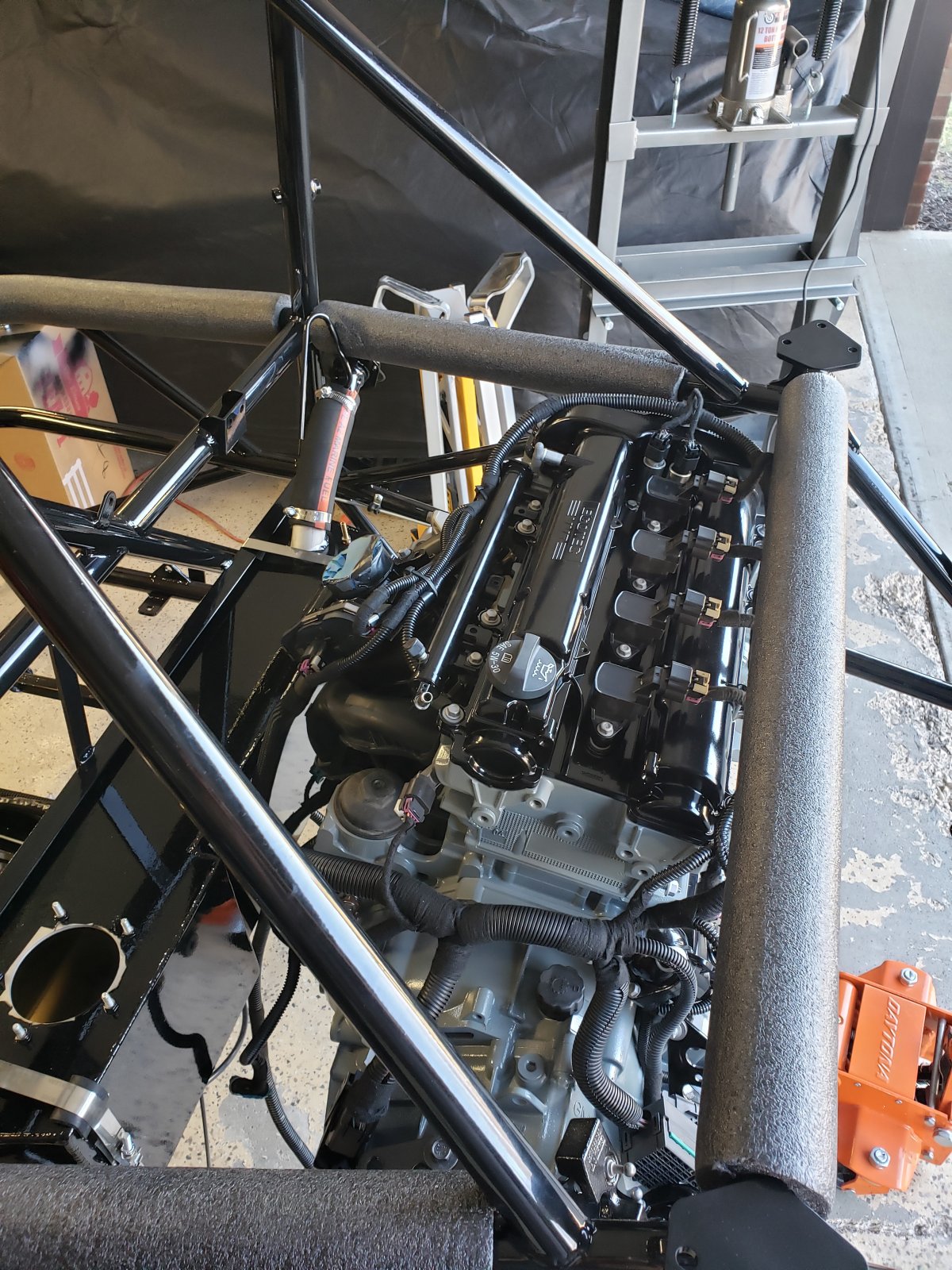

Fueling system completed. Installed new lines instead of using factory. Will see if it holds. If not then rubber it is.
Completed the cooling system as well.
Next is to install the BCM which im still waiting on and then doing fluids and I should be able to start. :)

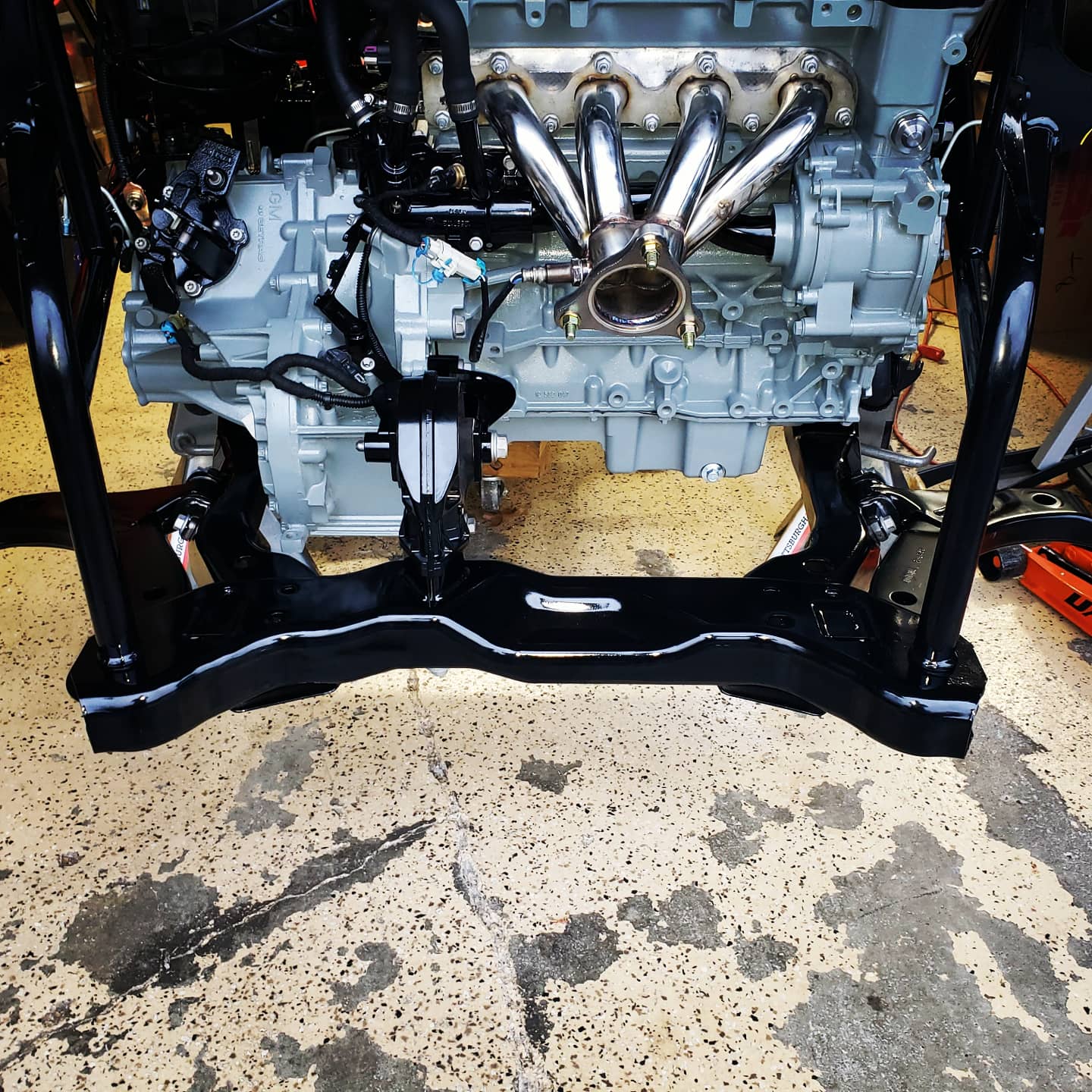

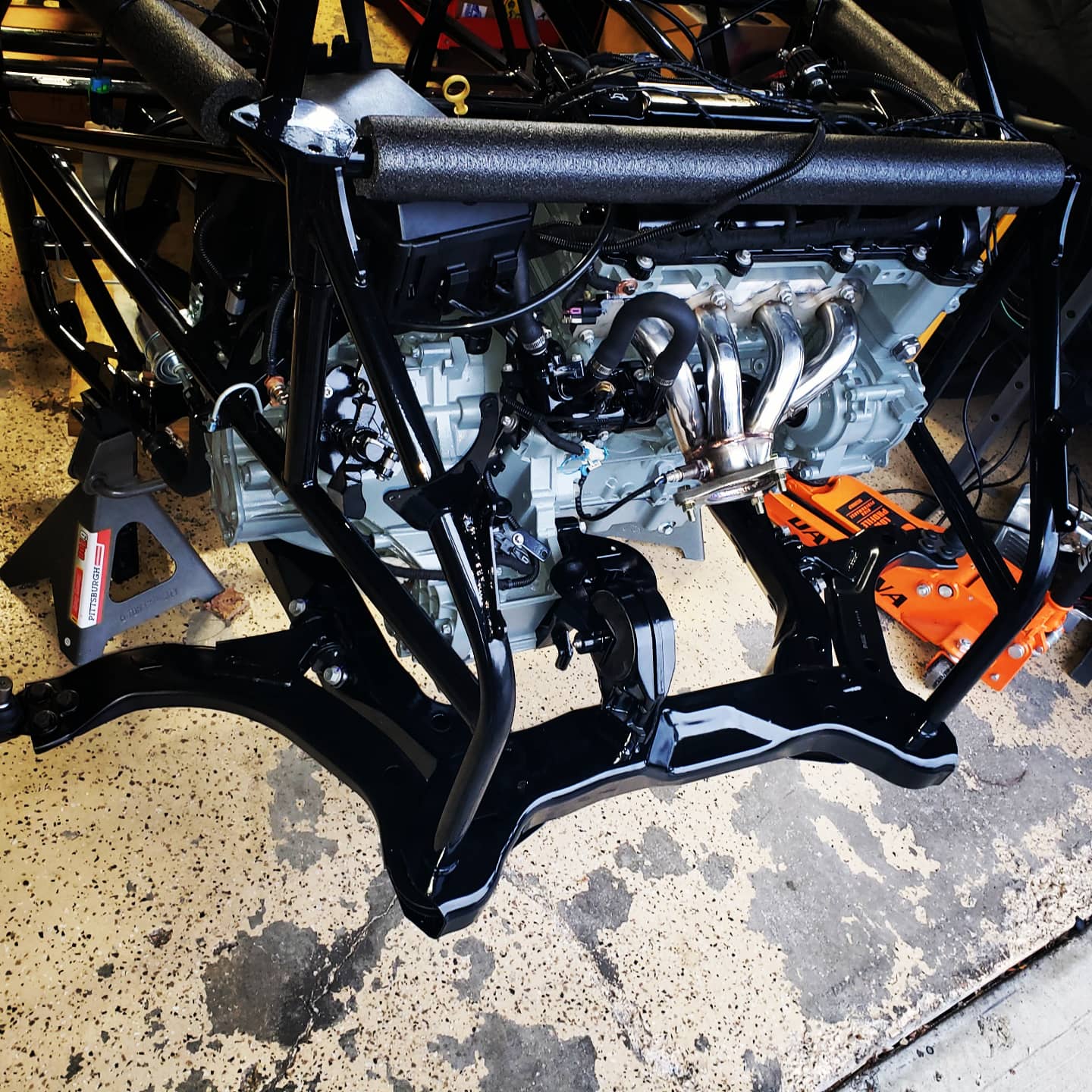

Installed the subframe, tranny mounts, and exhaust manifold. Powder coated all the front suspension and rear suspension parts. Should be getting my BCM back today and first start sometime this weekend! :cool:
22135
22136

Got the BCM back and installed. Installed the kick plate temporarily with rivnuts for easy removal. Went to prime the fuel lines and massive leaks.
First one was I never realized or looked at the fuel filter inlets to see they are different size pipes and put the same size quick disconnects on.
Second was the fuel injectors. During this whole assembly and cleaning part I replaced the injector seals and I believe I put the wrong ones in. I Also noticed the receiver end on the fuel rail of one that was leaking badly was bent and not sitting like the others. I ordered some new injectors and a fuel rail to make sure it is sealed. Fuel ruined some paint on the engine luckily it is on the firewall side :).
