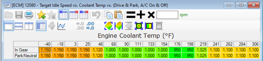

Hey All,
I have been waiting to post my tune due to the renditions that ZZP and I had to complete to generate a stable tune (20+). ZZP was great at customer service and I appreciated being able to remote tune. Please take a look at my latest log and let me know what your feedback is. Overall I have been on 2-3 rides since the final tune and most recent ride was very aggressive its too bad I did not log it.
Build
1. e85
2. 870cc injectors - FIC870SPLIT
3. ZZP Stage 2 Cams
4. ZZP Titanium Retainers/Springs #82
5. 3.1 Pulley
6. Dual Bypass
7. Diamond Pistons 9.5:1 / Stock Rods
8. ARP Studs
9. Gen3 Block
10. LSJ Head
11. ATI Overdrive Balancer
12. AEM AFR Gauge with Serial to USB connection to HP Tuners.
