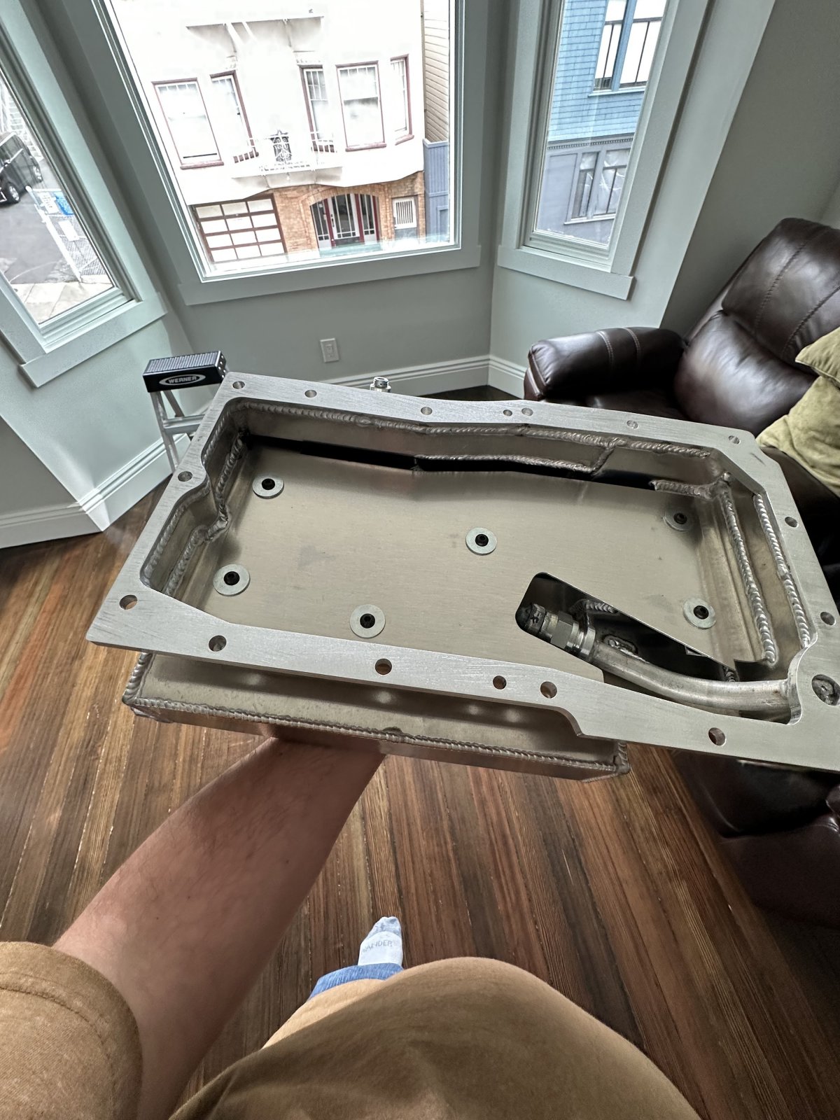

I picked one up this week.
Ill be running it on my LNF track goblin. I also have an accumulator.
I might get to install it this weekend.
ATMironov
Unfortunately the oil pan doesn’t fit.
I should have measured.
it looks like the motor is mounted much closer to the sub frame compared to the stock cobalt.
the CBM oil pan is interfering by almost 3” at the Passenger side subframe.
i hope they take returns!
