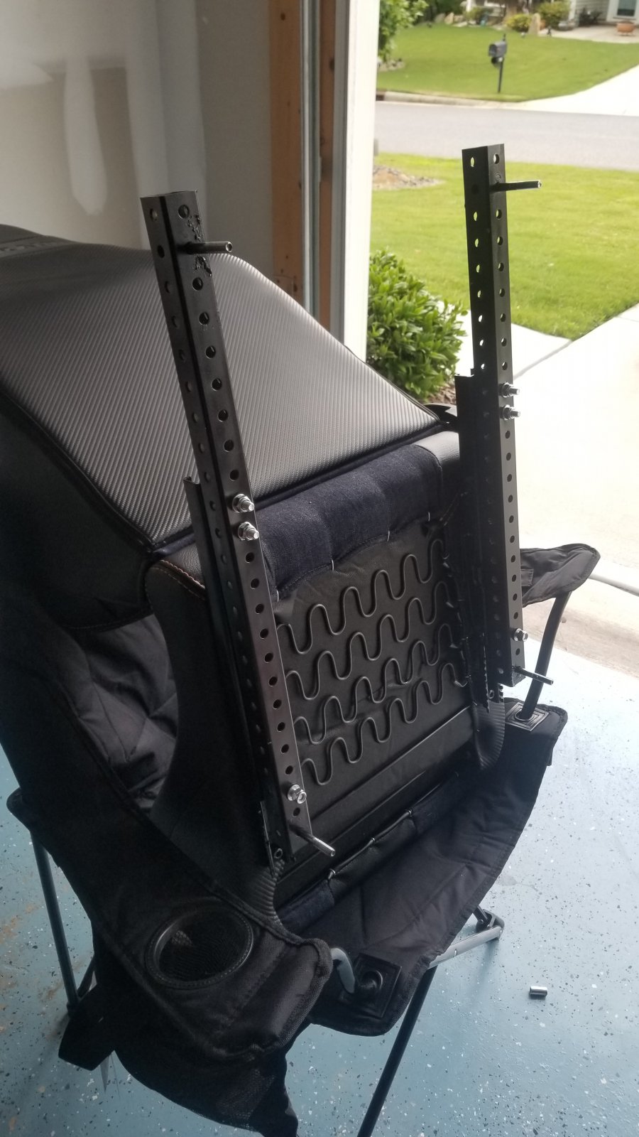

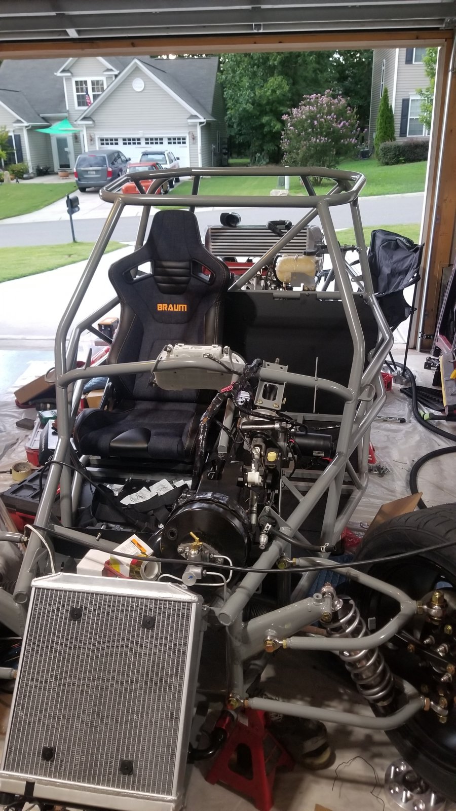

Also assembled the seat attachments and installed my passenger seat, fits perfectly.
For what it's worth, Braum seats are reasonably affordable, look amazing, and fit perfectly in the goblin. Mine are reclinable and all I needed to fit them was some stop sign post channel (has holes every inch or so) and a few other bits of hardware to make it beefier. I can make a write up of what bolts and parts from Lowe's were needed if anyone's interested. Well worth it to get sliding and reclining seats + 5 point harnesses for about what the corbeaus end up with DF, and only minimal installation work needed.

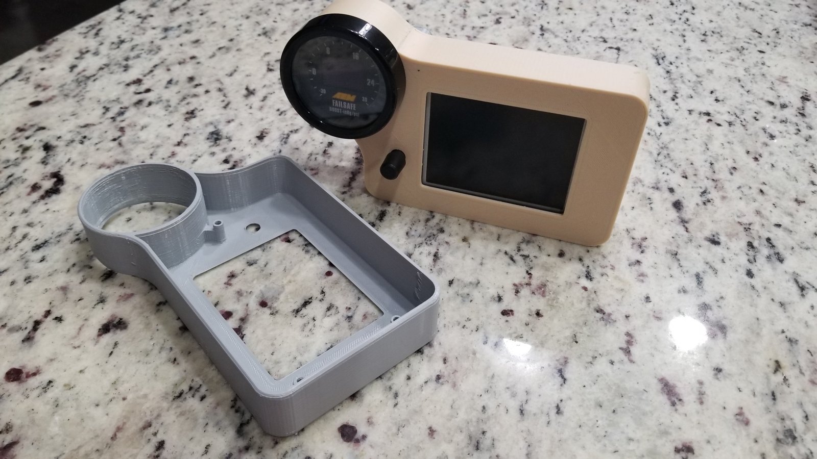

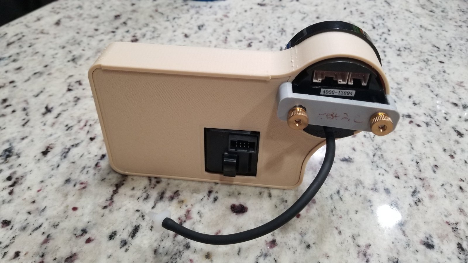

I'm also working on a combo gauge/rpd mount, first rendition turned out pretty well. Needs some mounting points and a few other bells and whistles. Pictures are a mixture of different versions printed with different types of filament.

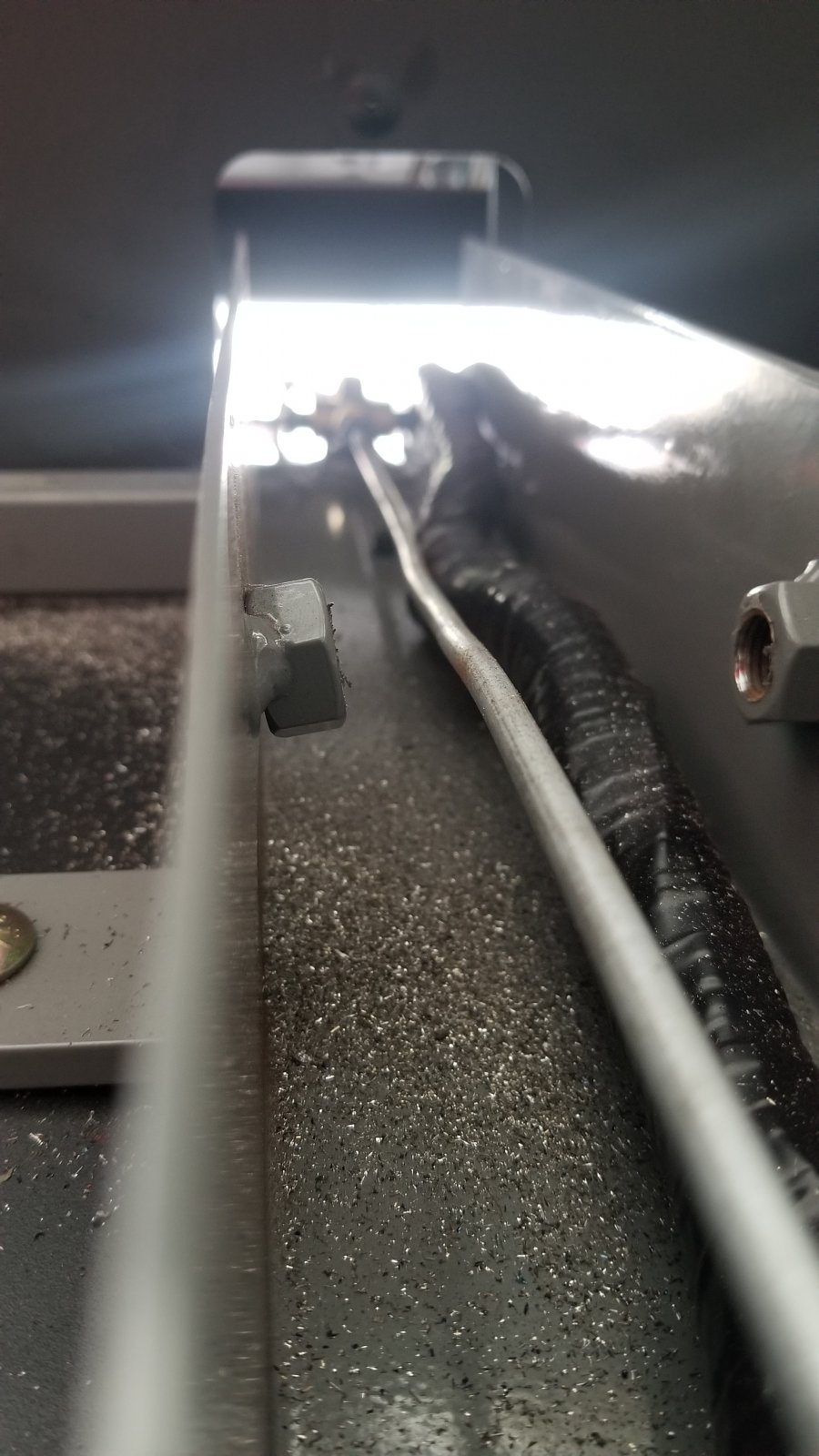

Can you send us some images of the seat belt nut?
We use two 7/16-20 Corbeau seat belt bolts to pull them against the inside of the tunnel while they are welded in place.
I will show the images to Ray so he will know what to look for before welding them.
Any interest in being compensated for your efforts, and making a second one once you have the mounting point dialed? I'd like my RPD and wideband gauge mounted together!
looking good there!
And all the rest of us mortals who do not have an RPD collectively sigh......... :)
When you're looking through the bolt-hole it's off centered enough for nothing to go through successfully. Drilling it out worked fine though.

Got my driver seat in yesterday and now all of that's settled and looking nice.

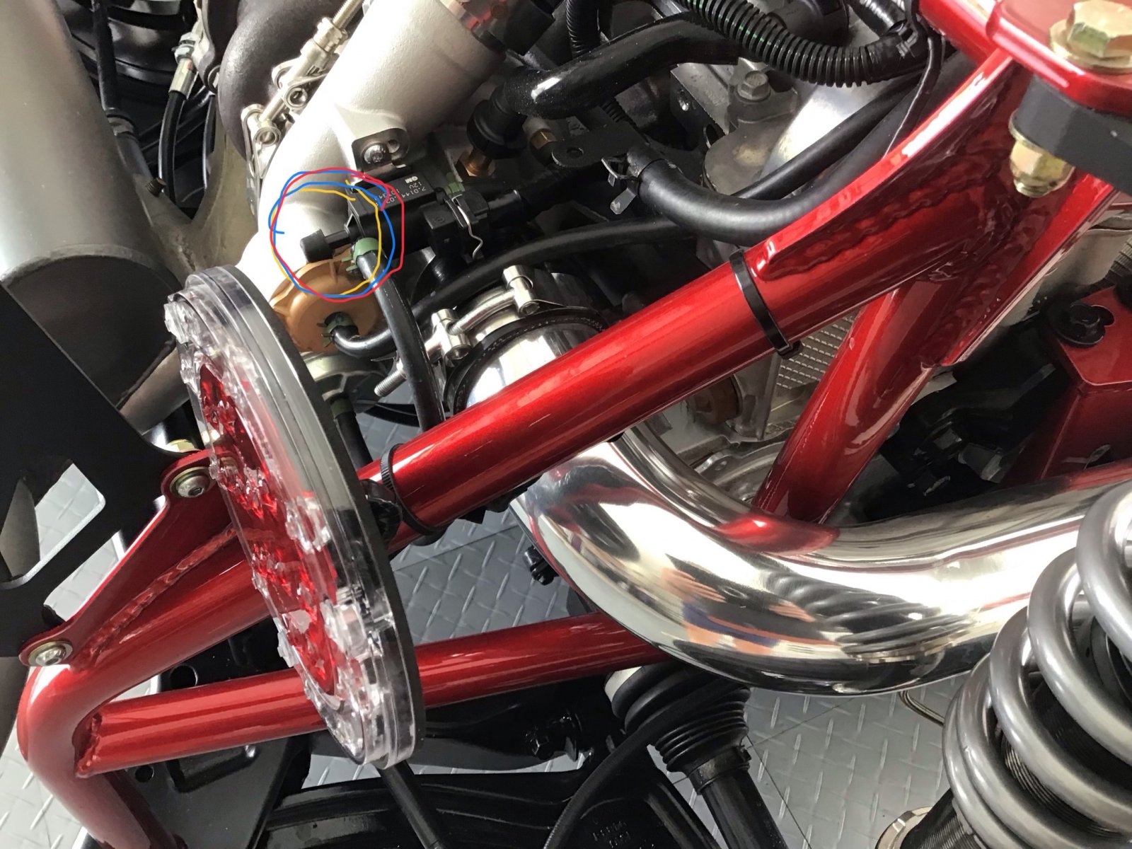

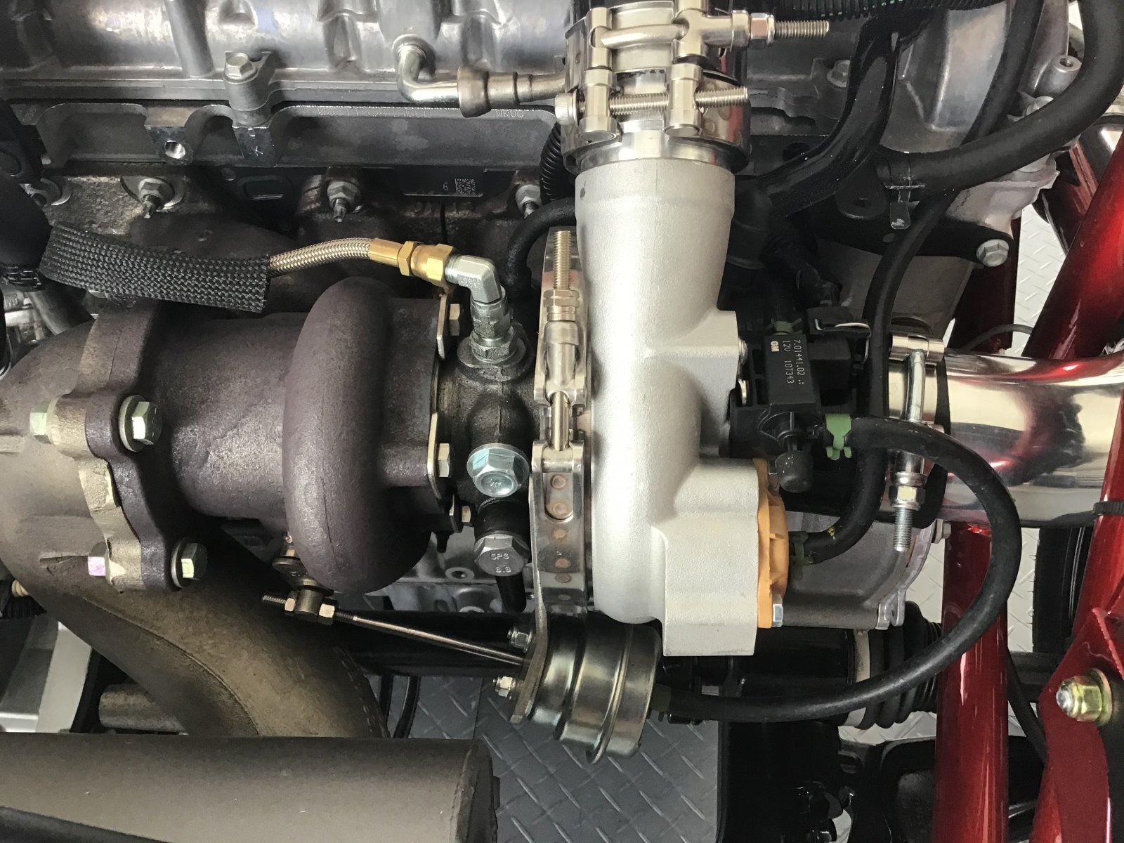

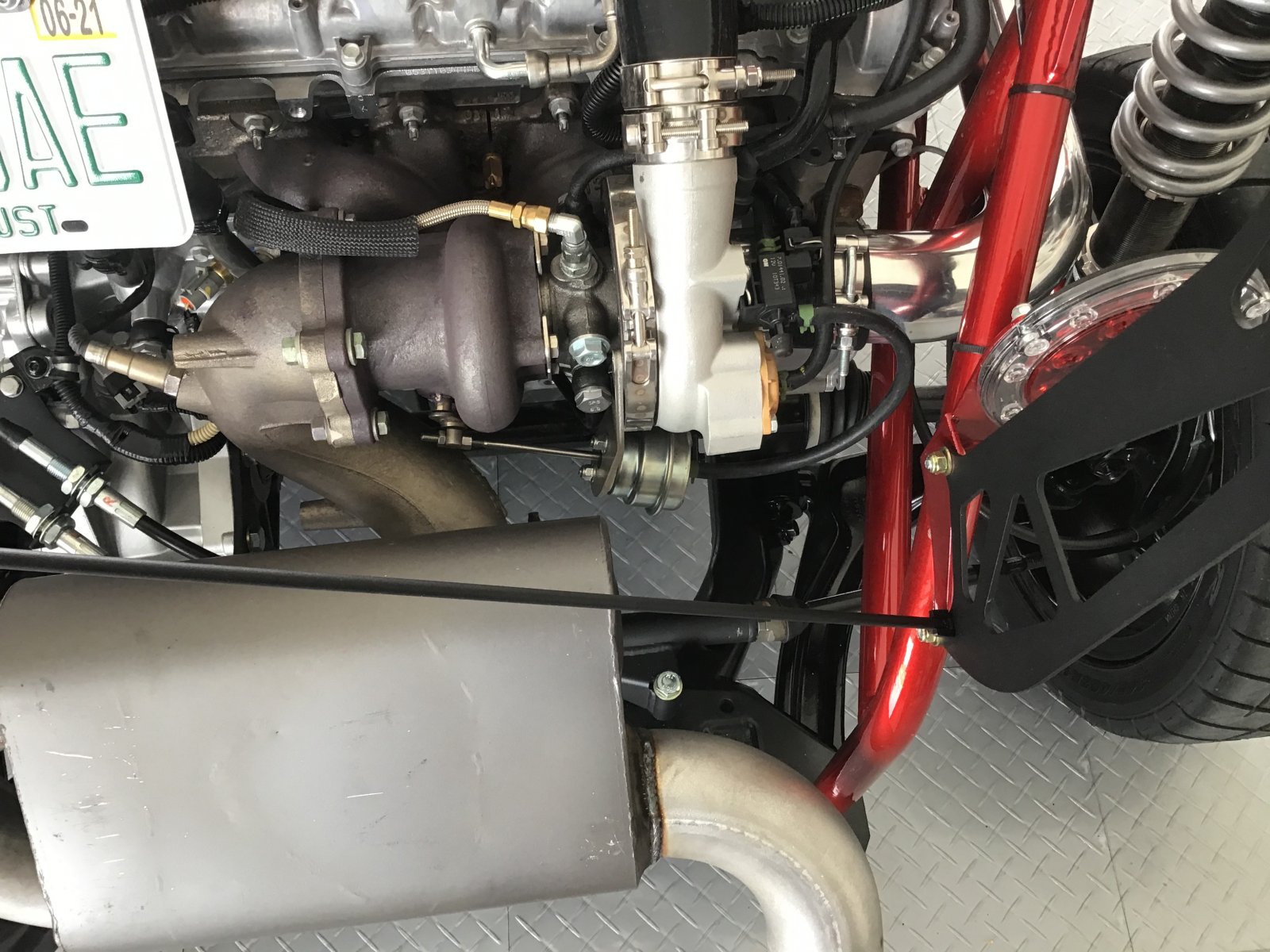

Help hooking vacuum lines on Z54 turbo , This turbo has a extra vacuum connection does your new turbo have extra vacuum connection if so where do you hook it to my turbo doesn’t work
