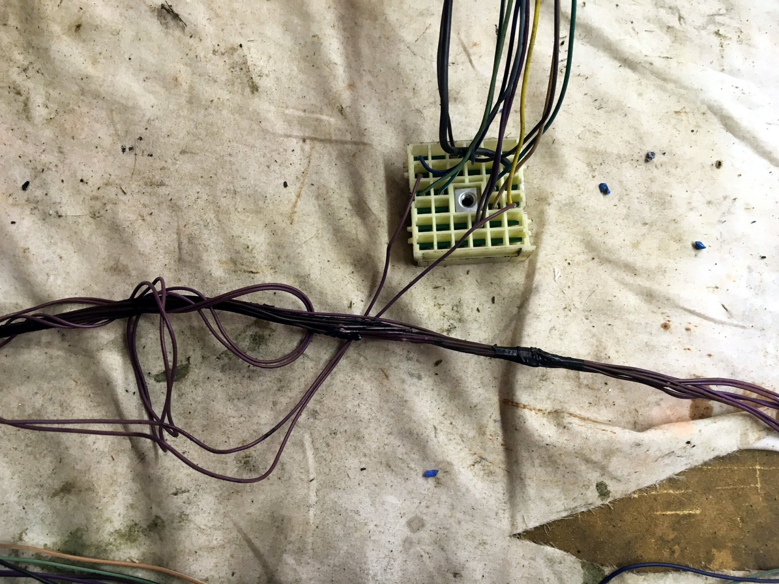

V1 Melted Purple Wires
This is found in the headlamp wiring harness. This very long loop of purple wire goes from on pin on the plug to another pin with a yellow wire (that goes to the headlamp). I found that this loop has gotten very hot at times causing it to melt the wires together and melted the loom. None of the other wires bundled with it were effected so I don't think it was external heat that caused this.
Does anyone know what the purpose of this wire is and more specifically why it's a long loop in the harness? Can I just cut the loop out and solder the it together inside the plug? I believe this is for the fog lamps, which I do have and those wires are purple, but it's not wired directly to the on this side of the plug.

I have pulled apart a couple of used headlight harnesses all were in the same condition as yours. Right, wrong or indifferent I just jumped them together at the block.

This wire is for "daylight driving lights". It is actually used as a inexpensive low value (ohmange) "resistor". When you have incandescent lights (they draw a lot of current) and you want to have them on in the daylight this "dims" them just a little extending the light bulb life. I have LED headlamps and they draw so little current the long wire resistor is of no value.

Sounds like a great way to catch a car on fire to me! I cut the wires out and jumpered them at the connector. I too will probably use LED. I'm leaving the optional lights in the wiring but I may use them for an "Off-Road" light bar or something.

BTW - If you do not want to have day light running lights, I think you can just leave the wire cut. I think there is also a DRL relay that could be pulled to disable the lights during daylight.
Burning up the wire could have been caused by someone putting much higher wattage headlamps in.

In my 2005 donor, the purple were a melted mess also.

This long wire serves as a "resistor" lowering the voltage and power to the headlights for daylight running.
